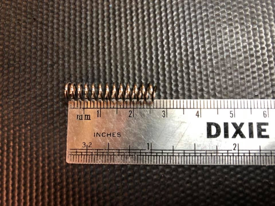

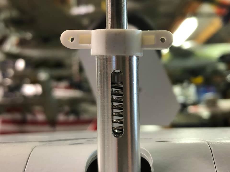

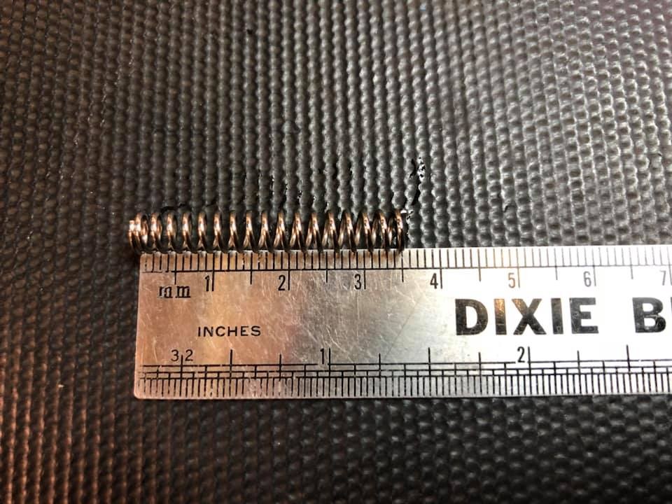

                          Switched out to softer springs, so much more dampening it’s such a soft landing almost unbelievable.
                          The longer spring is the softer one.
                                        So where did you get the new springs and type and size? I can see that the gauge of wire for the spring is smaller. I'll either cut them down like George did or put these in if I can find a match for them. Also, where did all the lights come from? Love to see video with new springs. Merry Christmas and a Happy New Year!
