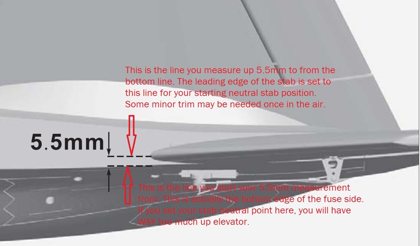

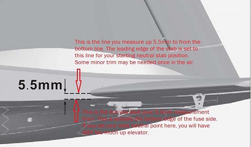

                                  Welp, the maiden didn't go well. She went screaming down the runway, pulled back on the elevator, wouldn't rotate, more elevator until full up, finally rotated and pops up. I relax the elevator a bit so that she won't go high alpha after take off, and when I did she slammed back down to the runway (grass) and flipped over. Oh well, repair and try again.
                                    #1037
                                    Bummer! Could it have been nose heavy?
                                      #1038
                                      ESC calibrated?
                                      • JazzmanB
                                        Flying and drumming in the pocket
                                        • Sep 2018
                                        • 85
                                        • Sf
                                        #1039
                                        Weight test https://youtu.be/Z_iHIi38j9k
                                        • Flash Jorden
                                          • 77
                                          #1040
                                          For anyone that may be a little confused about how to set the stab neutral position.
                                          Click image for larger version  Name:	F-22 elevator neutral.jpg Views:	1 Size:	130.6 KB ID:	169447
                                          Yup, this was my problem. I set the elevator neutral angle wrong. I thought the picture was showing 5.5 mm up from the fuse centerline, when it is actually from the bottom of the fuse. My mistake, I should have gone through this thread first. The picture and explanation in the assembly manual could be clearer.
