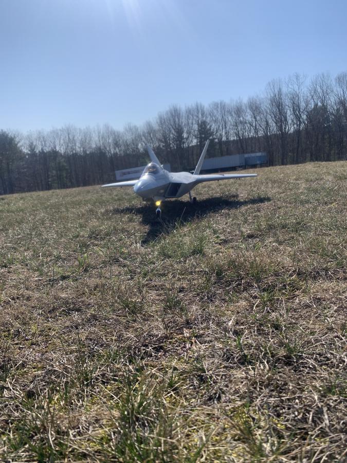

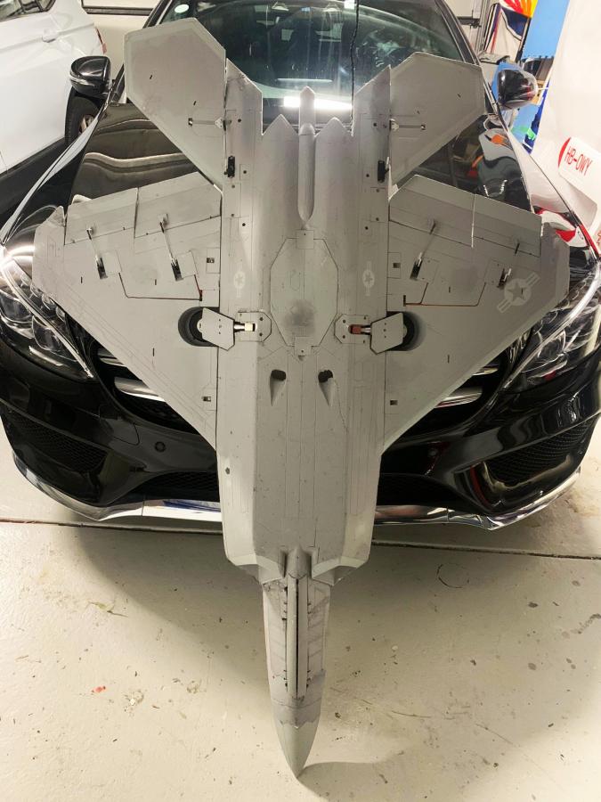

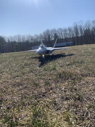

ID:	317800 Sheared another stock freewing gear pin today on takeoff. Belly landed safe in high grass. Thinking of 5mm steel round rod instead. Anyone else?
                            Have you considered a backstop or brace for the nosegear strut, to relieve the bending forces by moving the torque axis from the pin?

                              I have a 3d printed nose gear brace which works great and have had zero issues with front gear. Specifically the mains I have snapped 3 pins now.
                                Perhaps bigger wheels?
                                How fast do you land? How much flap?

                                  Gmack908 very unusual, it seems there is either something wrong with your field / runway or your landing technique....a short video might help the guys in here to help you with your problem.
                                  it is definately not common to snapp one pin after the other. 😖
                                    looking at a video of an earlier landing it may have been a bit hard. Also the field is quite rough on takeoff I looked back in the videos I have and it’s really blasting on the retracts. I also noticed that the pin broke exactly where part of it is notched which tells me I had installed it maybe not far enough down in the retract. Replaced tonight and will fly again this week when the rain stops and see how it does.
                                      #3598
                                      Ease her in, bleed off that airspeed and plop her down, she likes it that way.

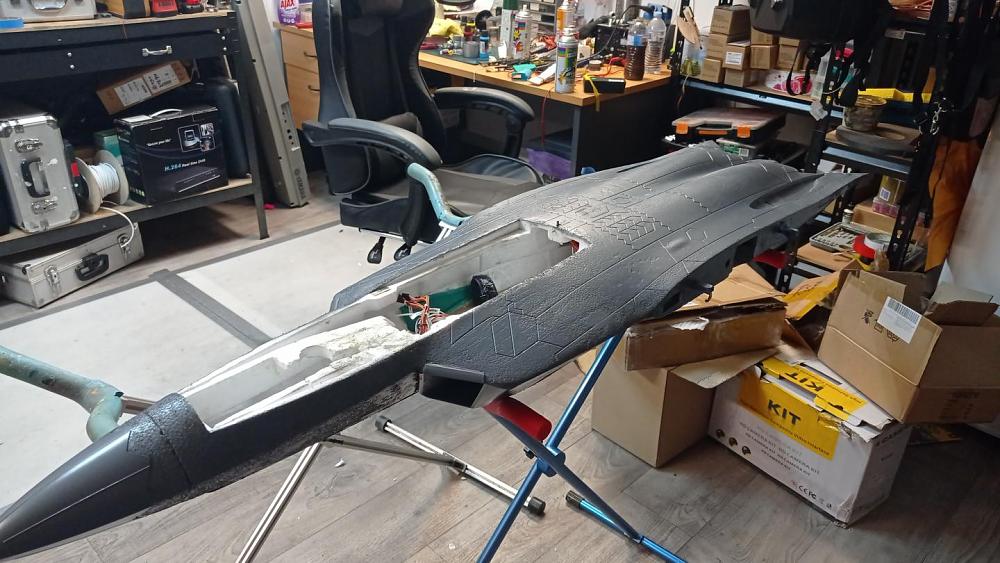

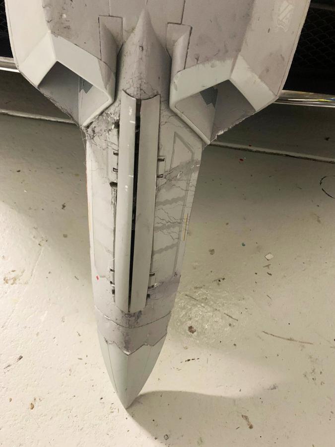

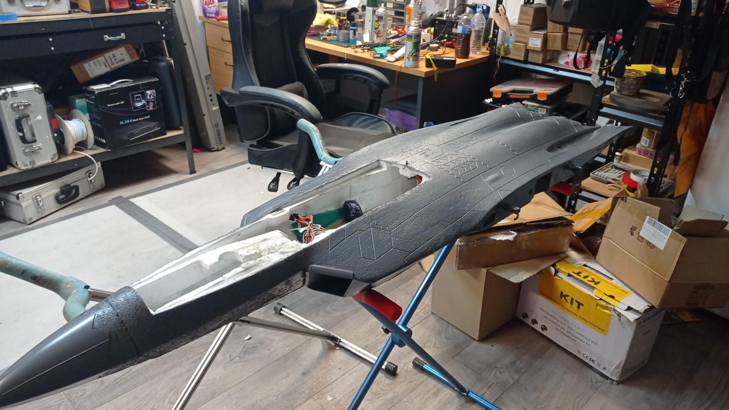

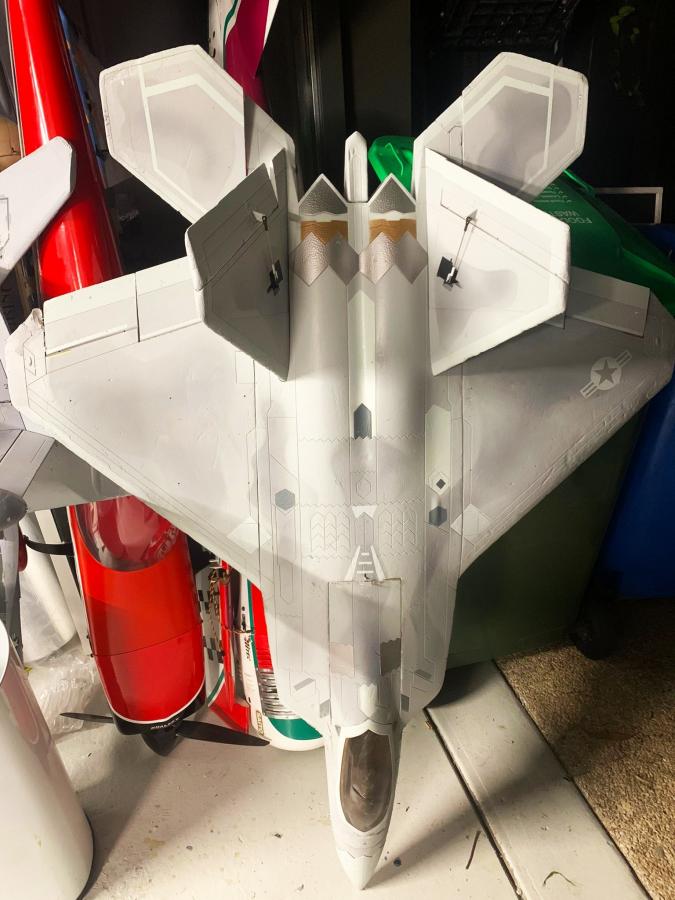

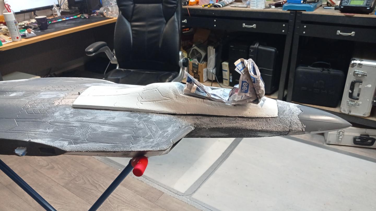

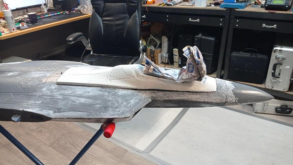

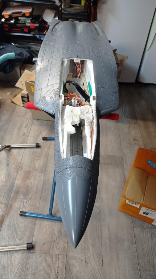

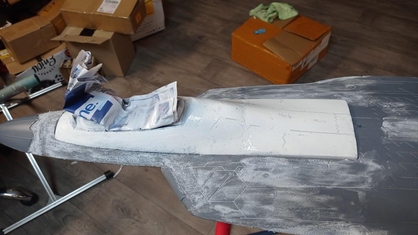

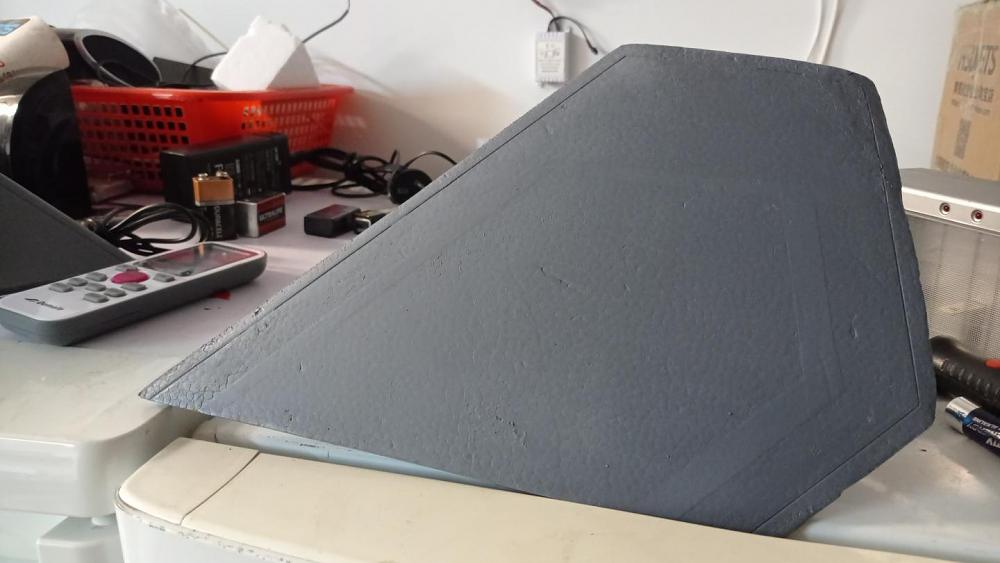

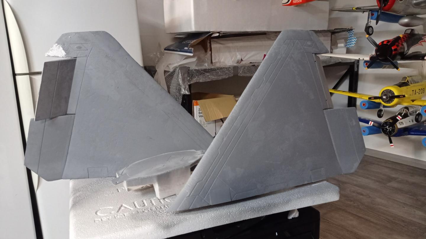

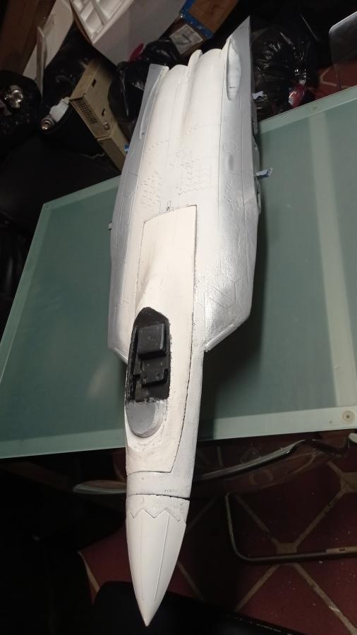

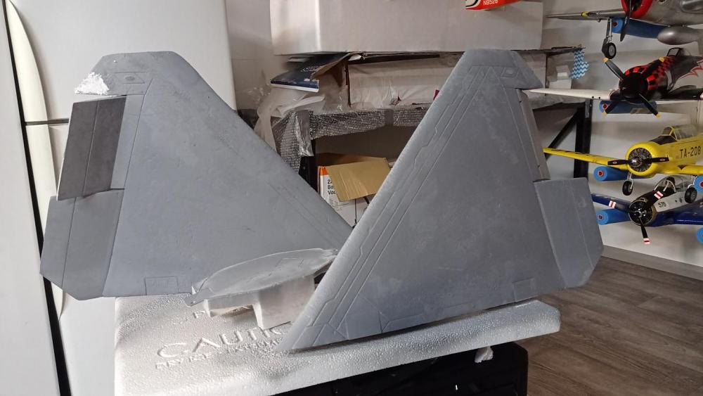

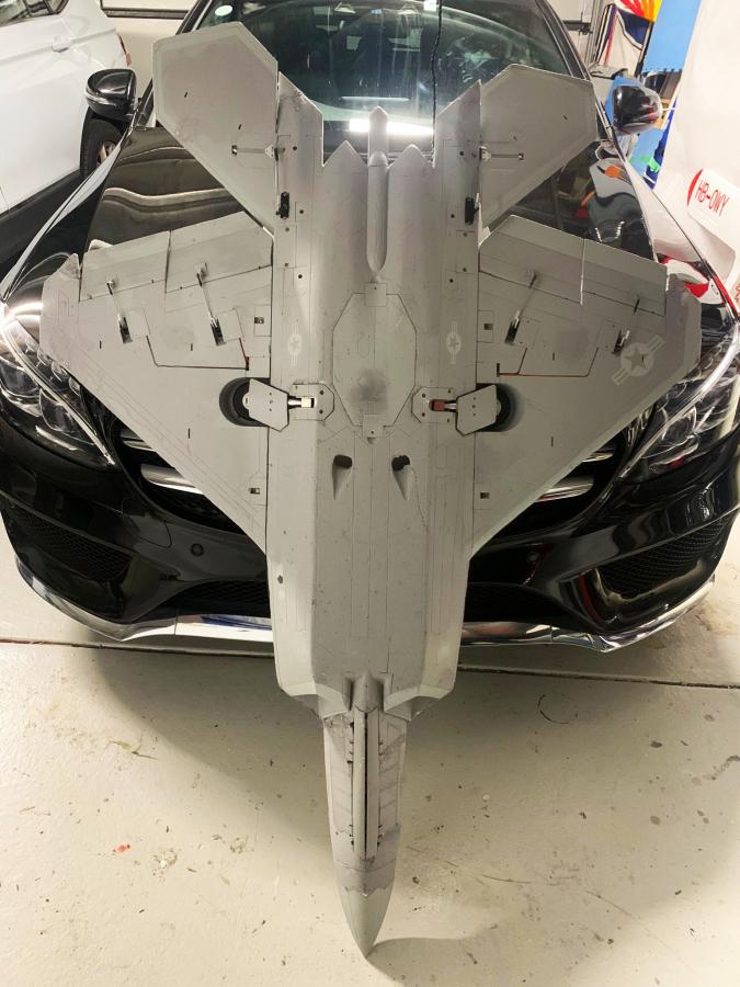

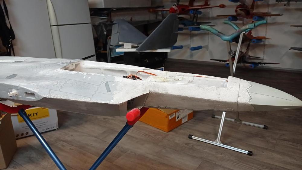

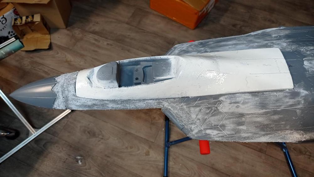

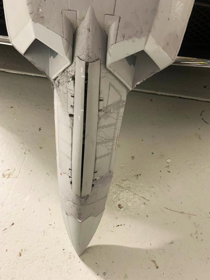

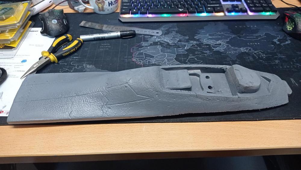

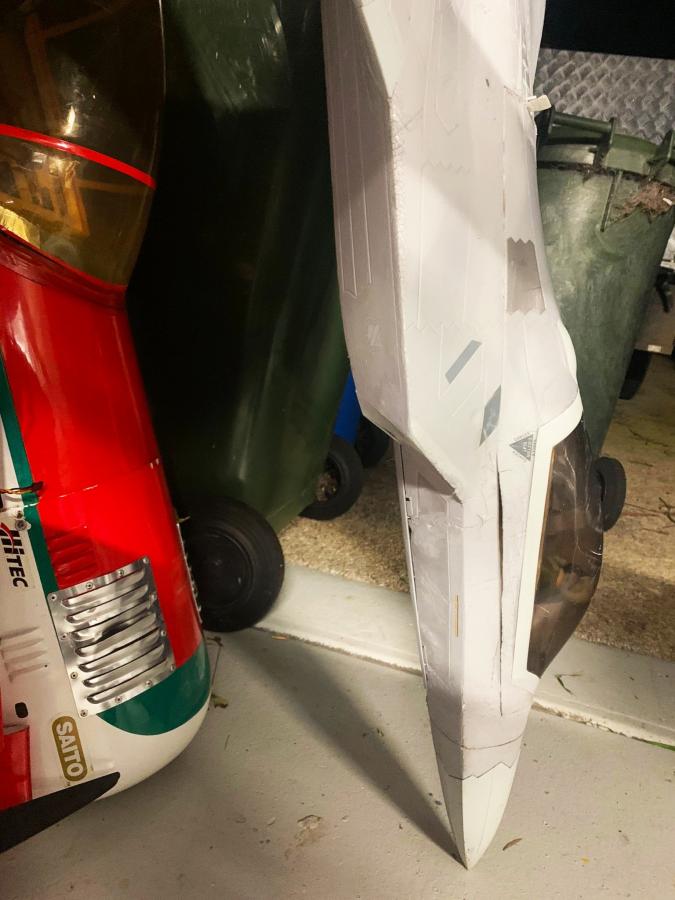

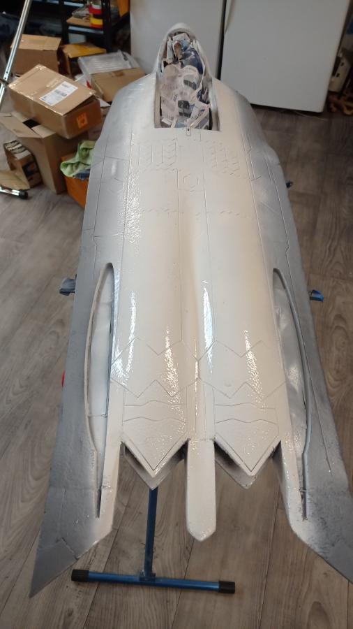

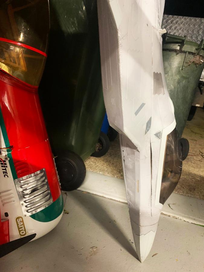

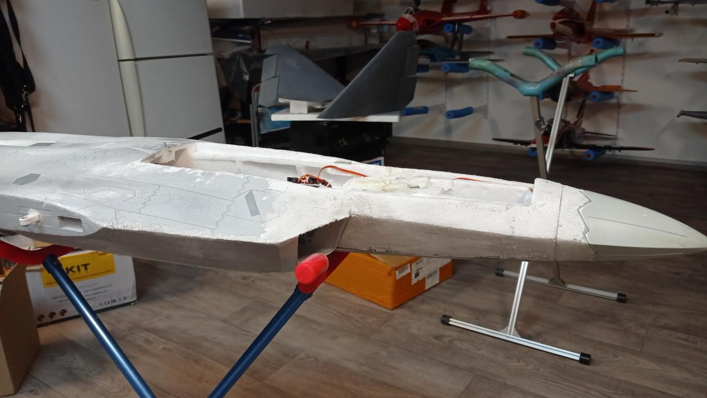

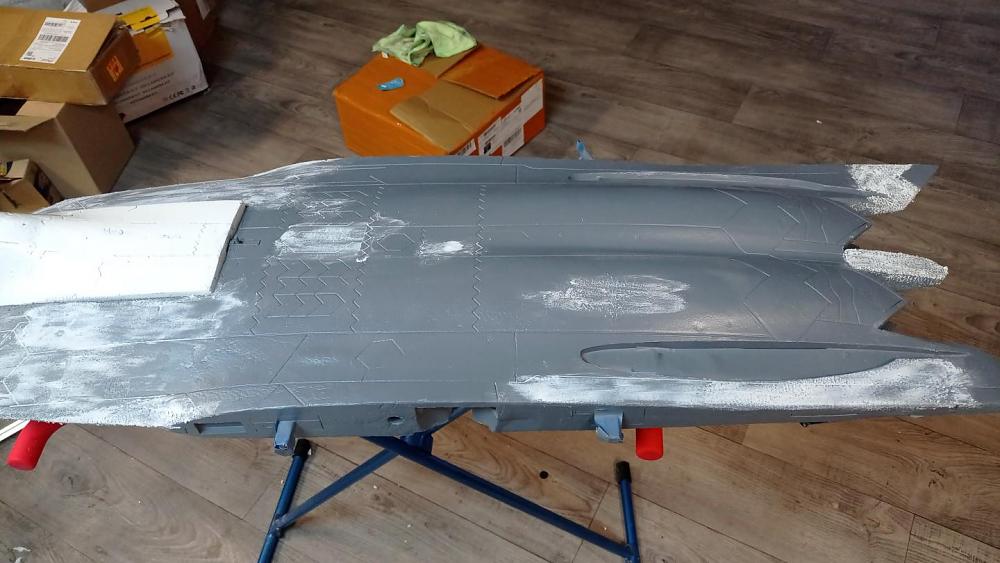

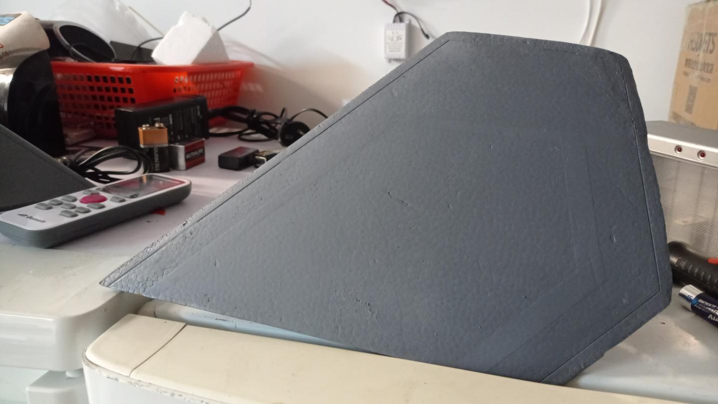

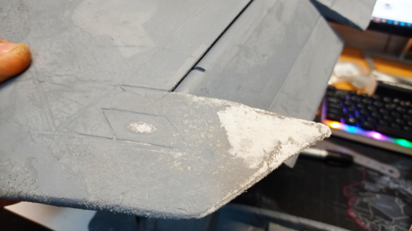

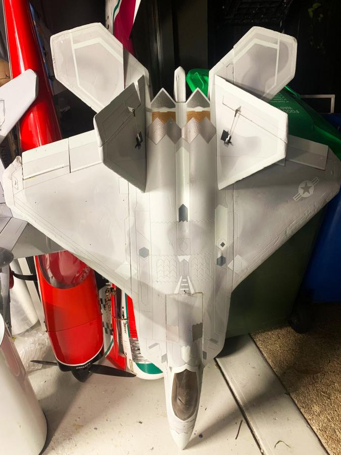

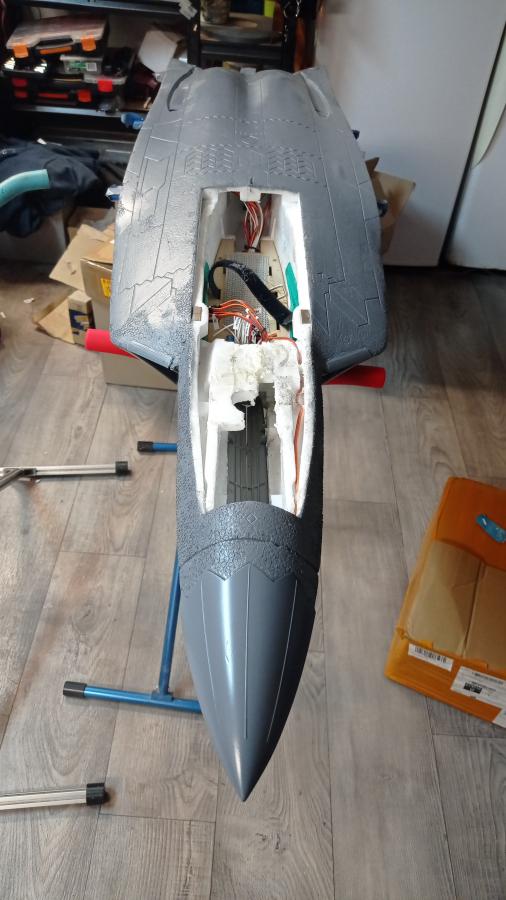

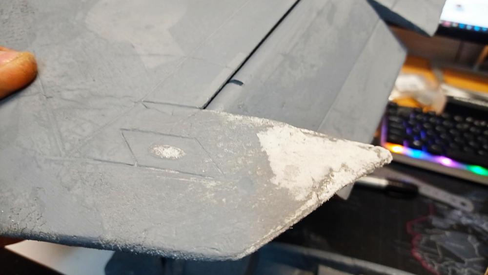

                                        Hi All Hope you are all well,
                                        I have done something a little different with my Freewing F22 Raptor,I know its not to scale but its my favorite scheme.
                                        I purchased this as an ARF kit it was a little beaten up so i decided to do it my style.
                                        Take a look any comments welcome.
                                        Click image for larger version  Name:	1625964162393.jpg Views:	0 Size:	81.8 KB ID:	318263Click image for larger version  Name:	1625964162404.jpg Views:	0 Size:	65.9 KB ID:	318264Click image for larger version  Name:	1625964162415.jpg Views:	0 Size:	76.6 KB ID:	318265Click image for larger version  Name:	1625964162381.jpg Views:	0 Size:	59.5 KB ID:	318266

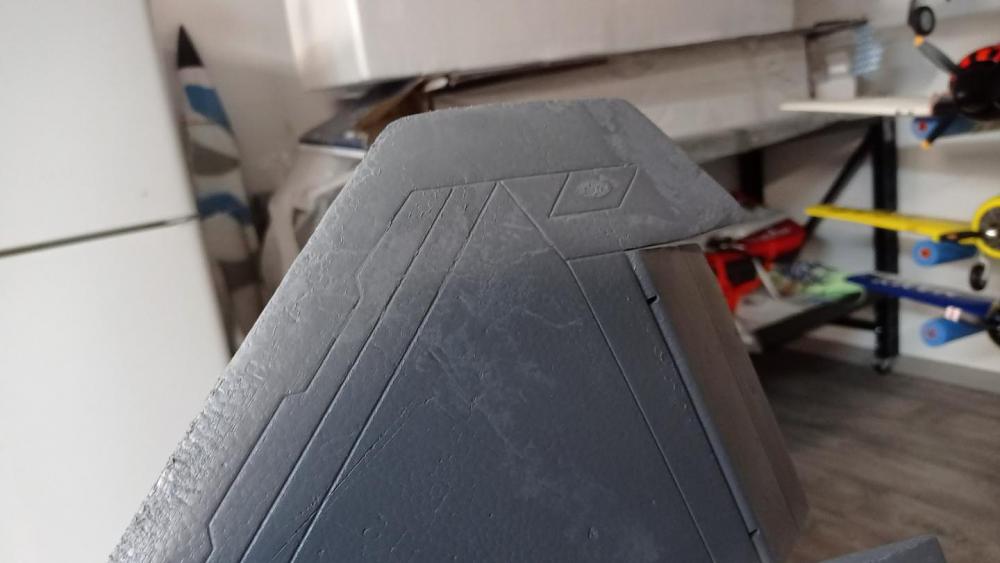

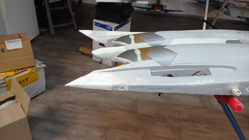

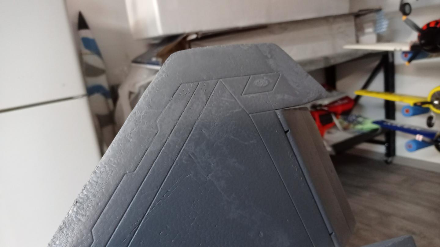

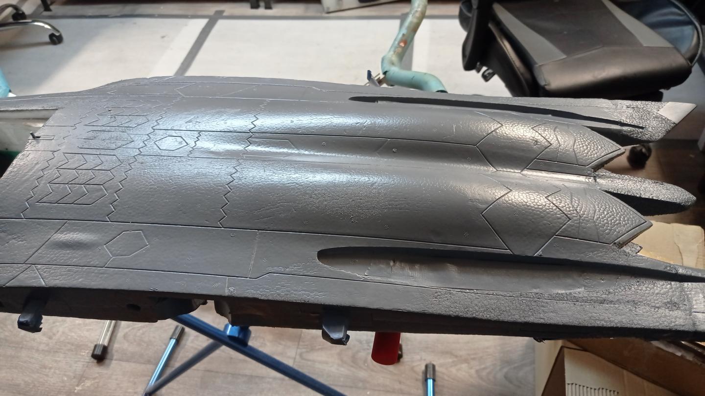

                                        This is the original condition before mods

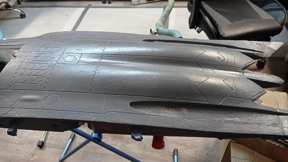

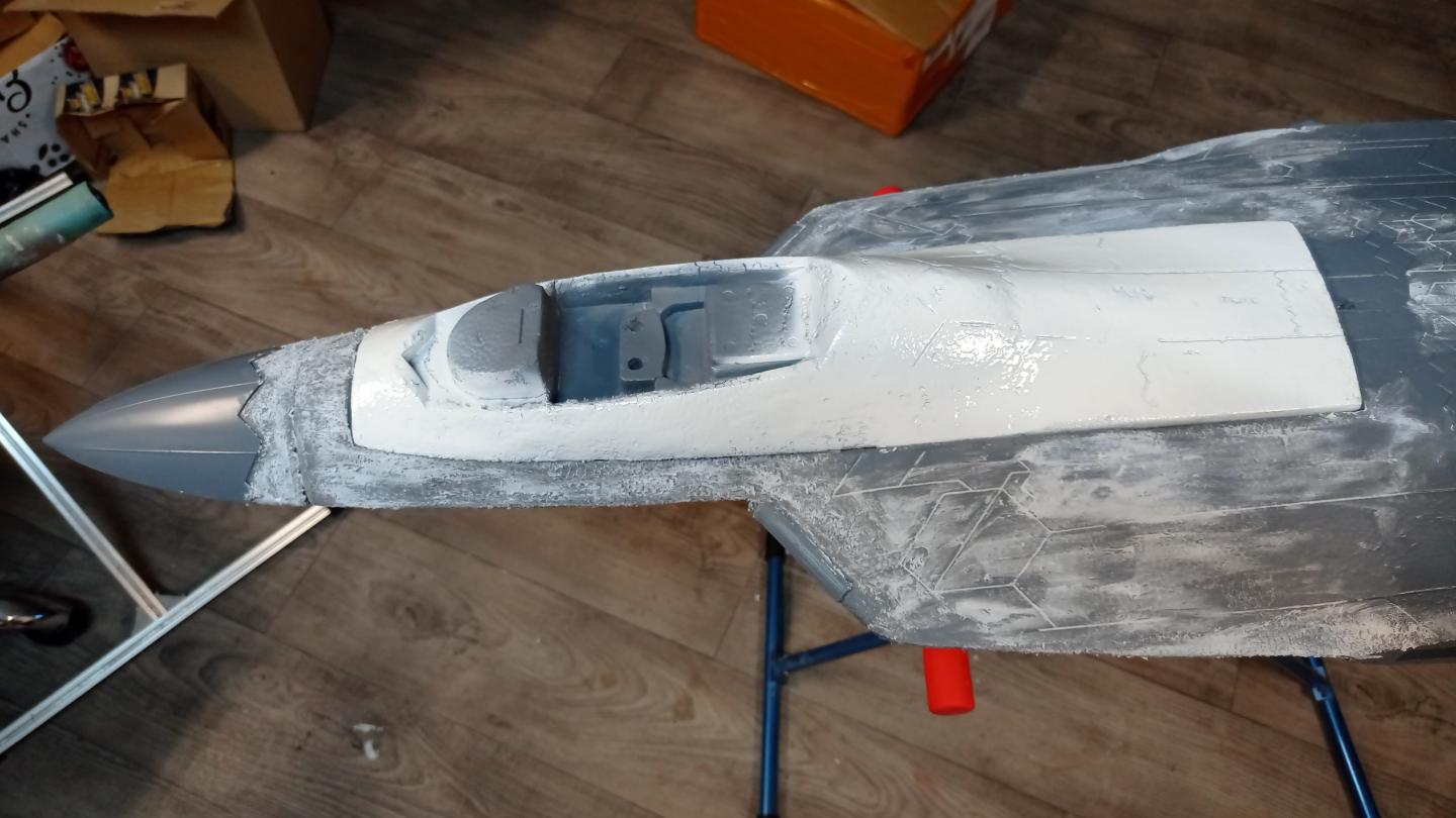

                                        Starting to repair.
                                        Click image for larger version  Name:	1625964313939.jpeg Views:	0 Size:	94.7 KB ID:	318267Click image for larger version  Name:	1625964313974.jpg Views:	0 Size:	78.3 KB ID:	318268Click image for larger version  Name:	1625964313955.jpeg Views:	0 Size:	103.2 KB ID:	318269 .

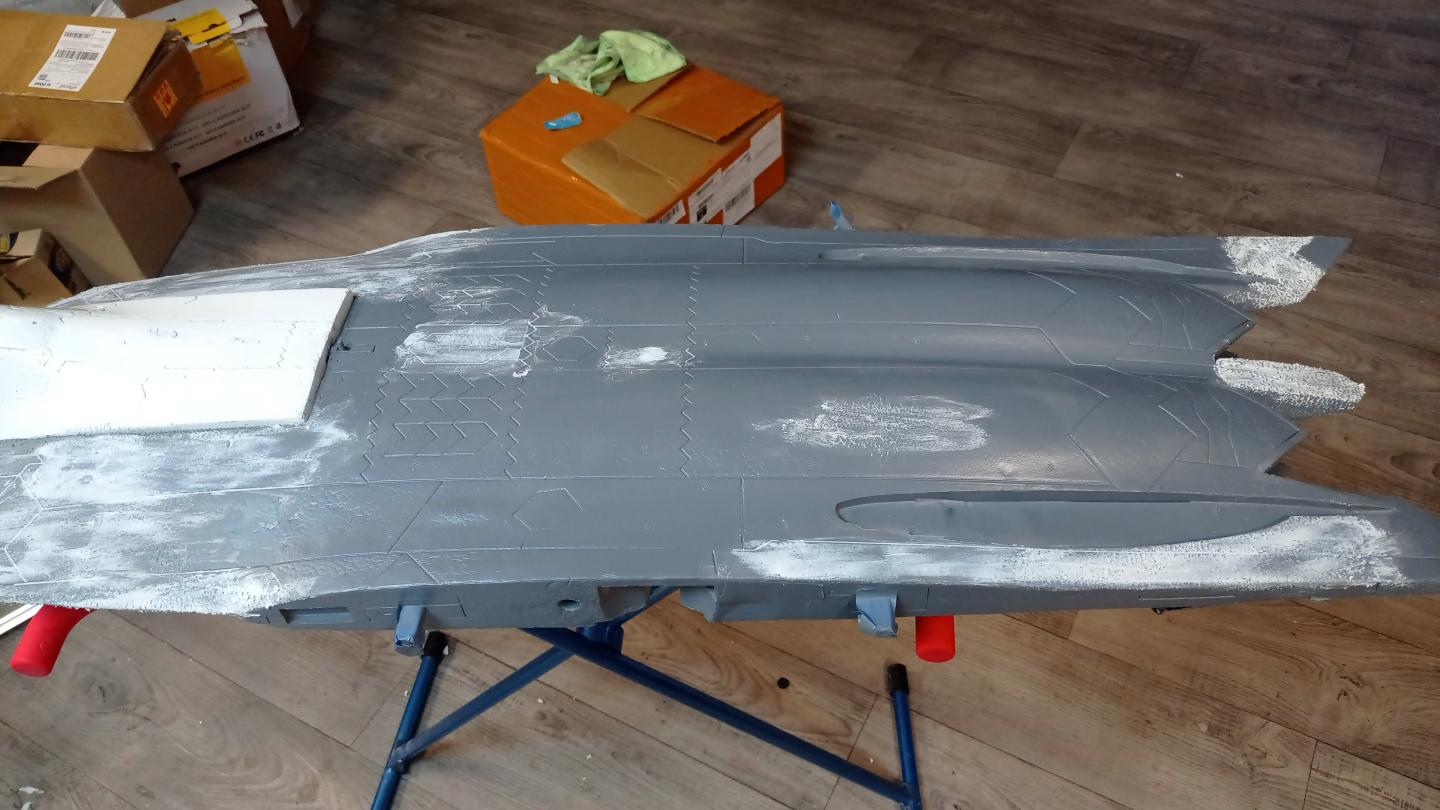

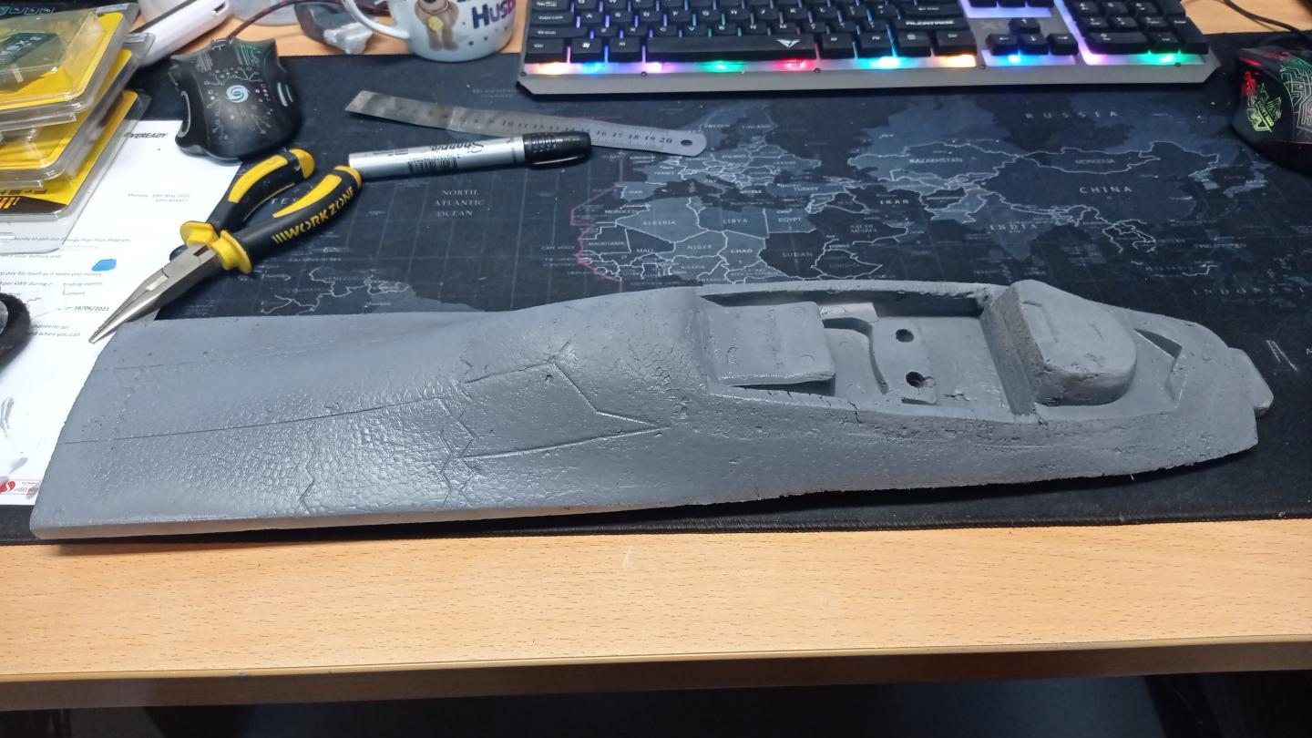

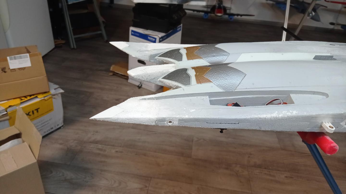

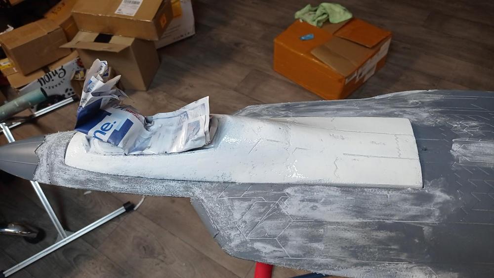

                                        After some repairs& Primer added did some more sanding Click image for larger version  Name:	1625964463469.jpeg Views:	0 Size:	123.3 KB ID:	318271Click image for larger version  Name:	1625964463404.jpeg Views:	0 Size:	113.1 KB ID:	318272
                                        Click image for larger version  Name:	1625964463449.jpeg Views:	0 Size:	129.6 KB ID:	318270
                                        Click image for larger version  Name:	1625964463426.jpeg Views:	0 Size:	142.0 KB ID:	318273
                                        Repairs and primer done..
                                        Click image for larger version  Name:	1625964463502.jpeg Views:	0 Size:	169.5 KB ID:	318274Click image for larger version  Name:	1625964463485.jpeg Views:	0 Size:	157.8 KB ID:	318275Click image for larger version  Name:	1625964463517(1).jpeg Views:	0 Size:	62.1 KB ID:	318276
                                        Click image for larger version  Name:	1625964253537(2).jpeg Views:	0 Size:	109.0 KB ID:	318279Click image for larger version  Name:	1625964253560(2).jpeg Views:	0 Size:	150.3 KB ID:	318280Click image for larger version  Name:	1625964253598(2).jpeg Views:	0 Size:	86.5 KB ID:	318281Click image for larger version  Name:	1625964253621(2).jpeg Views:	0 Size:	77.3 KB ID:	318282

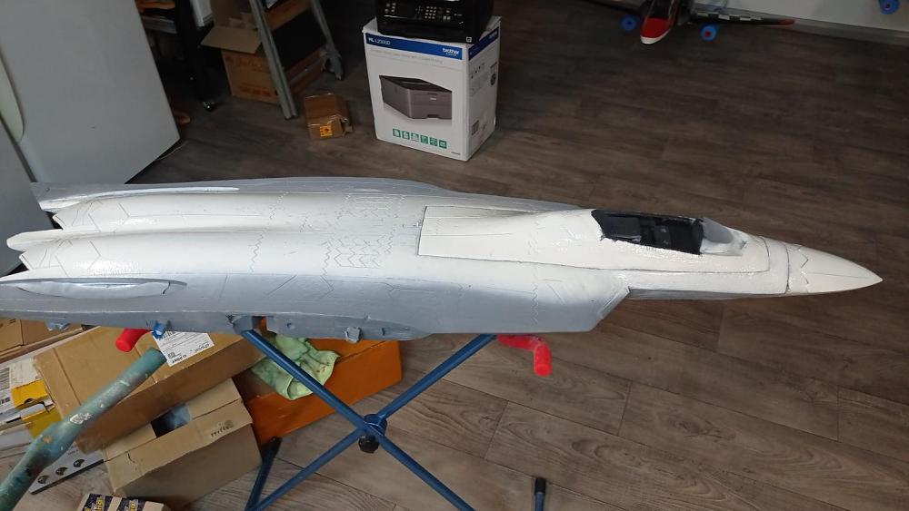

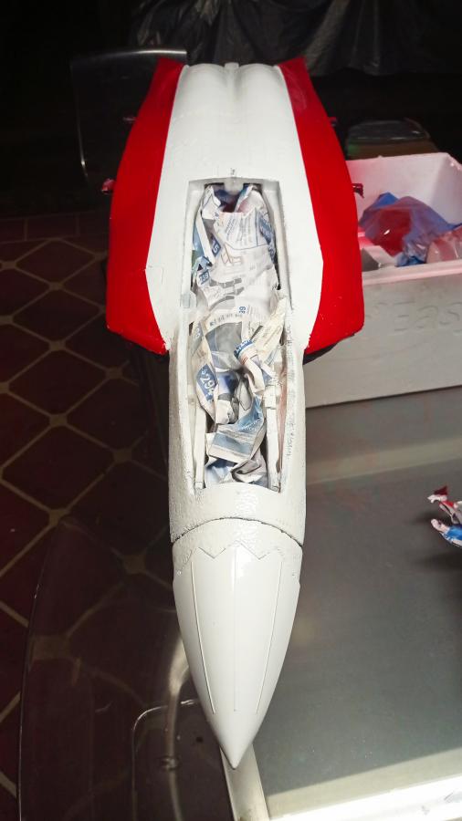

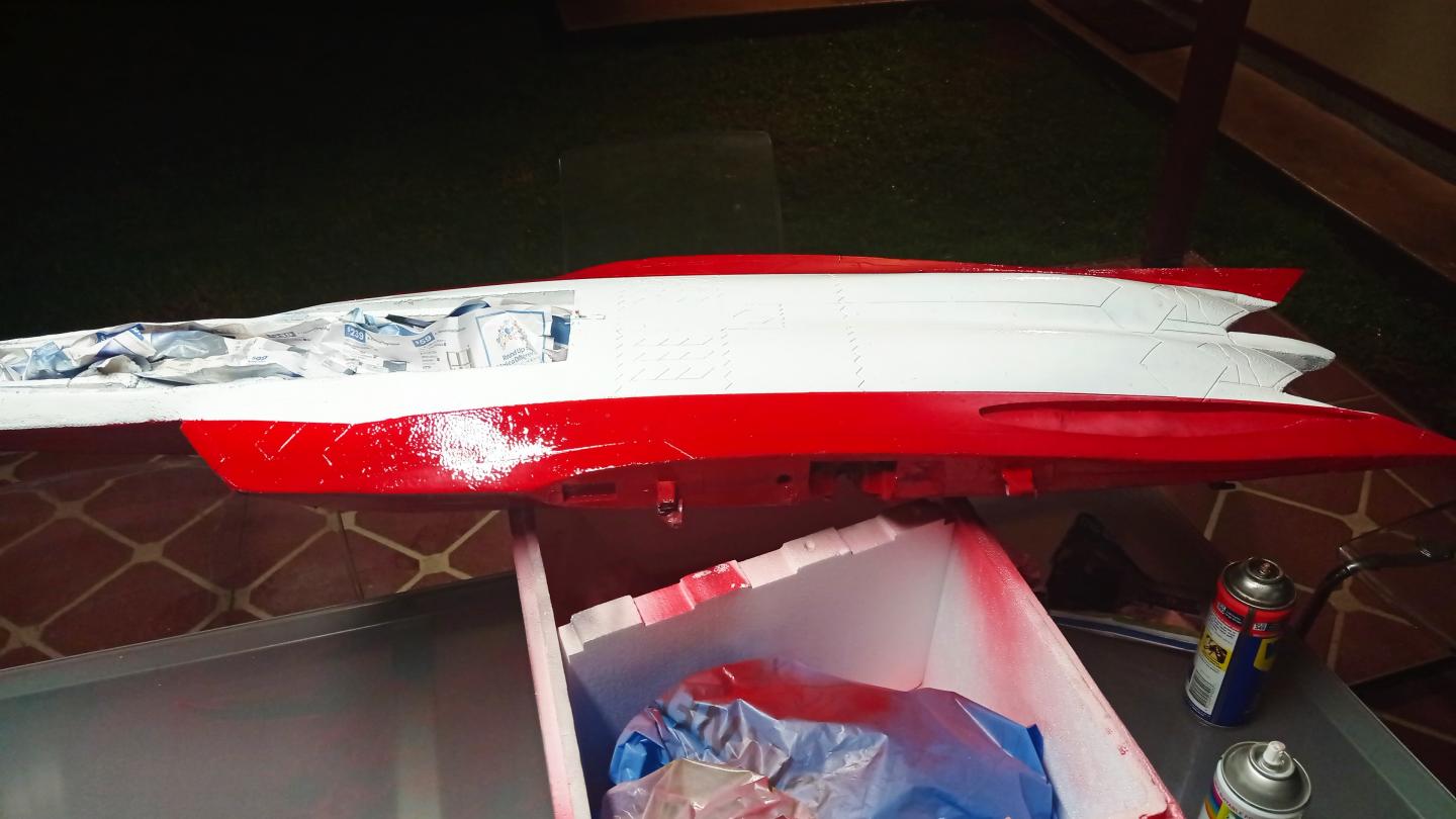

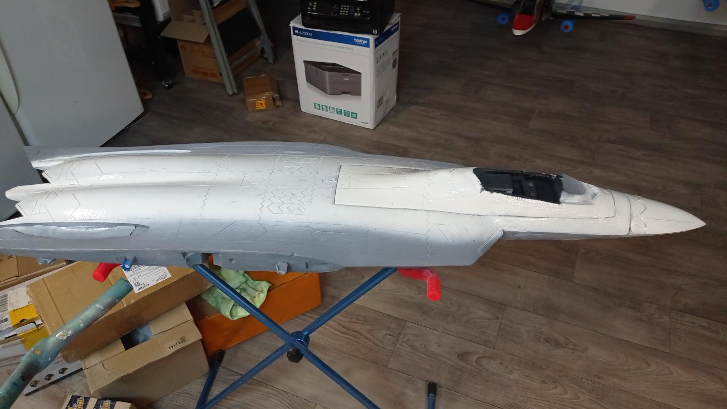

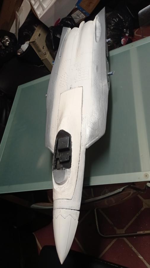

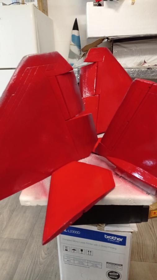

                                        Now for some white paint to start off the scheme.
                                        Click image for larger version  Name:	1625964463380(1).jpeg Views:	0 Size:	38.2 KB ID:	318278
                                        Click image for larger version  Name:	1625964463533(1).jpeg Views:	0 Size:	106.1 KB ID:	318277
                                        White pain completed now for some red.
                                        Next stem adding some decals.
                                        Continue?

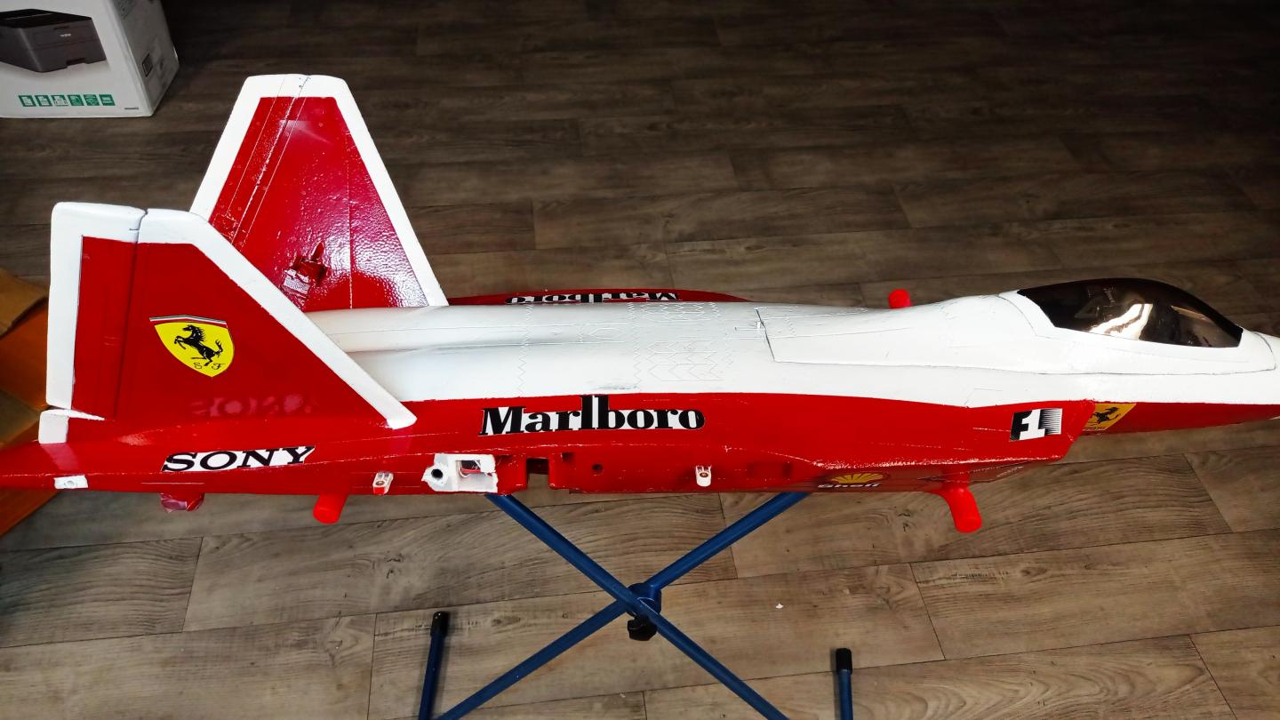

                                          Completed Build
