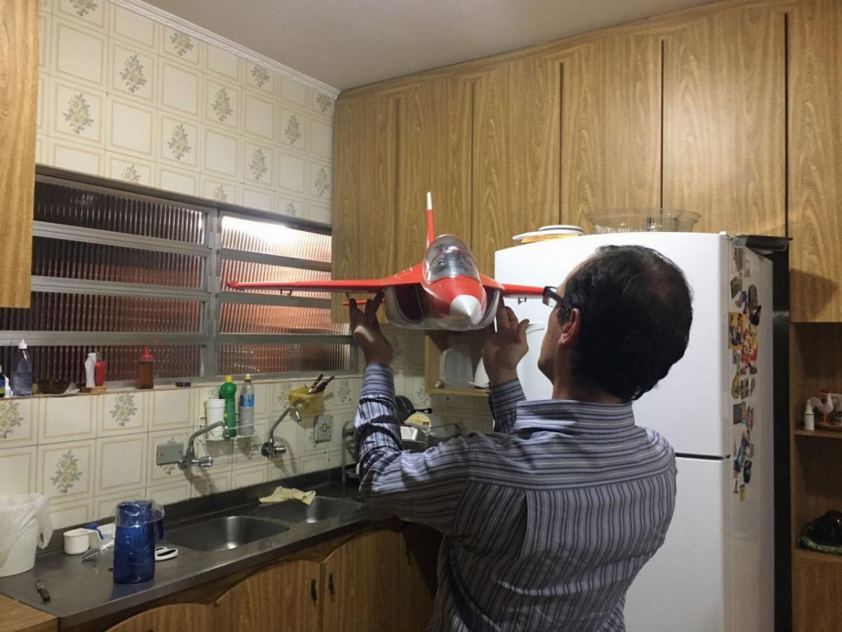

            Hey guys good afternoon!
            Just purchese my YAK :-)...very excited!
            Just one very important question please...i´m planning to use a GensAce 6s 5000mah 60C lipo on it (brand new battery)...question, will fit right ?....little concerned about.
            ​​​​​​​Thank you all

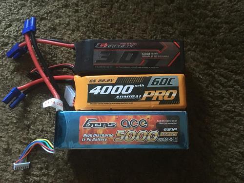

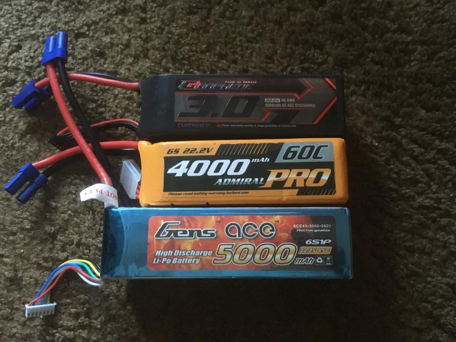

              • 8835
              #86
              It will likely "fit" but it may be hard to balance. This plane calls for 3000mah to 4000mah. My 3000mah Graphene is pushed as far back as it will go and it just balances and flies well. An Admiral 4000mah is only a bit heavier than the Graphene and also works. I also have the GensAce like you are planning to use. I've never tried it in the Yak. It will possibly be somewhat nose heavy unless you can gouge out some foam and push it back further. See the photo.

                  • 8835
                  #88
                  Dear friend Xviper2,
                  Thank you very much for your complete reply and comparison...it will help me a lot!
                  I´ll definitly go with 6s 3000...just will need to look if i can find 65C discharge...maybe only 45c. Do you thinkt its enough?
                  What about filght time you got with 3000? Much less than 4000?
                  It will be my first EDF, but i have more than 7 years of rc experience.
                  Safe flights!
                  The 3000 Graphene is very close in weight and size of the Admiral 4000mah (as in the picture). Flown in a similar manner, flight time is virtually the same since both seem to contain a similar amount of juice. Graphenes are known to be heavy for the same mah. That's why I always buy them a little smaller than other brands. The Graphene comes down warm while the Admiral comes down almost hot. I fly pretty hard with my Yak. If you fly with more throttle management, 45C should be OK. The other choice is the HobbyKing Turnigy Heavy Duty line of batteries. They perform similar to the Graphene and are slightly cheaper, but their overall lifespan (duty cycles) may be a little shorter. Don't "downsize" those if that's what you choose.

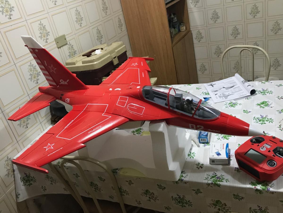

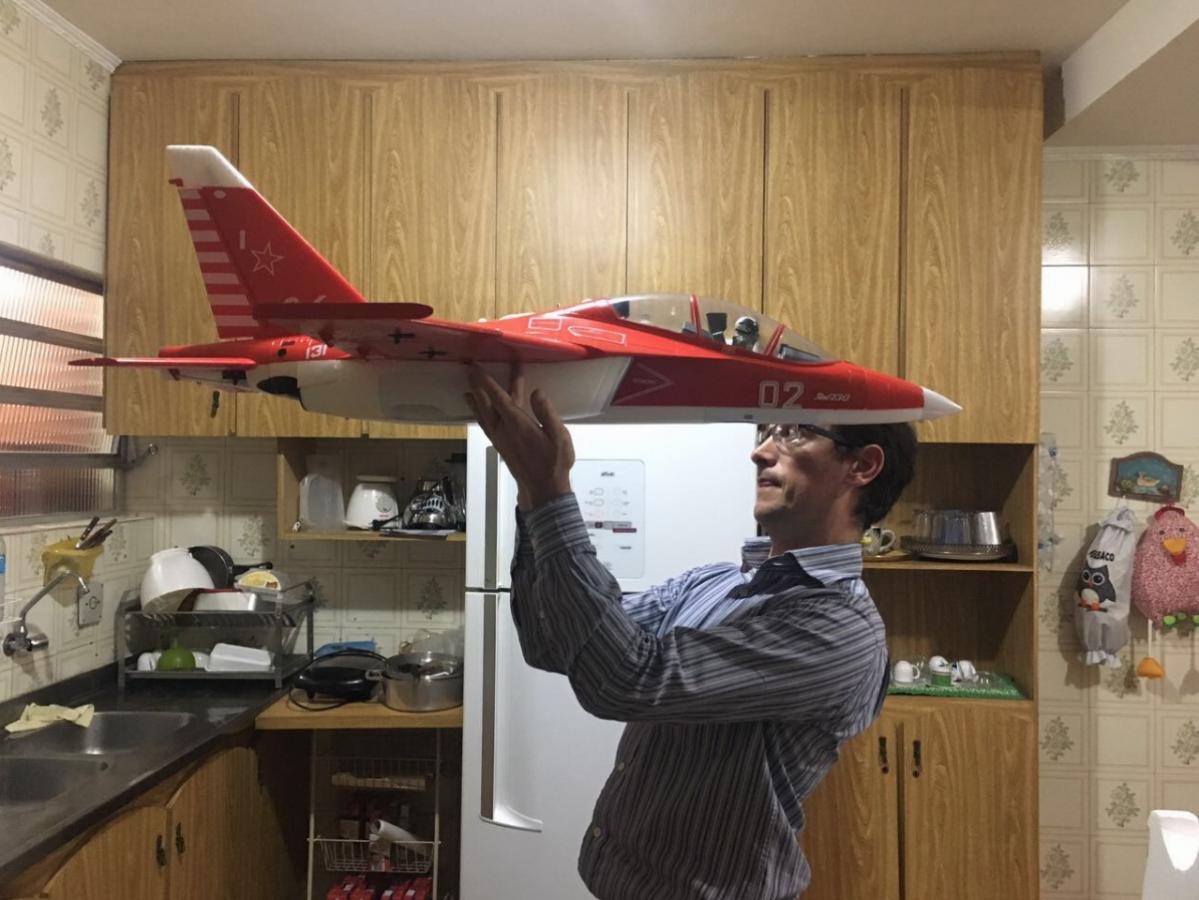

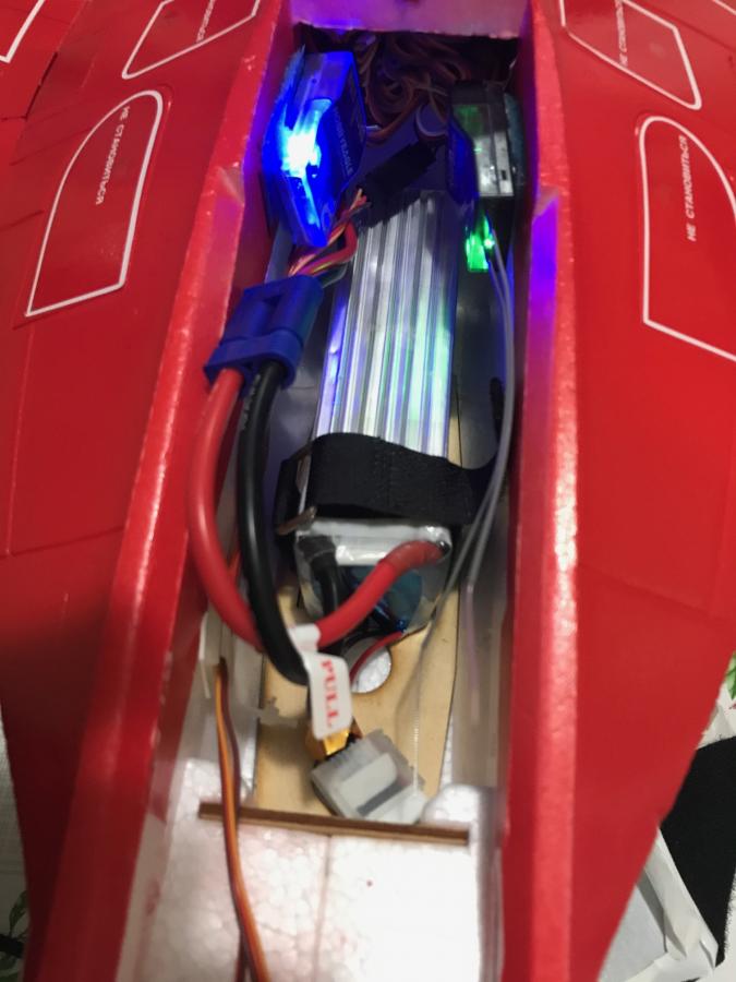

                        #91

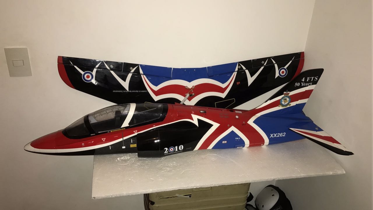

                        My Yak finally ready to the maiden next weekend.
                        Stock configuration + Gens Ace 62 3300 60C + A3L Gyro.
                        The CG seems good (3mm behind the trailing edge - forward wing mounting + battery full in the back), High/low rates as per manual + 3rd option more calm (3 position swich on my Futaba).
                        Must confess i´m little nervous about the maiden, considering that is my 1st EDF but as far as i researched this model is a good choice...Gyro off for the maiden (if everything goes well will be ON on 2nd flight to feel the difference).
