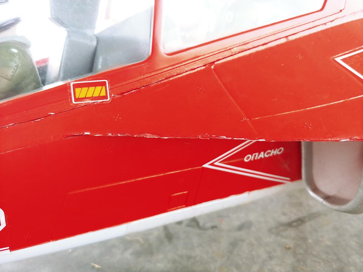

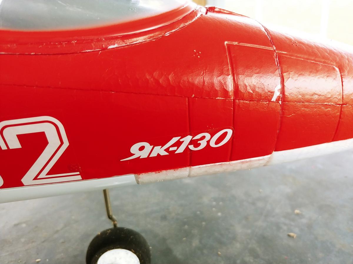

              Click image for larger version  Name:	IMG-20190928-WA0006.jpg Views:	0 Size:	197.3 KB ID:	214847
              Click image for larger version  Name:	IMG-20190928-WA0004.jpg Views:	0 Size:	154.1 KB ID:	214848
              Flew about eight batteries today; all 6S from 4000mah Compact Zippy, 4000mah HD Turnigy to 3600mah Turnigy.
              ​​​​​​The lighter battery makes it so easy to land, stays level and nice flare. Take off from the street and land on grass. Half flaps for take off, full flaps for landing. Its a heavy airplane, I wish it was sold without electronics, it needs a much better ESC and motor for the claimed upgrade, I cant imagine how the 4S version flies.
              Am not sure if it was the wind, but probably the wings are too flexy, and the plane had problems tracking on fast speed high to low altitude banking of it, bring it up high, turn, and sink the plane bringing it back.
              Contrary to others, the landing gear held up very well, it rained, so it was like velcro for the wheels. Had a few bunny hopping landings, and no landing gear failure.
              Even at full throttle, the jet felt heavy when doing loops, or half cuban eights. The Stinger is such a nimble toss around jet, it will do anything thrown at it.
              I wish the Yak had just a hair more power, the sound of the 12 blade fan, is where the money is, very realistic, blades came balanced, super quiet woosh sound. It has its pros and cons for a $200 jet.
              I have seen the FMS from RC Informer, and the FMS has a much better QC in finish, attention to detail. Mine arrived with assembly line packaging rash, and not even the maiden, and paint is peeling off.
              **one quick comment, for some reason when engaging half flaps the jet tends to lose altitude, pushes down significantly, instead of ballooning, never seen that before.

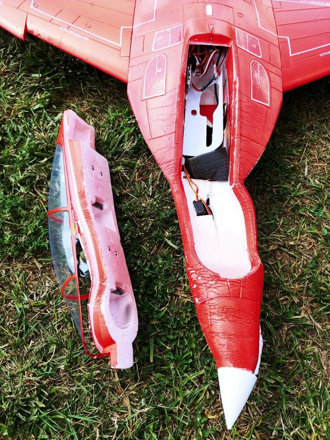

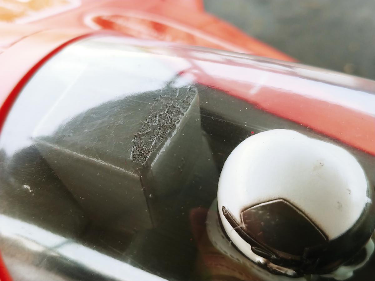

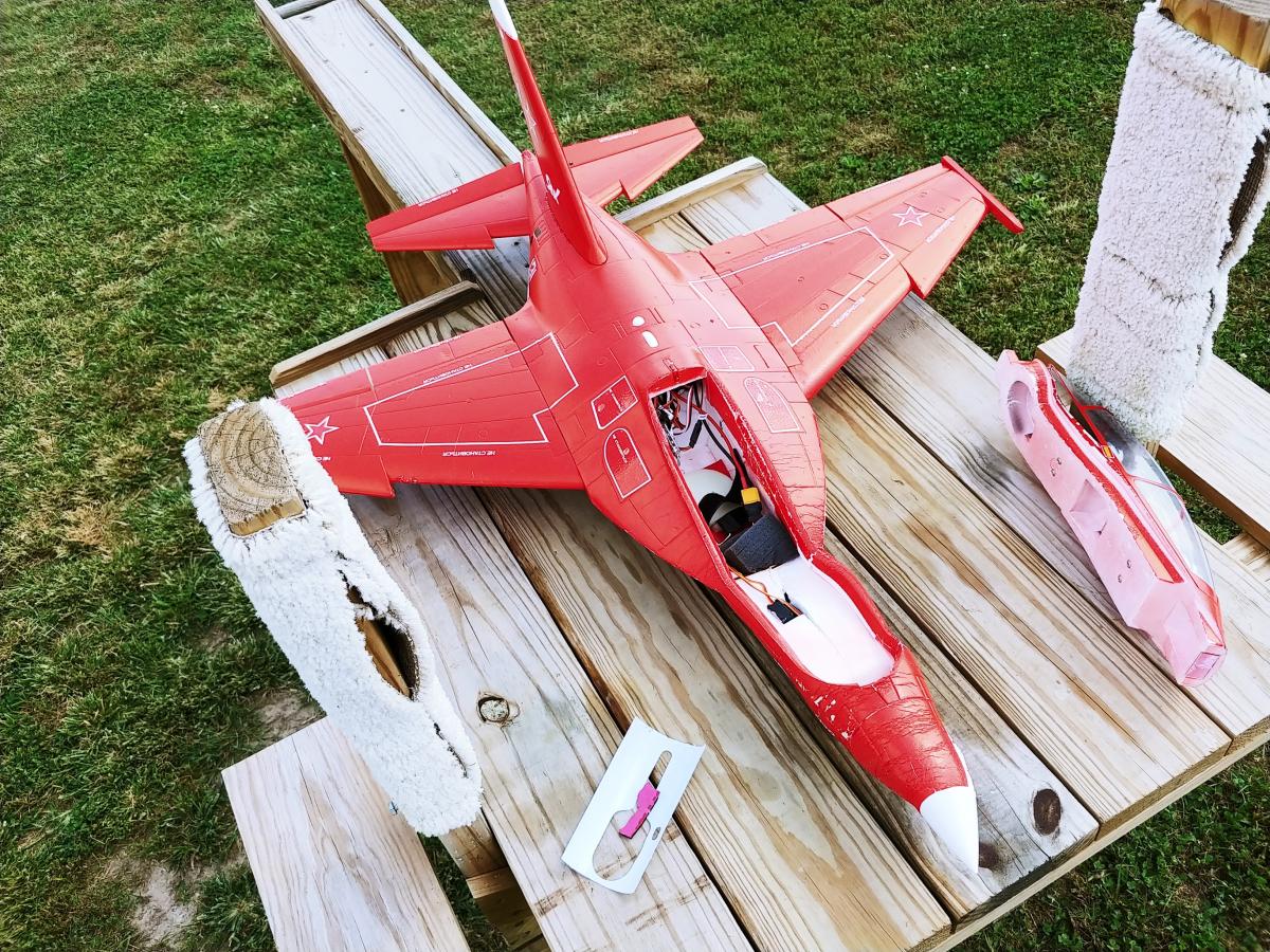

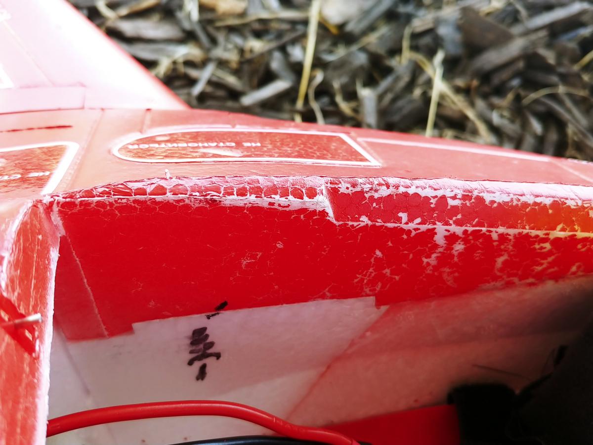

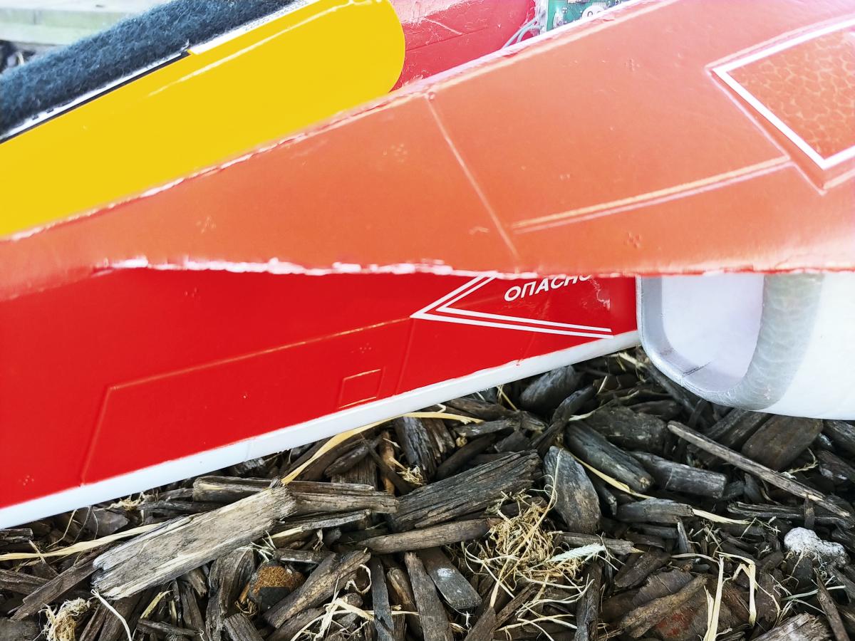

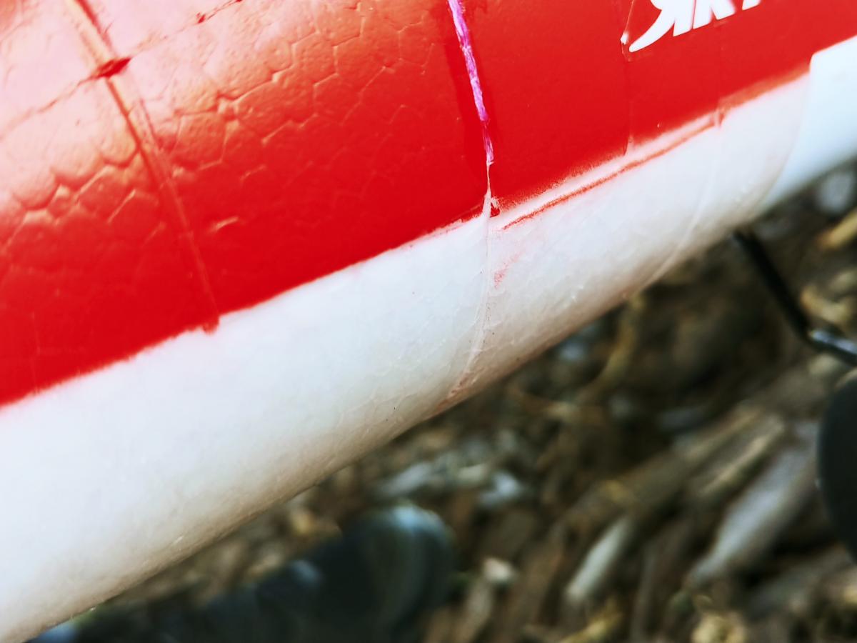

                Am completely devastated, 😢
                Was having wayyyy too much fun on 15mph. Am not sure if it was a stall or it lost signal, as once I walk to the crash site th rx was flashing red it has lost signal. Could have been from the impact or it was the cause of the crash.
                Its true once in a stall, low altitude there is not much I can do and will appear as not having signal as it spirals down into the soy fields.
                This jet, I dont know how others cant dial the landing, but I can almost land at walking pace or less, thats why am not sure if it was signal or not. Its amazing its flying envelope, motionrc Youtube video had mentioned the plane tends to have bad tendencies once in a while. I felt confident flying into the wind, w flaps, gliding it gaining altitude using elevator and then bringing it back to loop around. Click image for larger version

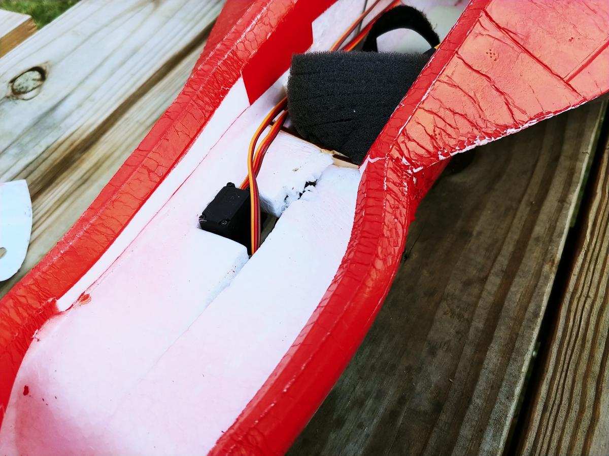

                  Its all glued all back together.
                  Click image for larger version  Name:	20190930_171314.jpg Views:	0 Size:	123.2 KB ID:	215092
                  Click image for larger version  Name:	IMG-20190930-WA0001.jpg Views:	0 Size:	182.9 KB ID:	215093 * a little rough on the edges, it flies well.
                  Click image for larger version  Name:	IMG-20190930-WA0002.jpg Views:	0 Size:	239.6 KB ID:	215094
                  I understand this site is motionrc, but have to say it, I should have shelled the 50 to 60 dollars more and bought the FMS V2; comes w better landing gear, all parts are attached, NO glue, inrunner motor, 80A esc.
                  Its an ok jet, anemic, I still prefer, at least for now, the 64mm Stinger, that one I can toss around and does everyrhing thrown at it.
                  Few minor things I did not like about FW PNP for having the label upgrade on it, 60A esc, sloppy paint job in the foam.

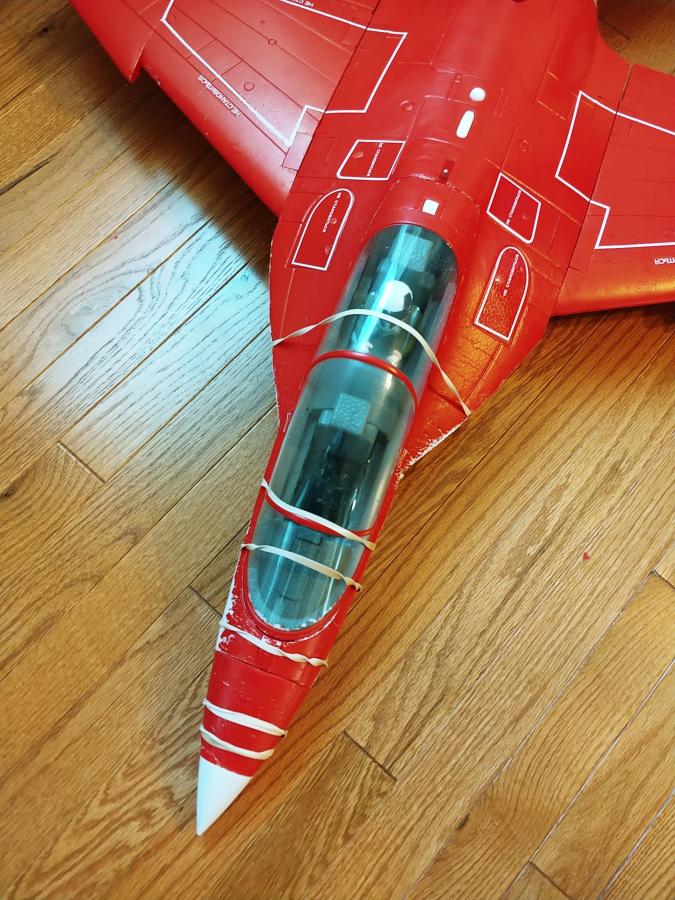

                    How didi you manage to fix this?
                    • MrVoyagerx
                      • Mar 2018
                      • 108

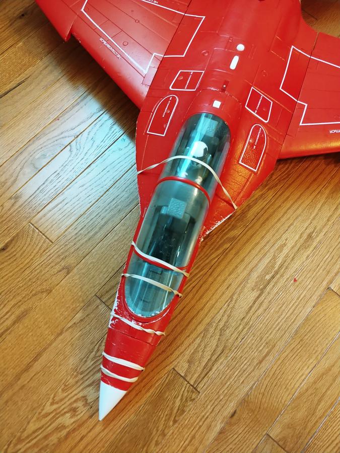

                      #110
                      I was about to throw the plane away when one of my friends gave me a pep talk to fix it and hands on I went.
                      The classic spa bath, a rubber maid or similar plastic tub, and a electric kettle. Bring some water to almost to boil in the stove on a big pot, plus the electric kettle. Dump it all in the plastic tub, and with a measuring cup start applying water consistently, but be cautious on the water temp, should be hot, but not scalding hot. You will know as the foam will pop up similar to an orange peel. This is where it becomes a black art and will sound kind of weird, lol, touch the foam and will get soft, start massaging it, do not force it, take your time. I gave it a break in between baths and sections, the key is to pour water continuously, heat water, electric kettle, repeat the process, and again to another bath, as you go along, the foam will start to give in, and start applying more force when massaging it. The foam WILL retain its memory, use foam tac or similar medium strength glue on the first stage when starting to glue, and hold with rubber bands. Measure the main fuselage tip with the wing tips that it is equal, if not, a little more hot bath, and keep applying more force. Let the fuselage cool off with foam tac (no hot glue yet), as its cooling off, push in any gator or orange peel skin. On the next day, I re-measured, everything seemed to be in place. There was still some foam a little off, so I pushed it back to where it should be, and then use hot glue to trim the edges, and with lines all along the inner and outer connection points, and the landing gear area, not too much, just enough. I did not let go until the hot glue cooled off.
                      There is some surface wrinkle still visible, but nothing too bad, probably with light Dollar Tree filler could make it look perfect. I decided to go fly it, it did not affect CG, I was very cautious on not using too much foam tac and hot glue. The jet tracks well, does roll, loops, snap rolls, the basic acrobatics with no issue. Did the cheater hole mod and swapped to a 80A ESC I had in my parts bin. Because its already scarred as I call it, I fly it like I stole it, and it does very well with the upgraded ESC and cheater hole, that 60A is a joke, it over cooks after about a minute of hard flying, with the 80A is consistent power the complete battery. Let me take back the CG, I removed one of the pilots, of course the one farther out, the first one of the two. Am probably gonna take the other one as well and paint the interior of the clear plastic black. This is one heavy jet, and every gram one can save is money.

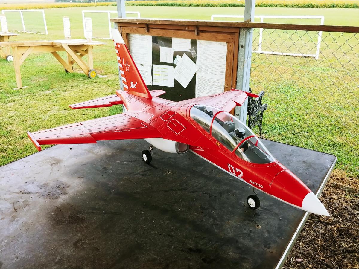

                            #113
                            The jet has this weird wiggle dance at low to half speed, the front landing gear is giving me trouble when retrieved, keeps doing a nasty wheel turn clipping in the outer plastic cover. I cut some of the plastic, but keeps pulling out and clipping every now and then.
                            Although the elongated tip is a trademark, it lands on grass and is not the most perfect, so once here and there it flops over etc and the tip outer spear clips on the grass tearing slightly the tip wing. Got fed up and cut it, one thing I noticed, the low speed wiggle has minimized significantly and feels that it tracks better.
                            This jet is on the heavy side and flying it w some wind is a must and lots of fun. The battery needs to be secured well or it will have bad tendencies on loops and harsh banking. Its my first jet w retracts and first on the 70mm line, all before are hand launched and 64mm.
