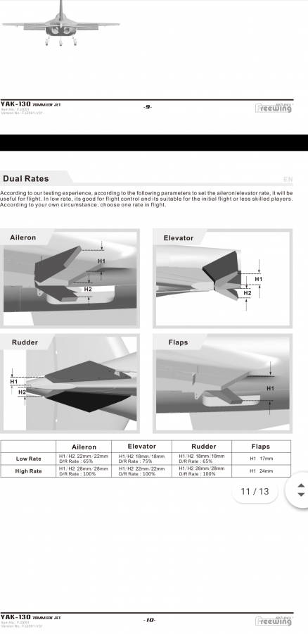

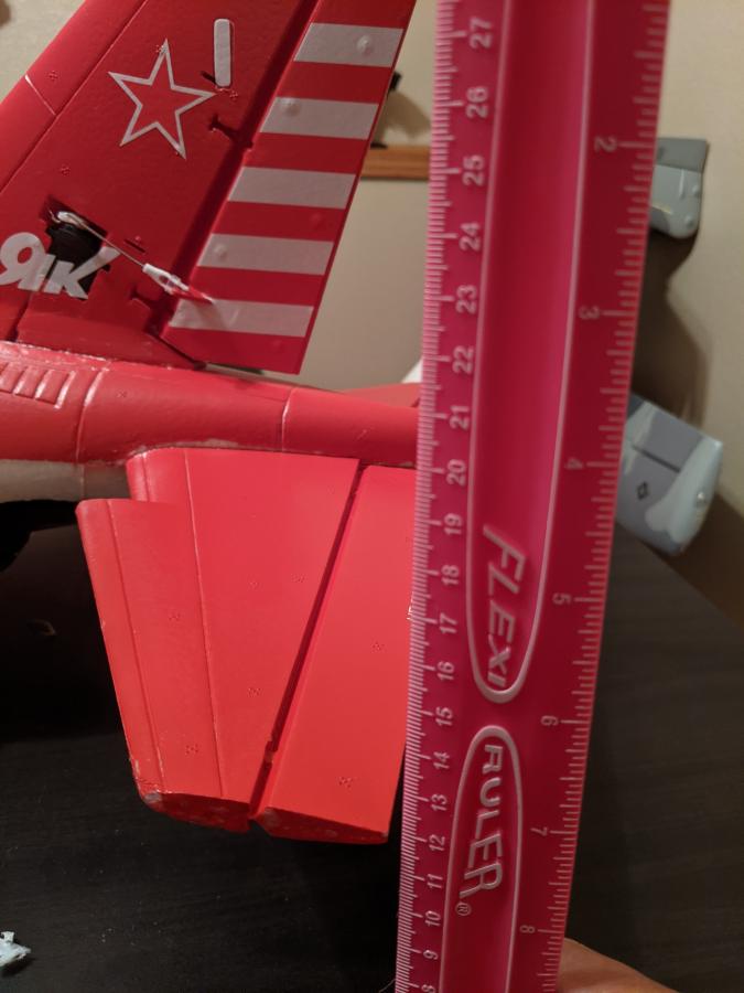

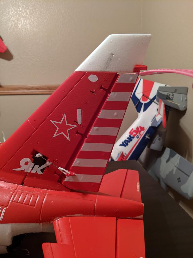

ID:	313570 Need some Help with the elevator and rudder deflection setup.
            As per the book the deflection on the elevator and rudder is to be measured on the smallest section of the control surfaces. I cannot get to the mentioned numbers even with 125% rates. but its right on if I Measure it at the Widest section of the control surface.
            Should I Ignore the Images in the book and set it up the throws measuring at the widest section of the elevator and rudder ?
            Any suggestions for a good starting point for expos ?
            Thanks Click image for larger version

              1. Ignore where it shows you to measure from in the pictures. Those are only for reference. Measure from the biggest (widest) part of the control surface.
              2. The plane will never need full deflection. This thing will roll like a corkscrew on much less than max throw. It'll also do loops tighter than you dare (stall) on max throw on ELE - no need for that much. Same for rudder. You'll never need to yaw that severely, even in a really bad crosswind. Even for ground steering, max throw will likely tip it over in a tight turn.
              3. Expo is a personal preference. What works for others may not work for you. Start low and work up (or not). 0%, 10%, 15% .......................... 50%. I've known guys who have dialed in 100% while others don't use it at all.

                Perfect, I have deflections set as per the widest section.
                On expos I will start where I left my eflite viper Hopefully Maiden soon.
                Thanks again

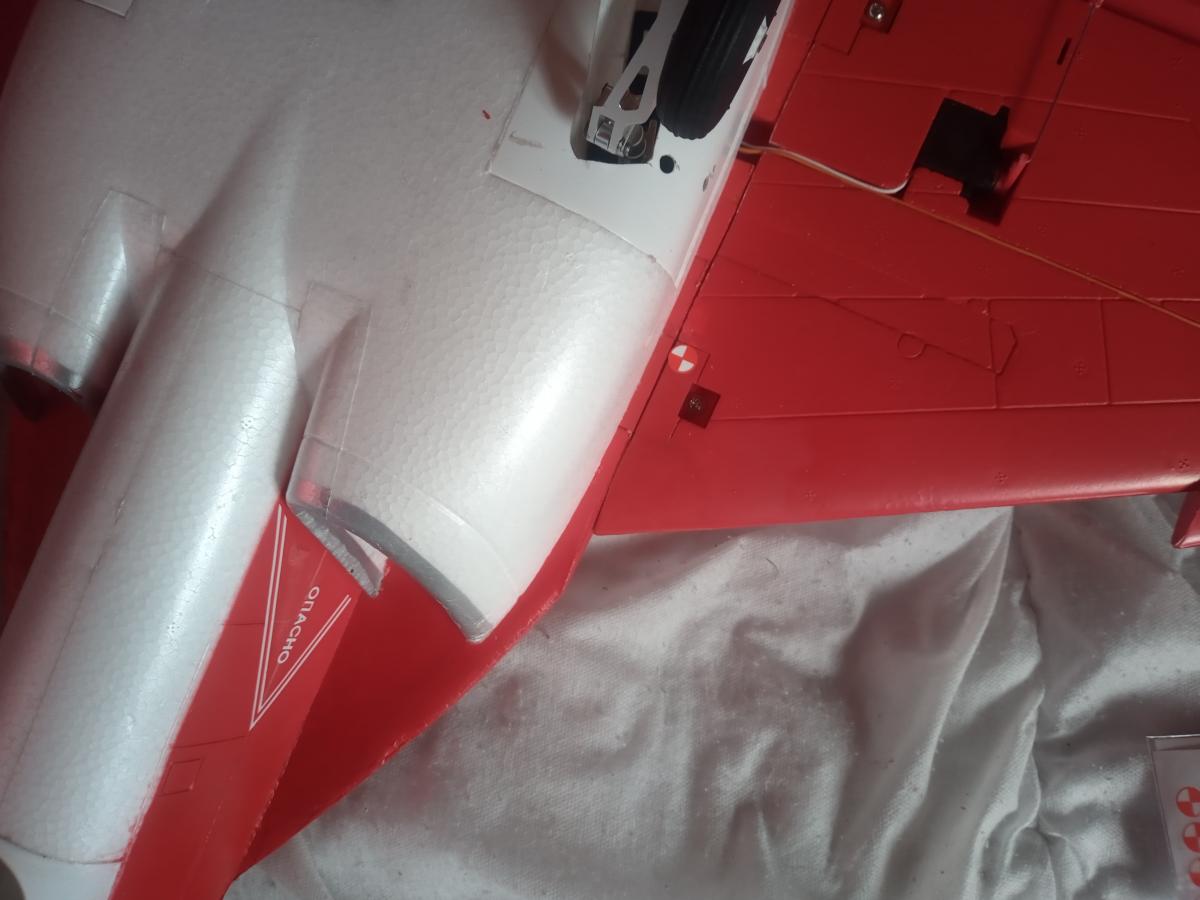

                                aamz 13 I dont use gyro but found that a cg of 70mm ( gear up ) helps reduce wing rock/yaw and is better than the 80mm back cg. The video above in post 154 shows flight with 2700 6s 40c battery at this cg, no gyro. Most of the flight is at half throttle, the faster you go the less wing rock you get. Flight time 3.5mins lipo 35% left. 3300mah 40c gives me 4 minutes of mixed flying
                                Click image for larger version  Name:	IMG_20210606_171536_542[1].jpg Views:	0 Size:	77.5 KB ID:	315239

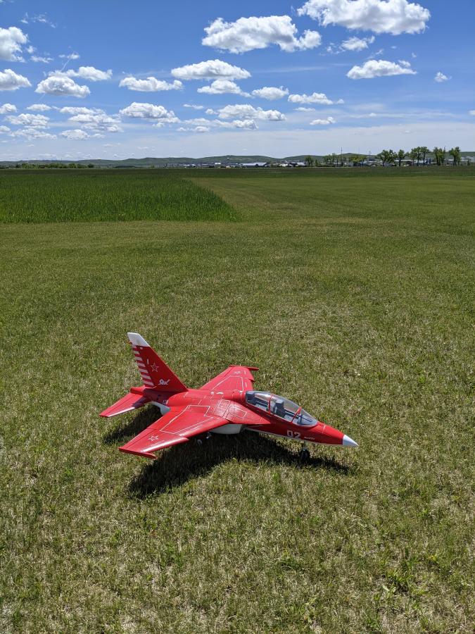

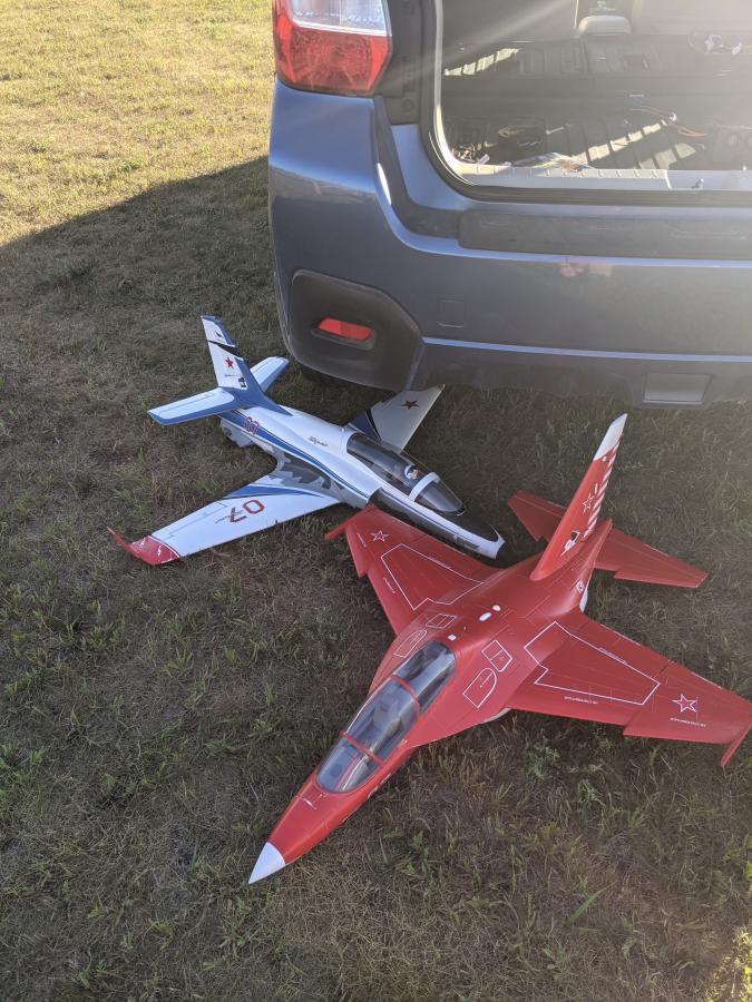

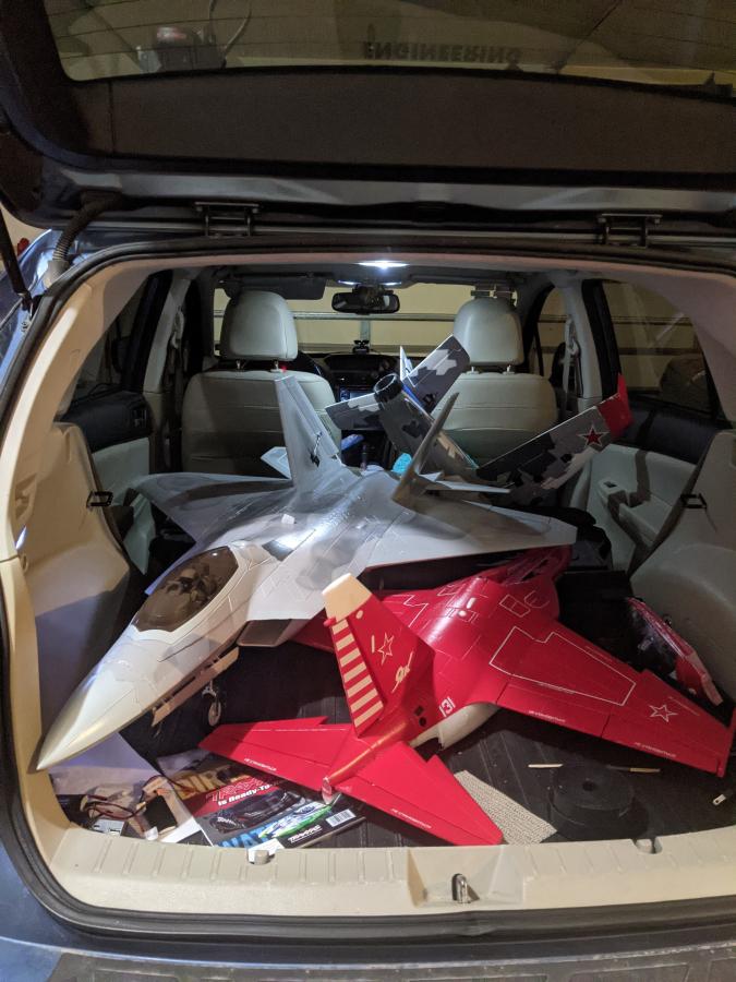

                                  Finally got around to maiden it on the 4th of July weekend. Its a beauty to fly. Key is to keep it close as it gets too far out pretty quick. Snappy and fun to play around with. I enjoyed tossing it around and getting in and out of vertical stalls. got the perfect CG as per the book with 4000MAH 6S Admiral Packs. I did end up gutting out the pilots to get the CG. The CNC suspensions are great. the do have a tendency to collapse completely sending the plane in to a shape turn. I might end up beefing the springs inside. to address the issue. No issues if I keep tracking straight after landing.
                                  the landings were pretty basic and uneventful. I was surprised on how slow I can bring it in and gently set it down. its tiny but can easily handle a lot of wind. does get tossed around a but but punches through most of it. Click image for larger version
