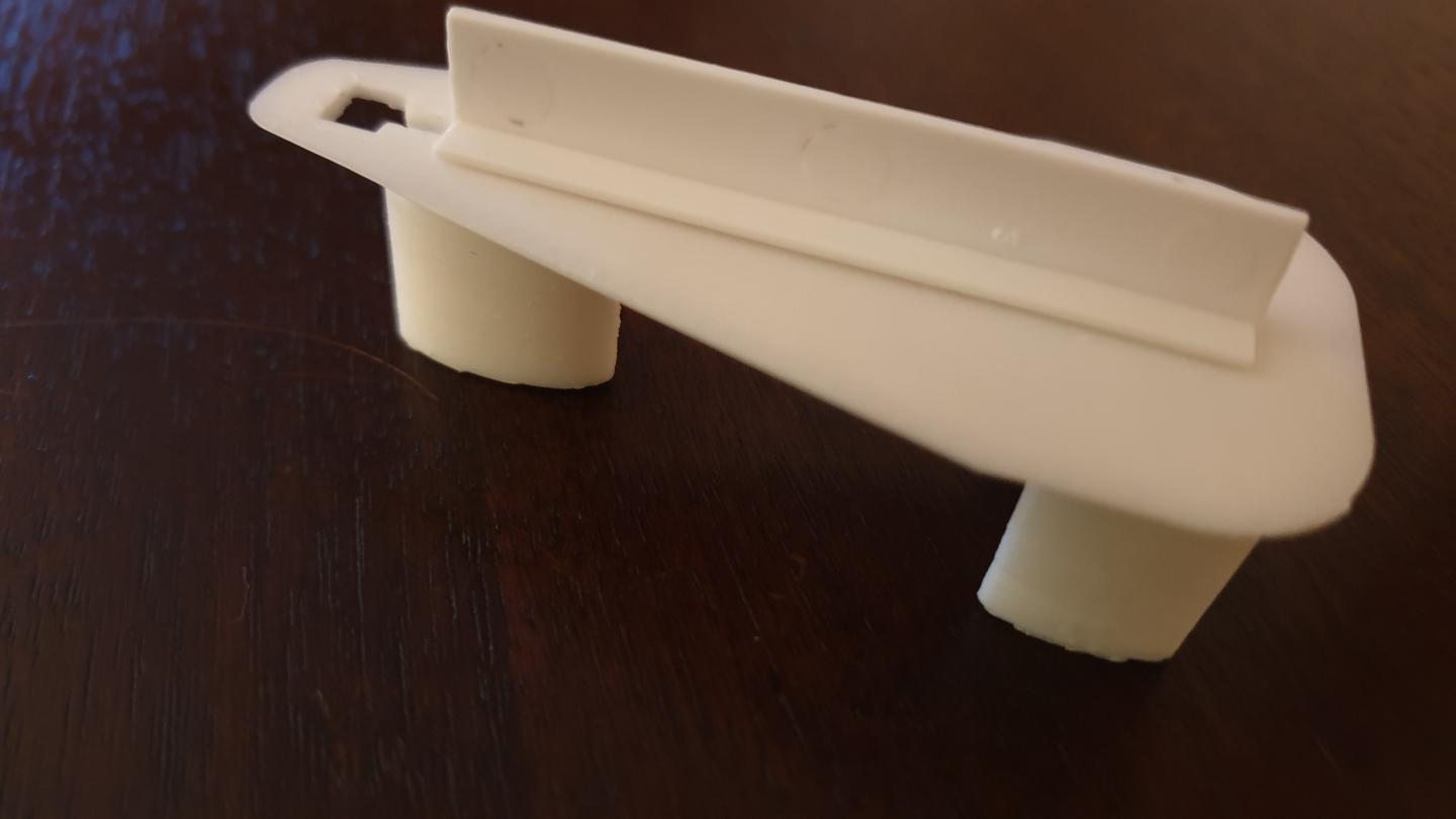

          Originally posted by patrick verlinden
          I redesigned the fuel tank attachment for direct fit with the Freewing 90mm EDF weapon attachment. STL file in attachment.Click image for larger version Name:	20190926_191412.jpg Views:	0 Size:	48.7 KB ID:	214593
          Do you have the file for this attach point? It doesn't seem to be in the download. Thanks.
          VR
              VR
              There are several versions on Thingiverse that might work if he doesn't have one for you
              • Vintage Racer
                Vintage Man, Vintage Car
                • May 2019
                • 186
                • Sucramento, Ka
                #507
                Thanks I did come up with one. It the Freewing 90MM system which I found without issue.
                VR
