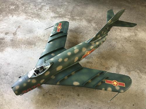

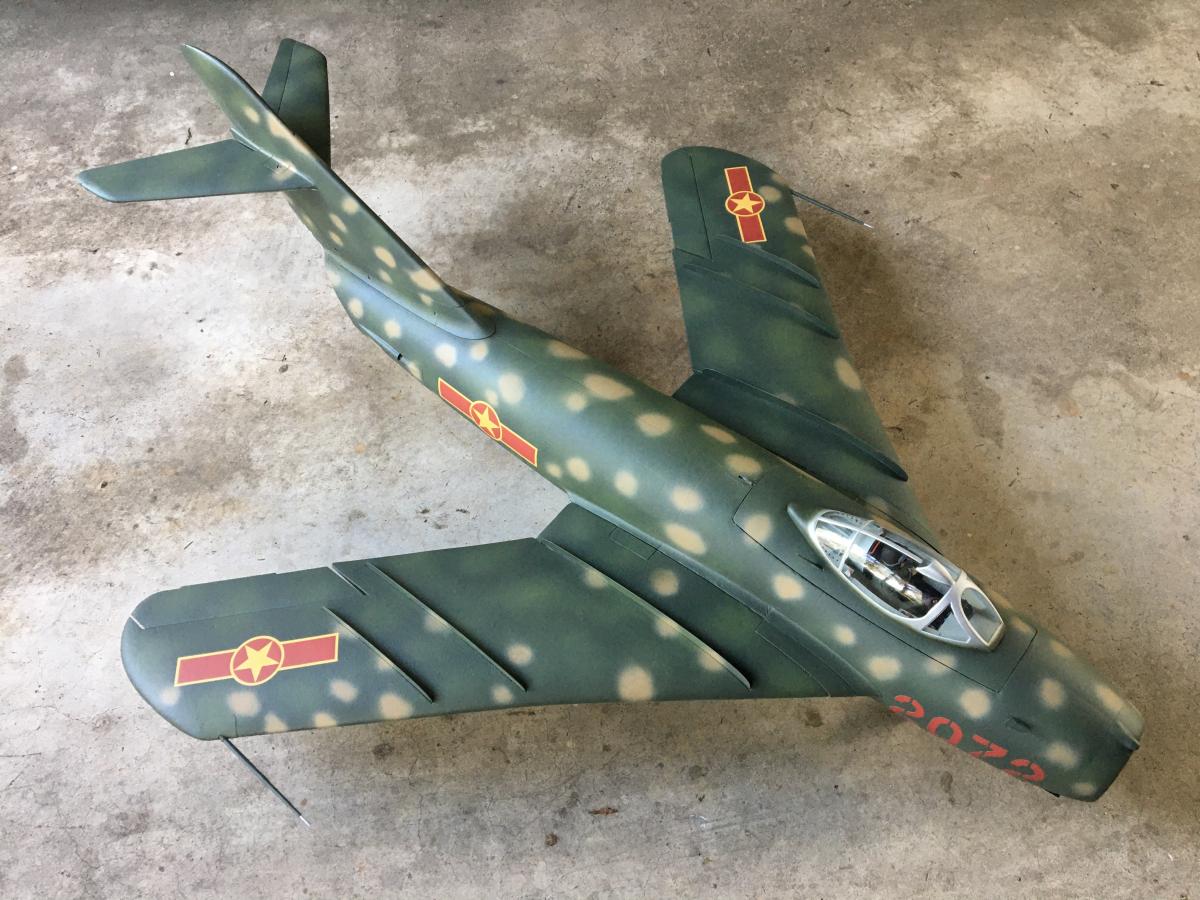

                Happy to see a thread on the Avios Mig-17 over here on HS. I'm "done" with the thread on RCG -- every second or third post is from the same jack*** (yes, I mean that) who posts his new videos flying his Mig irresponsibly (the way that is causing, and will continue to cause, all kinds of issues by the FAA for law-abiding AMA member flyers).
                That said, here's my Mig 17. I replaced all the servos with Freewing hybrid metal gear. The inner doors worked -- until they became intermittent and I decided not to fool with them any longer, as I could barely tell if the wheels were covered or not in flight. All wheels are Freewing replacements (F-4 Phantom). 3D printed cockpit and pilot. New color scheme -- BEHR flat latex uppers, Testors silver (spray can) lowers. I did my own grahics in CorelDraw, printed out for me, as always, by Callie. My pitot tubes are partly 3D printed (tips and wing-nubs) with plastic straw in-between, in case they snag.
                My latest lipo is the one suggested by The RC Geek -- Roaring Top, 6s, 6250mAh. So far I'm very impressed. Vertical is virtually unlimited (when it gets too high to see, that's high enough, right?).

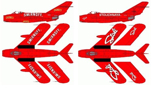

                          If I was going to do a civil version, I have long admired the Stoli showplane. In fact, years ago I started doing the graphics for it -- for a day or two I'd thought about faking that scheme on the UMX Mig 15.

                              Thanks Apha! Hey, how's the 1700mm Mosquito coming along (heh heh).
                              If I ever do another Avios Mig, it'd have to be this scheme!

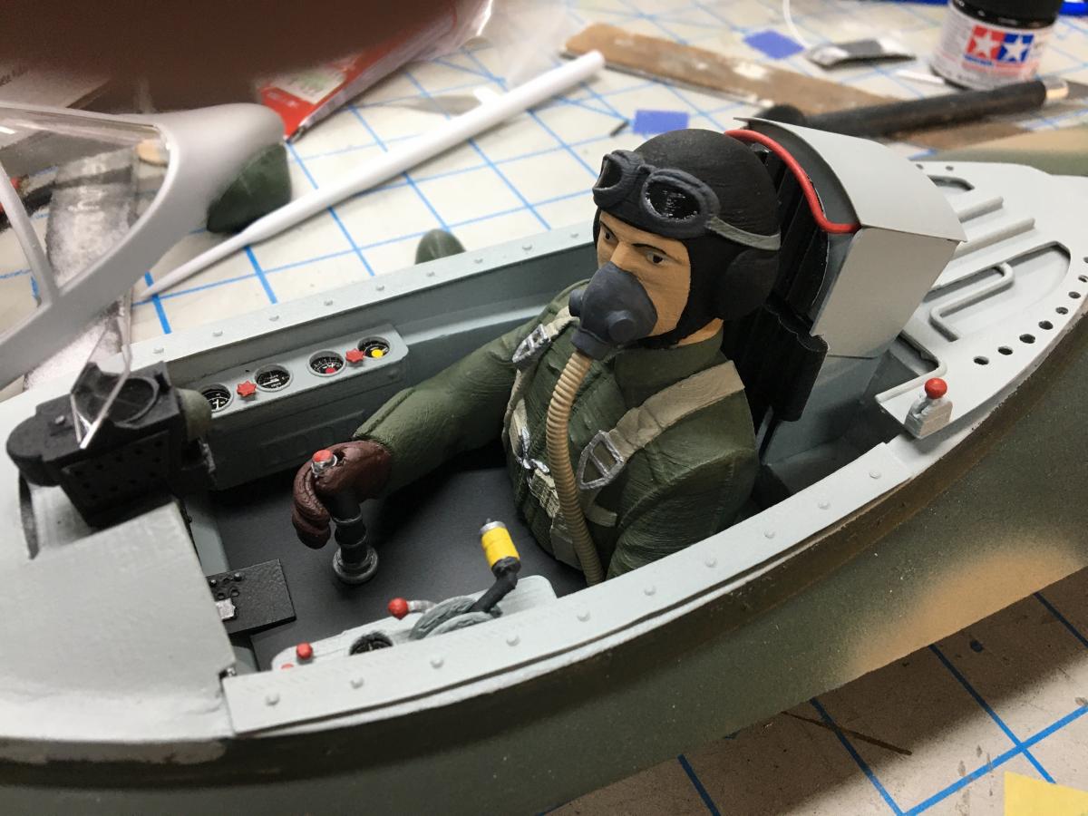

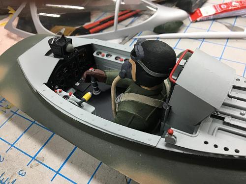

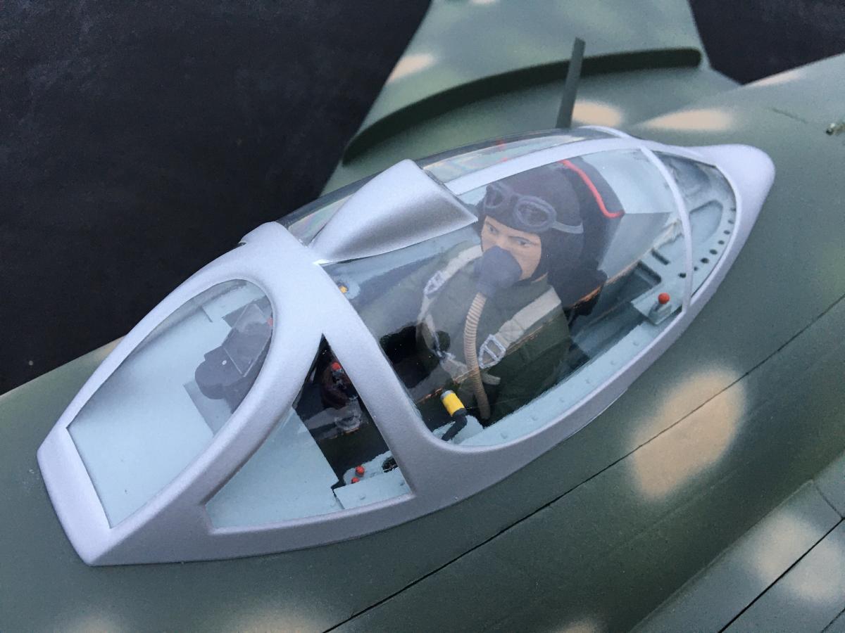

                                  I meant to add some information on the 3D printed cockpit parts -- I purchased these files for a modest amount from
                                  Patrick Verlinden <pat.verlinden@telenet.be>
                                  There are a number of parts, so I just took my time and printed one or two a day and basically made myself a kit. I think it's good to support young modelers who go to such trouble and hoping to make a bit of money to put back into their projects.
                                  As I mentioned before, my pilot was made from combining and modifying Max Gruder designs found on CGTrader. If anybody is selling nicer pilot files than Max, I sure haven't seen them yet.
