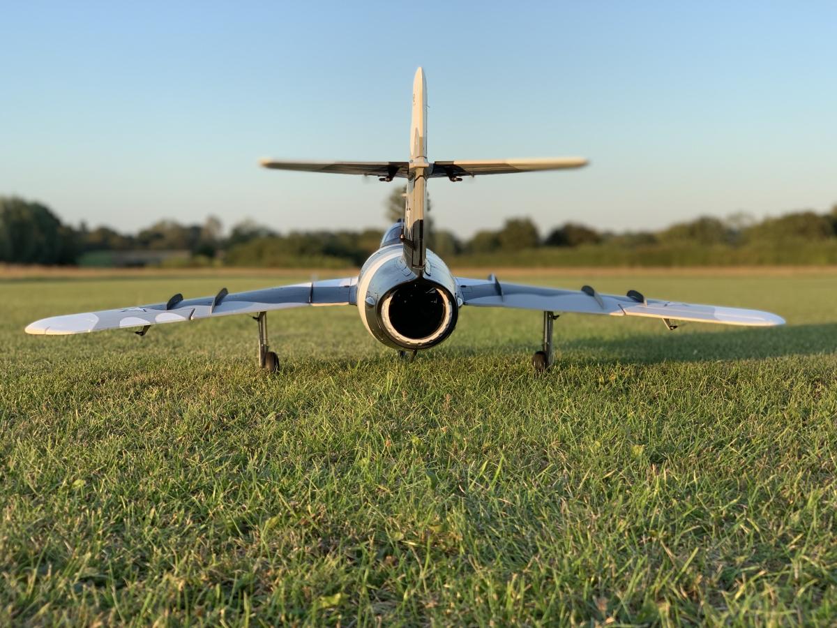

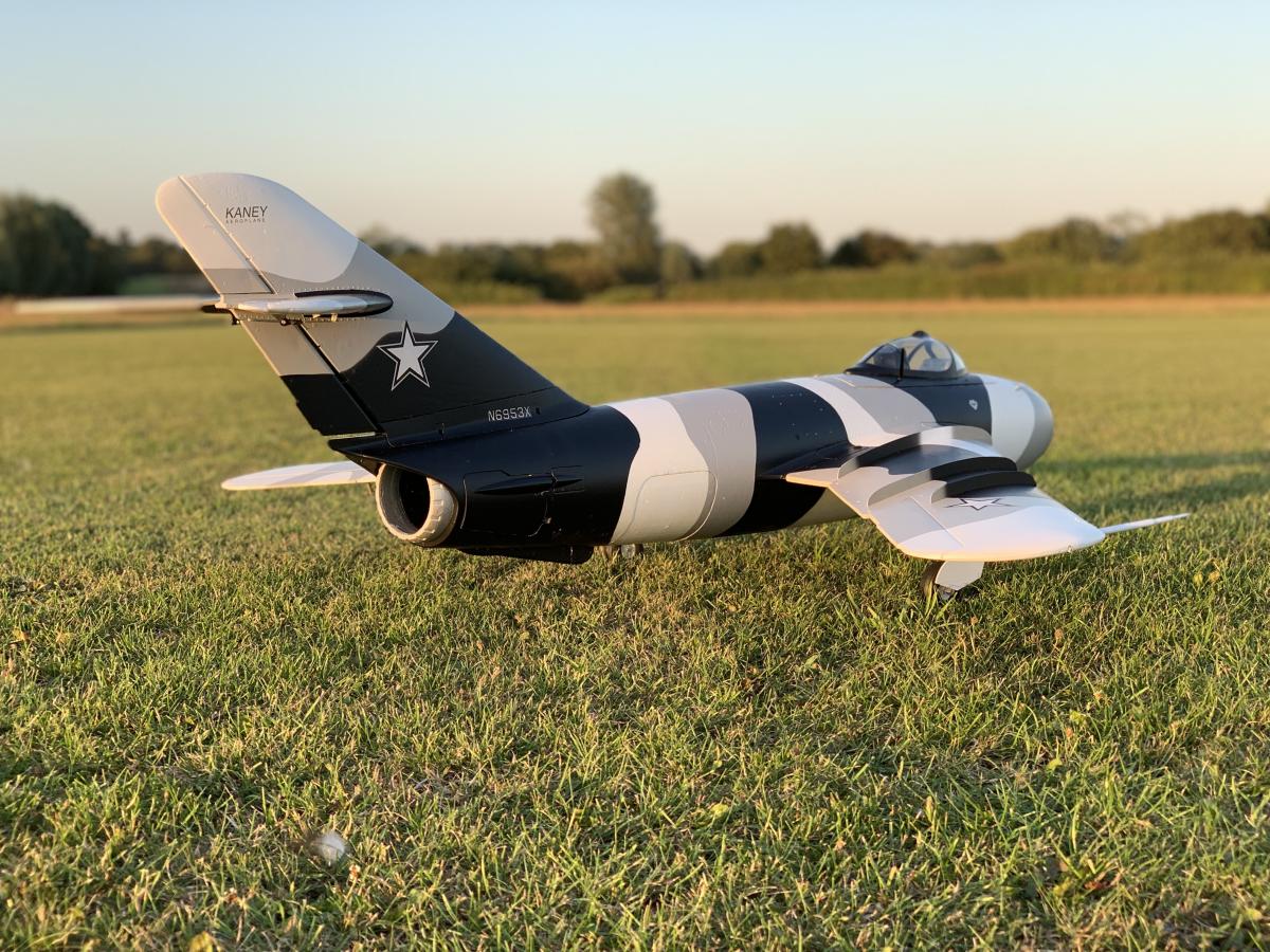

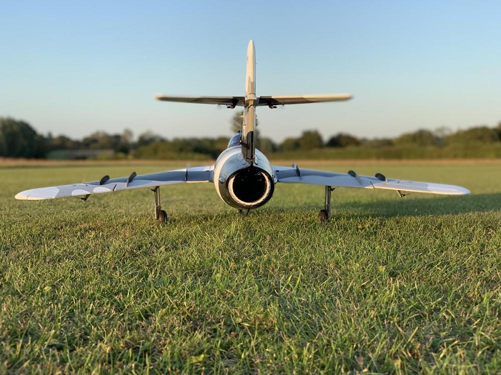

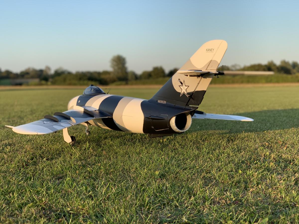

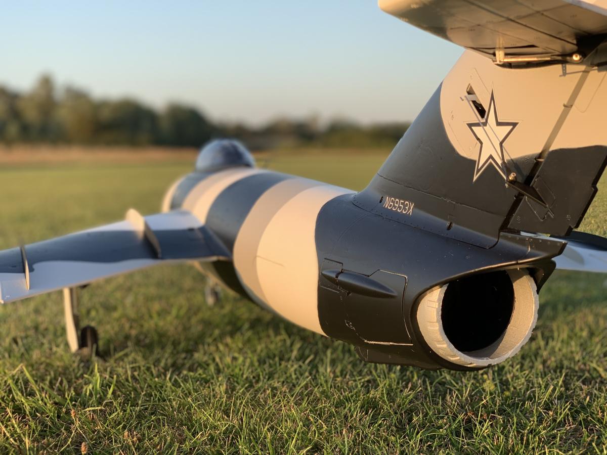

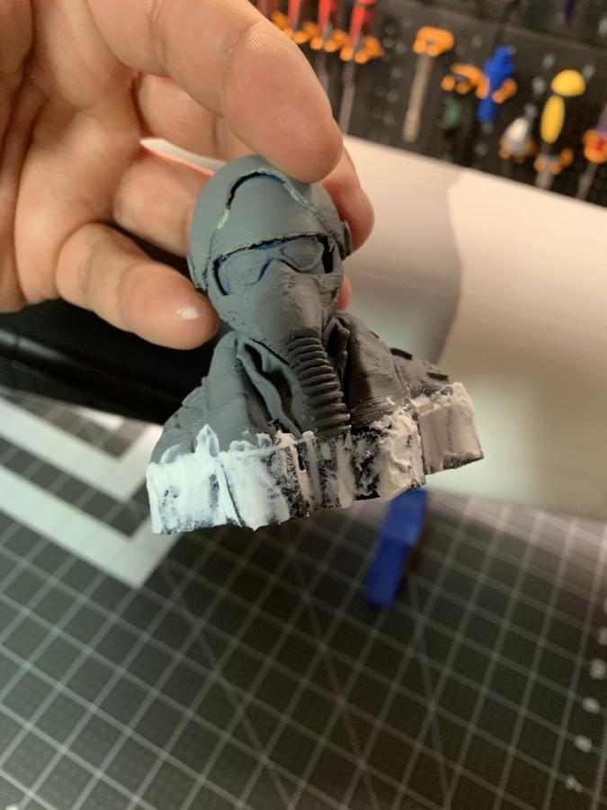

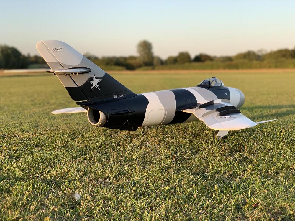

ID:	211391 Friday was the maiden day. It wasn’t the easiest maiden I had. Did require some R-AIL trim and some up ELE but then it was hands off. I have Y’d the airbrakes to flaps and I had no pitch change with 20mm take off flaps and 38mm (90%) landing flaps. I had 4 flights altogether and the plane slows down enough for smooth landings. I did ran out of runway on the maiden as it likes to float and roll. However knowing that previous landings were uneventful with hardly any head wind and some crosswind.
      I have flown with HRB 6000s and settled with CG at about an inch behind the airflow hole inside fuselage which allowed me to take back some of the ELE trim. I got 4 mins flight time on the last flight and I feel I can improve on that.
      I love the way it sounds and love its presence in the air so it is a keeper.

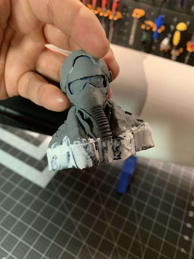

      I am waiting for my afterburner from Ran and pilot on the ready (needs painting).

        Nice pictures t01ga! The pilot looks great.

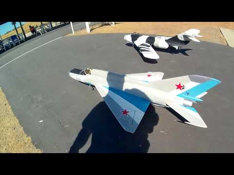

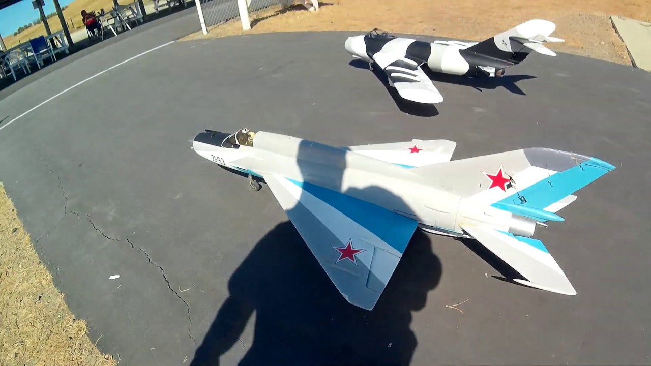

                              Got a formation flight with me flying the Freewing Mig-21 80mm and Frank flying his 90mm Mig-17... great combo!! Mine has an FMS fan but his is all stock...

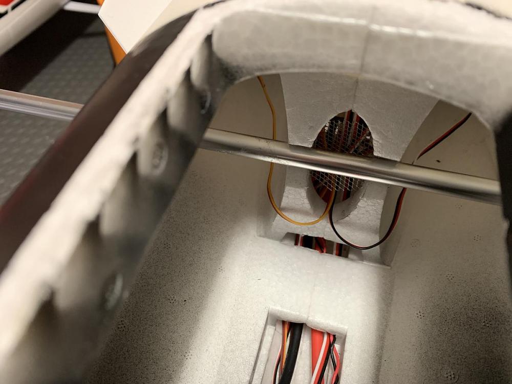

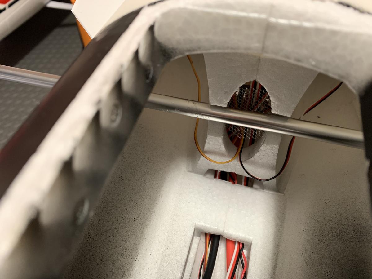

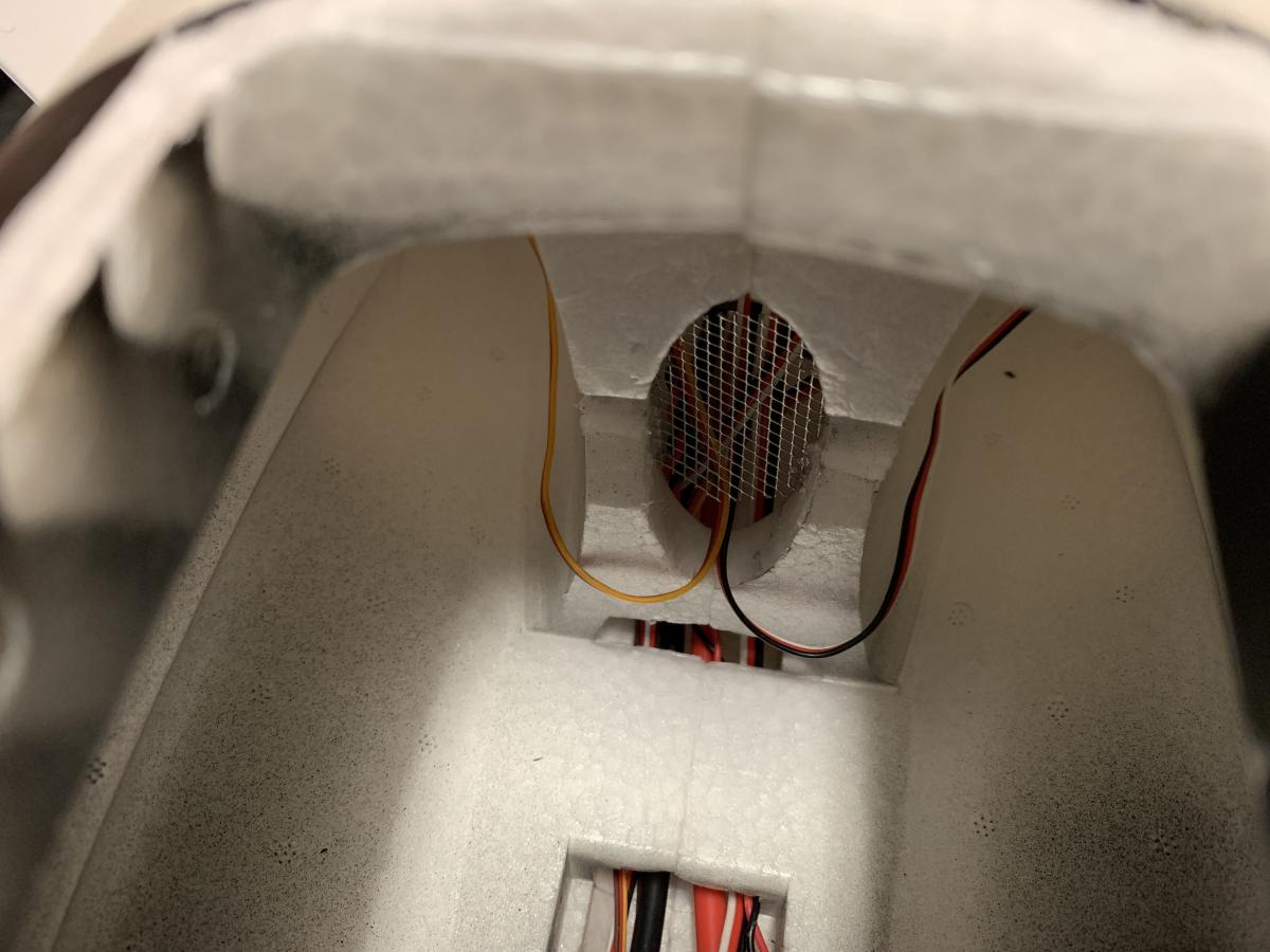

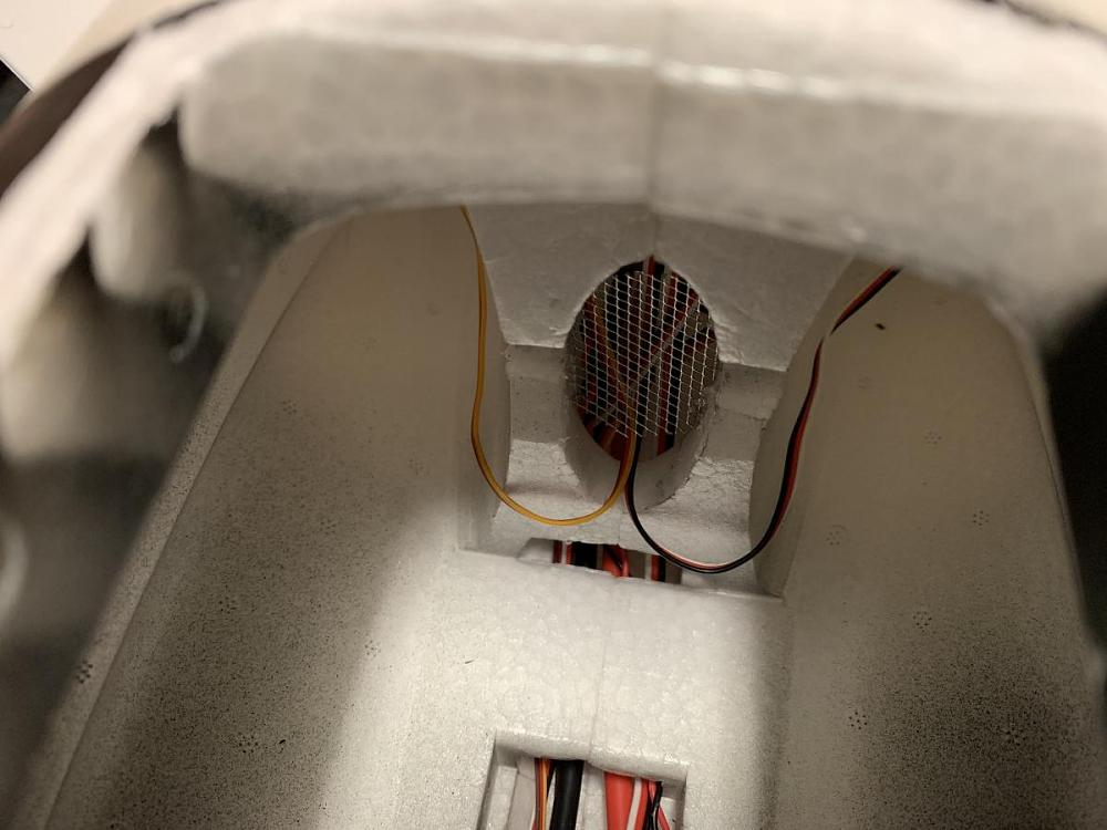

ID:	211976 WORD OF WARNING!!!
                                    Whilst installing my afterburner I saw that wires are all tangled around the wing tube channel especially the wires coming of the wing plugs. Couple of wires were kinked but luckily none had been cut. I assume they had been caught when pushing the wing tube. I have glued in a wire mesh guard and now the tube channel is all clear from any wire.
                                    You might want to check your installation.
