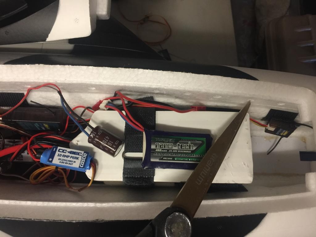

                      Mine (using the turnigy heavy duty 5000 6S) is tacked all the way to the back up to the junction box to achieve the recommended CG

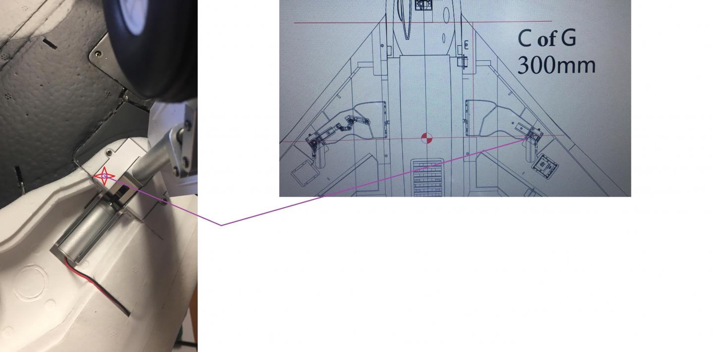

                        [QUOTE=tengarang;n209308]Maiden Flight went well, had to give it some up elevator, as forward CG position required some up elevator trim set. Dont like it sitting at netural with deflection up so i am showing all of you where i will be putting my battery the next flight which should allow me to set my elevator trims at dead center.
                        Tengarang, what is your measured CG position? Are you on, before or after the book cg position? Curious as batteries vary in weight.
                        oh yea, nice vid of the flight....👍
                        • tengarang
                          Banned
                          • 382
                          • Yay Area, California, USA
                          #132
                          [QUOTE=wolpertinger;n209327]
                          thank you sir.
                          you have a very good point
                          please see the attached picture of my relative CG location compared to the manual. I am slightly behind the cg stated on the manual. I also think moving it further back 3mm to 5mm will even help flaring much easier as well on final approach.
                          i balanced with the aircraft up side down. and there should be a few degrees of nose down incidence to be accurate from what i see on my side when balancing up side down
                          Click image for larger version  Name:	WhatsApp Image 2019-08-06 at 3.50.26 PM.jpeg Views:	0 Size:	83.8 KB ID:	209333
