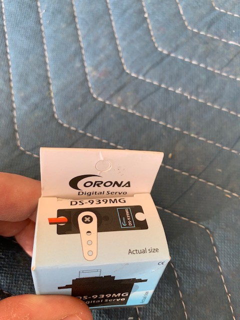

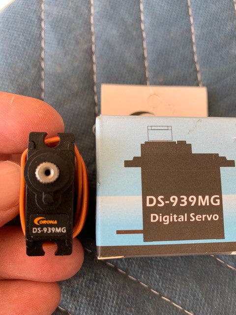

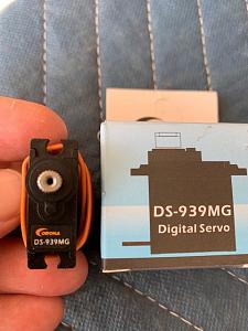

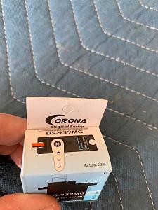

        For anyone who's looking to change the servos on his Mig, I found this servo to be a perfect fit.

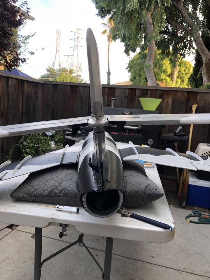

                            Ok now that I have gotten the rest from all the flying and other duties... the Mig will be completed and run up tonight!! its mostly done but I need to get the final prep done for the maiden this weekend. Servo adjustment, gear doors and clear coat... Really looking forward to this bird! I have seen them fly already but its always best when you get to fly your own...

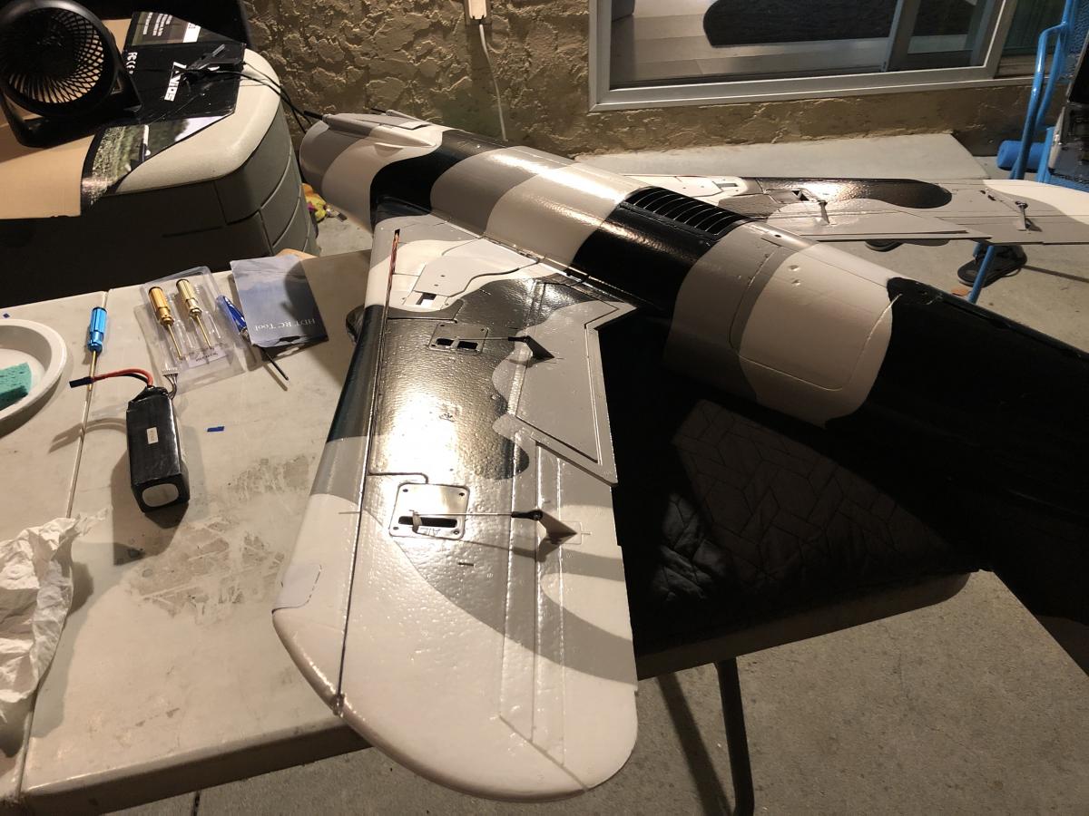

                              Mine arrived this morning and I've just finished with the unpacking, examining all the parts and testing of all the servos. I'm happy to report that all servos tested positive on a servo tester for several cycles. The only flaws (though very slight) were minor warpage in the flaps (or wings) as pictured below. Not a real big deal as I've seen far worse and this will be easily massaged straight. Also, noted was the wooden hold down for the ESC came loose, resulting in the ESC flopping around during shipping and pulling the 3 wires to the motor out. Reconnected, test for proper rotation, repositioned the ESC, glued the wood piece back down, a little hot glue along the edges of the ESC to keep it from moving. Will build when the rains come this weekend.
                              So far, this model appears to be just as good (initial quality) as any of the Freewing and FMS planes I have. If it goes together and flies as well as other private owners have indicated, I think HobbyKing has another winner. They even seem to have gotten the release process right this time (still thinking about the C-130 fiasco). After the many "losers" that have passed through my hanger (of all makes), I'm hoping it will join the fleet of "winners" from HK - BushMule, C-130 ("V2"), Albatross.

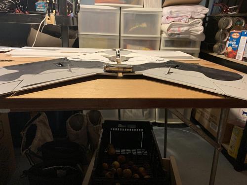

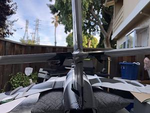

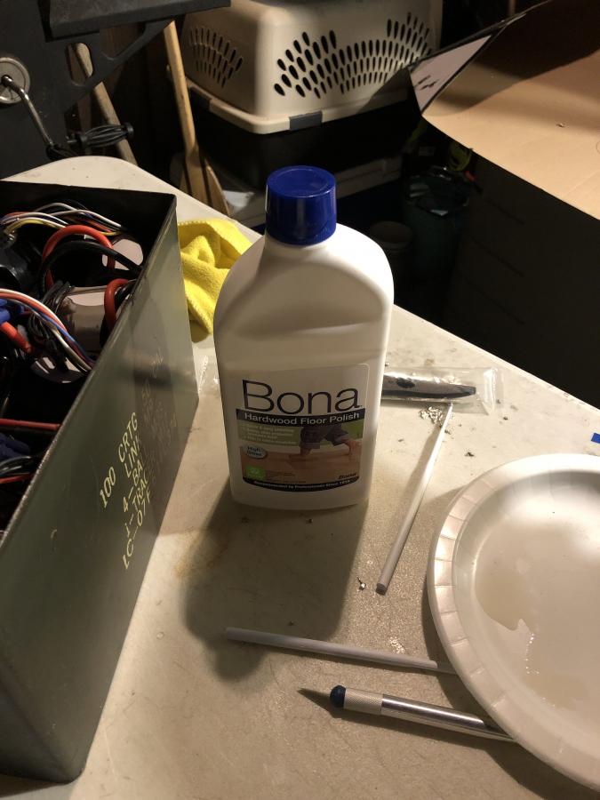

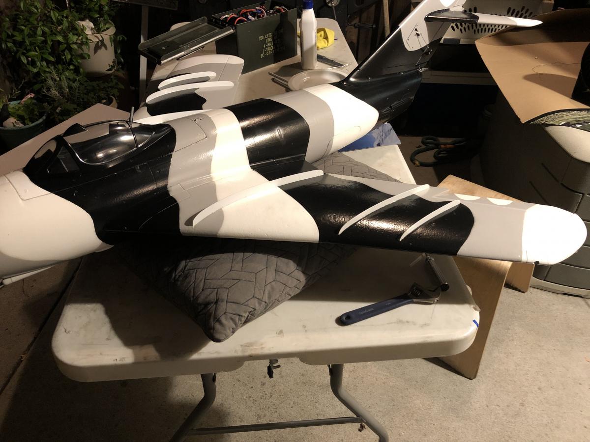

ID:	209651 Well I made some really good progress on mine last night. Got the linkages all lined up as they should be and noticed that the rudder halves were going in separate directions. This could be what is causing the rolling on some of the planes. Be sure to check this stuff before tou get it flying. Yes you can trim it out but the plane will still handle funky this way. I had to bend mine but it was easy to do. I also had to remove a couple servos to get them centered properly since the linkages were not enough. Either way it got done. I also did my first coats of clear and really like how it came out! Will do a lil more work today which will include securing esc/wires, installing ec5 plug and ztw UBEC. Will hopefully have it ready for maiden this sunday... here are pix of what I did...
