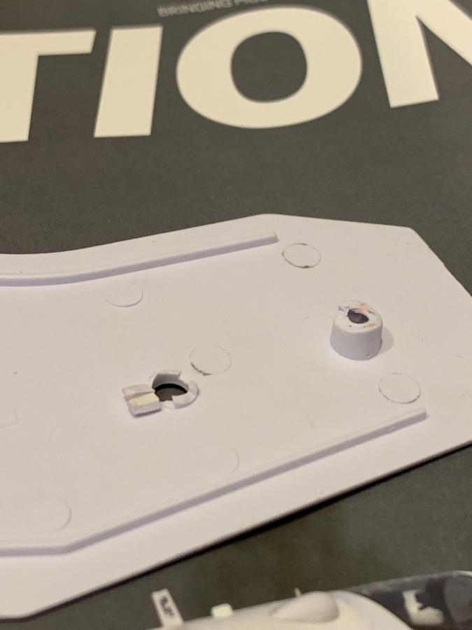

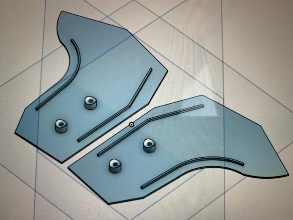

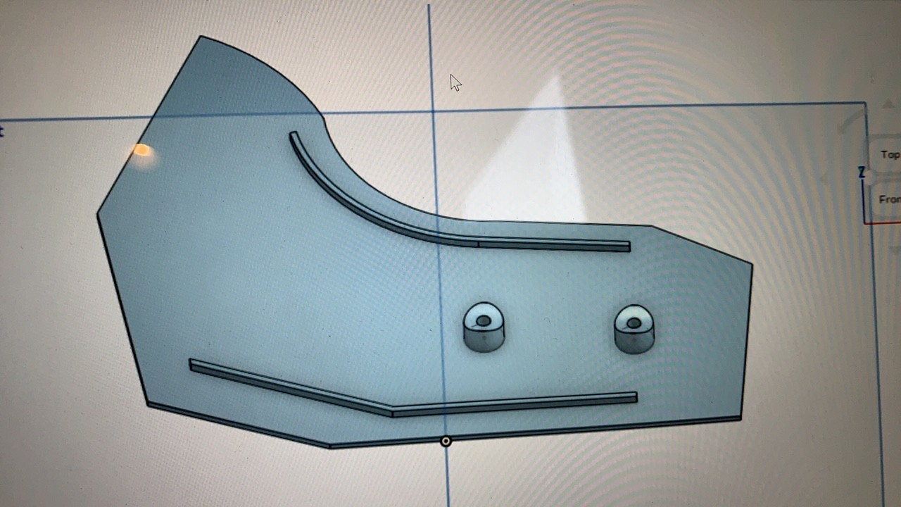

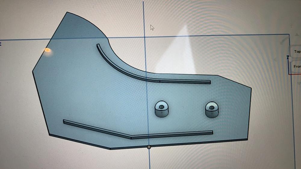

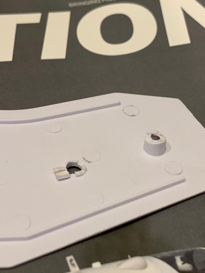

                            Your Mig arrived with broken gear doors? I just made these:
                            Click image for larger version  Name:	IMG_6501.jpg Views:	0 Size:	35.4 KB ID:	208770Click image for larger version  Name:	IMG_6498.JPG Views:	0 Size:	161.5 KB ID:	208771Click image for larger version  Name:	IMG_6500.jpg Views:	0 Size:	99.2 KB ID:	208772

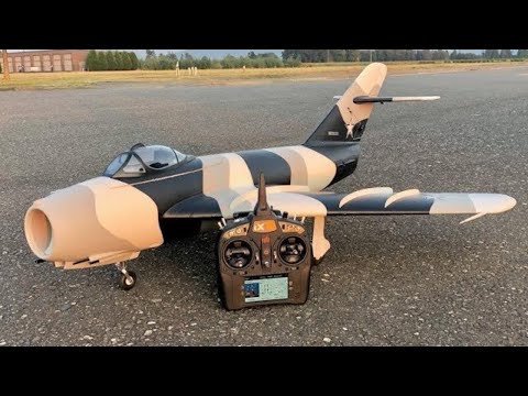

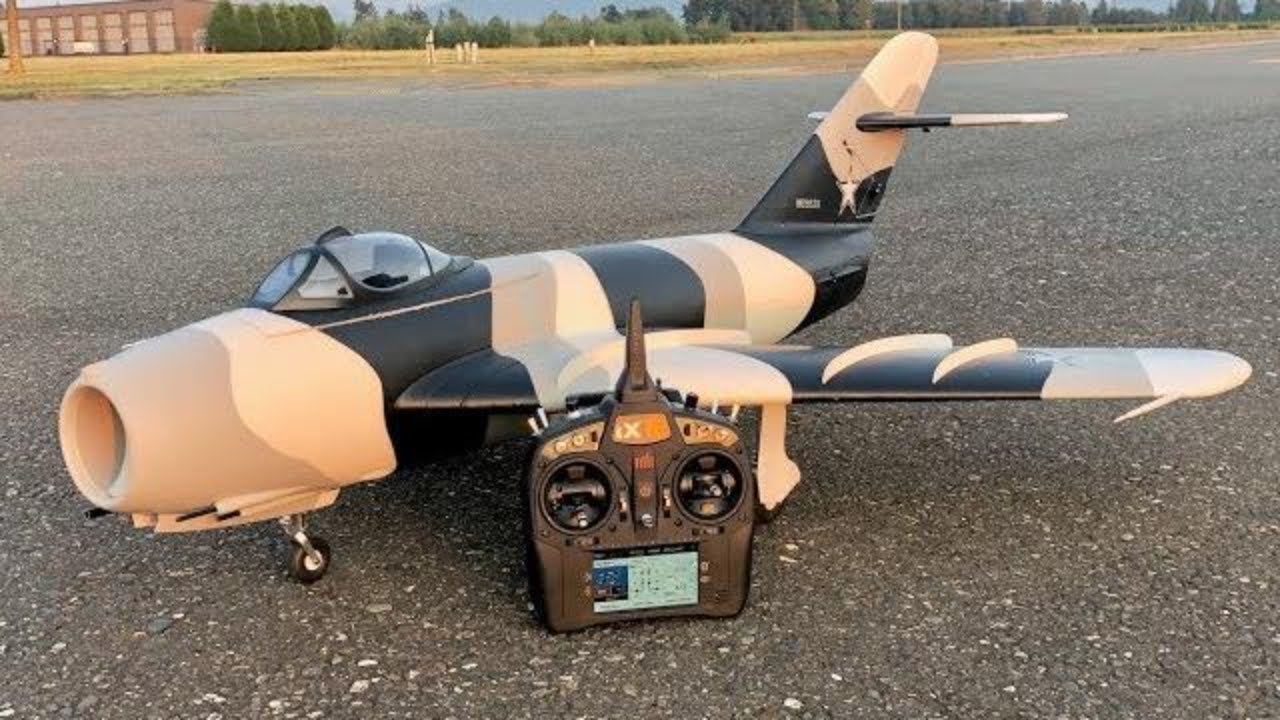

                              Having a blast with this sweet flying jet!
                              Please follow the links in the video description :)

                                  That’s cool. Can you post the .stl or the site where it’s located? Thanks!

                                    mine came in perfect condition, with Thelightburner setup it will be better than any other booty money can buy.
                                    Also good to know you carry spare parts via 3d printing, but i am sure the need will arise soon.

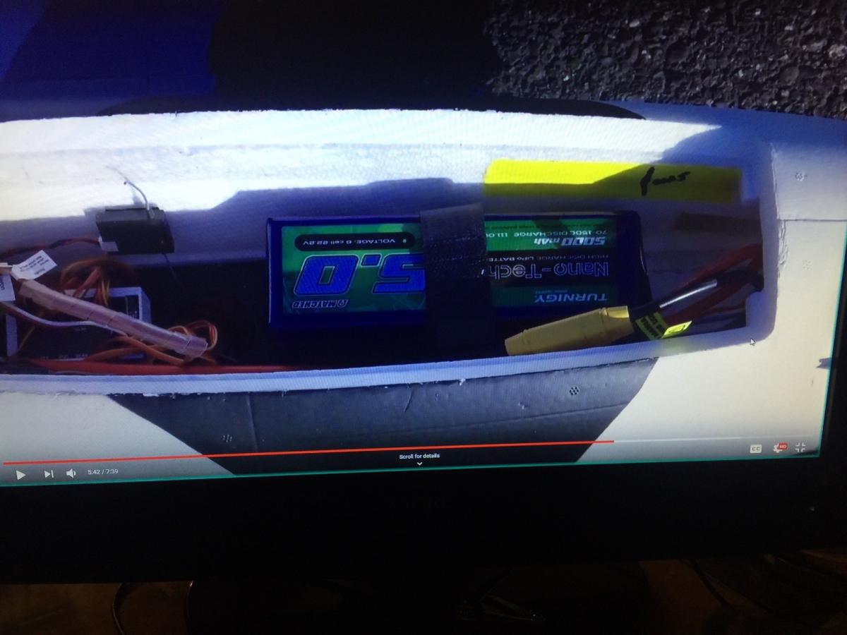

                                      The construction of my Hobbyking Mig-17 has completed its construction and preflight feasibility stage. Officially inaugurated as aircraft#54 of the tengarang fleet under the Chinese Peoples Liberation Army Airforce detachment.
                                      Using a China Hobbyline 6000mah 55C 6s pack indicated in the picture (not mine) below
                                      CG can also be found at timestamp 14:33
                                      The eagle Tree 2d/3d stabilizer, although not required for a model such as the Mig-17 was nevertheless incorporated to the setup.
                                      The introduction of the Guardian stabilizer requires a 10 channel receiver, in this case, a 10 channel DSMX Lemon RX was selected to cover all the basic functionality incorporating the eagle tree stabilizer.
                                      Gear -> Gear
                                      AUX1 -> Flap (set to a 3 position switch with 6ms delay)
                                      AUX2 -> MODE (Rate Mode, Safe Mode, 3D head Holding Lock Mode)
                                      AUX3 -> Gain (set to a slider switch)
                                      AUX4 -> Airbrakes (set to a slider switch with 8ms delay)
                                      AUX5 -> 3800uF 50V capacitor
                                      Throttle -> Stock BEC output measure via multimeter 5.46V
                                      Bind Port -> Castle Creations BEC output programmed to be 5.5V DC, the default is 5V
                                      there is a 40mV offset between AUX5 and Bind Port so a 3800uF capacitor is incorporated in the overall circuit, however, this is not needed due to the very small change in potential difference.
