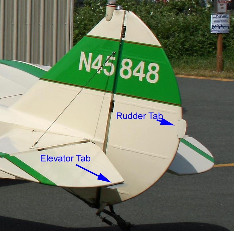

    Perhaps you'd explain to me why they both have the same "N" number
      #222
      Top secret bro!

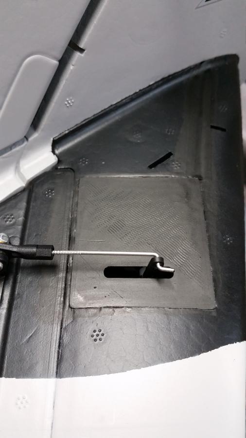

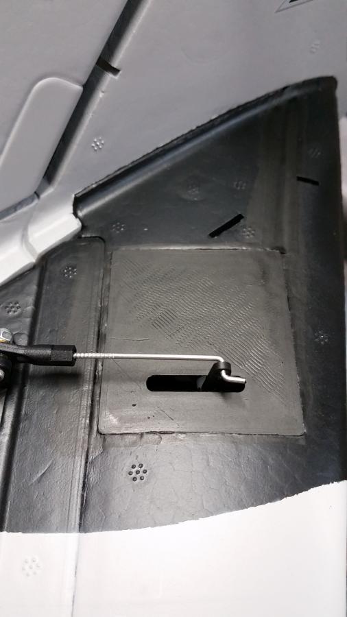

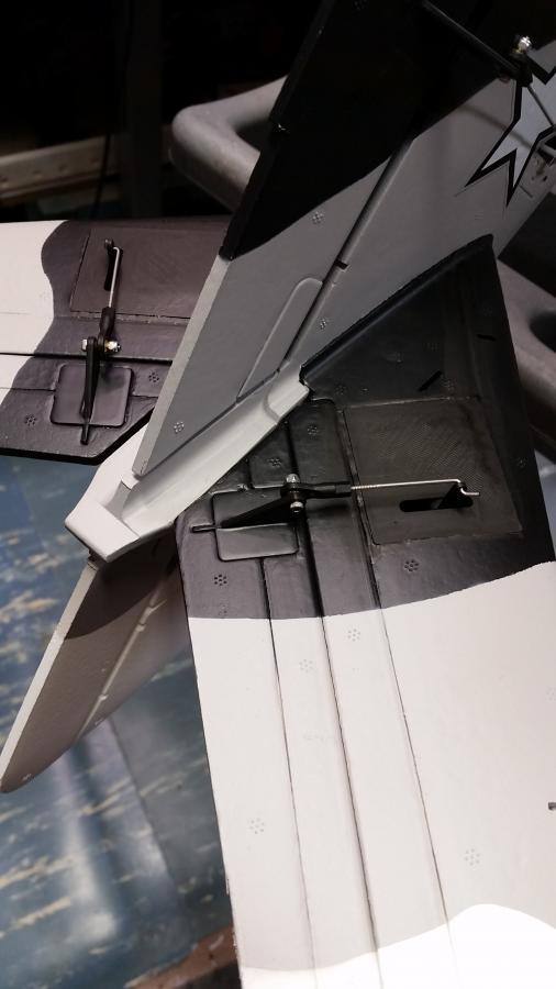

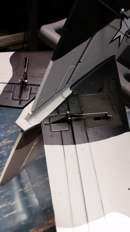

                        I printed and installed the 3DP elevator servo covers that were posted on the thread a little ways back. Peeled off the original tape, and they fit perfectly without any trimming. I covered up the servo wire trench with a piece of scotch tape and painted. I'm happy with how they turned out!

                          You are welcome ;)
                          Looks very good!

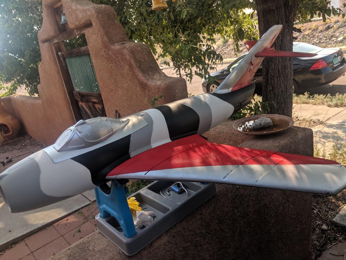

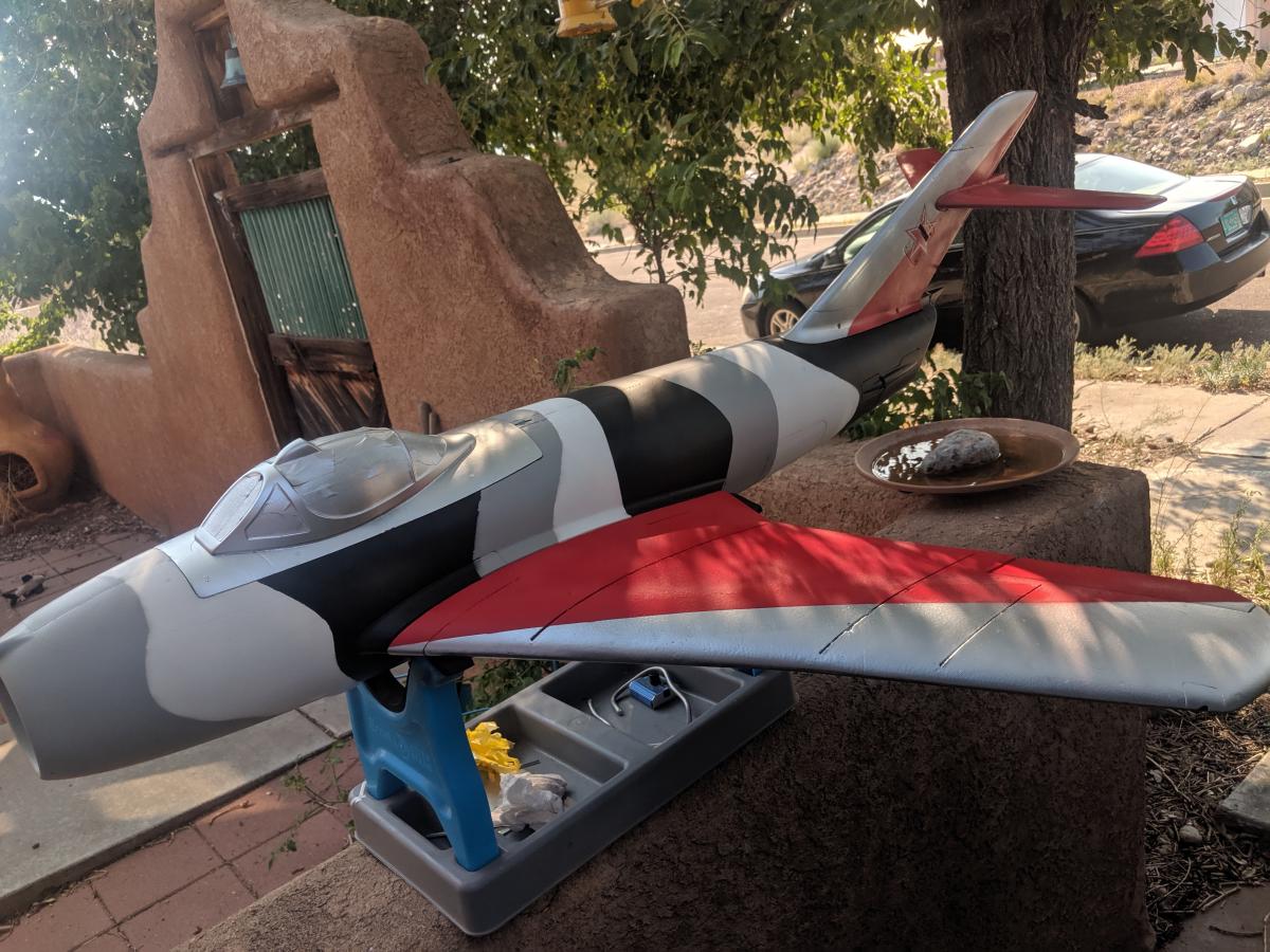

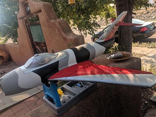

                            Made some progress on my repaint. Spent the day working up 3d models for cockpit eye candy. It won't be scale, but it will look better. Tail feathers are done, I made my own water slide decals using a cricut vinyl cutter. Click image for larger version

                                  You need these (on the ailerons anyway)

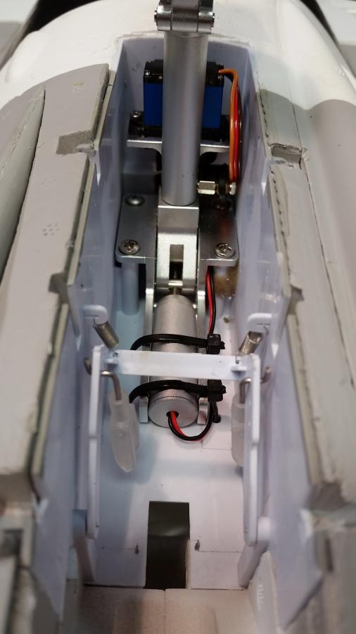

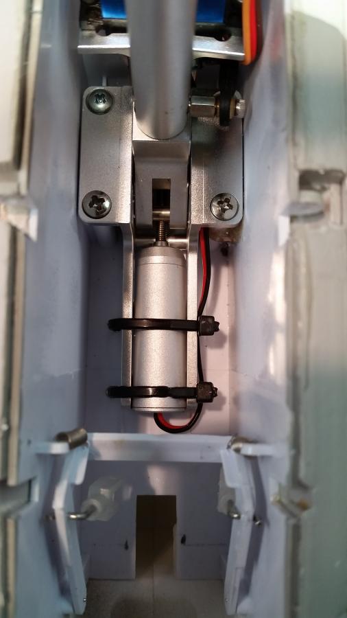

                                          Hey guys, I had a couple of nice flights today with my MIG at a warbird meet. On the last flight I made a dumb mistake on the landing and bounced it. The "dreaded pogo bounce". It sprung into the air and wallowed nose-high - almost stopped and was going to drop out the air but I gave it full throttle and just managed not to crash - it was just enough to prevent a stall and the second "touch" was pretty hard as well, it slammed in pretty good. There was no structural damage but after inspection, I found one of the main gear doors had broken off the mount (so I am printing a new set of doors) and I found some pretty nasty damage on the nose gear retract unit. It had been forced backwards by the impact and broke the mount. The retract unit itself was undamaged. (wish we could get metal-case retracts for the FW Corsair!)
                                          If you look at your plane, you'll see that the nose retract unit is held onto four plastic posts by 4 metal screws. The force of the "landing" actually bent two of the screws, stripped another out, and broke one of the plastic posts off. Also, it bent the aluminum mount that the little steering servo is attached to. (HK offers a replacement steering servo mount in the spare parts list, I wonder why). I took the nose gear out, straightened the servo mount, epoxied the plastic post, and replaced the two bent screws. I used some Foam-tac on the threads to help with the stripped plastic. Then I did this neat trick, which I learned was useful on the FW A4 Skyhawk nose gear. I drilled some small holes and installed two small zip-ties like you can see in this picture. This secures the retract to the floor and prevents the gear from bending backwards in a hard landing (which I hope not to repeat)!!
                                          This is a very easy mod which will help avoid breaking the plastic nose gear mount.
                                          Here are two pics to show my work. I removed the nose gear doors to make it a bit easier to work in there.
                                          If you look closely hear you can see the epoxy under the front right screw, and you can see the back left screw looks different. I was amazed that the original screws were actually bent!
