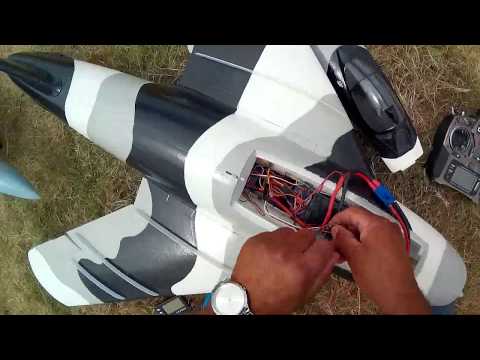

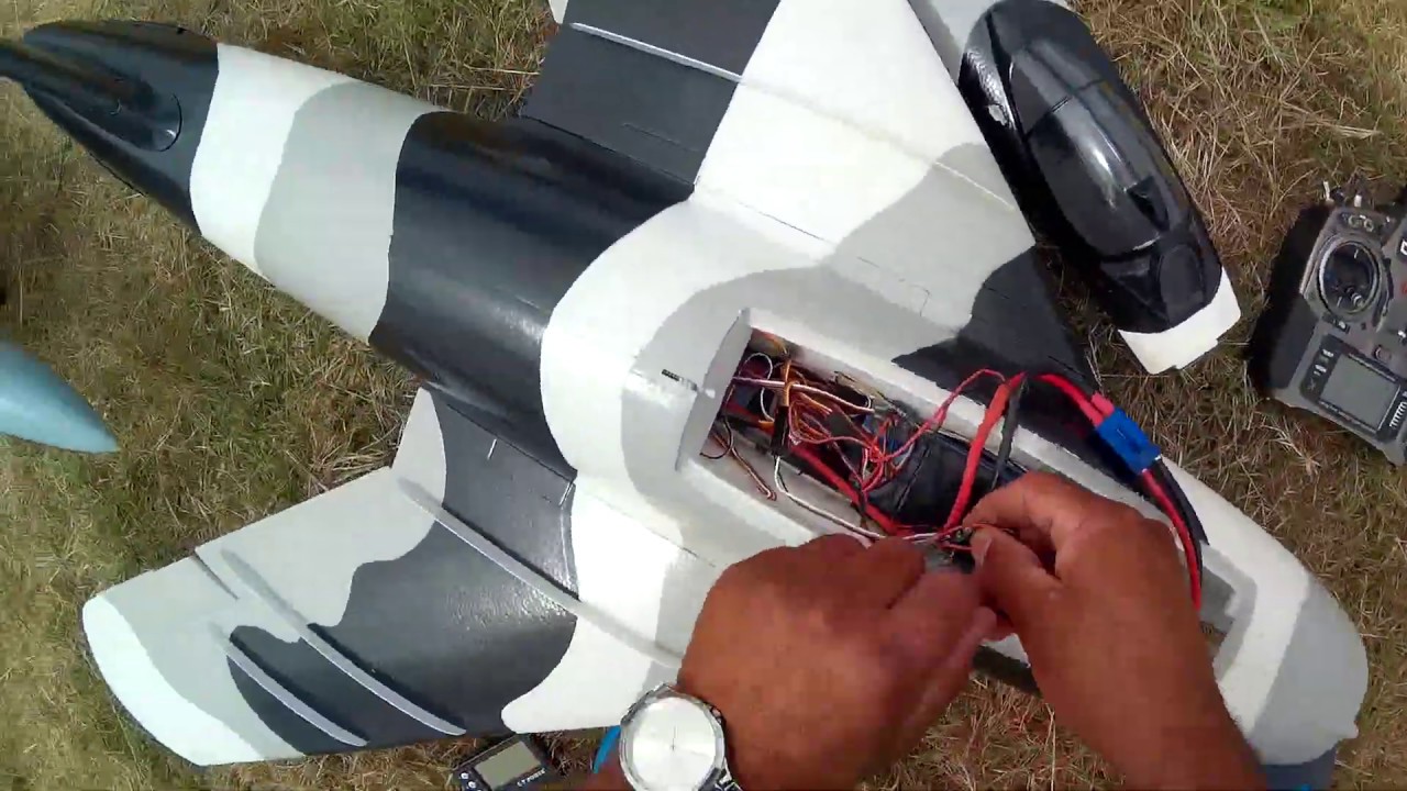

      I can't help much with the question on the board (My PNP bird came with the board already installed) but I can tell you that everything plugs into a regular receiver and the board does the work of sequencing the gear. Although it seems to be finicky and so I cycle it each time I fly.
      The steering servo is mounted on a metal plate (shaped like a "C") that is attached to the strut, so yes, it does swing up and down with the gear. It works well, but that plate can be bent in a hard landing and then the steering will be off-center. That happened to me and it was very easy to straighten it out - but I wasn't very happy with how easily it bent. I noticed HK sells that plate as a spare part. So I ordered one!
      The control board doesnt sequence. There is a sequencer under the battery tray that then plugs into a gear controller. I totallt removed my board and sequencer to eliminate failure points and it has been working well this far!
      • Originally posted by gooniac33 View Post
        You are correct of course, I meant that I plugged everything in to the board and let the model's electronics do the work (the actual sequencer is a separate part that is under the tray). So to refer back to the original question, I didn't need anything additional to make the retracts work.
        Of course now I am dealing with the issue that they don't always work all the time, which is a hassle. I put the gear down, fly the base leg then the final approach, and then I see... no gear!! So I have to abort and repeat, which doesn't always work out if your battery is at the redline. Fortunately I haven't conked out. But I came waaaay too close one time and ruined one of my 5000mah batteries. Which is why I am using 6250's now! I am going to definitely consider bypassing the thing completely like you said, Gooniac.

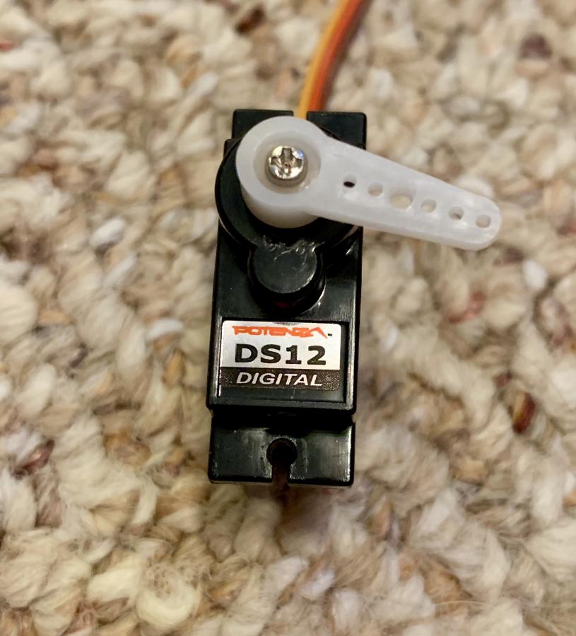

                • Just as an FYI, the Flex Innovations DS12 servos are direct replacements for what comes in the MIG. The DS-12’s are 12g metal gear digital servos. I’ve used them on a few projects and like them.

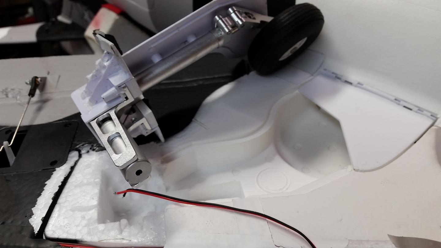

                  • Was at the TORKS Ejets meet (near Columbus Ohio) this weekend and had a great time - and had to eat a big piece of humble pie after flying my MIG. They have a beautiful 800' paved runway and I could not stick the landing - even after 'splaining to everyone here about how I had the model dialed in last weekend. Well, not so much! Each time I came in I had the dreaded bounce - and I would power up to save it from the "sabre dance".... but I had several nasty "landings". It didn't get better in subsequent flights and on the last one bounced bounced bounced and ripped the nose gear out of the mount and one of the main gears completely out of the wing. No airframe damage but it was demoralizing. (I did manage to do just fine with several other planes at the event... but the MIG had to go back into the trailer. And now I'll have to do some repairs.)
                    When the main gear came out it ripped the wires right out of the retract unit. The whole unit (retract and wheel and plastic cover) is intact.. I'd like to ask the group - do any of you have any insights regarding how to disassemble the metal actuator? I can't figure out how it comes apart.

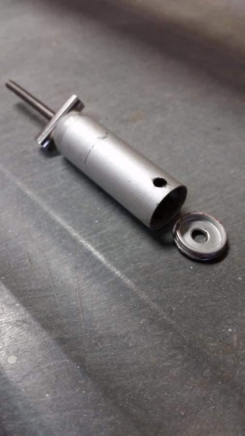

                    • Well I figured out how to get the actuator apart. I disassembled the unit to get the worm drive out and I could not get the end cap off.
                      After struggling with it for several hours I finally got it off, its a simple press-on cap that was secured with Loctite.
                      I really like this all-metal unit. It will be very easy to reattach the wires and reinstall it in the plane (the retract unit was not damaged)
