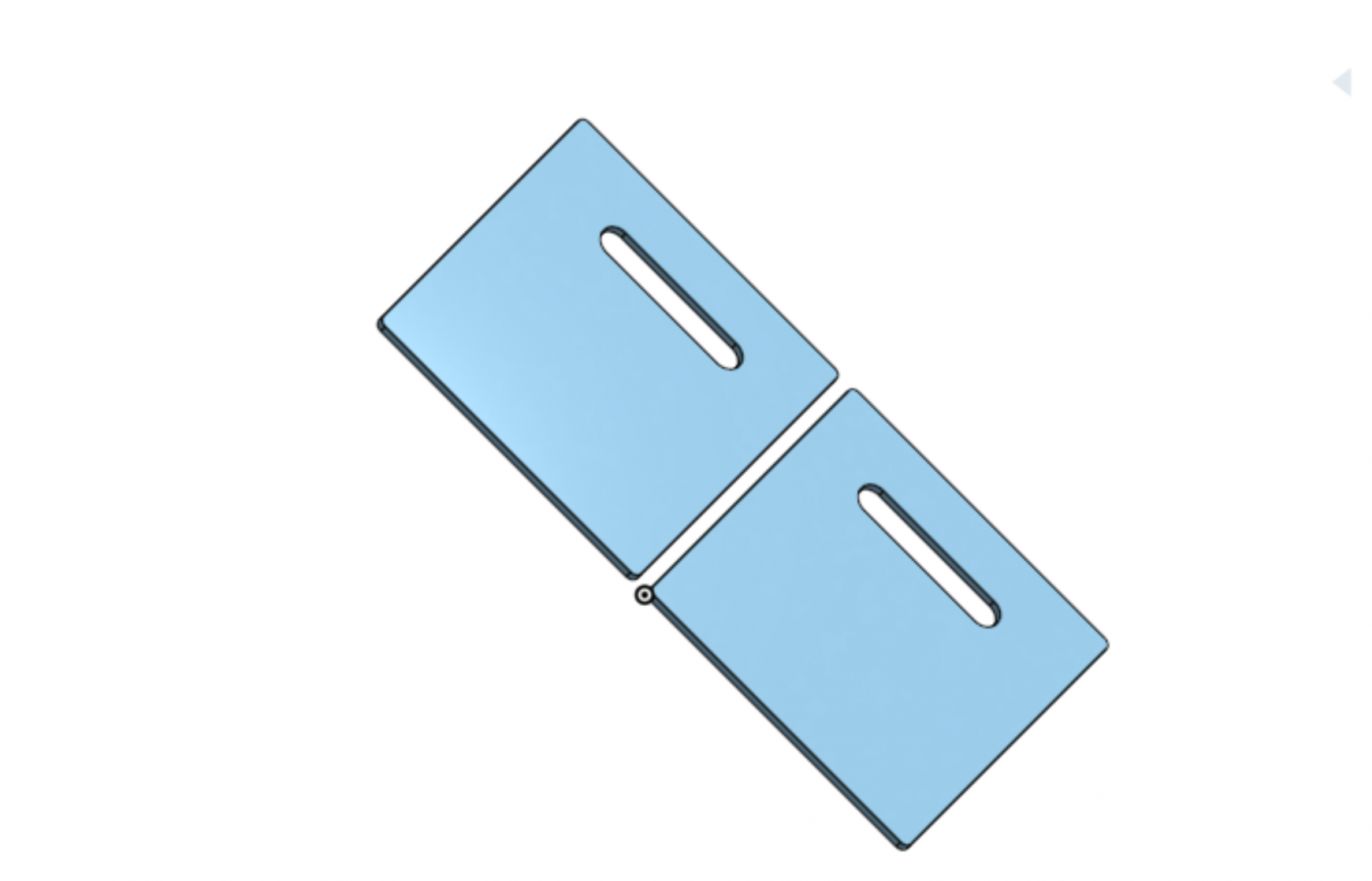

                      • Elevator servo covers:
                        Main landing gear doors:
                        Both published now and ready to be downloaded

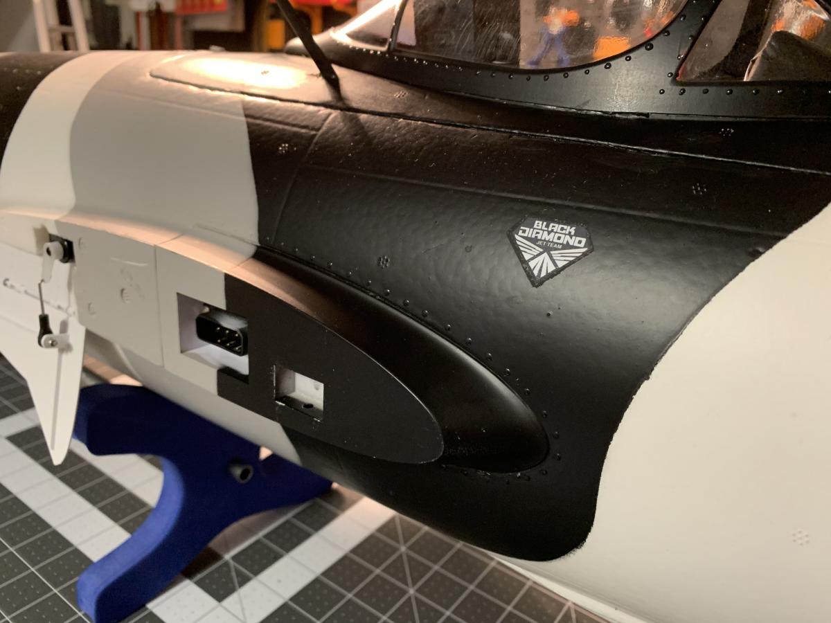

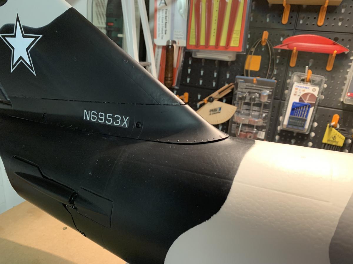

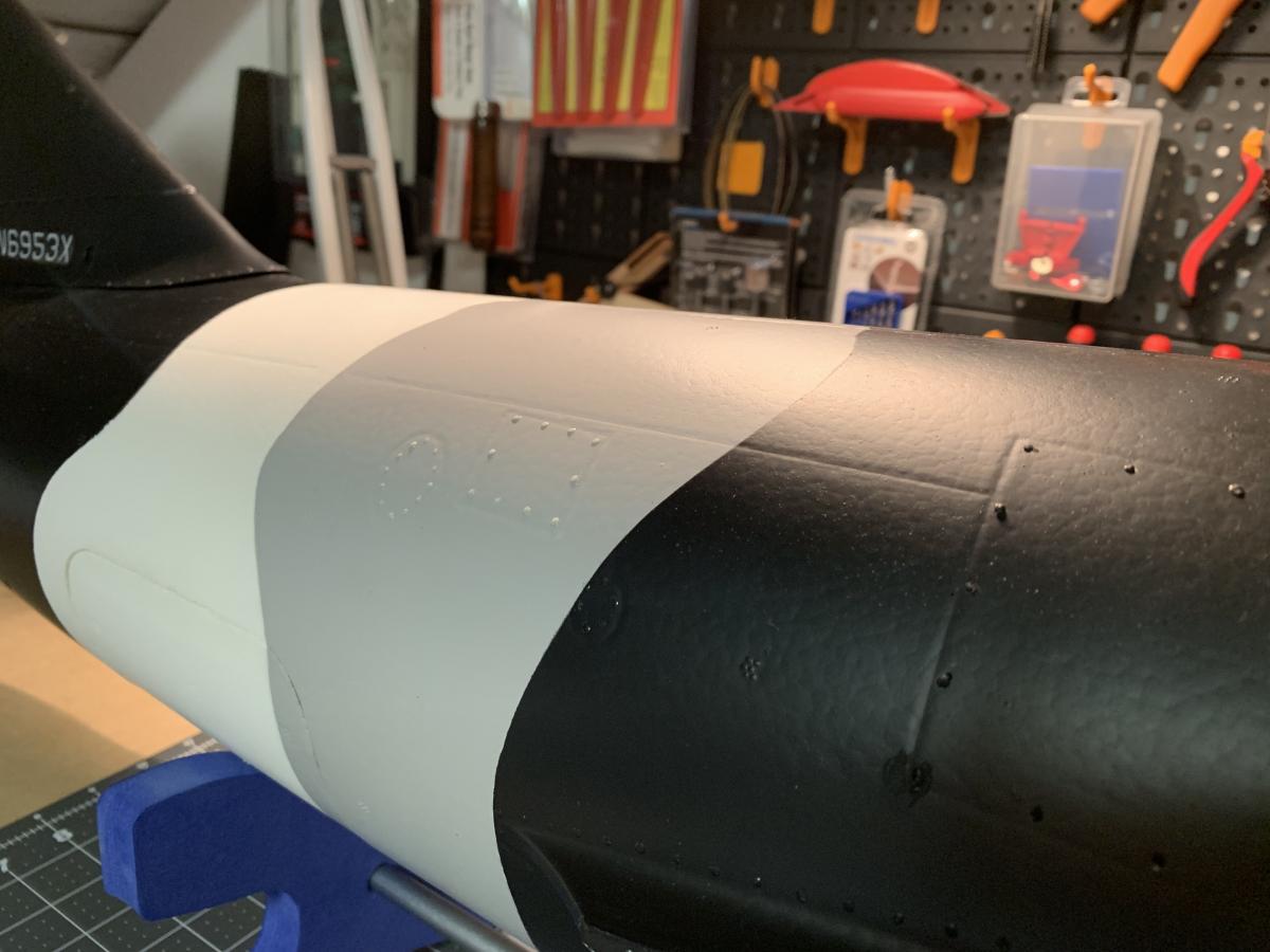

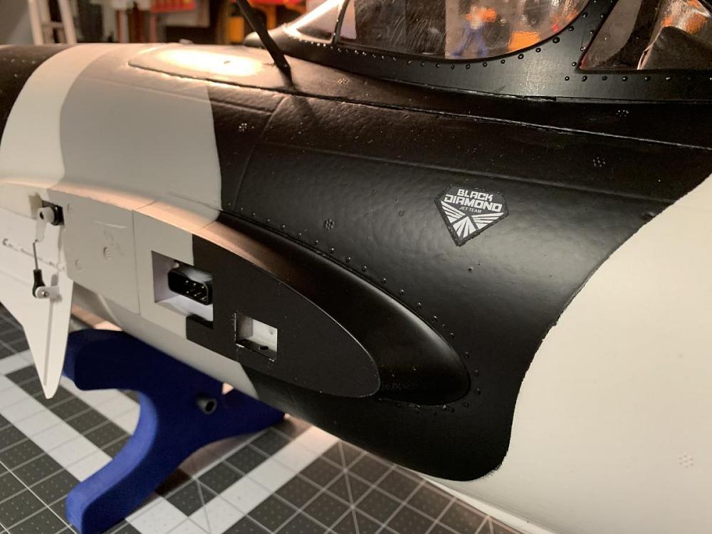

                        • RanGee, that's cool, thanks! I printed and installed the tail skid, it fit perfectly and it's exactly what this plane needed. I flew three flights today. With the Admiral 5000 stuffed as far forward as possible, it still checked out tail heavy (a bit more than 1/4" further back than the manual's recommendation) but flew perfectly. When I flight-tested the balance (by flying inverted) it was not tail heavy. We're going to need to move the battery strap. It's not possible to secure the battery even with the strap all the way forward.
                          I found it somewhat difficult to land, because it floats like no one's business all the way down the runway in ground effect. I discovered that it lands well on the grass at the end of the runway! You definitely need to slow this one down on final - and I need to do more flight testing to see how slow it will fly! I was landing with half flaps with the speed brakes deployed.
                          I did need some up trim after takeoff. I found the elevator response to be normal but the aileron response was fairly soft - I have my controls set up with the control rods on the next-to-the-last hole so I think I may move the aileron control rods to the outer hole. And - its not extremely fast but flies really well. Stable and easy. I really liked it.

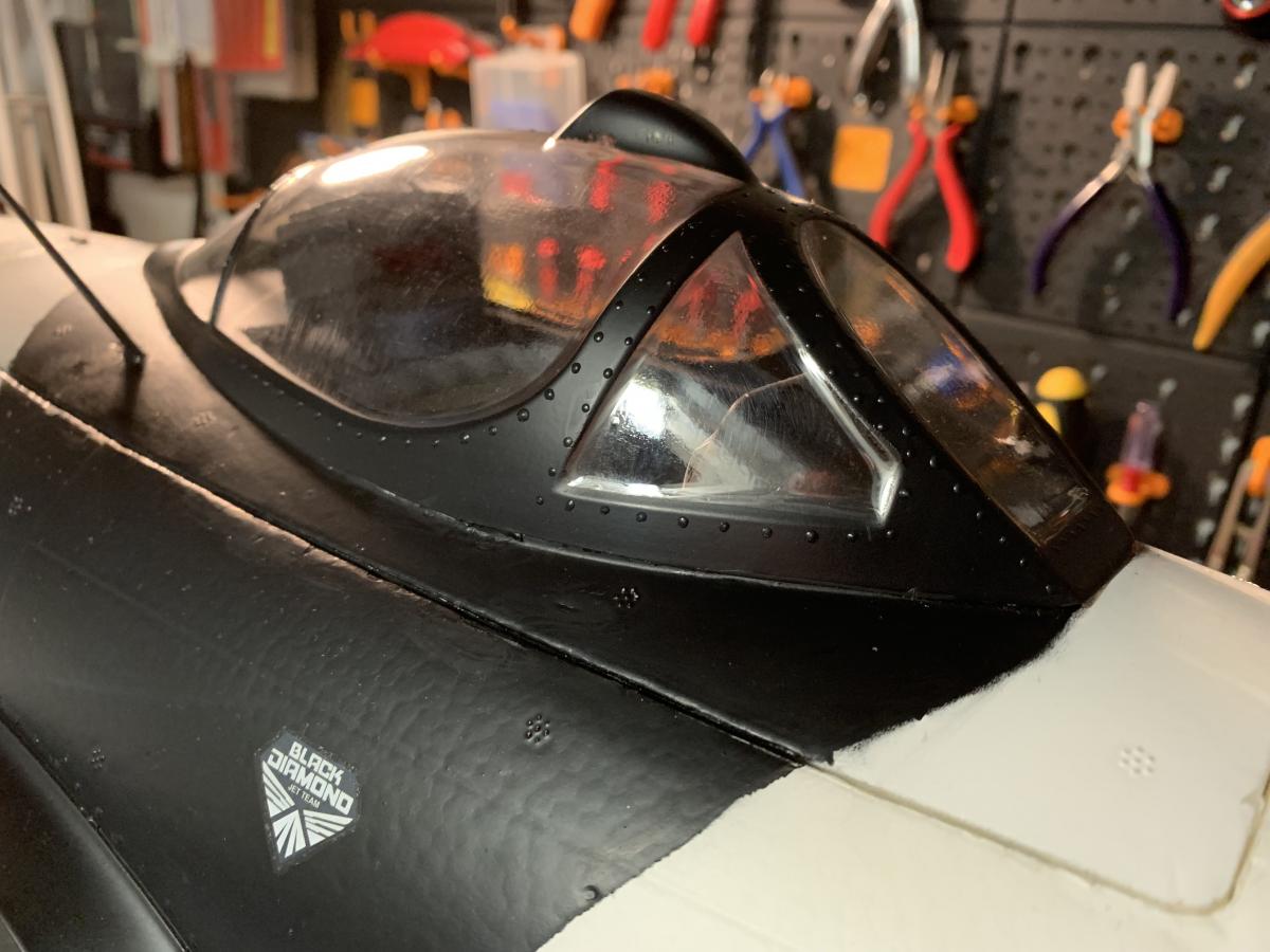

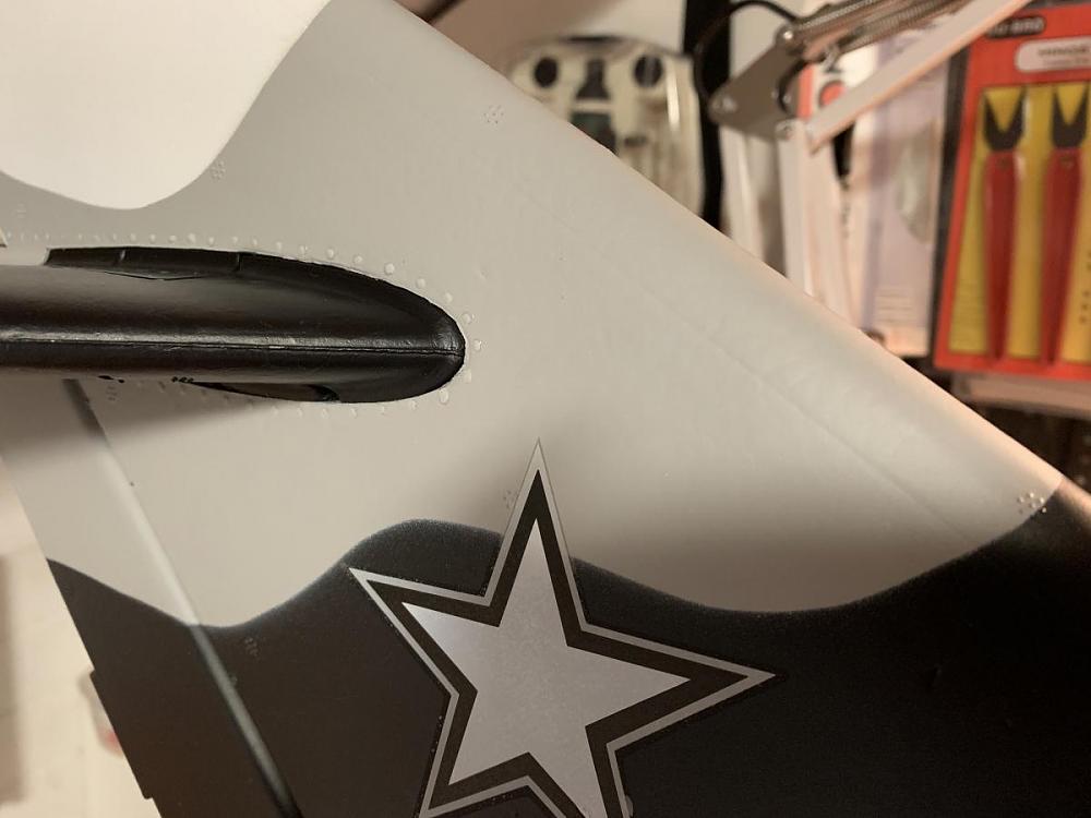

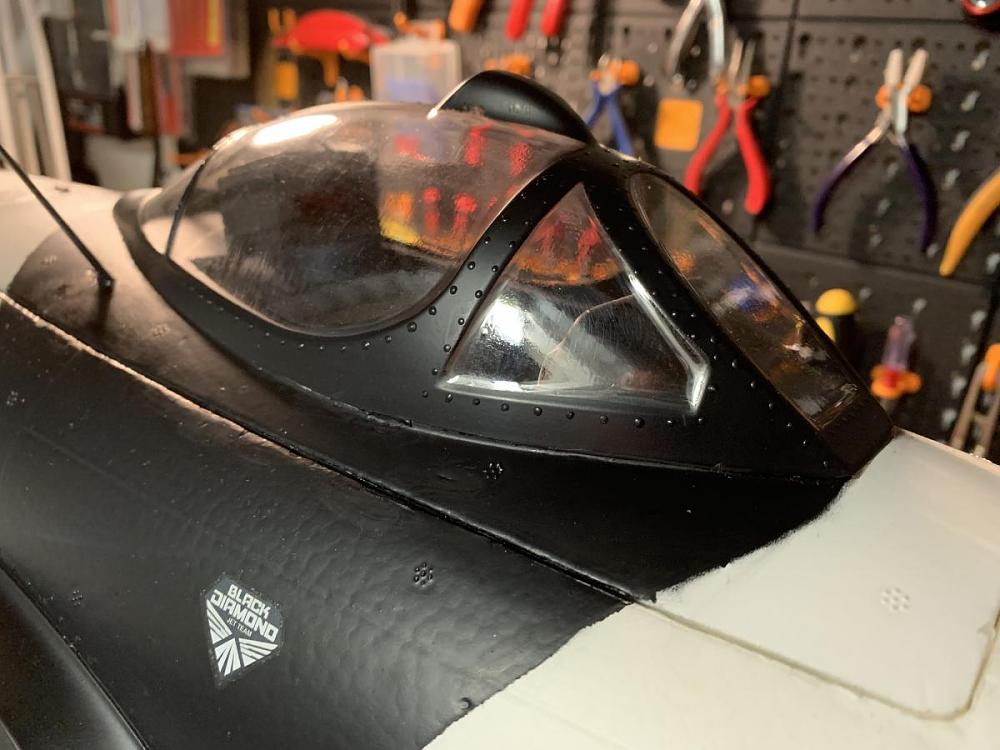

ID:	209845Click image for larger version
ID:	209846Click image for larger version
ID:	209847Click image for larger version
ID:	209848Click image for larger version
ID:	209844 Some rivet detail...
                            Tolga
                            Instagram: @_t01ga_
                            YouTube: t01ga

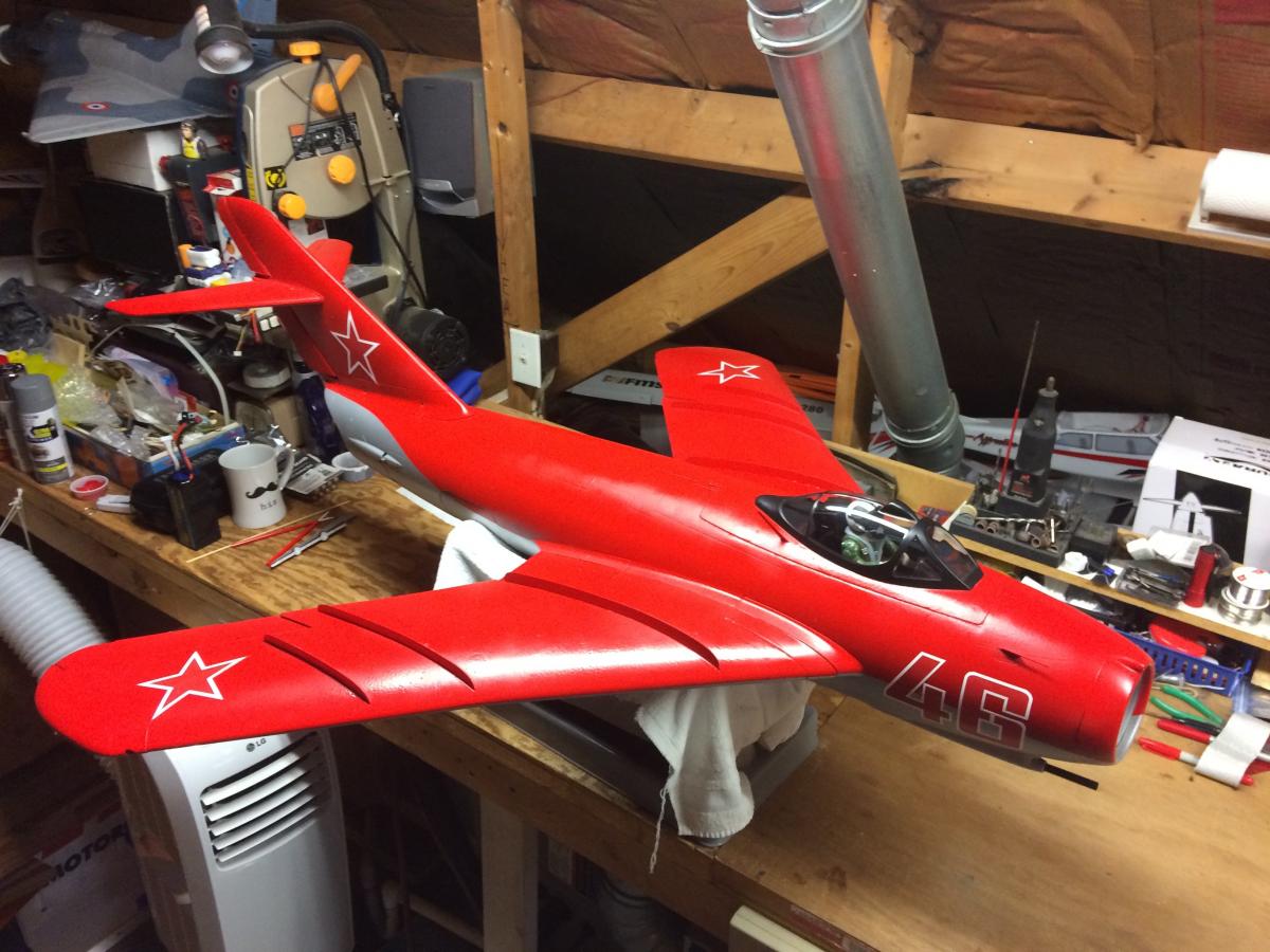

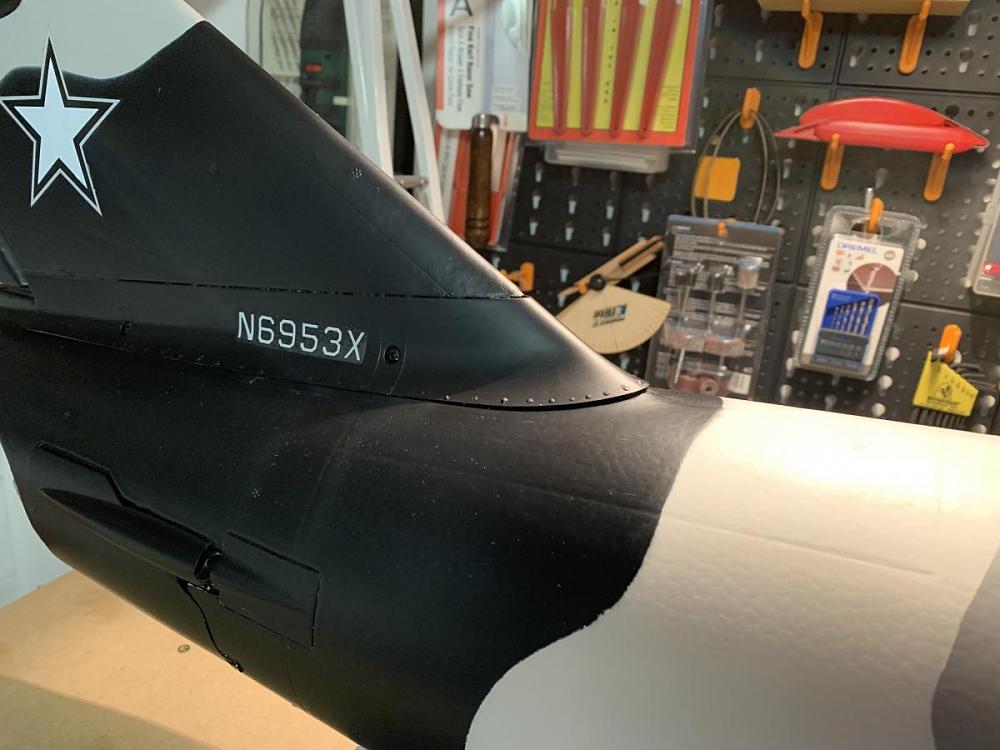

                            • Cool! I did some work on mine too...
ID:	209850Click image for larger version

                                That is literally awesome!!!
                                Tolga
                                Instagram: @_t01ga_
                                YouTube: t01ga

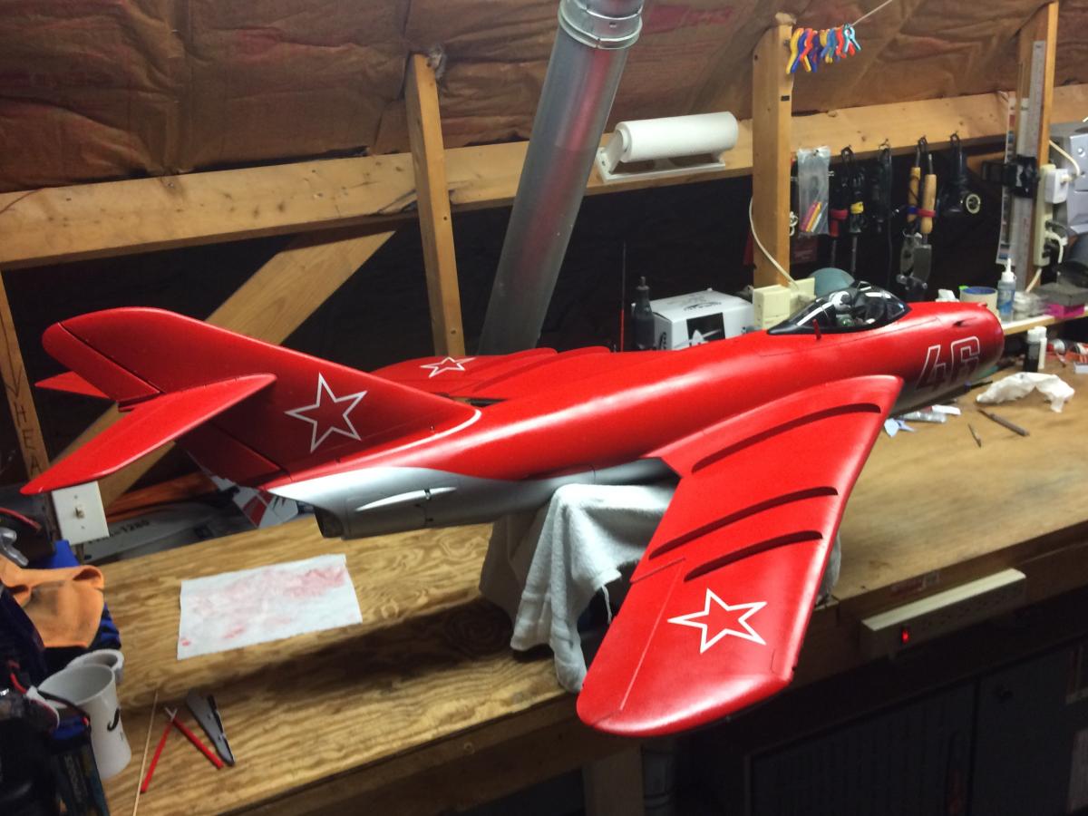

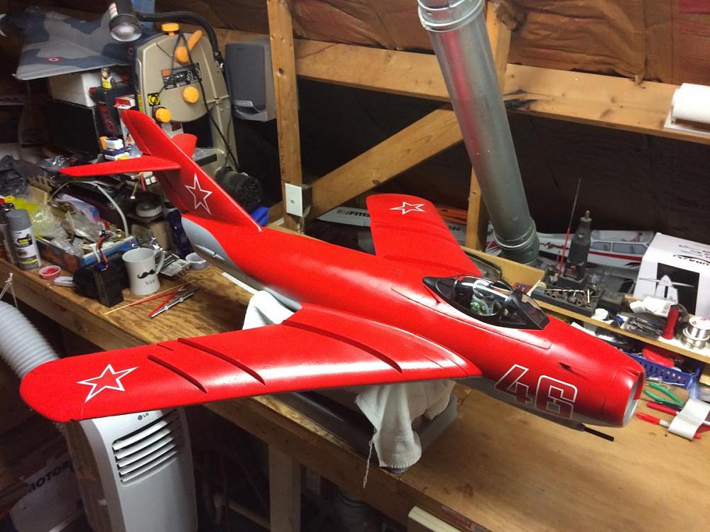

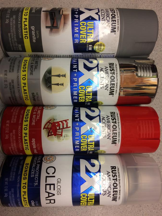

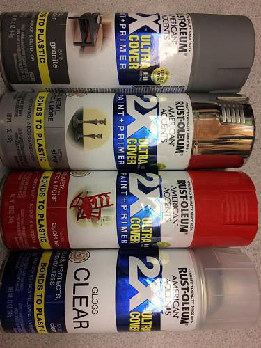

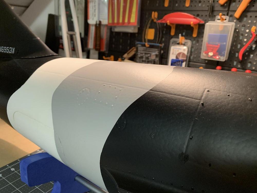

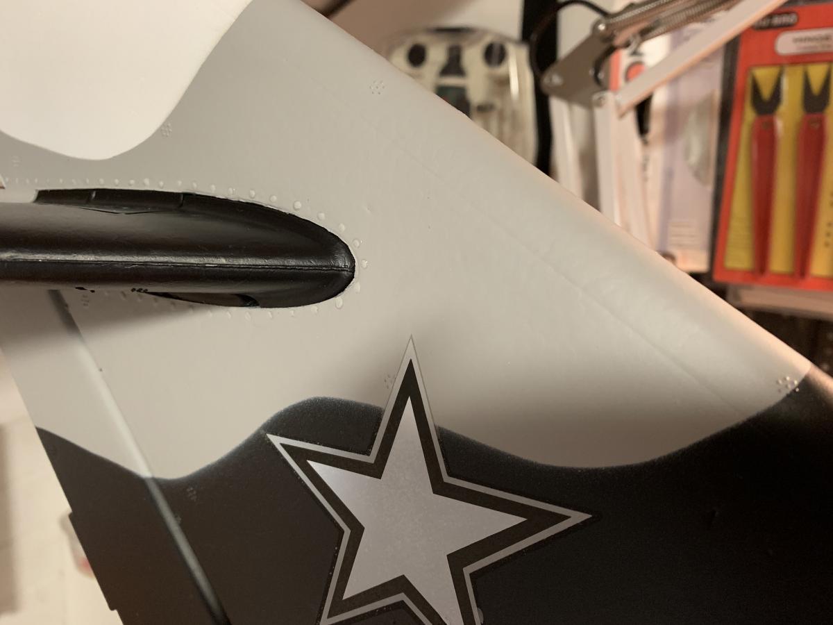

                                        • I was asked about the paint I used. Pictures worth a dozen words. This is my first time using this paint and I’m not sure I’d use it again. I bought it all at Wally. The one I went to didn’t have primer so I used the granite. Took about a can and a half. Then I did the chrome. It turned out perfect, looks like aluminum. Then the Apple Red... notes... the foam on this is soft and dents easy, it’s not a FreeWing. The original paint peels off really easy. I’ve complained about FreeWing paint before but won’t again after this.
                                          The paint is fair, it covers well and dries reasonably quick to the touch, about a half hour. I let it dry a day in my attic workshop between each color and the clear coat... says 48 hours but I gave it 24.
                                          Wally has a no name paint that would probably be better and Model Master is definitely better (though expensive)...
                                          Use very low tac tape. Click image for larger version
