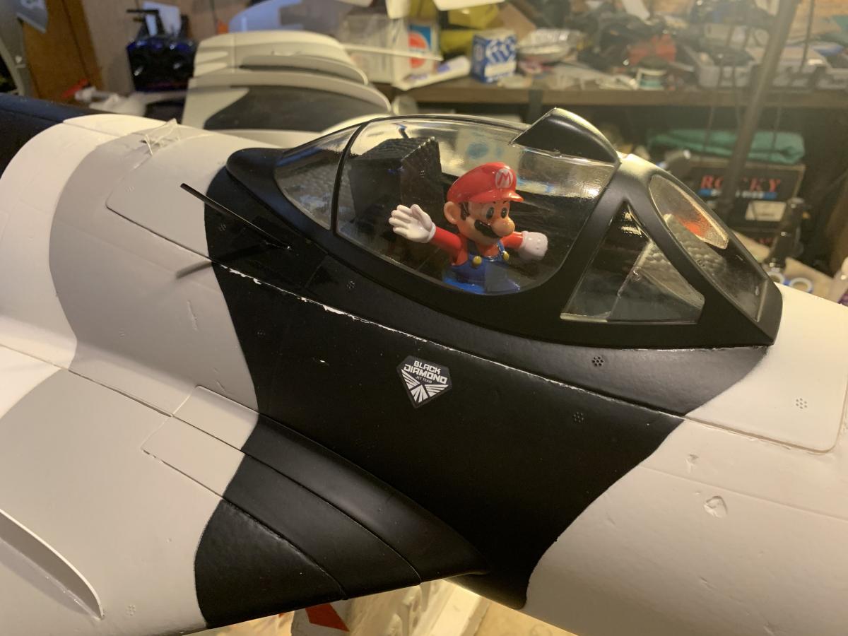

    • Someone was asking about what is the right size for the pilot figure?

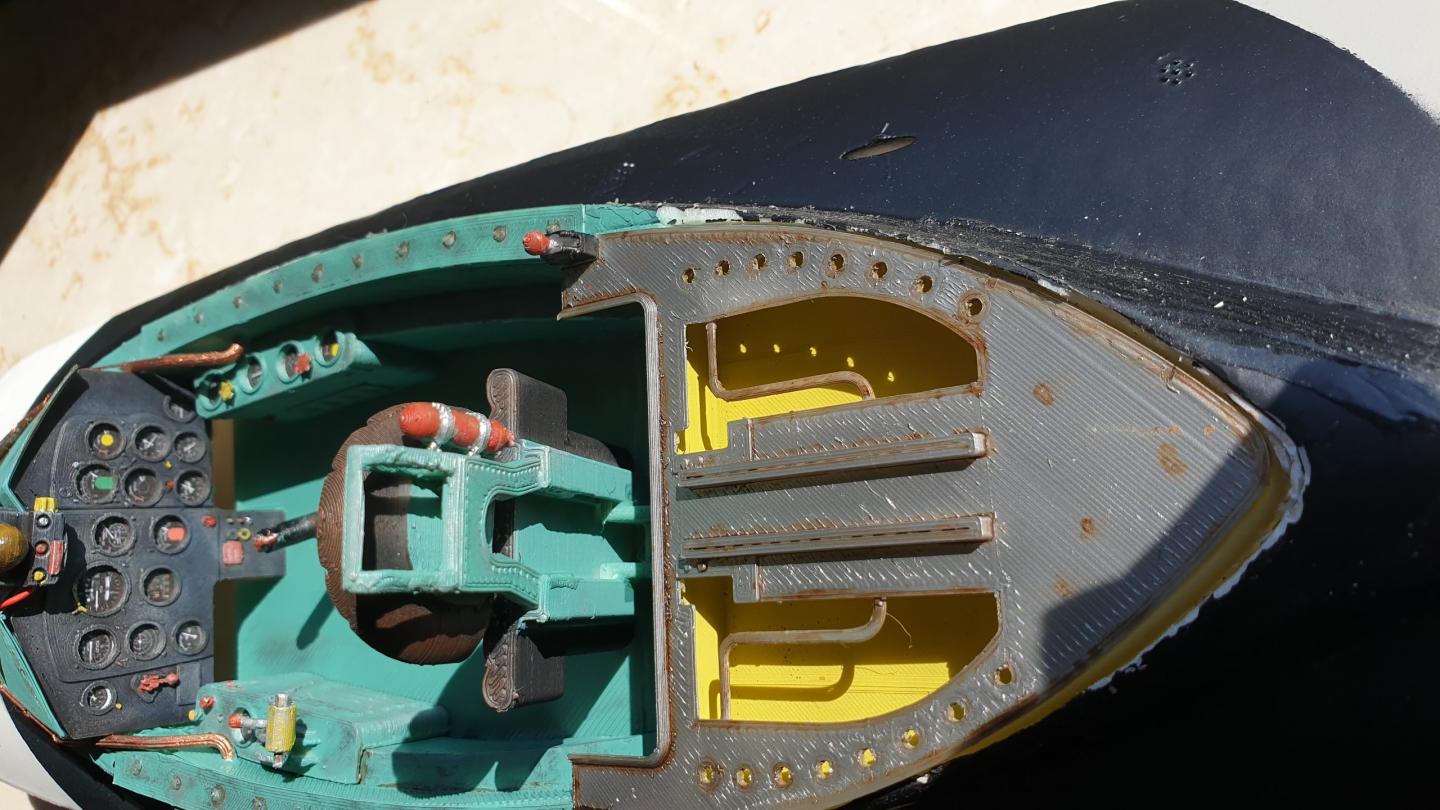

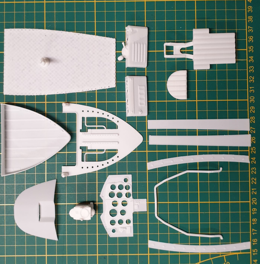

            • Small reminder : The MiG-17 cockpit set is still available! STL files if you can print it yourself, but also complete sets.
              Please contact me at pat.verlinden@telenet.be
              • Hi everyone!!! Patrick just shipped my order and sent me pics!!! His 3D stuff looks like a winner! I will post pics and update here when they get to Texas! Excited to add some details!!! Thanks Pat!!! Jerry

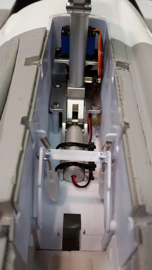

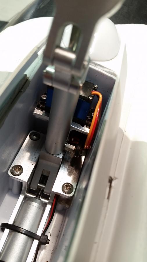

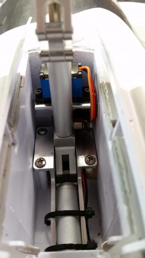

                    • This is a little off-topic but I’m betting someone will be able to help me.
                      I hate RC landing gear. Now that I have that context established...
                      A friend at the club just bought the Avios MiG 17. He was raving about the gear retracts. So I bought a set, thinking it would be a great project to integrate them into one of the EDF models I have that had gear issues flying off our grass field (IE all of them!)
                      I got the retracts quickly from HobbyKing! And I started
                      studying them to see why they are so great. Obviously they are very different than most retracts, etc. All metal. Sturdy. Nice.
                      But wait! Only 2 conductors in the wires to the motors! And, where is the steering arm?
                      Yep. There is a special control board required. Location: Hong Kong. Ordered one. 3-9 days shipping. Can’t wait..
                      My actual questions:
                      Is there anything I need to know about connecting the special board to my receiver? I read something about these retracts perhaps needing a different voltage than usual. Do they just plug into a standard receiver and the board does the rest?
                      And, it looks like the steering servo mounts to the strut and swings up and down with the gear. Is that right?
                      Any other insights and random thoughts about these retracts would be greatly appreciated!

                        • Originally posted by EDF_Lover View Post
                          I can't help much with the question on the board (My PNP bird came with the board already installed) but I can tell you that everything plugs into a regular receiver and the board does the work of sequencing the gear. Although it seems to be finicky and so I cycle it each time I fly.
                          The steering servo is mounted on a metal plate (shaped like a "C") that is attached to the strut, so yes, it does swing up and down with the gear. It works well, but that plate can be bent in a hard landing and then the steering will be off-center. That happened to me and it was very easy to straighten it out - but I wasn't very happy with how easily it bent. I noticed HK sells that plate as a spare part. So I ordered one!
                          • That’s exactly what I needed to know! Thanks!

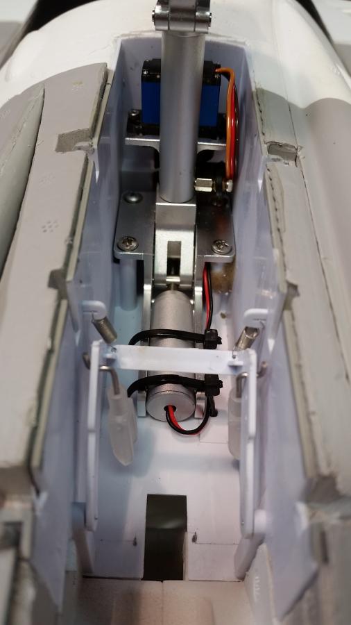

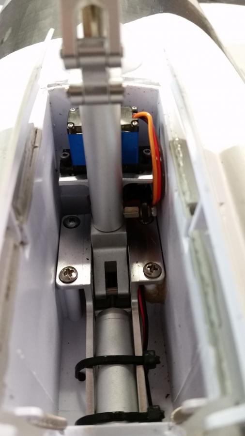

                            Is there any chance you could post a picture of how the steering servo connects to the strut? I can imagine how to rig something but it would be great to see how Avioys did it.
                            Thanks do much!
                              Thanks so much!
                              Hey there lover ,
                              Sure, here are a few shots. Its not easy to photograph this, since its a small space and the servo is mounted to the back side of the strut.
                              But here you go.... the model is upside-down obviously, and the view is towards the tail.
                              (In the first pic, the doors are disconnected)
                              The black zip-ties that you can see lock down the retract to the floor and prevents the retract unit from being forced backwards in a hard landing.

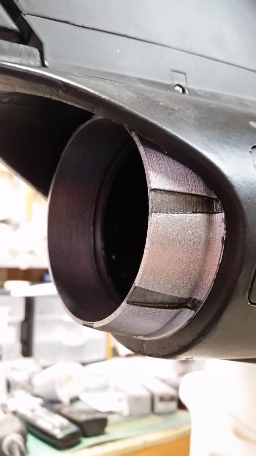

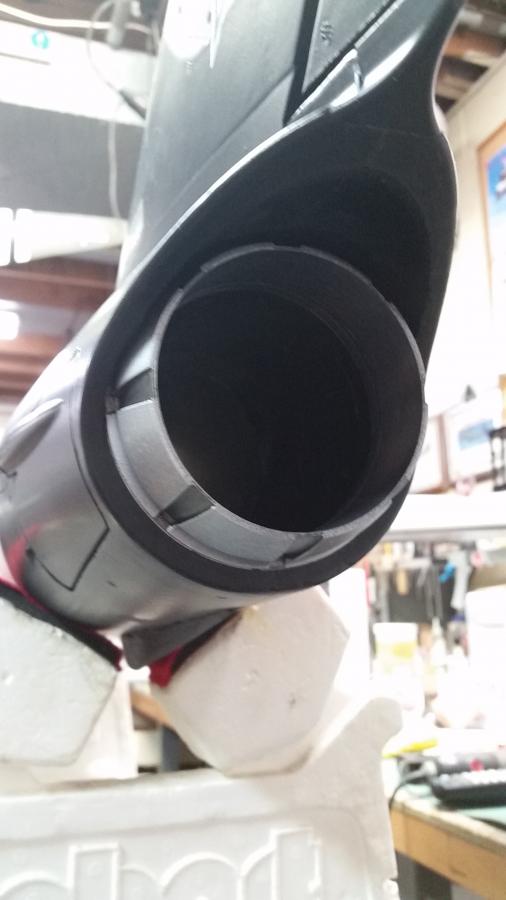

                              • I printed "Superhero's" 3D-printed tail nozzle that he designed for the MIG (you can find it here on Thingiverse) and installed it this evening after a quick paint job.
                                It fit perfectly. Its very simple and looks great!
                                The original foam nozzle pulled off easily.
