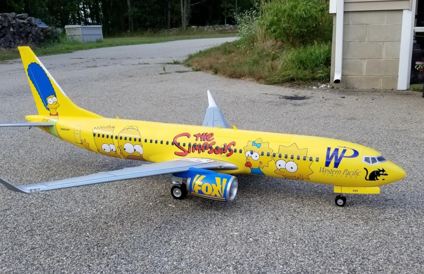

    Still have a few more minor detail graphics to add .... but was anxious to fly it. I modified the winglets and the rear of the engine nacelles to make it look like the older B737 that Western Pacific use to fly.
    Maiden flight went well .... but I will add a bit more up elevator throw for the next flights. I used a 6S 6000 mah pack, and am happy with that size.

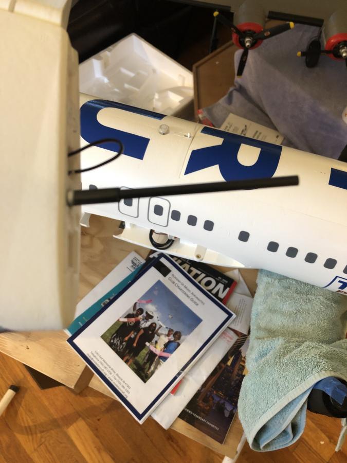

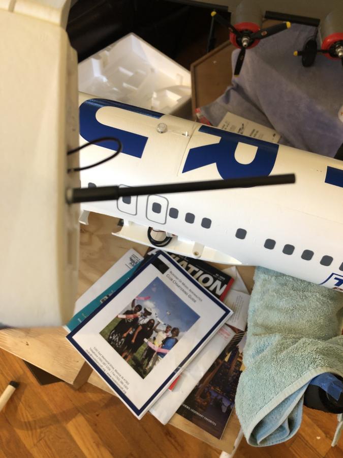

    For added structural strength to the horizontal stab, and rear wing tube I have added a 4 mm carbon fiber rod inside the rear wing tube and the horizontal tube for greater stress factors. I have done this on other planes and it does Increase the structural strength which decreases flex of the surfaces
    That "lake" makes for a scenic backdrop but it's also a scourge. No wonder the club has a rowboat, life jacket and chest waders as standard equipment. Oddly, it's really not a lake. It's an effluent pond from a former gas processing plant. They say it's been cleaned up from the "old days" of sulfur production but after I got back from retrieving the 37, my hands and face (from the oar splashing) were itching like crazy. I hope I don't grow an extra finger or ear.
