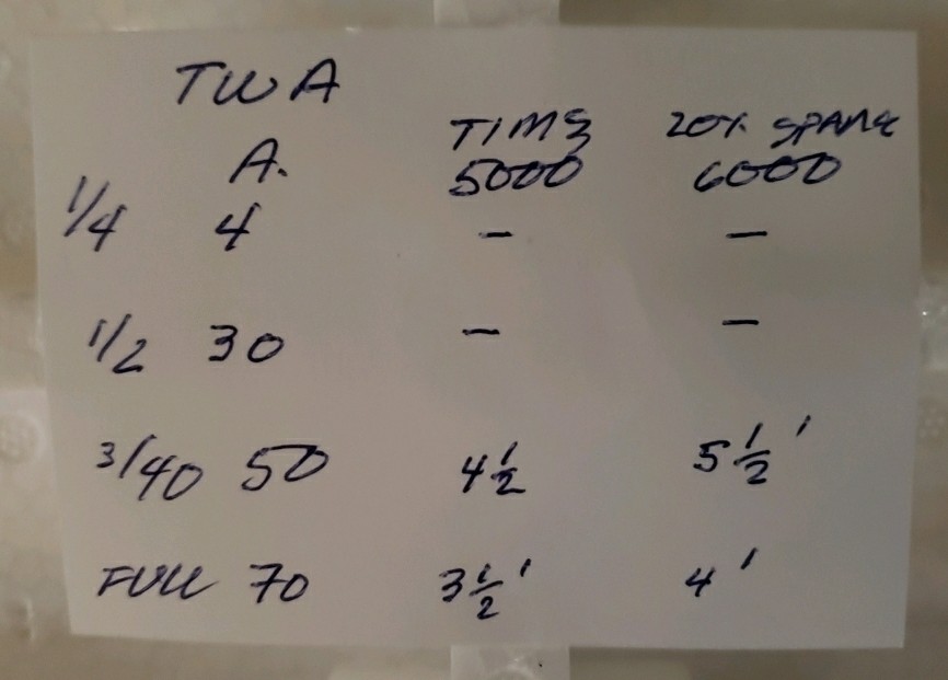

    AL37 power consumption using in line amp meter. Click image for larger version

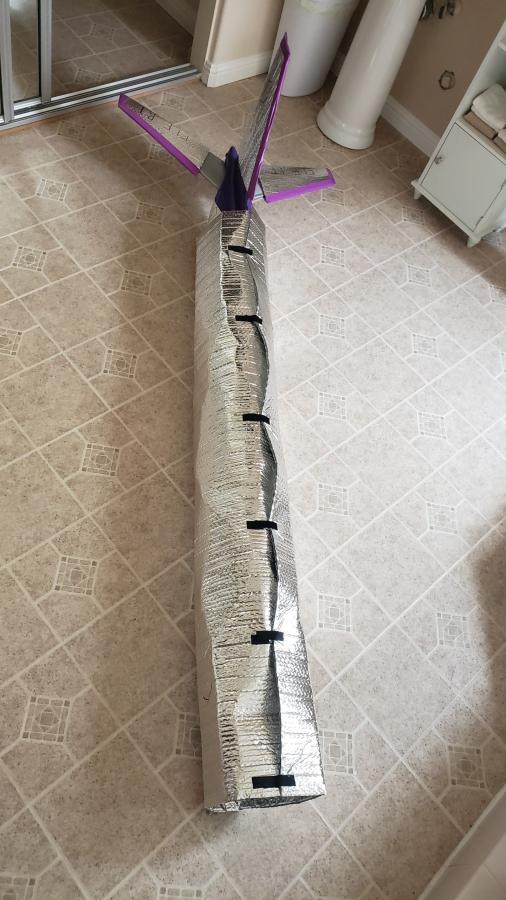

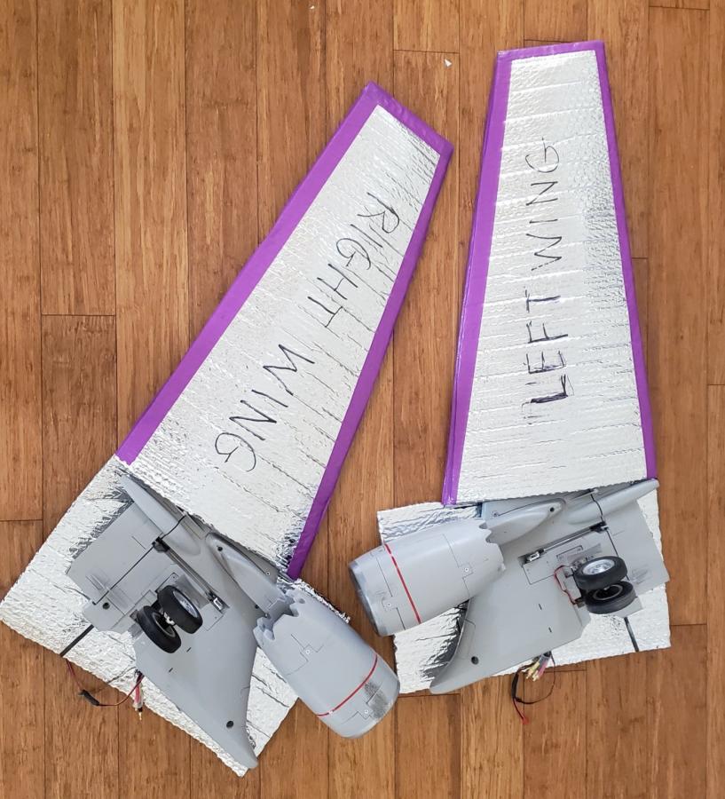

    Click image for larger version  Name:	United 982_ (112).jpg Views:	0 Size:	73.3 KB ID:	280394Click image for larger version  Name:	United 982_ (111).jpg Views:	0 Size:	116.3 KB ID:	280395
    For safe transport, Reflectix. Total costs $55.

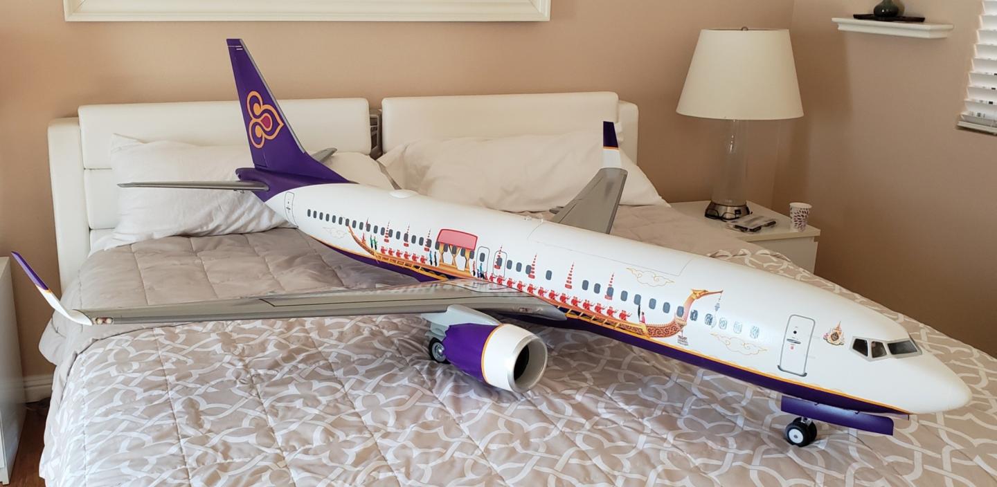

Name:
ID:	280391 Thai Airways Suphannahong Royal Barge - inspired by the 777 livery. 6S 6000 with JP Hobby Brakes. Maiden pending at Coachella Valley RC Club, Thermal, CA.

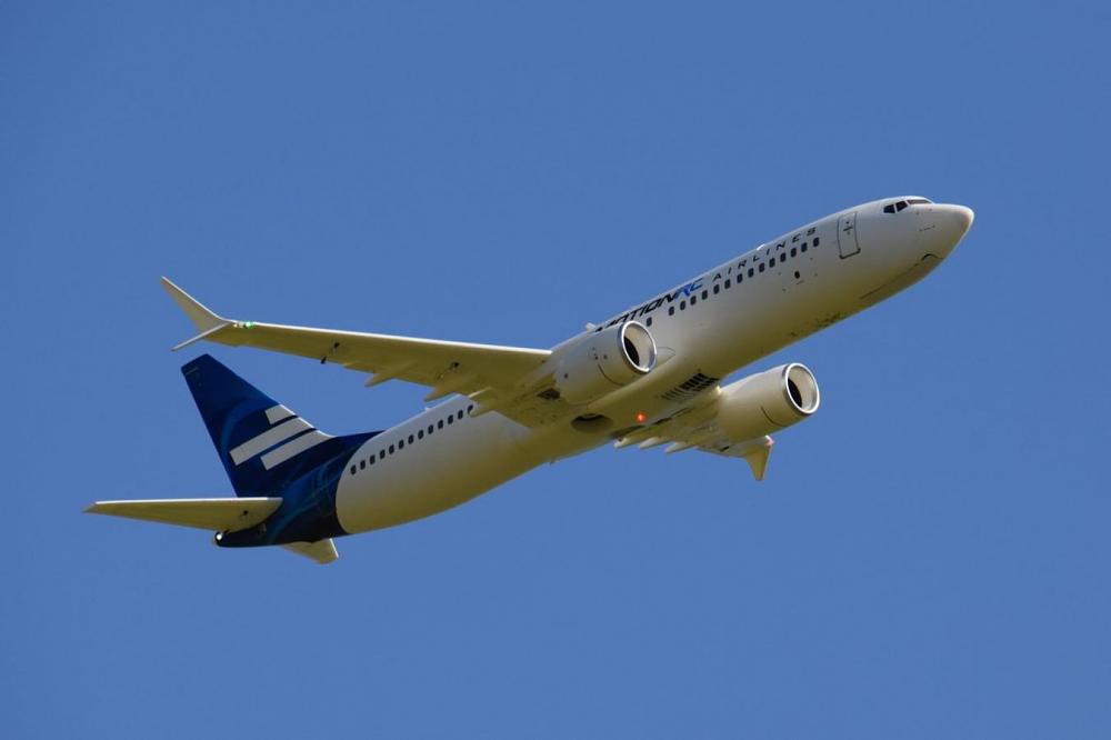

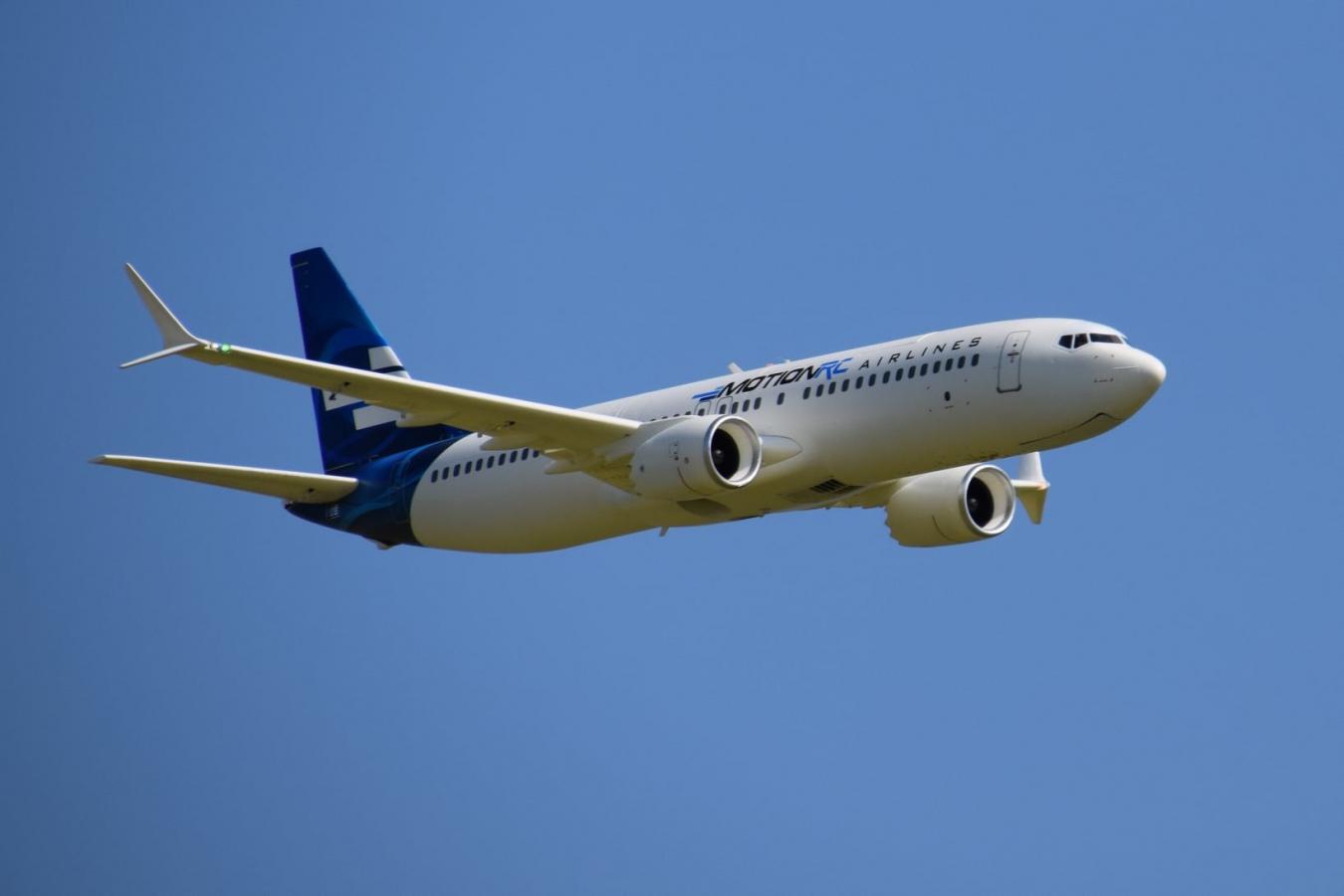

    Click image for larger version  Name:	10-10-2020 Paul and Sparky's Commerical Jet liners in the air 1.jpg Views:	1 Size:	26.5 KB ID:	280111 Click image for larger version  Name:	10-10-2020 Paul and Sparky's Commerical Jet liners in the air 2.jpg Views:	1 Size:	38.4 KB ID:	280112Click image for larger version  Name:	10-10-2020 AL-37 solos shot 2.jpg Views:	1 Size:	41.9 KB ID:	280113Click image for larger version  Name:	10-10-2020 AL-37 solo shot 1.jpg Views:	1 Size:	42.4 KB ID:	280110Sparky and I were able to share the skies together at our club fun fly this week end....pretty cool airshow

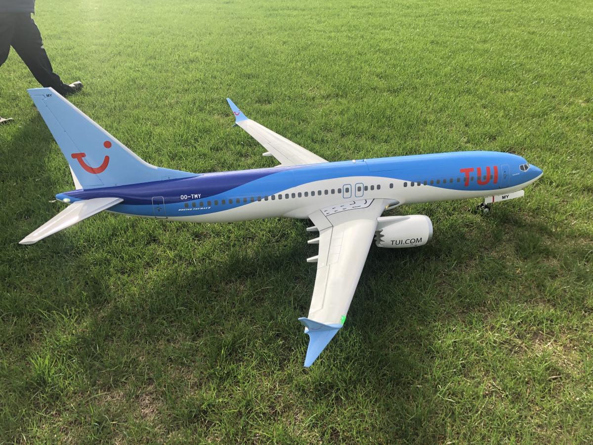

    Originally posted by Speedrick
    Ok,
    maidened mine today, with the CG as indicated.
    During the take off roll, it became obvious that the CG was way to much fwd.
    It was such that I had no more elevator to flair during the landing.
    Apart from that, it was a successful maiden flight on the 737 today
    have a nice one,
    Eric

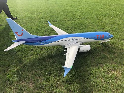

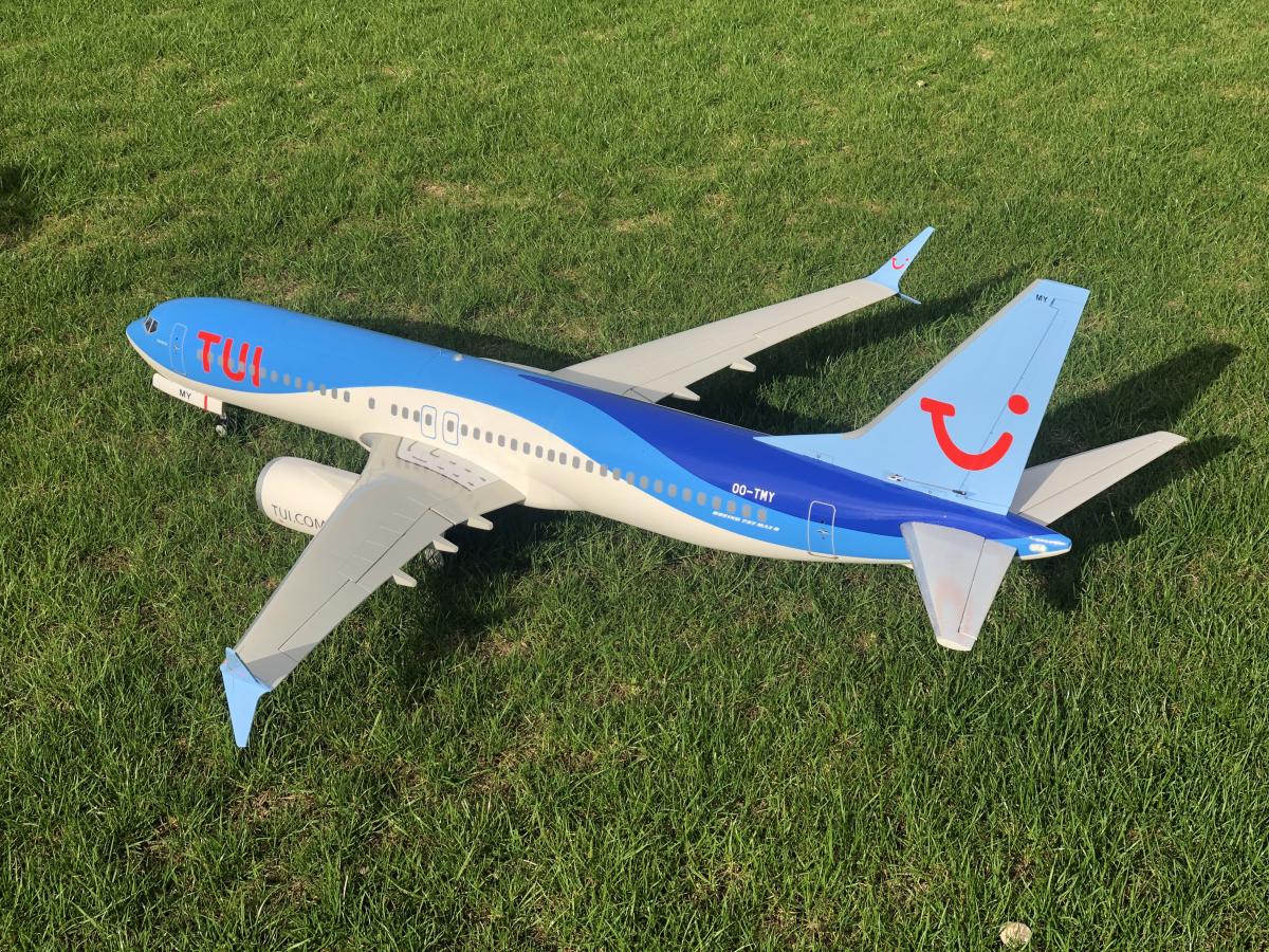

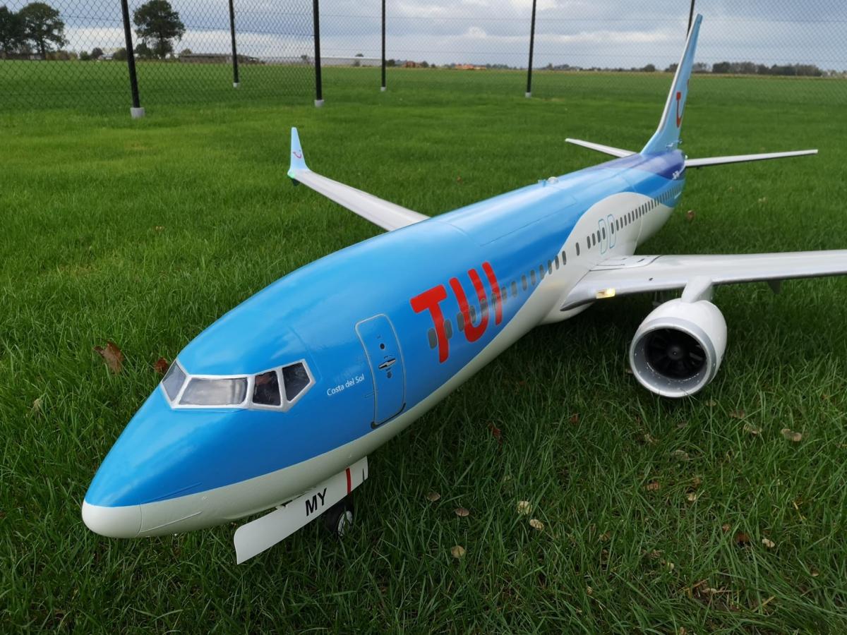

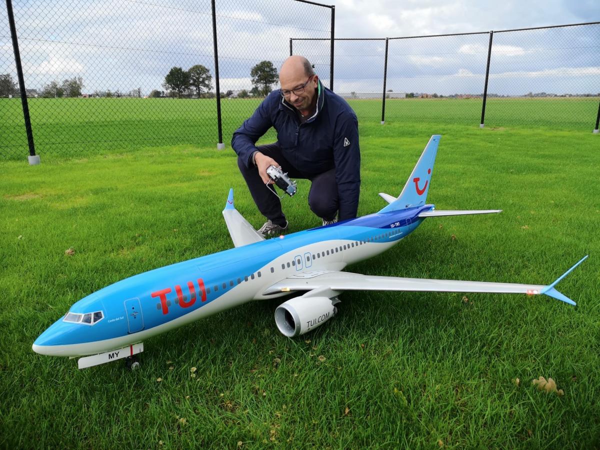

    That is a beautiful job on your plane!! Its stunning!
    The marked CG on virtually all FW planes is too far forward, its a "starting point" and virtually all of us prefer to move the CG back. "How far back" depends a lot on what you like in terms of the model's performance. For the AL37, try moving the battery back 5mm on each flight until you like it. Don't go back further than that!
    I took an airborne video with my AL37 today. It was quite windy, made all the passengers very sick. :face_vomiting: But I made a perfect landing on one wheel, then the other one!!

    Ok,
    have a nice one,
    Eric
ID:	280008Click image for larger version
ID:	280007Click image for larger version
ID:	280006Click image for larger version

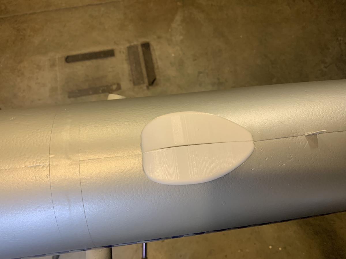

    Thanks again for sharing the files. I printed them out but unfortunately, there is a gap along the sides if you if you glue both halves together. I don't think there is enough curvature to the mounting area where the antenna meets the fuselage. I carved a little off of the front and back ends to help and opted to allow for the seam along the top. It'll be easier to fill and sand now. I'm grateful for your contribution and it works for me but just wanted to give you this info incase you wanted to tweak the design a bit. The photo shows the gap after some carving. Prior to, the gap was much larger. Just an FYI. Click image for larger version
    Thanks for letting me know, I'll create more of a curvature, looking at the pictures I see what you are saying.
