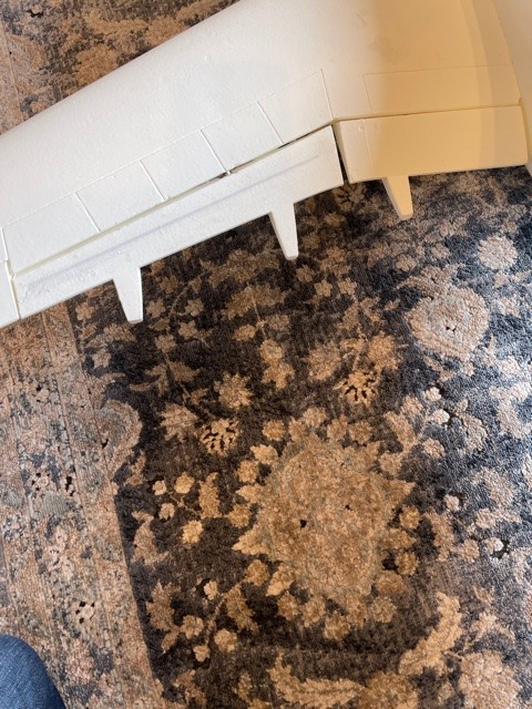

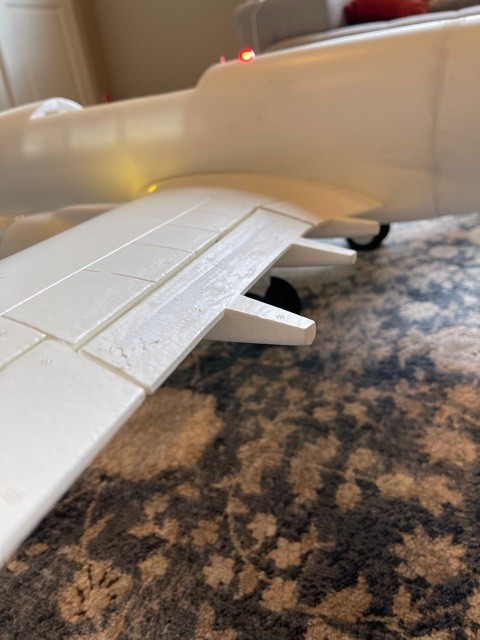

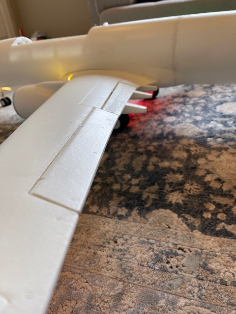

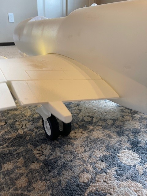

    I have a question about the neutral flap position. I have aligned the inner and outer flap w/ the leading edge of the aileron. I noticed the alignment causes an inward curve towards the fuselage which is causing a bit of a gap. Trimming up the inner and outer flap causes a misalignment. I hope this make sense. I have uploaded a few pics. Does this look right?

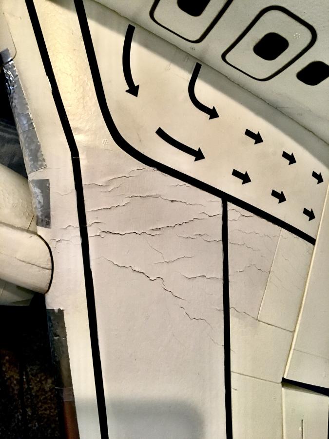

    If you will fly it a lot, consider reinforcing the top skin with carbon fiber inside the wing’s wiring channel as discussed in this forum. Avoid the top skin cracks like I got after a lot of flights. See photo below after 2,000 flights and aerobatics.
    Search “ferrite”, “choke”, “RF choke” for info on these important items.
    -GG
