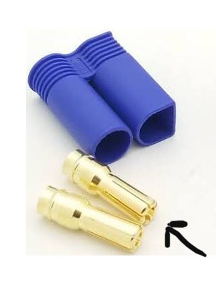

    Hi ABJ, I had an EC5 connector on an AL37 get hot enough to form a bubble on one side of the connector. The cause was a poor solder connection inside the male side on the contact screen that expands off the center shaft and makes contact with the inside of the female EC5.
    If you suspect it is the EC5 getting hot, get a very bright light and look inside the male EC5. Look for damage. Also, consider replacing the male EC5 with the split-shaft type of EC5. See photo below…
    Tip - After about 2-3 flight sessions, I wet a cotton swab with alcohol and clean out residue that forms inside the female connector of all my batteries. You will be amazed how dirty the cotton swab can get. Clean=less resistance=cooler connector
    A very warm EC5 = ok. Hot EC5 = there is a problem.
    Note: There are some good YouTube videos showing tricks to solder AWG wire. Watch a few. You should be using 10 AWG wire.
    -GG

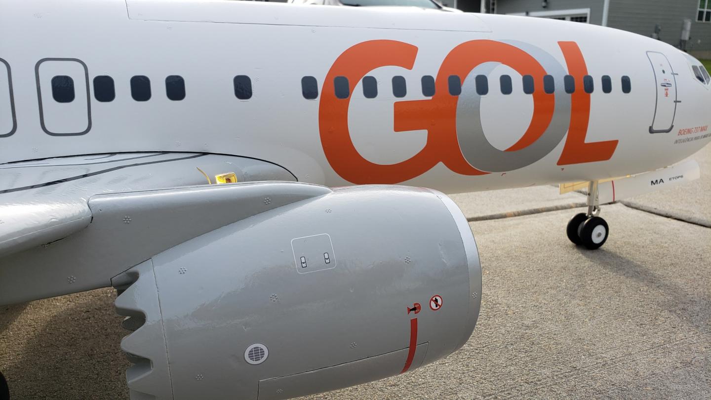

    Click image for larger version Name:	20210711_210841_1.jpg Views:	0 Size:	184.5 KB ID:	318568 Finished my 2nd AL37 in Voegol livery. I've always loved this scheme. I originally asked Callie back in 2019 and finally did it. Click image for larger version Name:	20210711_212031_1.jpg Views:	0 Size:	280.9 KB ID:	318562Click image for larger version Name:	20210711_190336_1.jpg Views:	0 Size:	128.3 KB ID:	318563Click image for larger version Name:	20210711_185831.jpg Views:	0 Size:	200.6 KB ID:	318564Click image for larger version Name:	20210711_195110.jpg Views:	0 Size:	153.8 KB ID:	318565Click image for larger version Name:	20210711_185345.jpg Views:	0 Size:	254.7 KB ID:	318566
    Beautiful, I guess it's safe to assume you kinda like the AL37!
    Note: There are some good YouTube videos showing tricks to solder 10 AWG wire. Watch a few. You should be using 10 AWG wire.
    -GG

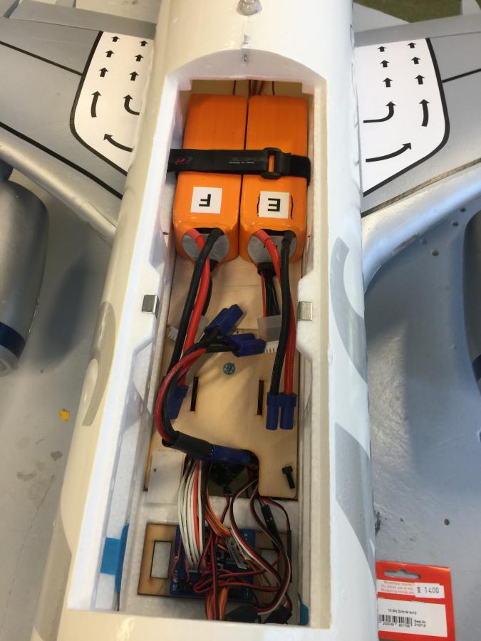

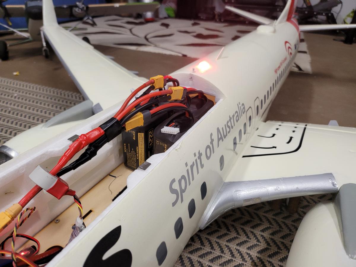

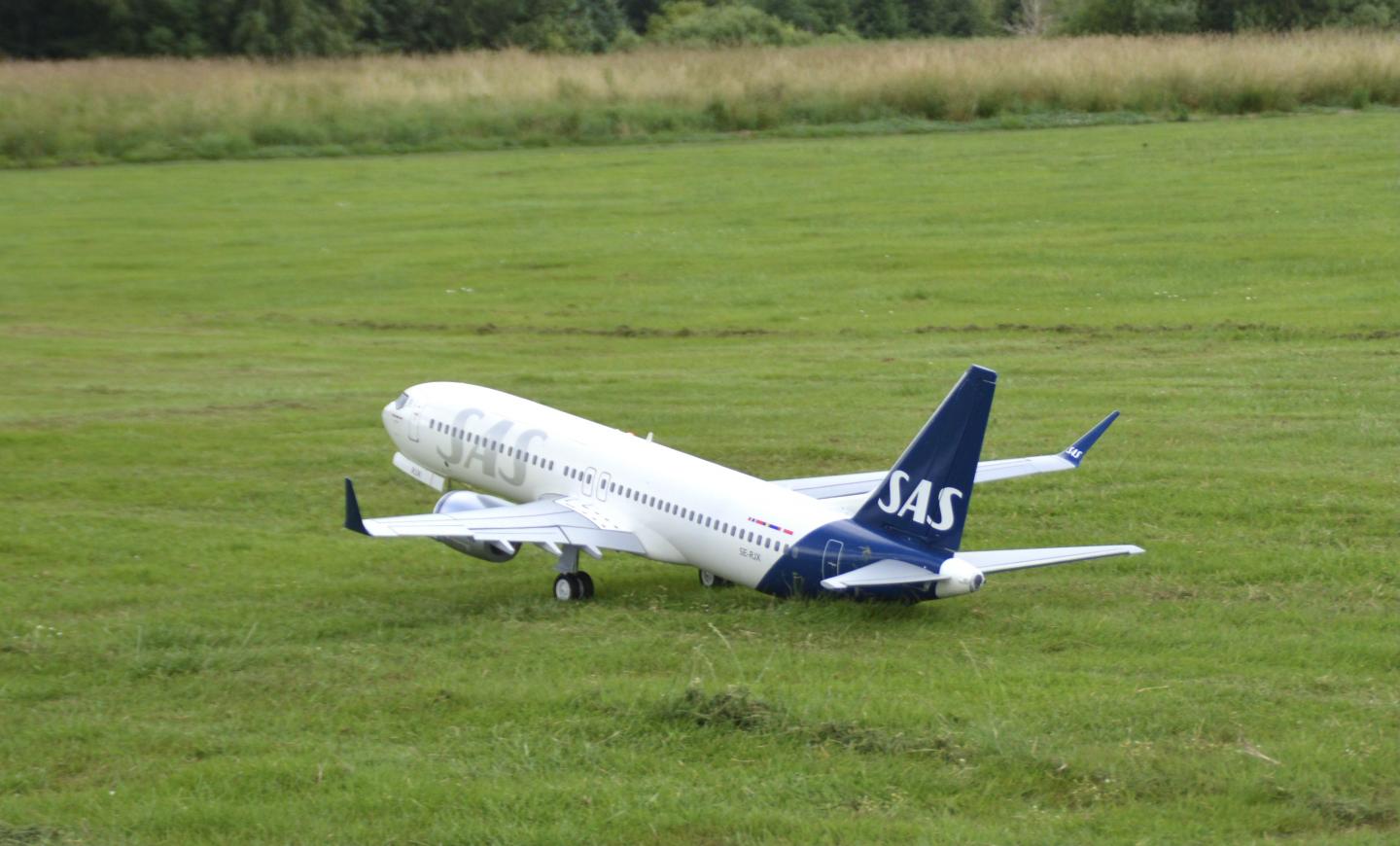

    Maiden done, all vent well and my concern about the extra weight by flying with two 4000 MaH Bats proved not to be a problem, only catch was it required a rather long takeoff run, but landing was fine with plenty af elevator authority to flare.. However i found out that supply cable from bat's to ECS got extremely hot, which i think i strange when considering that i only had full throttle during take off, rest of my flight was at half gas, just cruising around .. Flight time with 2 x 4000Mah 70C was 4 mins, and the cells were at 3,75 after..
    Im suspecting the factory wire Y connection from ECS to Battery connector might be soldered bad, or just made of to thin wires..
    The heat and the power consumption seems strange,,
    Does anybody in here have the same heat build up in cables and connectors when flying.. ?
    I fly my 6S Freewing Hawk T1 & F-35 frequently and have never experienced warm cables / connectors
    :-) Anders
    You're flying off what looks like fairly deep grass. It's going to take a long distance to get off the ground. When I fly off grass, this plane can take twice the distance to lift off.
    I don't recall anything getting hot, maybe the battery comes down a little warm but that's it.
    :-) Anders

    Two 4000mah, 6s, 70C LiPos shouldn't weigh 4800g. Is your scale calibrated correctly?
    Unless you hit a hole or bump in the grass or land real hard and heavy, the gear should be OK. I've done it a couple times with mine but I didn't like it. Lots of grass get sucked into the engines.
    PS. Nevermind, you're talking about the weight of the whole plane and batteries.
    Yes.. total airplane weight is 4800G. Batteries alone are 1240 G.
    Hope to survive the GRASS experience :-)

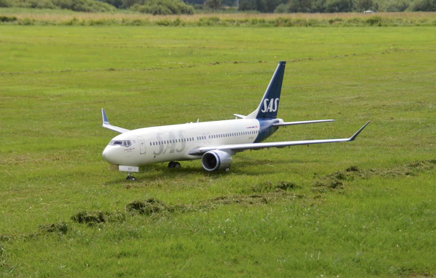

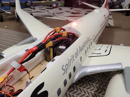

    Ready to maiden my AL37 in SAS scheme, have been reading this tread through for info an battery size and im planning to use 2 x6S 70C 4000Mah bats in parallel, mainly because i have a bunch of them on stock. i have modified the battery tray to be able to place batteries further back to balance on the factory CG. It balances perfect and ends up at 4800Grams in total weight.
    ? please share if you have any experience flying with dual bats at around 4800G on the airframe. Im flying of grass surface in my club and my main concern is the stress on the LG with the added weight, Will it hold :-)

    I haven't tried yet but next trip out to the field will be trying 6s4p 4000mah Li ion for hopefully a 15min flight lol. That's about 1800g of battery.
    Click image for larger version  Name:	20210702_172732.jpg Views:	4 Size:	115.1 KB ID:	318205​​​​​​​
    Justin La has a vid on YouTube of a 2x5500RT endurance test and the plane handled it fine. I think managing speed and bank angle in the turns will be more critical than the landing gear - these are some of the best retracts you'll find on an EDF for my 2c.
    Thanks.. Your setup looks very similar to mine.. Nice to hear the LG's are tough, as im not concerned about the flying as
    long as i keep it within the scale flight envelope for a Passenger jet.
    Hope to fly tomorrow, will post result
    :-) Anders
    ? please share if you have any experience flying with dual bats at around 1240 G for both. and total airplane weight at 4800 G,
    Im flying of a need grass surface in my club and my main concern is the stress on the LG with the added weight, Will it hold :-)

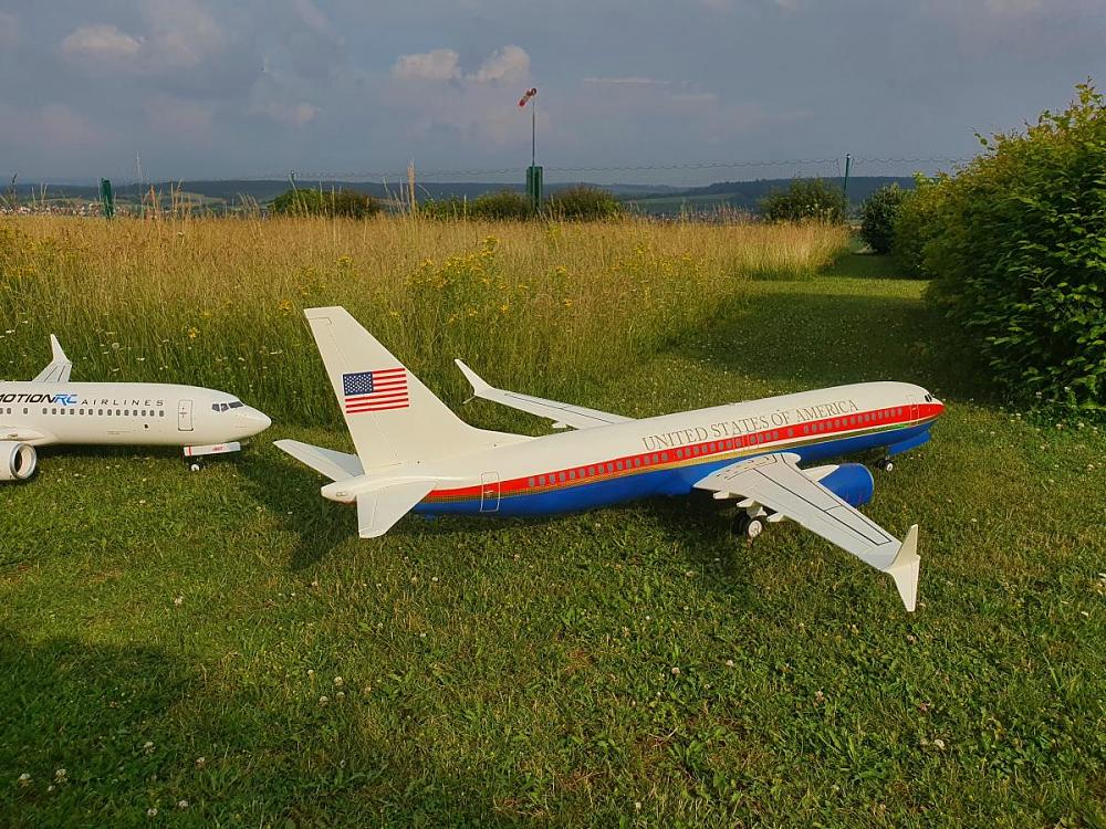

    MAIDEN ALREADY
    Airforce one with NEW design
    from my friend, mine is in background
    we like them🤩 flying regularily since 1.5 years from grass
    w/o any issues
    use just big batteries up to 8.8Ah and extended battery bay
