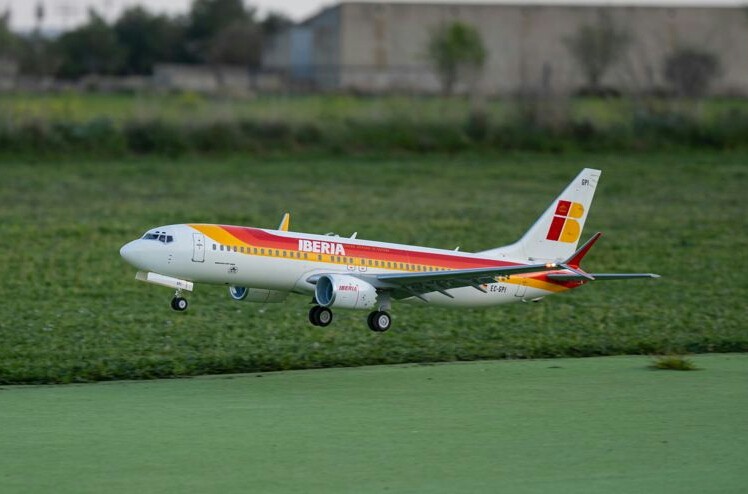

  • aljoma

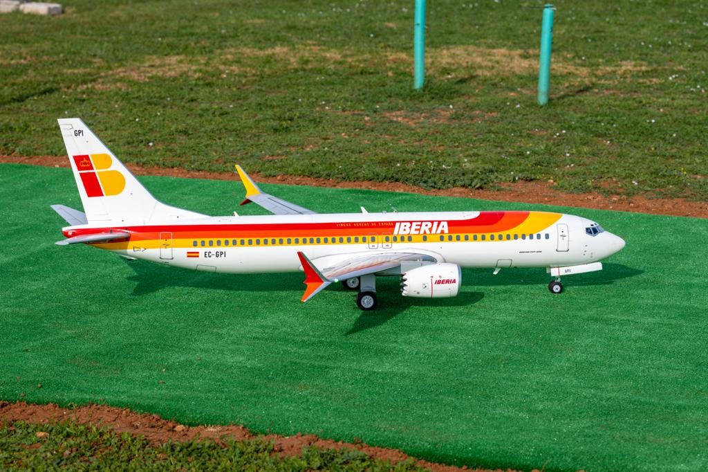

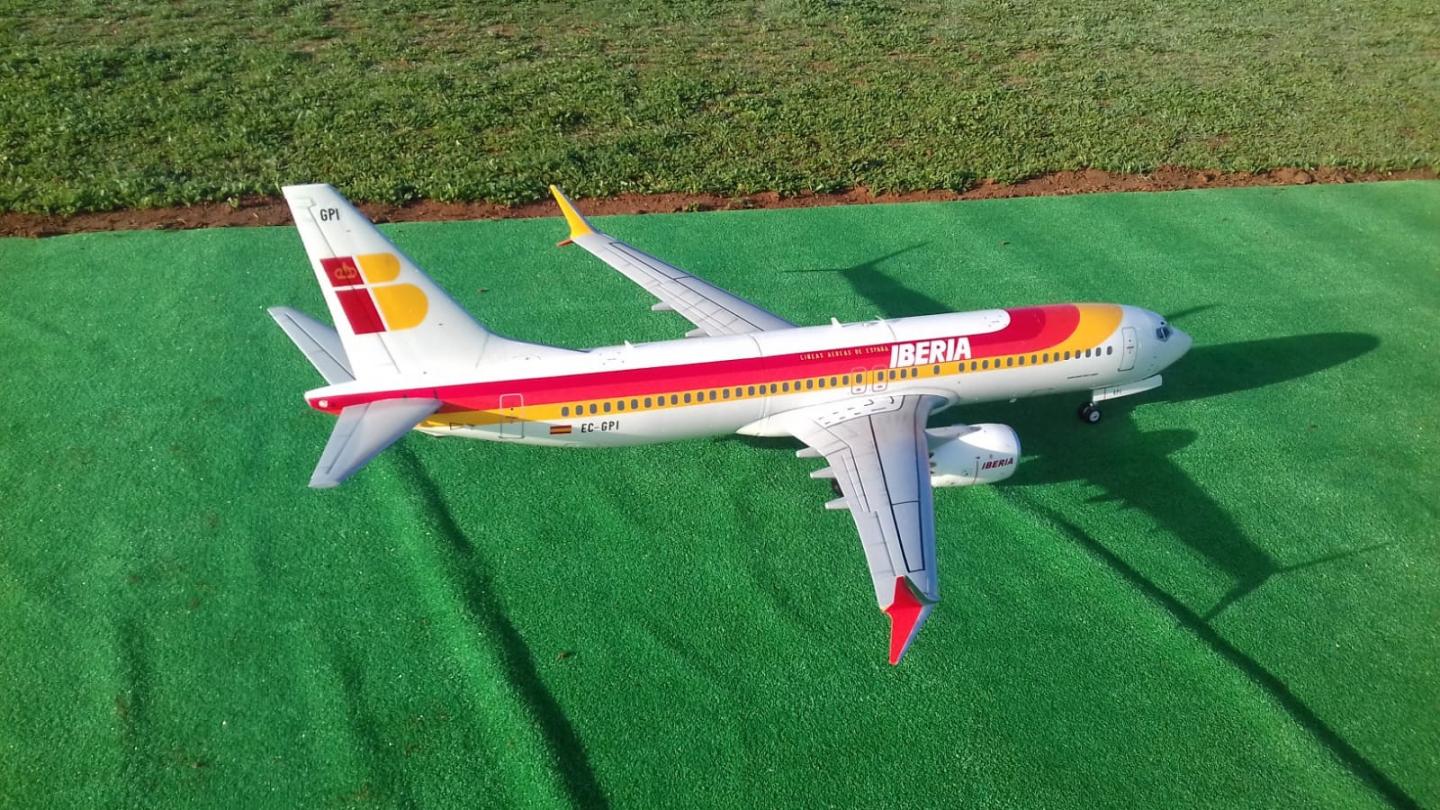

    Bueno después de mucho sudor, cinta y botes de pintura el Boeing ha quedado espectacular
    Os dejo unas fotos
  • hcew
    Hello
    Friday was maidenflight. Weather good, gras cut and up in the air.
    Flies very good and looks awesome.
    Thanks to CallieGraphics for the decals

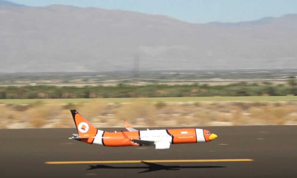

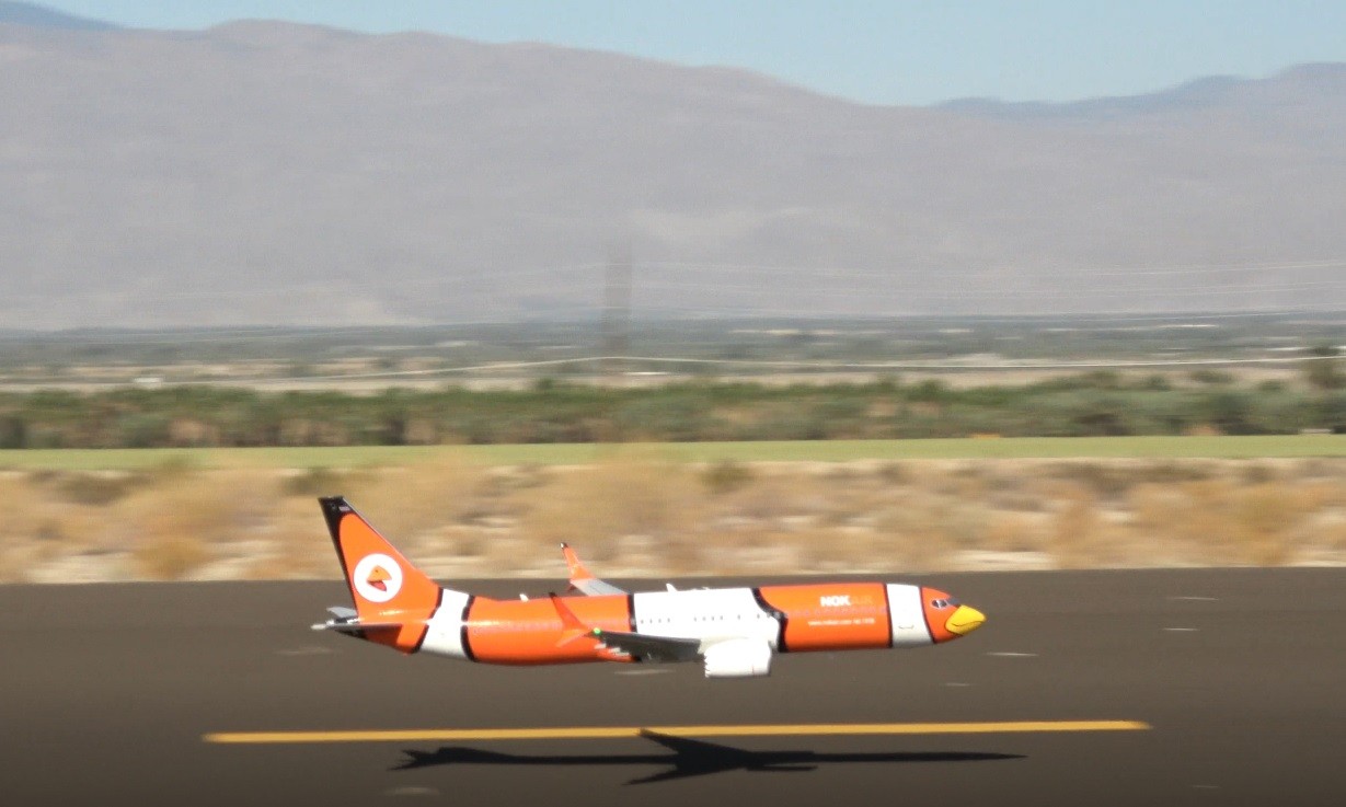

    This last week end, we took the Nok Air out for a spin. The skies were clear and blue. Dan Metz of the Coachella Valley RC Club flew the plan while Bob Husar, builder/owner, recorded the flight. We had an RC truck with a 4k runcam 2 to capture the low passes. We call it a mobile "buzz cam". Here's a shot where Dan took it down to about 12 inches (or lower?).

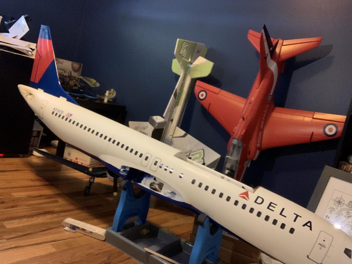

    Certainly not perfect but I'm very happy with my progress, got a ton done yesterday:

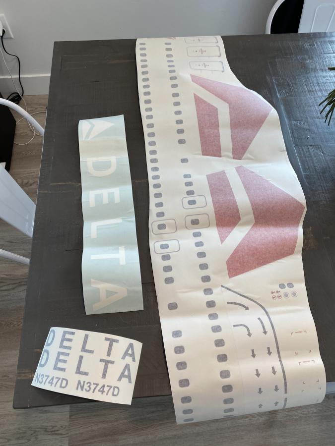

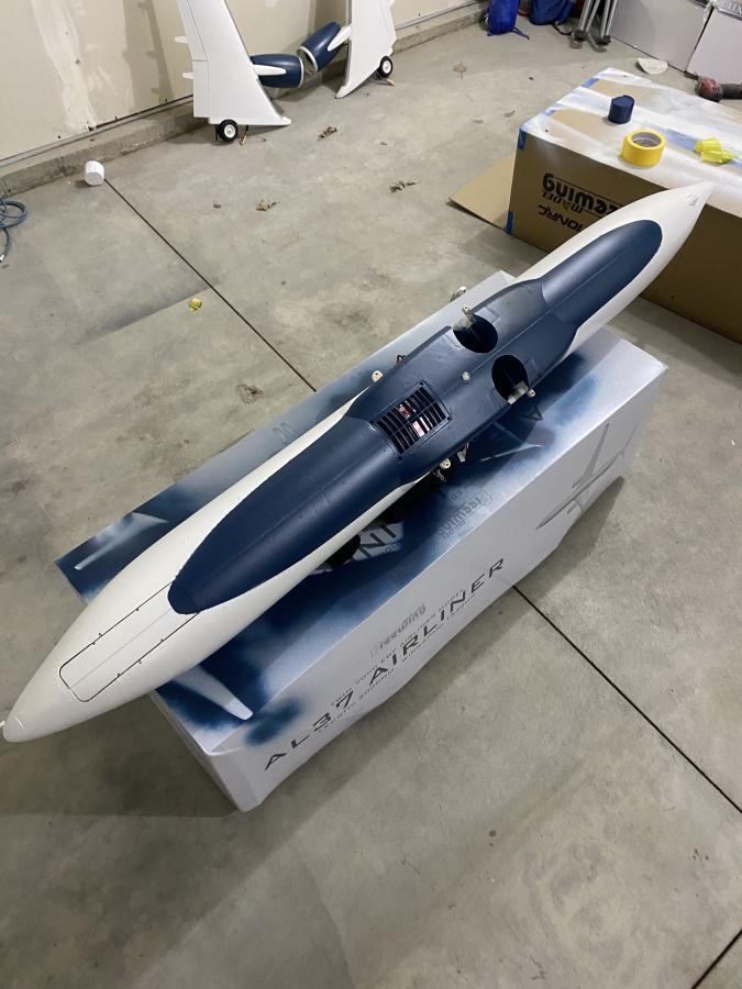

    Remove the vent. Apply decal over the place where it goes (over the hole). Take sharp razor and cut the decal away where the vent hole is. Re-apply the cut off decal onto it's backing paper so you can possibly apply it over the vent itself and cut slits where it needs it and push the decal parts down into each individual slot.
    Makes sense, thanks! Also duh, should have thought of just removing the vent to paint. Hoping to get the whole belly painted up tonight.
    Thinking I'll remove the grate and paint that, then fully tape up the esc's and paint the hole around them a bit to get some decent coverage below the grate. Will definitely be a bit of a surgical process trying to get the delta logo to be flush with the grate but think you guys have given good direction on that.
  • Topshot19
    Originally posted by ndrew3
    Funny that you say this as I'm literally in the same boat with the same livery. Is it OK to paint over the ESC vent and the ESC's? I was thinking of masking over it and hand-painting the vents as I wasn't sure if it'd be smart to paint the actual ESCs. The delta logo itself on the belly is right smack dab on that vent too as you note so was kind of thinking of trying to hand-paint that somehow.
    A couple screws to get the vent off to paint. I just pulled it off and painted it so I didn’t have to deal with overspray on the esc’s.

    Originally posted by Topshot19
    How did you put the delta sticker on the belly? I’m having a hard time with the esc vent.

    Originally posted by Tooeleflyboy
    Hello AL37 fans just a quick mention on mine now that I finished my build.
    This is really a wonderful plane with very few if any issues so far since it's release. Let me say a few things I learned along the way. If you add two short servo extensions to the nose gear steering and retract you can move the blue box under the battery tray and get more ribbon cable running out to the wings for easier access to installing and removing it. When installing the main wings take caution with the pre-installed small rear wing spar as I poked the fuselage a few times with it while trying to slide in the wing. Also when applying the decals, watch the posted video and be careful and I had almost no trouble at all with paint lifting.
    With that said I would personally not attempt to use any masking tape on this beauty for painting lines. Freehand is the best (what I did) but there are other techniques that could be used. I even heard cheap (brown) wet paper towels was one of them but have never tried it. On the wing tip winglets some small file work on them goes a long way to help making them slide on and off better. The rear horizontal stabilizers need to be installed at a slightly upward angle. I struggled at first trying to put them in even wondered if they fit correctly and then when I changed the angle slid in without a problem. In closing this was a fun build and have yet to fly it but feel very confident she is more then air worthy based on the hundreds of other flights other pilots have performed on it with no trouble or CG issues. I have also posted a build on here as well.

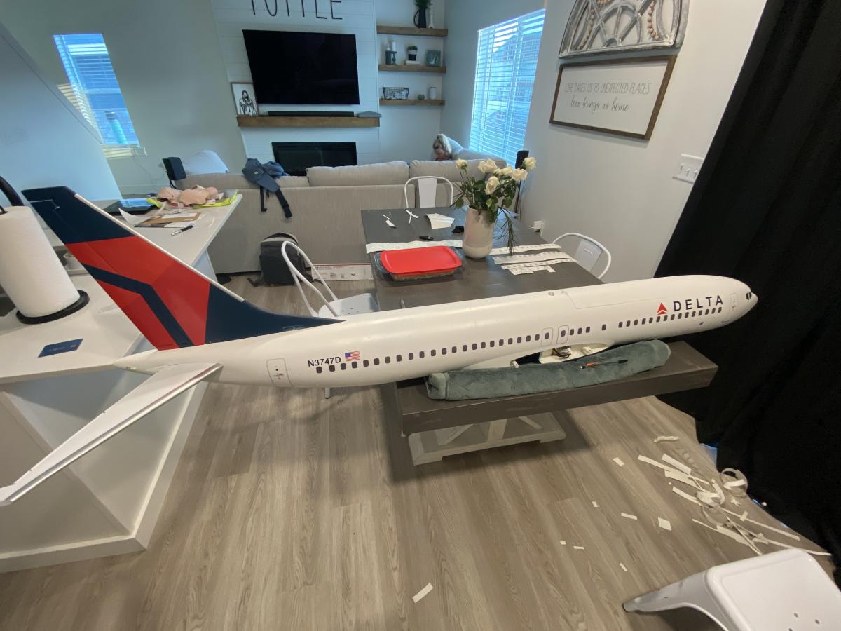

  • Topshot19
    Bought one of the models that was yellow and repainted to the delta scheme. Anyone have experience putting the delta logo on the belly of the plane? How do you do it with the vent port.

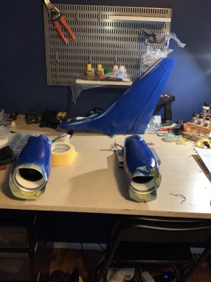

  • ndrew3
    I finally worked up the courage to start painting mine, been sitting in the office for a good couple of months almost.
    Decided there was no way I was gonna paint the whole thing white so just started on the engines and vertical stab with dark blue (Delta livery). Now just need to mask off the big blue belly on the fuselage, kind of a weird shape so will be interesting. Will definitely be getting some color match on each color as I'm sure there will be some weirdness once the tape comes up.
    Overall though I feel like it's going super well, Painters 2X has gone on really nicely it seems and their normal dark blue is so close to Delta's that I didn't even have to worry about matching.
