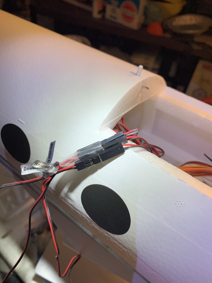

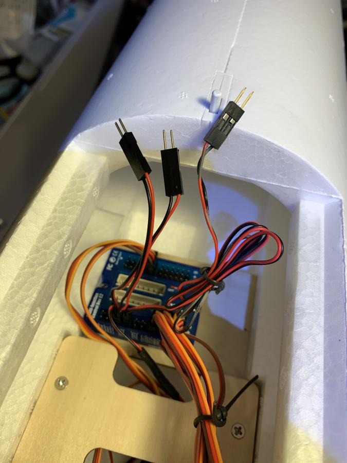

    RE: The 3 light leads from the wing...... Just happened to have a 2-wire light extension cable from a dead plane. Now, I can make the connections from the wing to the blue box in one motion. Tape the 3 plugs from the wing together. Tape the 3 plugs from the blue box together. Equals ONE triple connector. The 2 ribbon cables from the wing and the triple light plugs will be zip tied together so only need to fish one thing from the wing. This now becomes far easier to assemble this plane at the field than it ever was for the AL-37 (requires 5 connections per side = X10 vs X3).

    Thanks for the work around on that. Quick assembly/disassembly at the field is critical for me.

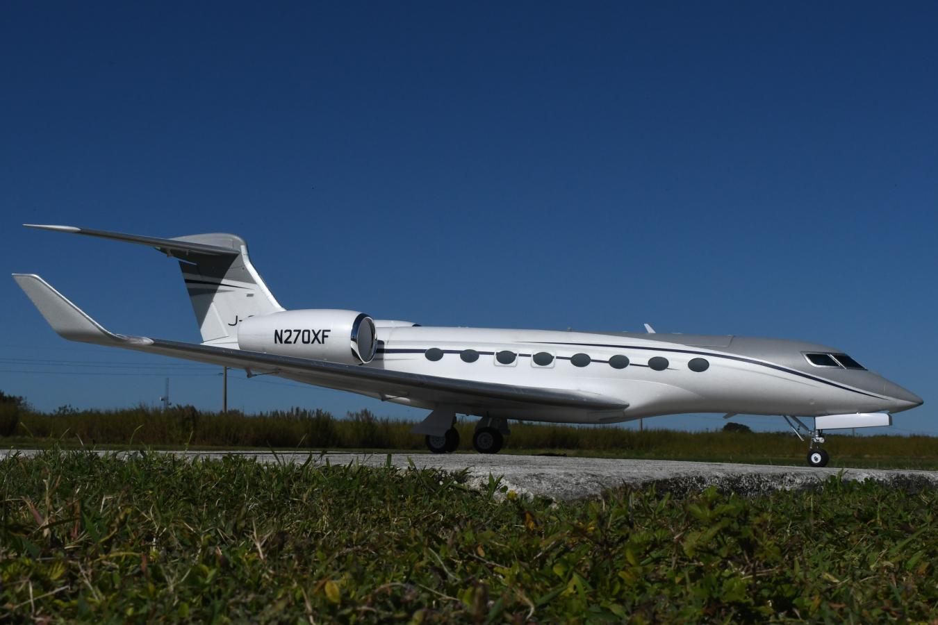

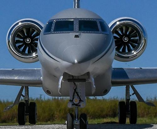

    Finally got to see the BH "Gulfstream" in person and was tasked with doing the photography and video for her website. More in the "What did you Fly Today" thread, but this airframe is definitely a winner. Specs very similar to the FW PJ50 so expect that one to fly just as well. Super stable at incredibly low speed (35% throttle) and plenty of guts to get up and go. While this, like the AL37, isn't exactly my "cup of tea", I can still appreciate a well thought out and manufactured model. I suspect these will sell incredibly well to a large audience and think that after you get your "Gulfstream" (or whatever they're called), it will soon become a favorite. I'm definitely an MRC kind of guy, and never thought I'd say this about the Pj50, but just may have to get one myself. Definitely can't wait to see some of the incredible re-paints that no doubt will be coming in the next couple years like we saw with the AL-37. 7 minutes on a SMC 5300 and over 10 on a SMC 6200. Sweet! I'm positive those of you with a FW PJ50 in your future will absolutely love it!!!

    I like that idea. Simple
    I was planning on trying to find a 6 wire connector. This is so much better
