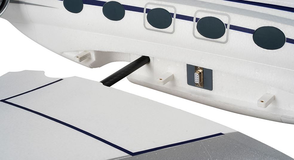

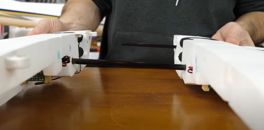

    I did some more detail checks.. here are some major differences.
    1) Wing and its connector (attached pictures). It looks like the RCMotion PJ50 wing connectors with 2 reinforcement rods seems more robust to support the back gear. The Xfly wing only have 1 joint rod in front of the back gear. This could be weak to support the landing back gear. Also, I do not preferred the Xfly connector version, as the wing flex upward during flight, connector could be stressed and loose contact and you would loose airelons controls.. but then again the plane is not going 200mph with high G turn to reach that stressing point.. so just my opinion here..
    2) Motor are different with ESC. PJ50 (2x 2952-2100Kv Inrunner ) . Xfly motors(2 x 2860-KV2200 inrunner ). Not sure which is more efficient or faster..
    3) Landing gear looks different.. not sure which is better..
    4) PJ50 ESC is mounted in bottom back, where Xfly ESC seems to be mounted on wing belly. No big issue in either design here.

    There are some differences. Retracts, control horns, esc location. I think the big diffence is in the hardware. Atleast that I can see.
