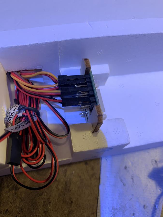

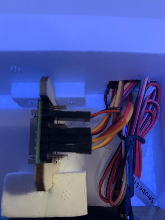

    While taking a break from working on my Flite Test Flerken, I've gone to the next step in PJ50 process. First one was to take inventory of all the parts. The next step was to check that all the servos are working.
    Ailerons, flaps, elevators, rudder, steering, retracts ........................ all work. HOWEVER, take a look at the following pictures of the wing boards, left and right sides ...............................................
ID:	334904Click image for larger version
    Anyone see the difference? One the left, the 3 servo leads are spaced. One the right, the 3 servo leads are all together next to each other. The one all together is INcorrect. The person at the factory didn't follow the directions and just plugged them in "willy nilly". I did a "dry fit" to see how they responded and sure enough, the AIL lead off the blue box worked one AIL and one Flap. Anyone not having worked with these wing boards would have gone "WTF"? Unplugging each lead and trying it in different slots cured it all.

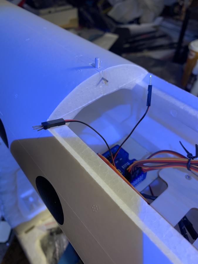

    Next observation .......................... on the wing board, notice the one light lead plugged into the board. Note that there is one empty light plug (2 pins) on each side. Now, why couldn't they have done a little modification to the blue box circuits so that the extra light lead from each side could be plugged into the empty pins? Maybe they can. I'll have to test it out to see the difference. Perhaps they don't blink the way they wanted. This would make it unnecessary to have to plug those into the blue box after the wing got attached. But see the following picture ....................................
    They made a Y "pigtail" that is already plugged into the blue box for those 2 leads coming from the wing. But remember that there is yet a 3rd light lead coming from the light in one of the wheel wells. I presume that this one has to be plugged directly into the blue box. I'll make another pigtail that is plugged into the blue box. Then I tape all 3 plugs together, as well as taping the 3 leads from the wing together. That would make it just one motion to plug those in - 3 motions instead of 5.
    Next, Minwax everything.
