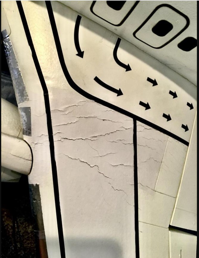

    I'm gonna maiden mine without a gyro (as is my AL37), and I am also going to evaluate whether or not adding internal carbon bracing to the top skin near the fuselage (max bending moment area) might be needed to better withstand the acrobatics I will be doing with it...and also the likely high number of flights it will be making.
    Without the added stress of the engine nacelles, my gut feeling is that the internal top-skin bracing won't be needed. But, if I can add it easily, I will probably add it just to make sure I don't get the top-skin cracking I saw in my first AL37 which I retired after many, many flights due to the ugly cracks that developed and then kept getting worse even after an attempted repair. See photo below:
    Added note: The AL37 I am currently flying with the added internal top-skin bracing is showing only a few very tiny hairline cracks in the paint, but they are not growing in size. A quick sanding and brushing on a new paint coat over the area will make them easily disappear. I've proven to myself that the internal carbon bracing to the top skin is a valid mod for the AL37 to better withstand acro + lots of flights. It might be a valid mod for the PJ50....this remains to be seen.
    -GG
    (First repair attempt didn't work and the paint didn't match. Photo below was taken at #1 bird's retirement.)
