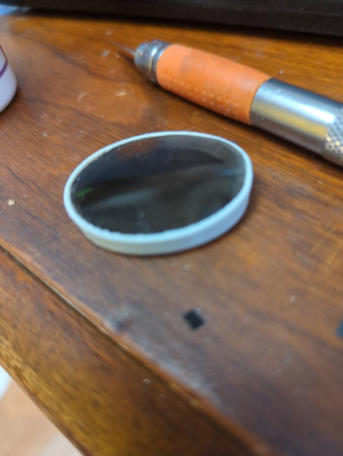

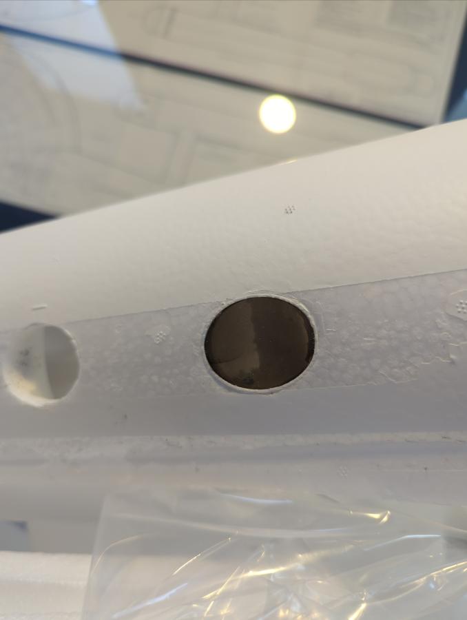

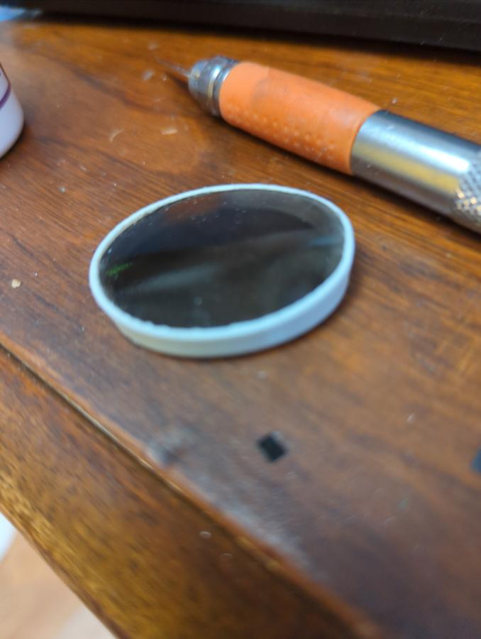

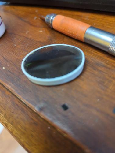

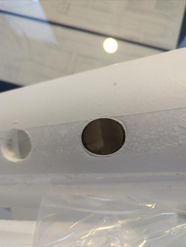

      avanti127 inspired me to go ahead and do a full cut out for the windows. I tinted some sheet plastic with a paint the model car guys use then cut out the lenses with my cricut cutter to insert into the lens holders I printed.
      ​​​​​Almost time to paint, but I think I'll add pilots first.
