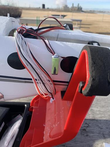

                  Flew my PJ yesterday morning and the flights were just like maiden day - beautiful flights, fast, powerful, solid, picture perfect take off and near perfect landings (I'm still getting used to it) and thrust reverse is fantastic - everyone hears it and looks.

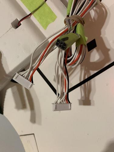

                  Here's a picture of my wing connectors done up so there's only 3 things to hook up.

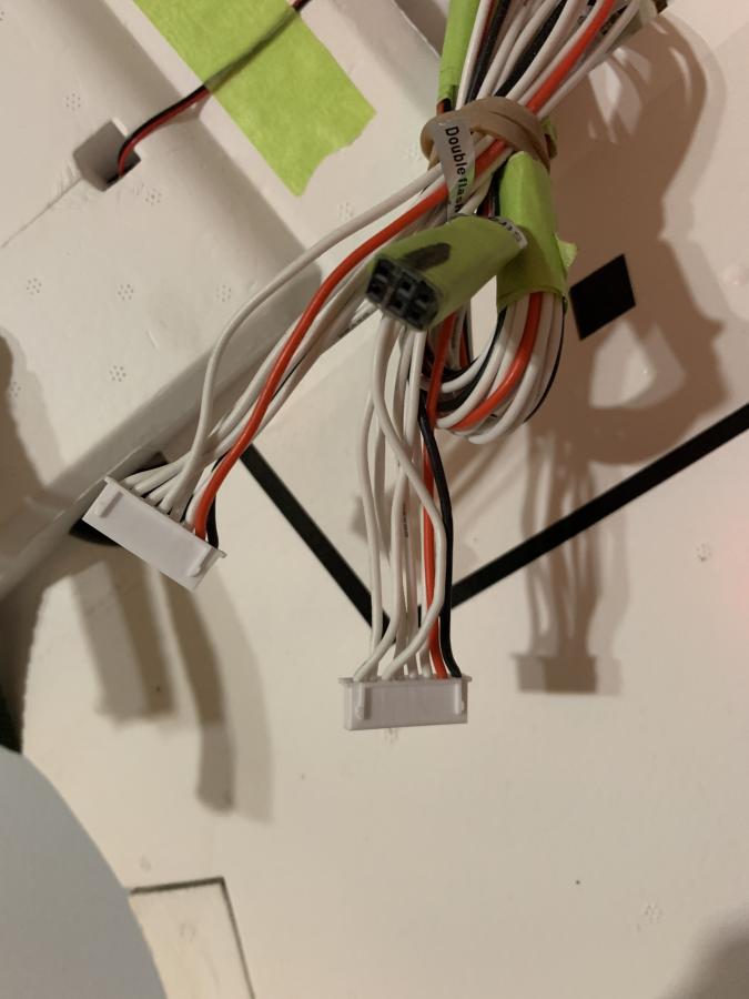

                    A slightly different angle:

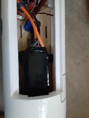

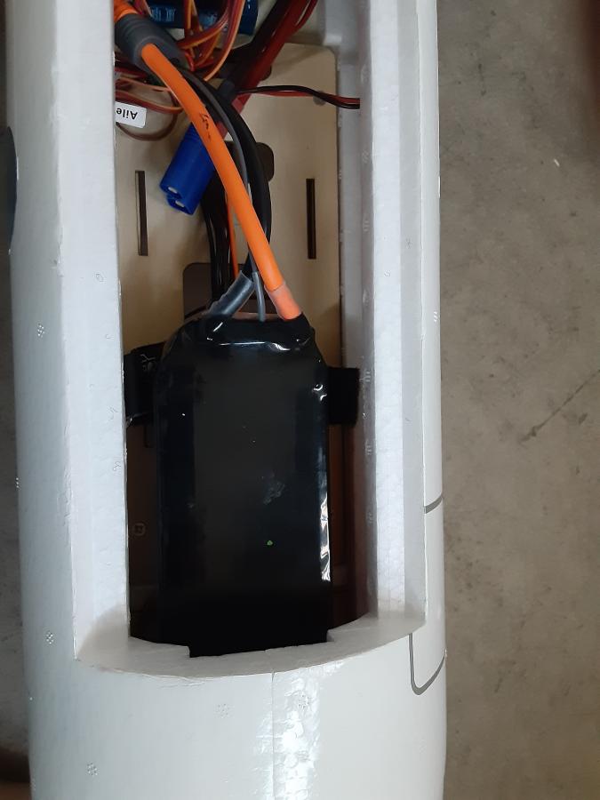

                        6s 5000mah bettery all the way forward and the aircraft is a hair tail heavy still. Worst part is I cannot strap it down. What have you done to balace your aircraft out?

ID:	340423 I really dont want to buy another battery. I am useing the molded marks.

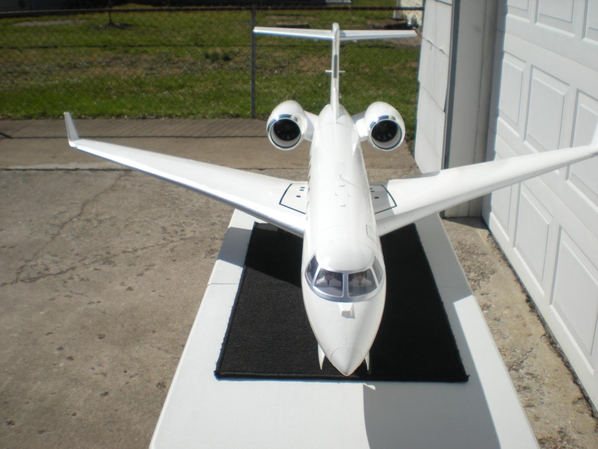

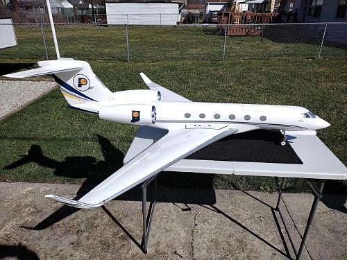

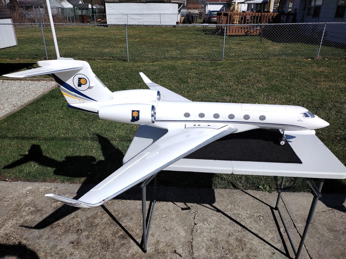

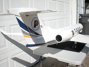

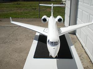

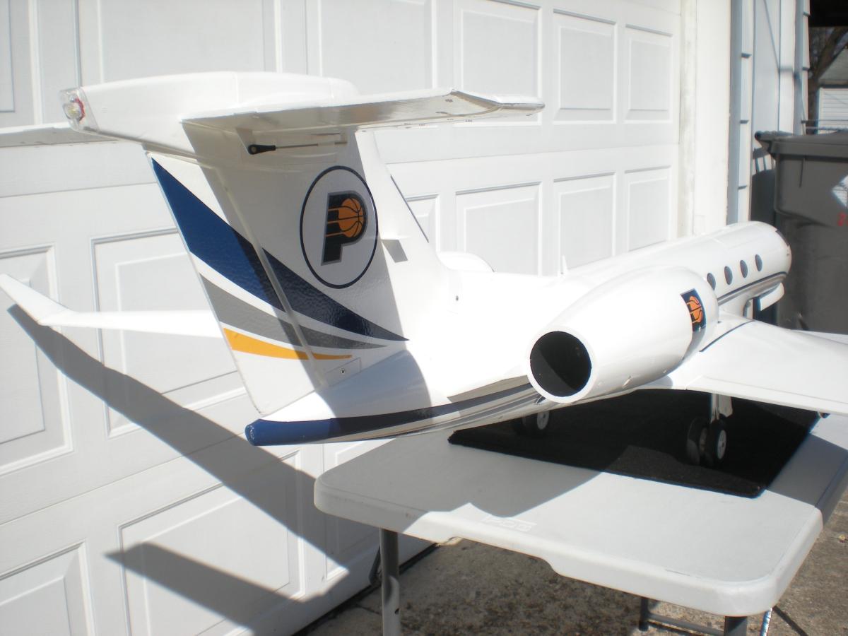

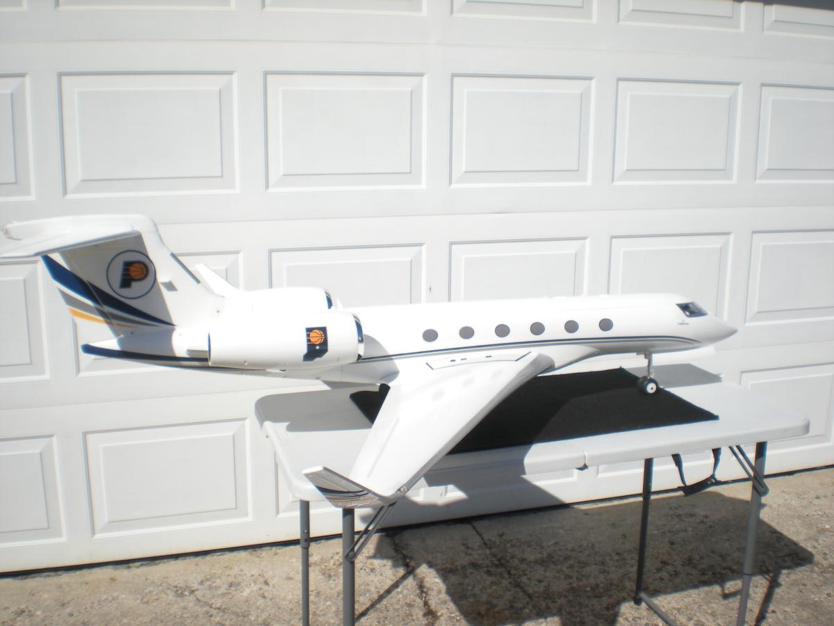

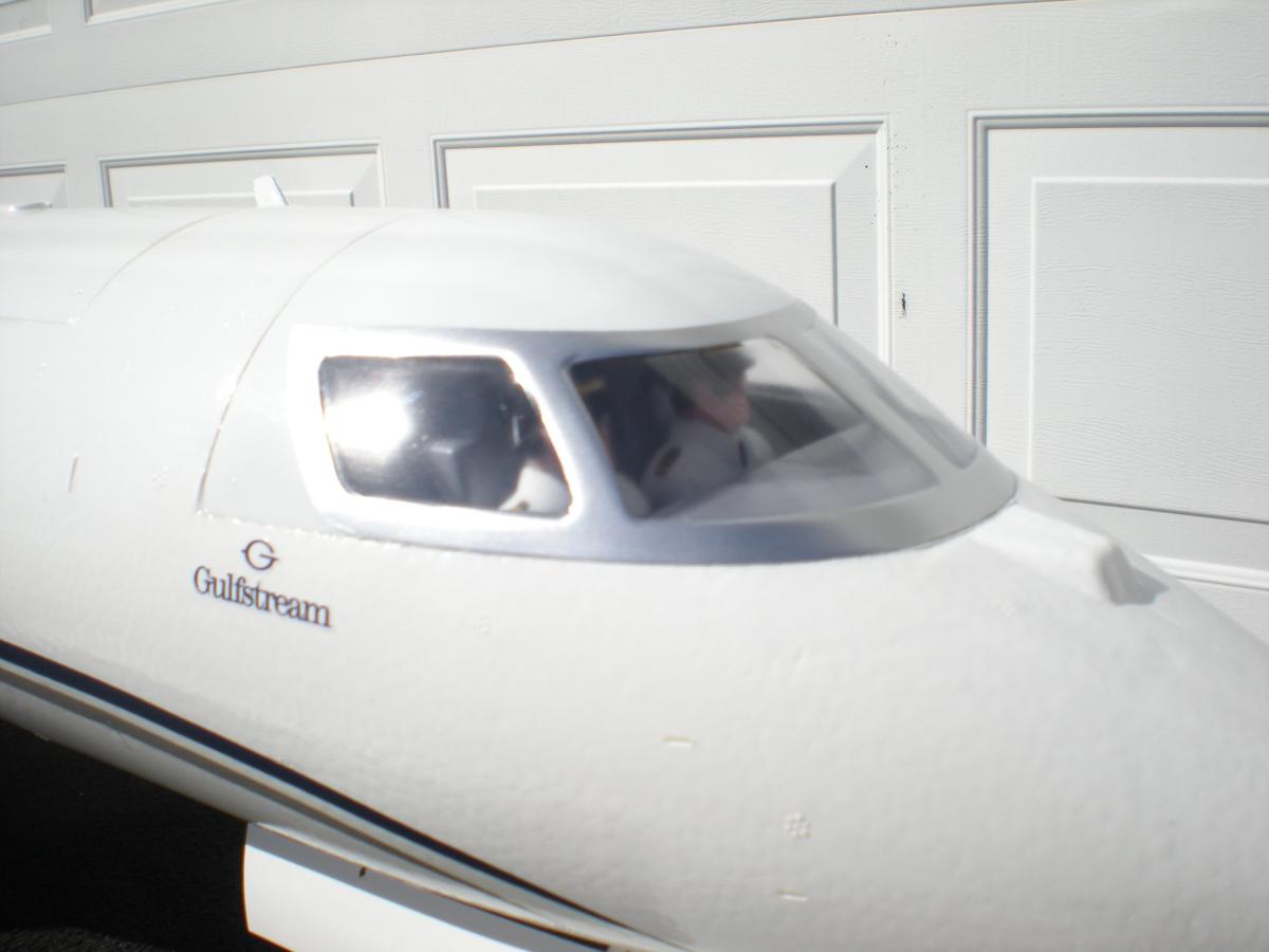

                                  I was going to do a repaint but the factory finish was great and it was White already, so I just made a few changes to make it "mine" and added a
                                  couple of decals, pilots and a few coats of minwax to put a gloss on. Just waiting on the weather to cooperate so I can Maiden.
ID:	340430Click image for larger version
ID:	340426Click image for larger version
ID:	340427Click image for larger version

                                    What is your battery weight. Just doesn’t look right.
                                    Shouldn’t need that. IMHO
                                    -GG

                                      The battery is only 695g. If others are in the 800g weight that explains it.

                                        Admiral Pro 6000 =
                                        846g / 29.84oz

                                          I think that's it. You're about 150g shy of the usual battery. I know that SMCs are light for their mah size, as are Spektrum smart LiPos. If you don't wish to buy new batteries, keep it as far forward as you, make a new strap location and add a bit of lead to the nose as far into the front compartment as possible. If you use a lump of lead placed up against the front bulkhead, beside the battery, it shouldn't take that much weight to do it. (150g of battery weight is spread throughout the battery. A single lead lump is concentrated. Stick it up there with a dab of hot glue. You can easily pull it off later if you get heavier batteries. Or velcro it to the front of the battery.)
