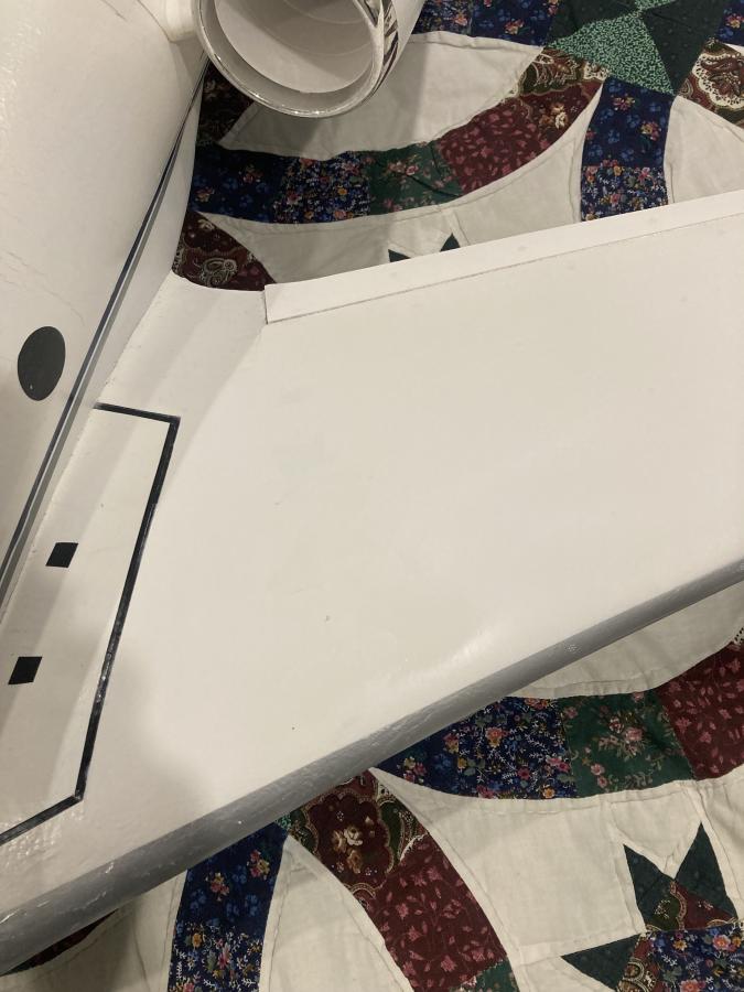

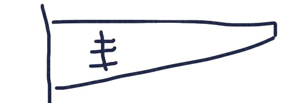

                                    Update to my post 491….almost 2 months later and several hundred more PJ-50 flights.
                                    The Bondic held up, but the amount of flexing the wings still do caused the paint to crack. UGH and UGLY! The crack in both wing tops is about 1/4 the way to the tip and both cracks run chord-wise….almost from leading to trailing edge.
                                    Back to the drawing board.
                                    This time I Dremeled out the cracked paint and then Dremeled in span-wise trenches 90 degrees to the crack. Then I epoxied in some mini spars/stiffeners made from a carbon fiber sheet.
                                    Filled, sanded, painted. Looks like new. The stiffness and resistance to flexing is vastly superior than to the Bondic-only prior repair attempt.
                                    I’m betting the top wing paint won’t crack again. Not in this area, anyway.
                                    The following visually depict the above and show the final results before I overcoat with polyurethane.
                                    When I wear this bird out, the next PJ-50 will get an additional carbon fiber spar glued to the inside of the top skin like my AL37. That’s a real solution.
                                    The designers of the PJ-50 weren’t counting on a thousand or more flights done with aerobatic flying.
                                    -GG

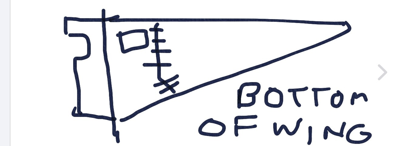

                                          Reference post 497 above…about the top of the wing. Now, for the bottom of the wing.
                                          I noticed where the bottom wing section pieces fit together within about 6 inches of the fuselage the sections were beginning to develop a case of the “spread apart itis” under a positive G load.
                                          So I added several mini carbon sheet spars all along the wing piece joints to stop the spreading under load. I added 6 mini spars sunk into the foam skin from near the leading edge back to near the flap. Did this to both wings.
                                          See drawing below.
                                          I flew her this morning and had to make a little aileron trim adjustment. Apparently the wing had been slightly twisting under load. She’s tight now and solid. Filled, sanded, painted…can’t see them.
                                          Eventually, I am going to wear this bird out. She’s my all around favorite EDF, so she gets a ton of stressful fast and aerobatic flying which is wearing on her. And all this flying, only one aileron servo has needed replacement. Truly amazing for these tiny servo motors.
                                          -GG
