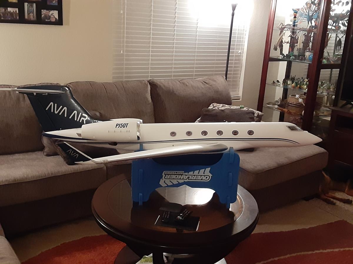

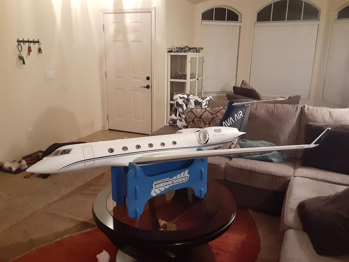

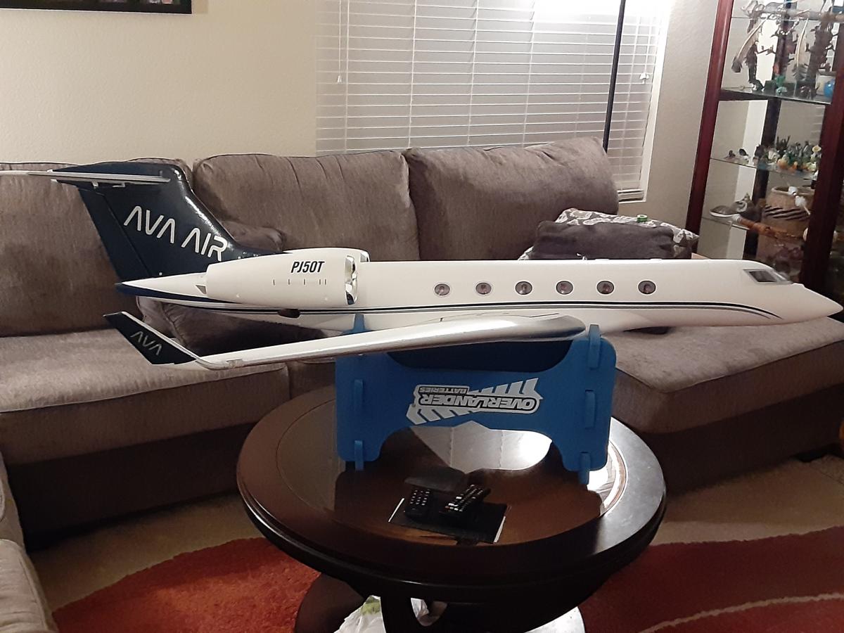

                      Here it is so far. I love it.

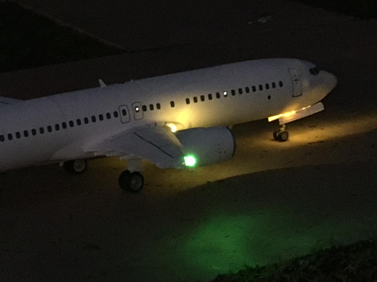

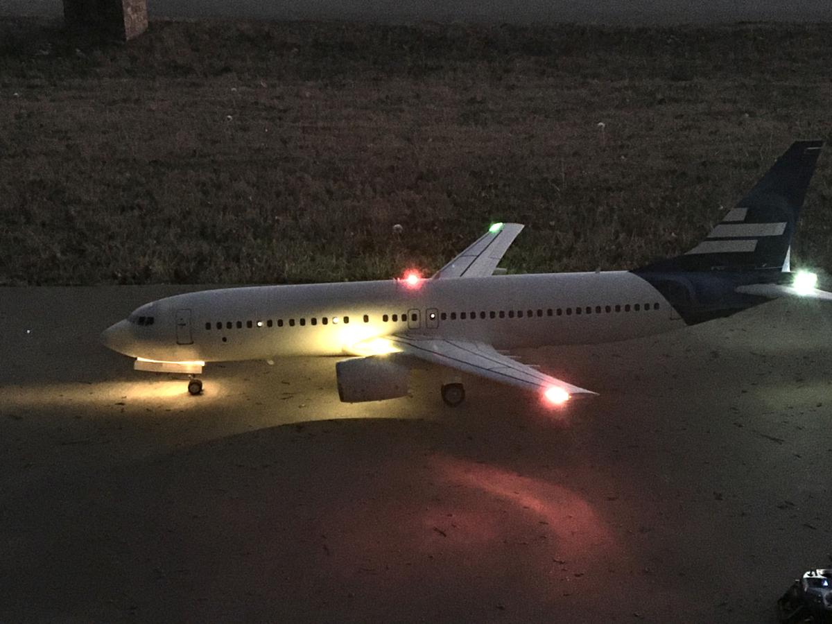

                                    Wwwweeellllll…..I attempted it with the AL37. First thought about an individual LED in each window, but discounted it after doing the design...even looked at LED light strips. Probably would have worked, if the plane had not been assembled. Then I lit up the insides and cut out windows and covered with a clear plastic disc. The holes are too small to see, and I ended up creating a flying banana of light.
                                    Then tried to paint the interior black to kill the lit banana effect. Could not get it evenly coated with black. So I ended up with a spottedly lit flying banana.
                                    Then I tried fiber optics to take light from an enclosed light box to each window. I did a few windows, and it worked. But you could not see the windows in flight. Bigger fiber optic fiber for a larger light in the window would weigh too much.
                                    I will try to post a photo, if I can find it.
                                    -GG
                                    Found them....It did look good on the ground after sunset or before sunrise.

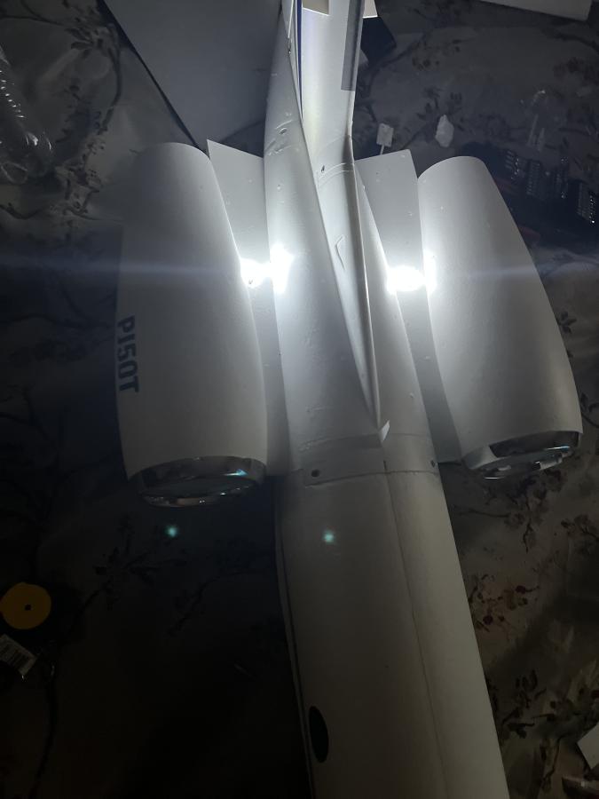

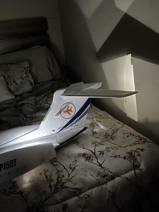

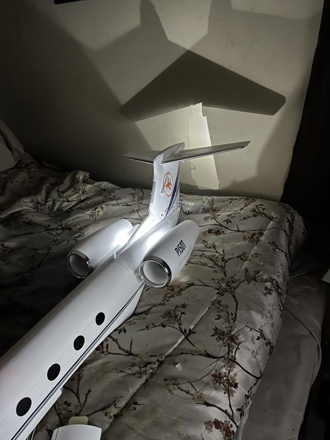

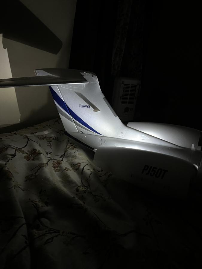

                                      I added logo lights to the tail. I placed lights inside the engine pylons. I think it came out pretty good. Had a little mishap on top of the tail. Spackling it now.
                                          Click image for larger version Name:	IMG_3101 (Edited).JPG Views:	0 Size:	120.1 KB ID:	340133
                                          Click image for larger version Name:	IMG_3104.JPG Views:	0 Size:	66.3 KB ID:	340132
                                          That's actually pretty cool. It looks like the reflection you see in the windows from passengers reading newspapers and other literature. Nice!
