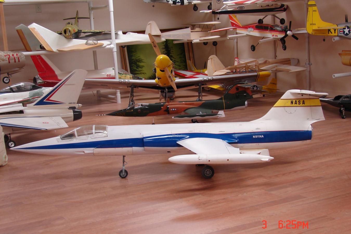

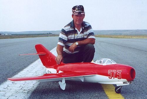

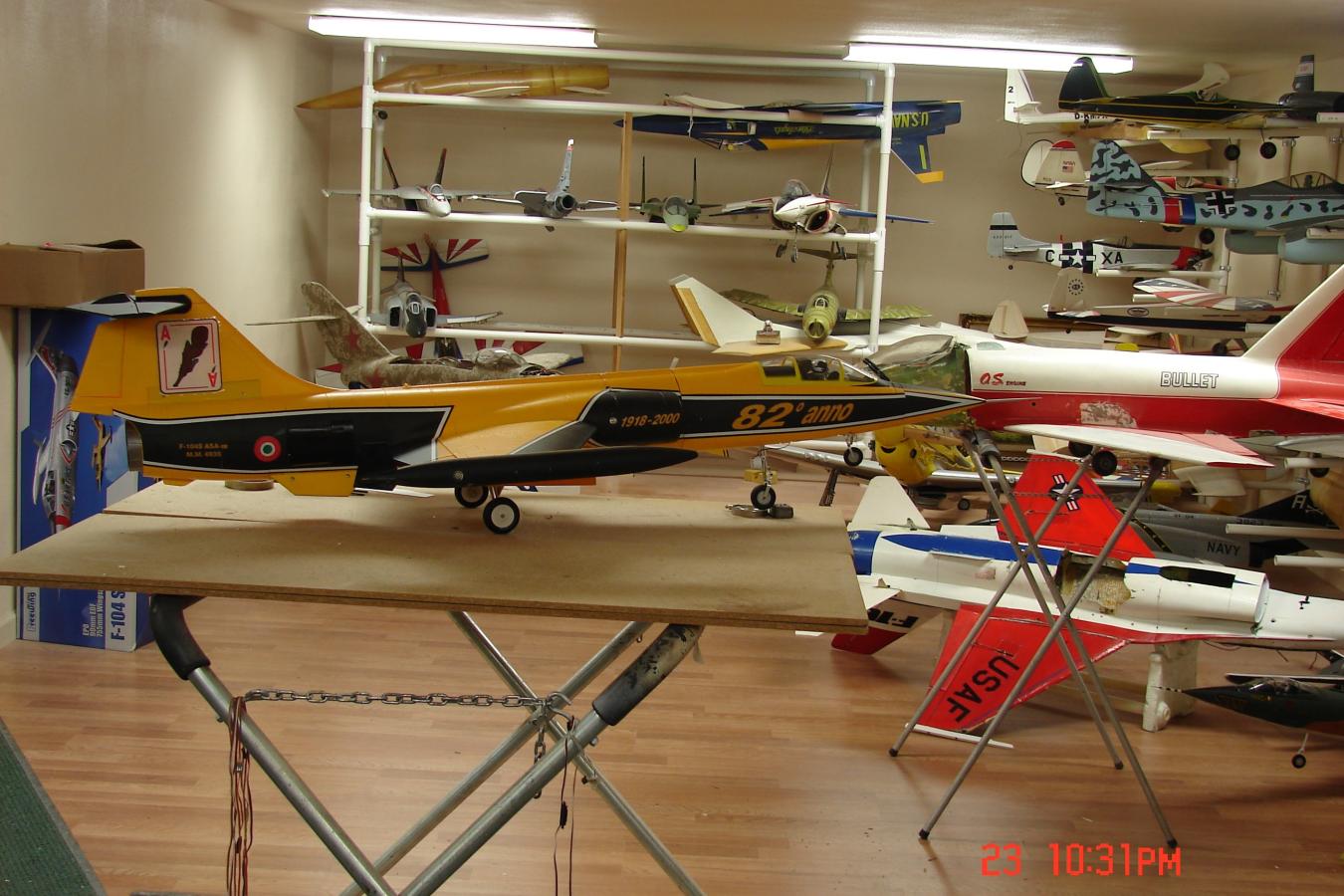

                                  • Not new to the hobby--1984ish.....just a smidge of the hanger.
                                    have the PJ50...took note of the 3 to 5mm reflex on the ailerons...great idea! Will do that as I have only flown her one time and did experience the dutch roll on landing. No gyro yet but will take your advice to heart.
                                    I started my jet experience with a Byron F16, the Byron Bullet , the Avonds Rafale and have two turbines, the BVM Mig15 and a Hotspot ---sold by Yellow Aircraft before they went out of business. I have had the Hotspot in about a 70% complete build and bought the kit in the early 90's, not sure I will ever get it finished??? Too many planes, not enough time
                                    Don't tell the wife , but close to 70 planes, some new, some quite old, in the hanger. Probably have built and/or assembled close to 275 + aircraft since starting in the hobby... Rod

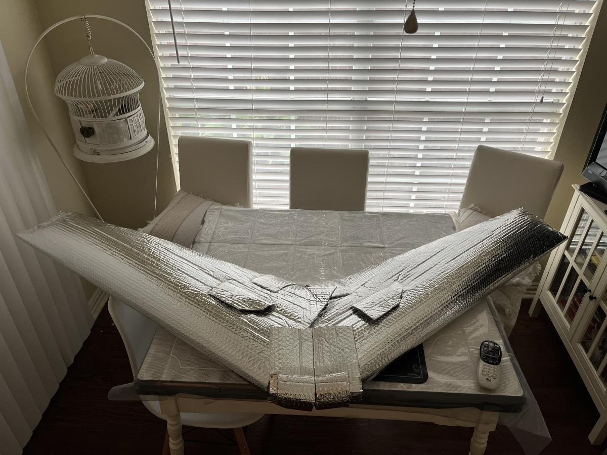

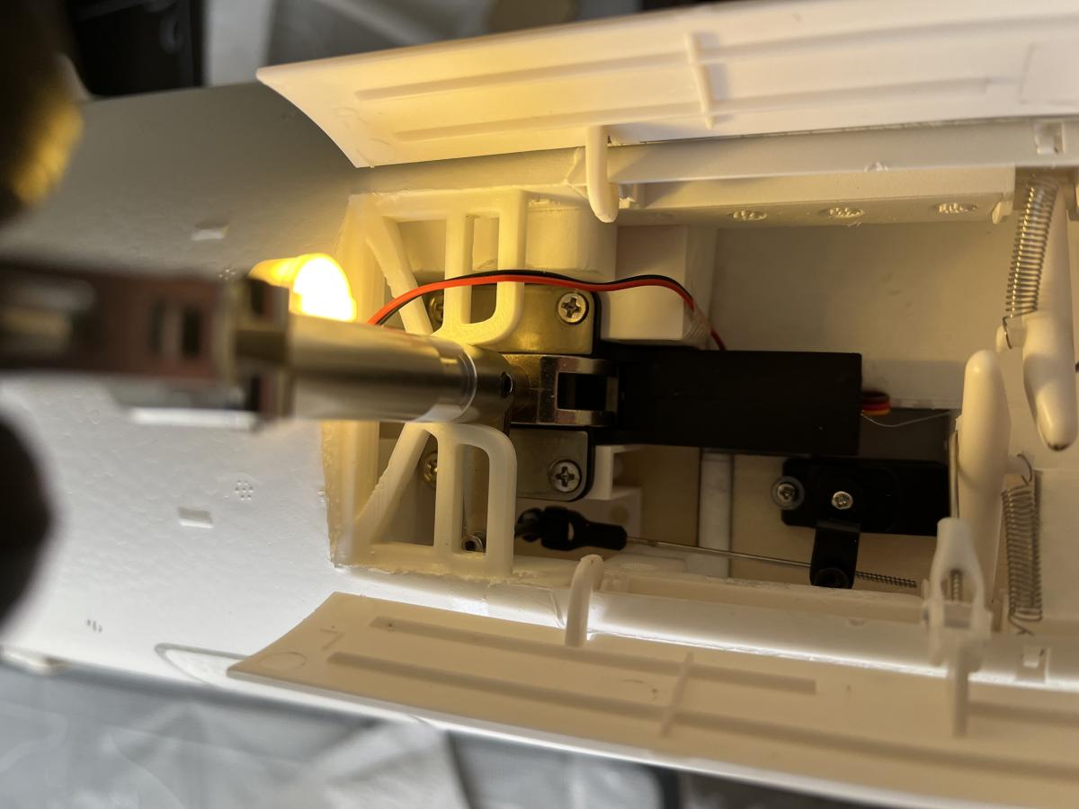

                                      • Still waiting for a maiden date......deployed a nosewheel support brace which might help longevity for grass operations. I also cleaned up my wiring to make it easier for field assembly....it does make it less fiddly when the wires are bound together and fastened to the fuselage sides. Transport-Storage wing bag protectors incorporate velcro strips for single wing or two separate wings ....ready to go
                                        TwistedGrin​
