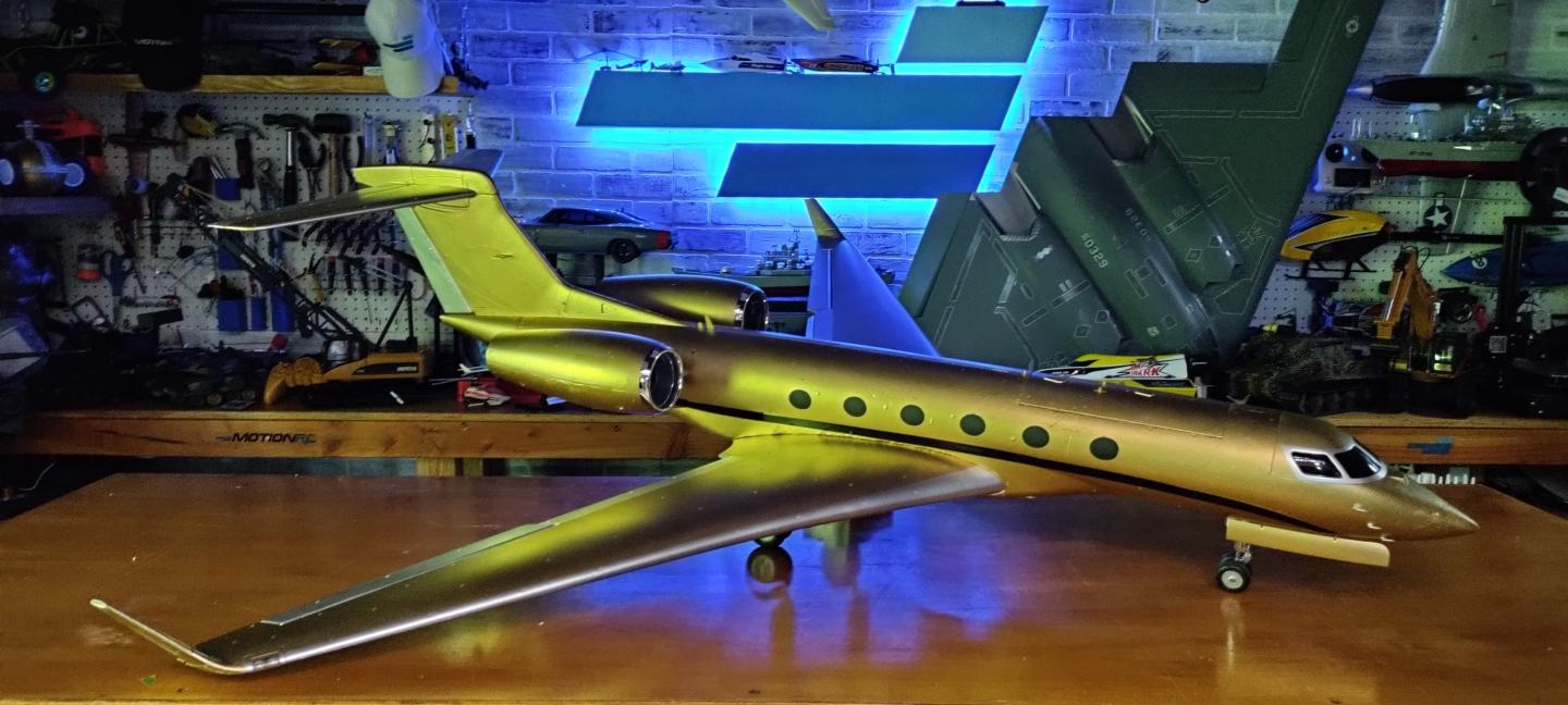

                Took my beat up PJ that was in the mid-air crash and spruced it up a bit!

                  That looks awesome James. I finally got to fly mine Saturday, what an awesome flying jet. Got my windows installed and it will be getting painted hopefully sometime this weekend.

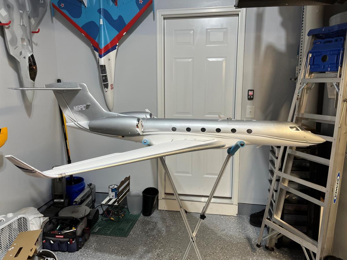

                                Finally got my Corporate scheme completed. Just need to fix the N# on the tail. I set it on before I reattached the tail to the plane and it was angled. Time to order a new set from Callie to do the fix but overall it cam out great. Real windows installed as well.
                                She also forgot to get me the two rear window window trims and the cabin door on the other side.
                                Photo of FS attached.

                                  That looks awesome!

                                    Sweet! Want to do mine...?🤣🤣🤣

                                      Thanks Evan.
