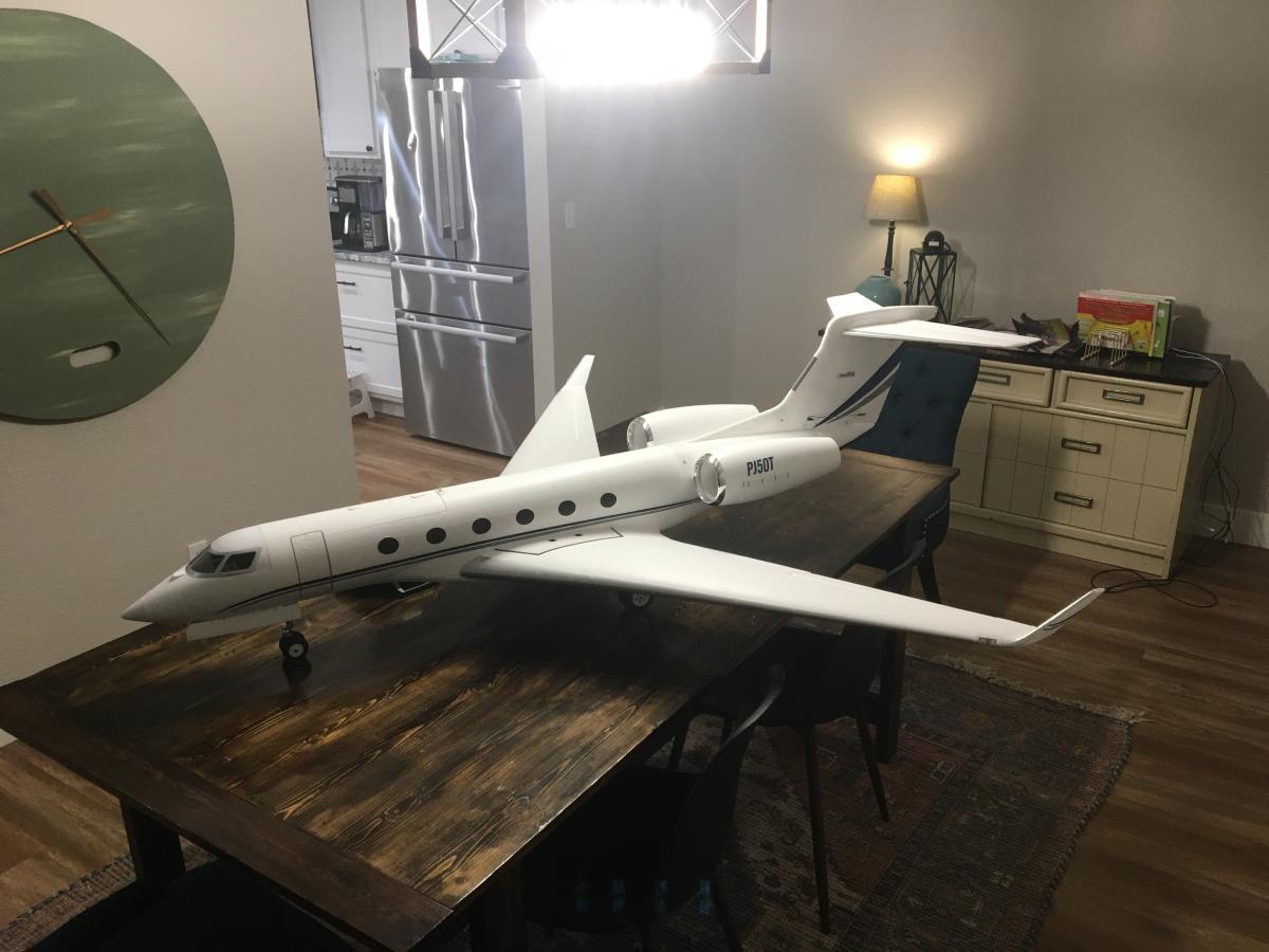

        She’s HERE! Beautifully executed kit and packaging! My hat is off to the designers and those who did all the pre-assembly + decals! The finish is VERY nice.
        Easy final assembly! Got it all done except for the piddling stuff(antennae, pitot tubes, etc.). I will maiden it tomorrow…light winds forecast. I did need to cut off the elevator pushrods a few mm to keep from having to add a lot of trim. I could not screw the ball link in enough without poking the pushrod thru to the ball area.No big deal.
        Admiral Pro 6000 not quite all the way forward = perfect CG per the book location. Not gonna be able to move the battery back any more the way I mounted the RX. So if she’s nose heavy, I will add weight to the tail.
        Added small RF chokes back in the tail on the rudder and elevator wires. One large one was clipped around all the wires going forward from the ESCs (as close to the ESCs as possible) and added a small choke by the green ferrite ring up by the receiver. Added 4 chokes total.
        Will paint overall with UV protectant water base paint once I am done playing tomorrow.
        -GG
        Added note: So I have read, the motor side of the ESCs has less RF noise output. Therefore, I did not add chokes on the motor wires. You may add them, if you want to….can’t hurt. Always place the ESC choke(s) as close as possible to the ESCs.
        Click image for larger version  Name:	672825F6-F0E2-4CE3-B74A-32EE15B53AC9.jpeg Views:	0 Size:	92.8 KB ID:	339747
