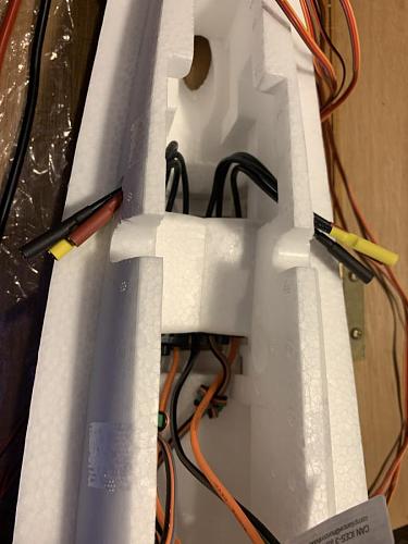

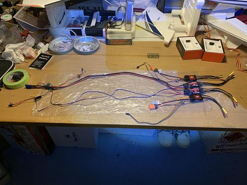

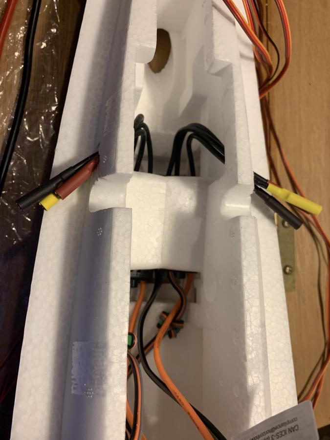

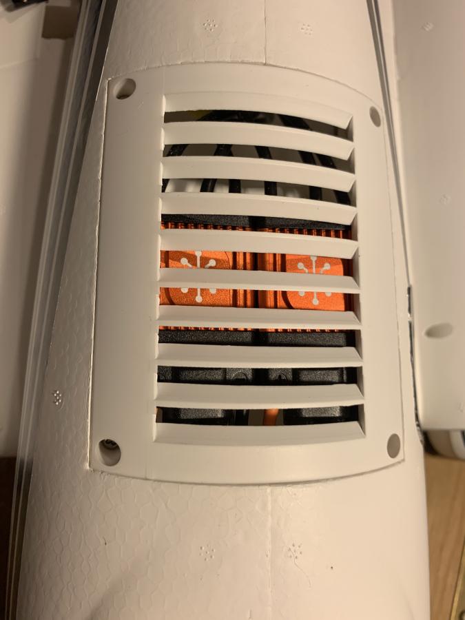

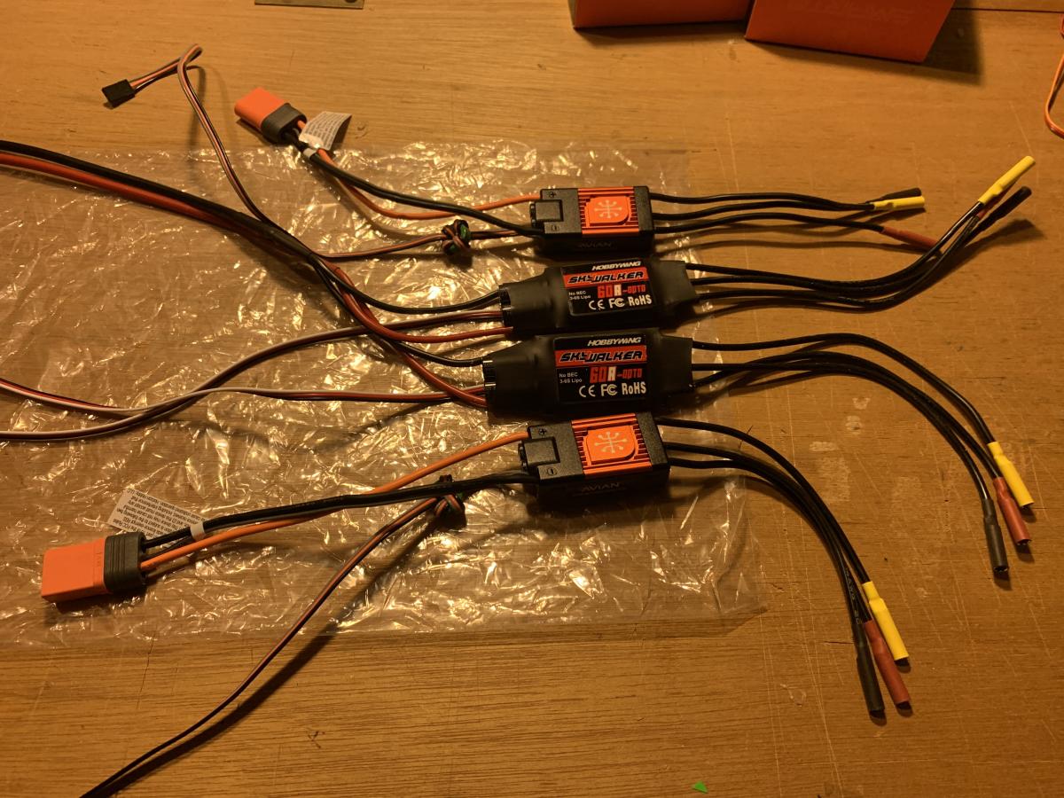

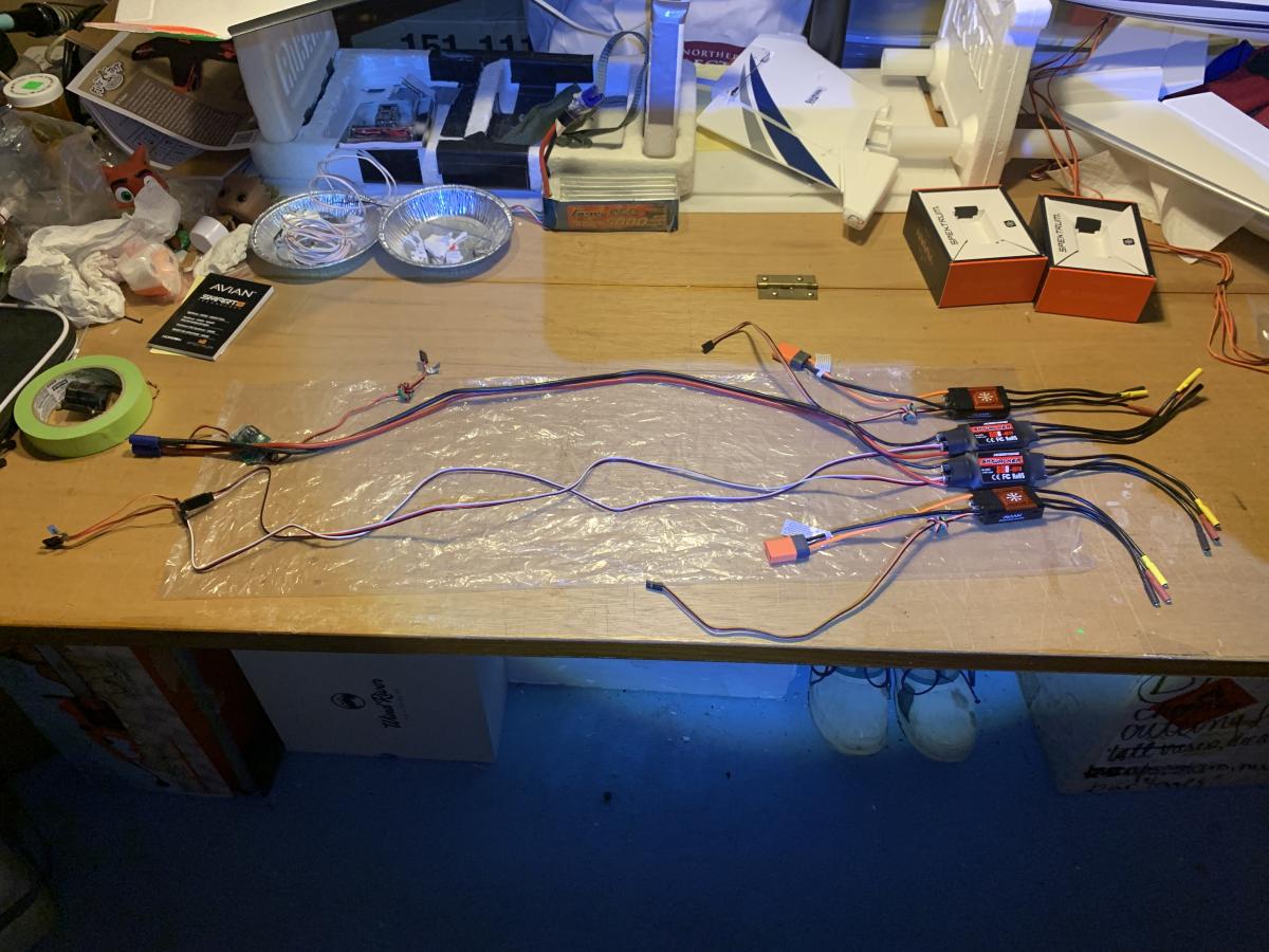

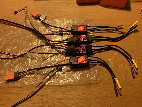

                Did some testing and then did the swap to the Avian ESCs this morning. Here are some pictures .....................................
                Here's what it all looks like when yanked out of the plane:
                Close up comparing the sizes of the ESCs:

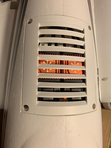

                Avians installed in the plane:
ID:	335360Click image for larger version
                I plugged everything in and it all works like a charm. Thrust reverse works as was expected. However, as mentioned before, power lead from one of the ESCs had to be removed. With both hooked up, both ESCs just kept beeping and couldn't initialize (these things are too smart). I did the throttle calibration and programmed reverse one ESC at a time. When done, disabled one power lead, hooked it all together and BINGO! Now, I just need to make up my own Y to tie the two ESC battery cables together. I'll use the stock wires to make it. Rather than cutting off the IC5s, I'll solder a couple of EC5s to plug into the ICs. A couple of extensions for the throttle cables was all that was needed, using the stock Y. I think this thing is going to be a blast with thrust reverse.

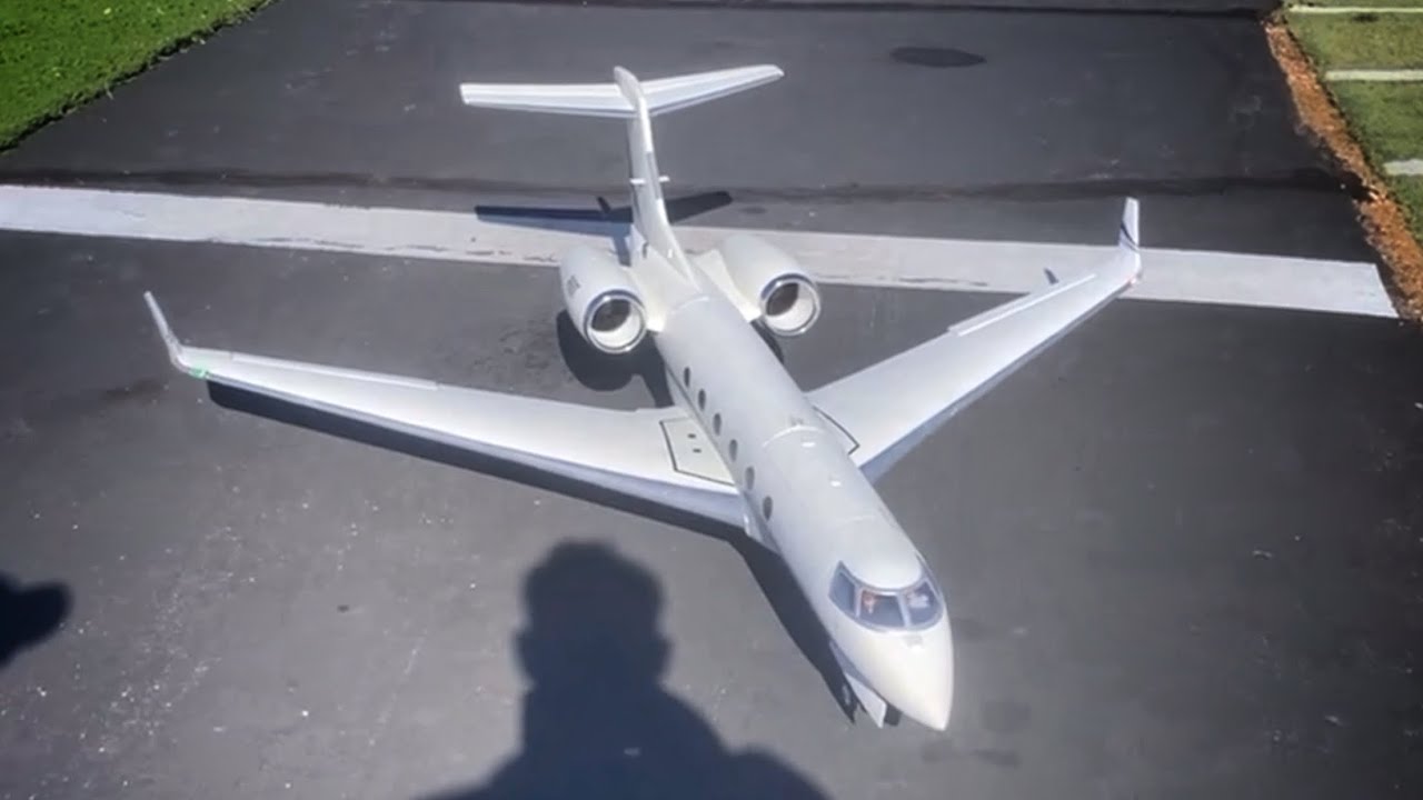

                                Got it all done. Encountered a glitch in making the dual ESCs go into reverse thrust. It worked perfectly on the bench before the plane was put together but once I got it together, I could not make both engines go into reverse. Only one engine would go into reverse at a time. When both motors were hooked up, they only went forward. I tried everything I could think of to no avail. Then I decided that when the two ESC signal wires were Y'd together, somehow the reverse signal was either not strong enough or got scrambled. So I went and got a 4-channel smart RX and hooked up only one ESC to it, leaving the other RX as it was. Powered the second RX via the ESC BEC. The first RX has the red wire yanked out and is using the external BEC that came with the PJ. Bound it up, did throttle calibration, hooked both RXs to power and BINGO, it worked like it was supposed to. I didn't even have to do the Avian thrust reverse programming from the new RX as it remembered it from being done with the first RX. The first RX didn't have to be re-bound either. It also remembered.

                                Looking at the PJ and then the AL-37, I think the AL should have been this size. The PJ is big but not too big.

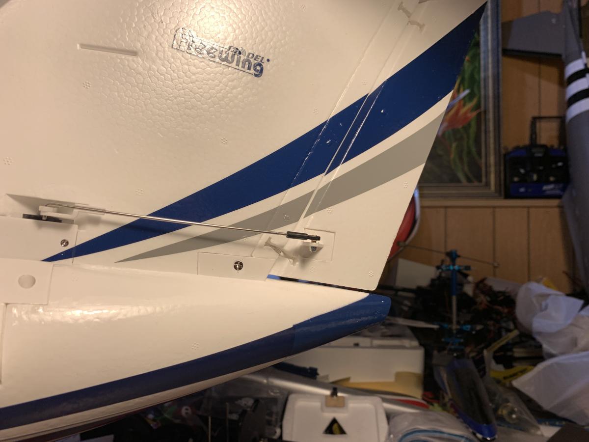

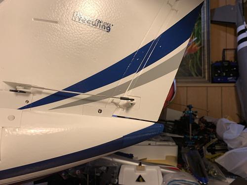

                                        Would you mind taking a measurement of the Freewing logo on the tail? Want to find out how best to cover it with another graphic. Thanks.
