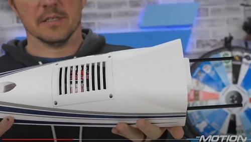

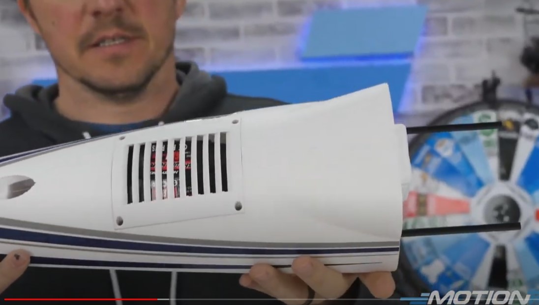

      Something to consider (possibly overkill depending upon your flying style and typical flying air temperatures)...
      (Photo below) I see that the ESCs are mounted in the rear tail cone. Thus, as with the AL37, cooling air only flows over them when the jet is in motion.
      This design leads to a few things which you may be getting prepared for....as learned from my AL37 (summertime days get HOT here)::
      1. Running down the batteries while stationary isn't a good idea. The ESCs get hot and heat is problematic for electronics. They'll last longer if you keep them cooler.
      2. If you must run down the batteries while on the ground, get some cooling air flowing into the ESC compartment.
      3. I built a cooling fan from a high volume/rpm, 24-volt DC PC case fan attached to one end of an old 6S battery and added a switch.
      4. The AL37 sits low enough so I place this cooling fan+battery assembly on the ground under the AL37 and blow air up onto the ESCs.
      5. Since typically I strive for a short down time between flights...as soon as the AL37 lands and taxis back, I put the cooling fan assembly under the bird and begin blowing air over the ESCs while I change the battery.
      I see that the PJ50 ESC compartment is high up and located on the underside of the tail cone. This will require building a small shelf for the fan+battery assembly to get the assembly high enough off the ground to effectively blow cooling air into the ESC compartment.
      Alternatively, when the bird arrives, I am going to evaluate this area and determine whether or not there is sufficient room to mount a small cooling fan in there that will be circulating air any time the main battery is connected. DC fans don't draw much current at all.
      Overkill....possibly. But electronics are happier when they are cooler. And, I have had an ESC shut down on me due to overheating while running down batteries on the ground when I could not fly off the charge.
      -GG
      Screen capture from the announcement video...

                        No different than the AL37 ESC location and never had an issue. Plus they said it was tested for almost year in hot climates.
                          Details of the testing are unknown, but I'm glad to hear that.
                          However, the points of my post were #1, FACT: I had an ESC stop working/shut down during a hot day ground run w/o any cooling air flow (stupid of me). and #2 FACT: Any electronics will last longer if you take care to keep the operating temperature down.
                          What I can state is that making a lot of flights on hot days with very little down time between flights AND all this flying has been done with cooling the ESC with the external PC case fan while the battery is being changed has given me good results (i.e., no more ESC failures). I prefer to have the maximum amount of margin possible.
                          Bottom line, if you're gonna get the PJ50 AND you fly in hot climates AND you do a lot of flights with little cool-down time between flights....you have another data point to reference.

                                I agree on the down times. I always wait between flights anyway that's why I take at least two bird with me to the field.
