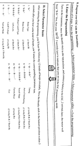

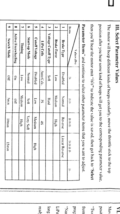

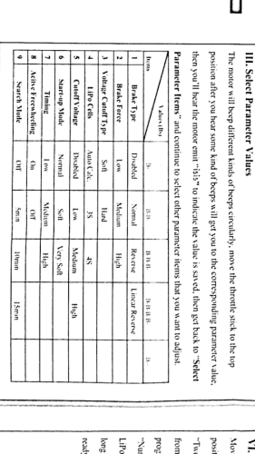

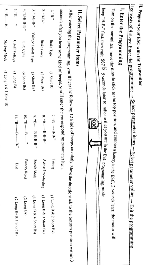

                                #235
                                Ill have to find the stick instructions, I know you sent me a pic Evan D but I can't make it out Thanks
                                  • 5424
                                  #236
                                  These may help. To describe it… turn on transmitter, make sure the throttle stick is active, no throttle cut active.
                                  Put throttle to full throttle.
                                  Plug in airplane. You should hear two beeps, a pause and then a musical type set of tones.
                                  Then a single beep, then two beeps, then three, then four, the next is a long beep and when you hear it put the throttle all the way down.
                                  Then you’ll hear a single beep and then two beeps.
                                  When you hear the two beeps go to full throttle. You’ll hear some tones that it save low LVC.
                                  After that or anytime just unplug the battery and you’re done.
                                  If you need to we could do a face time or regular phone call and do it.
