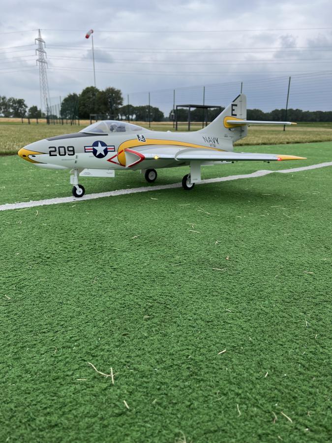

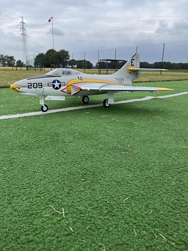

    • First flight done! Started without gyro, had to trim aileron a bit, then switched gyro on..fly s great!
      All at Beerse modelvleugels Belgium Click image for larger version
