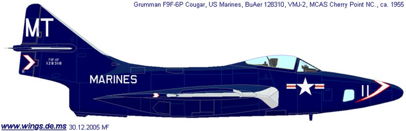

          Same here with my ARF-Plus Cougar. shipping says delivery Sat. Already notified Callie Graphics on a new livery for this bird. Going with a Marines livery in blue. By the time I get the livery package she will be all painted and ready for the graphics. Click image for larger version  Name:	F9F-6P_Cougar_USMC_VMJ-2_b.jpg Views:	0 Size:	38.7 KB ID:	379750

            If it came in that color, I wouldn't hesitate to buy it. That yellow on the grey have me trying to figure out the shape of the plane. To me, its too much going on with that yellow.

              We debated between the Navy blue scheme and the current gray scheme forever! We went back and forth numerous times. The decision was painful because we really liked both. Normally it is pretty easy for us to pick a good livery but this one was SUPER tough.

                I think it looks great! Most Cougars you see are Blue so something fresh. 4 STARS

                  Another thought. The darker colors like the dark blue on the cougar will alligator much more easily. Another plus for the light gray

                    I've got gray jets, white painted jets, Blue Angels F-18, Black Bunny F-4 and they all gator after time no matter how much you keep them out of the sun. The heat of the day also helps with the gator effect. Nature of foam planes I guess. But you can't tell when they rip through the skies....
