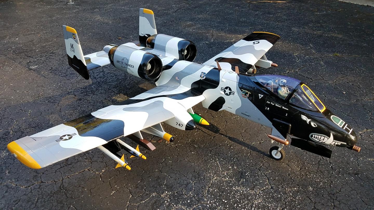

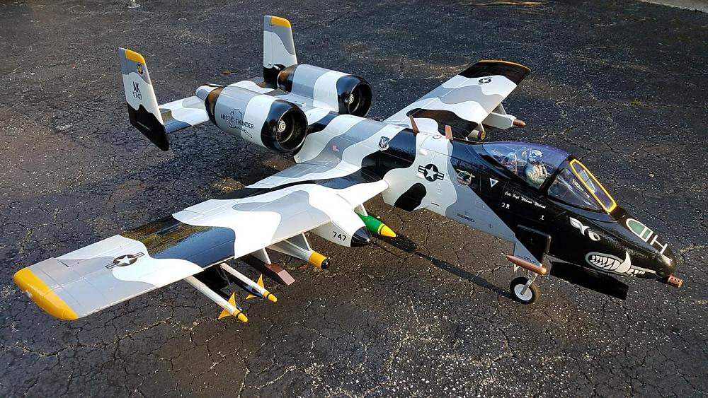

  • flyAA
    Originally posted by Raptor3596
    Got the 90mm EDFs put together. The 1900KV inrunner motors and 130amp esc fit perfectly. I wasn't sure about the aluminum spinner caps, but they add good contrast.
    I found out I didn't need to purchase the esc mounts or the tail nozzles separately. They were included with the Nacelles.
    good stuff! Did you have to extend the esc battery wires at all or were they long enough stock?
  • Raptor3596
    Originally posted by Gringotuerto
    Good idea!
    Anyway, I was looking at MotionRC site and see that the newer 80mm jets come with an inrunner. The A-10 specification page says:
    2x 3530-1900KV Brushless Outrunner Motors w 9 blade fan
    But the 80mm Mig-29 and the Avanti specs say:
    2x 3658-1920kV brushless inrunner motors w 9-blade fan
    So an intermediate option might be to keep the same nacelles and just change to the new inrunner motors...? I would guess that the external dimensions are the same so they fit without much work, but I didn't verify that.
    I thought about just upgrading to inrunners and staying 80mm, but I had a 90mm set up alread sitting on a shelf wanting to get put back into the air. Im curious to see the performance and power comparisons between a 90mm and 80mm inrunner set ups.
