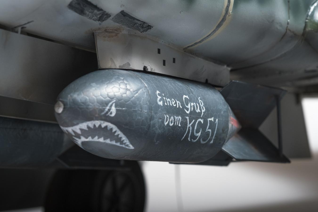

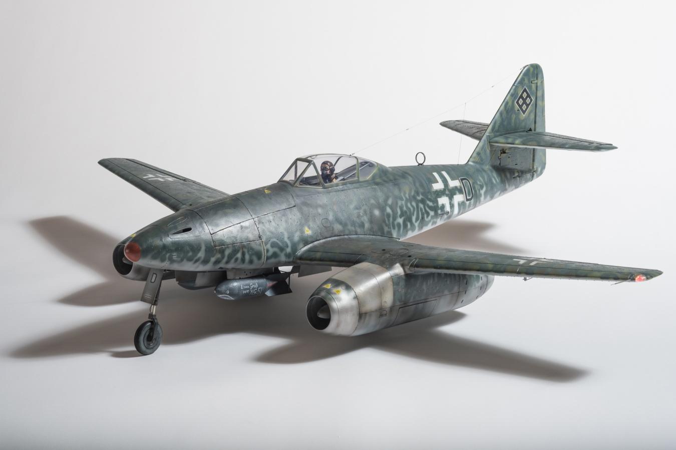

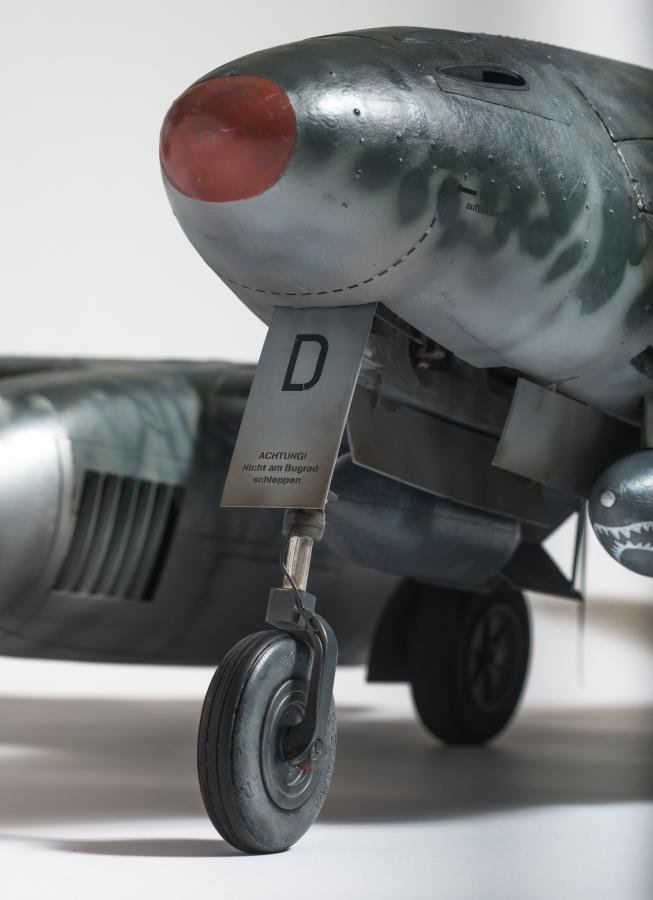

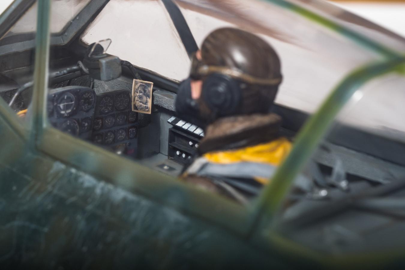

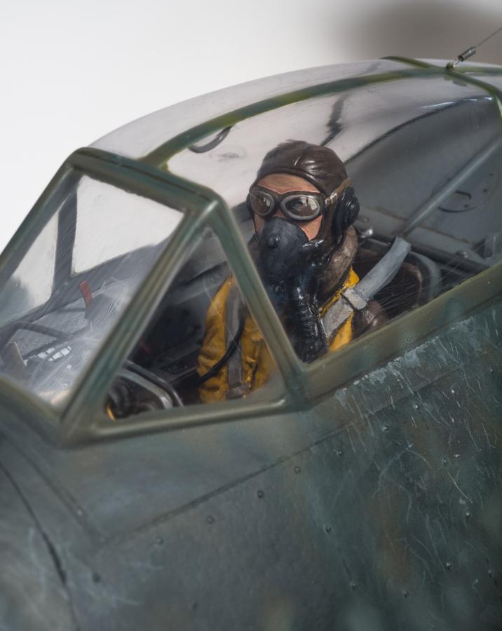

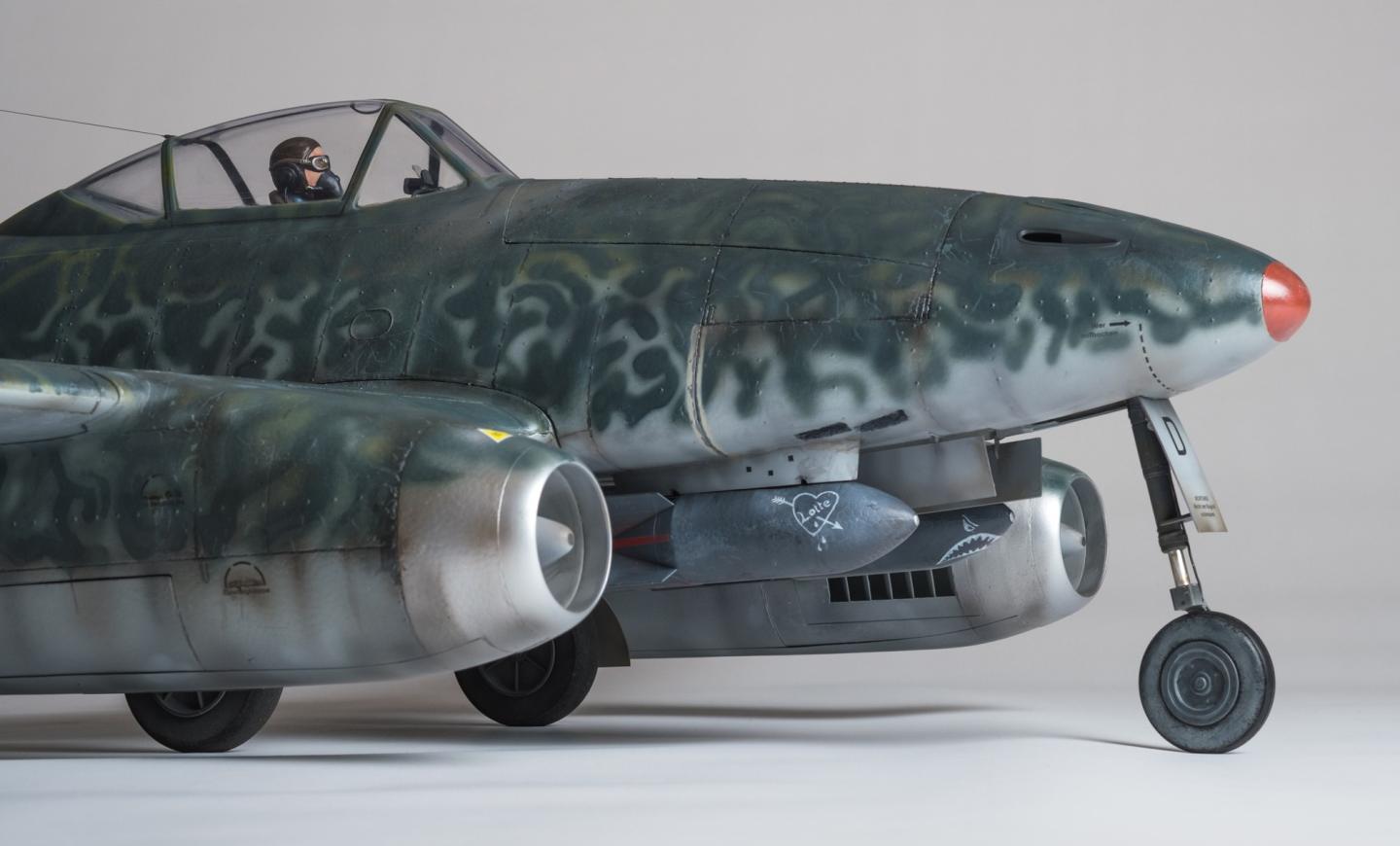

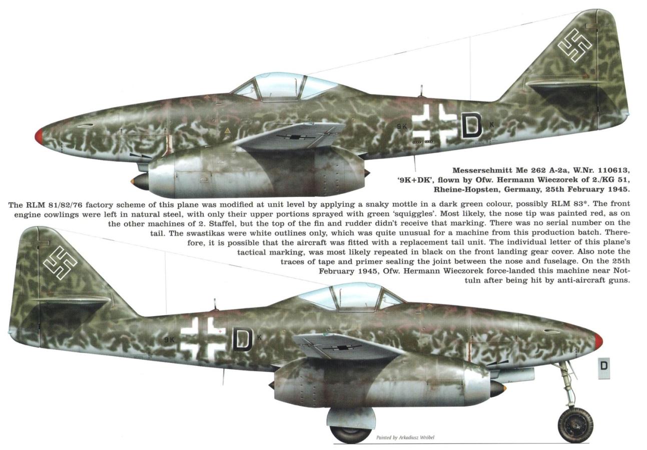

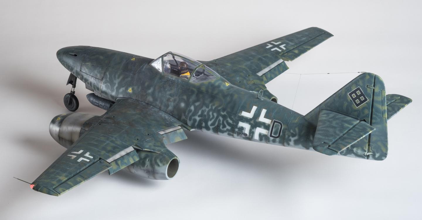

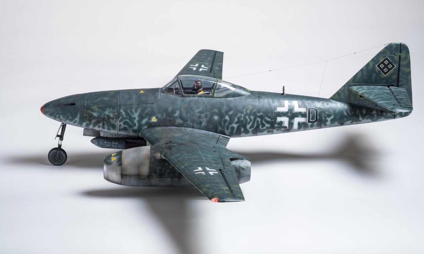

                              Originally posted by Ralph Stepper
                              Hi Folks,
                              after finishing the March Mayhem Contest with 8th place I am very pleased and honored - so many incredibly customized and beautifully shot models and all of them would have deserved a top rank. Therefore again many thanks to all voters and of course to James and the Motion RC team for having this happened again.
                              And of course deepest congrads to the winner and his impressive B-24!
                              As promised - here now some further images of the 8th rank voted
                              Freewing Me 262 V2, converted into a A2a Sturmvogel (stormbird) Blitzbomber, Bu.No. 110613 „9K+DK“ of 2nd/KG 51, flown by Ofw. Hermann Wieczorek from Rheine-Hopsten airfield in February 1945.
                              Beside a full gear modification (100 degree front gear with 64 mm wheel and 85 mm main gear wheels as well as adding inner main gear doors) I did a full flap mod. (full flaps instead of stock split flaps) as well as a full cockpit re-do and numerous scale mods and additions (working nav. lights, SC 250 bombs, Riedel starter cones, antennas, ...).
                              Thanks
                              Ralph

                              hi Ralph!
                              Absolutely love what you've done with the paint and gear mods, really stunning work!
                              Would you mind sharing the plans or any build notes if available? I'd also love to hear more about the mods you've done, they look brilliant and really set it apart, especially the landing gear omw

                                  This is not a plans built plane. Its a modified foam plane available at MotionRC.
                                  Originally posted by mglotter87
                                  hi Ralph!

                                          #420
                                          Hi Evan,
                                          thanks Im aware :), I have the same plane, I was refering to the gear mods - plans
