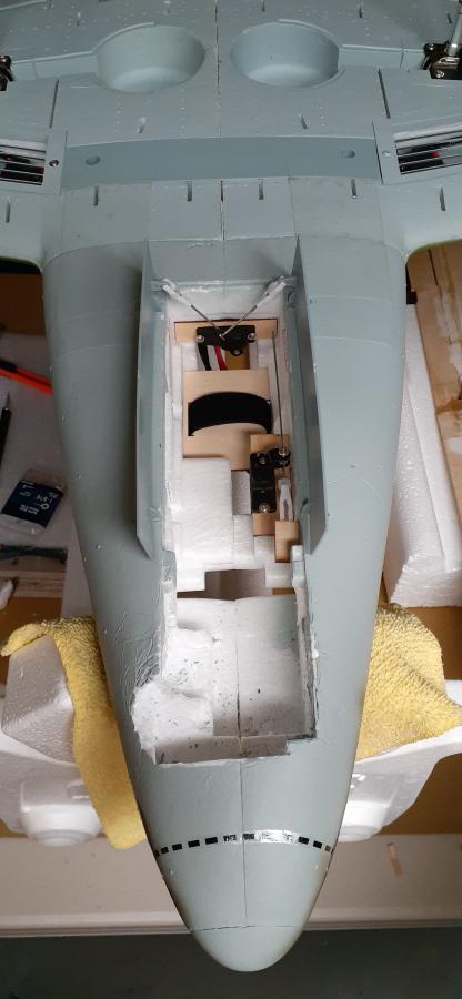

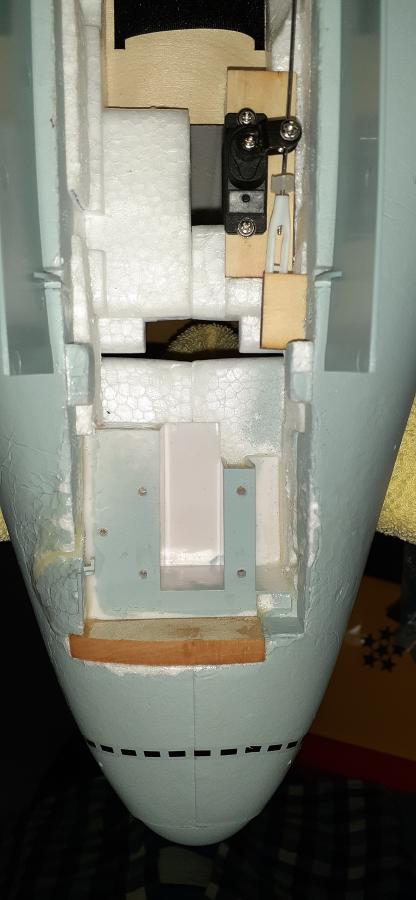

  • Oh, BTW, I have one square rod on each side.
    • Originally posted by Spencer Keith View Post
      thank you
      That's right, its was just my choice. I just stuck it in there in the middle because I am bit OCD. I don't think it matters exactly where it located. But it is needed. On my first 262 I snapped the nose clean off during a fairly normal landing. After I installed this, on both the first and second plane I've had no problems at all.
              Figured I might as well do both sides lol.
                Oh yeah, we definitely did both sides. I just took the picture of one side as an illustration.

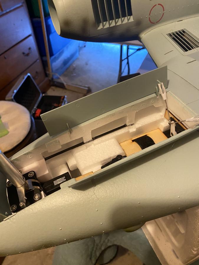

                • Crashed my ME-262 last week, going through a rebuild but manual only for PNP..... any chance someone could post picture of how the servo for the gear doors are set up? Thanks in advance!

                    Add two layers of clear gorilla tape, both sides, on the bottom to keep gap at front of wing from spreading and breaking off the nose at that locatìon.
                    • Originally posted by Casey C View Post
                      Is this what you are looling for?

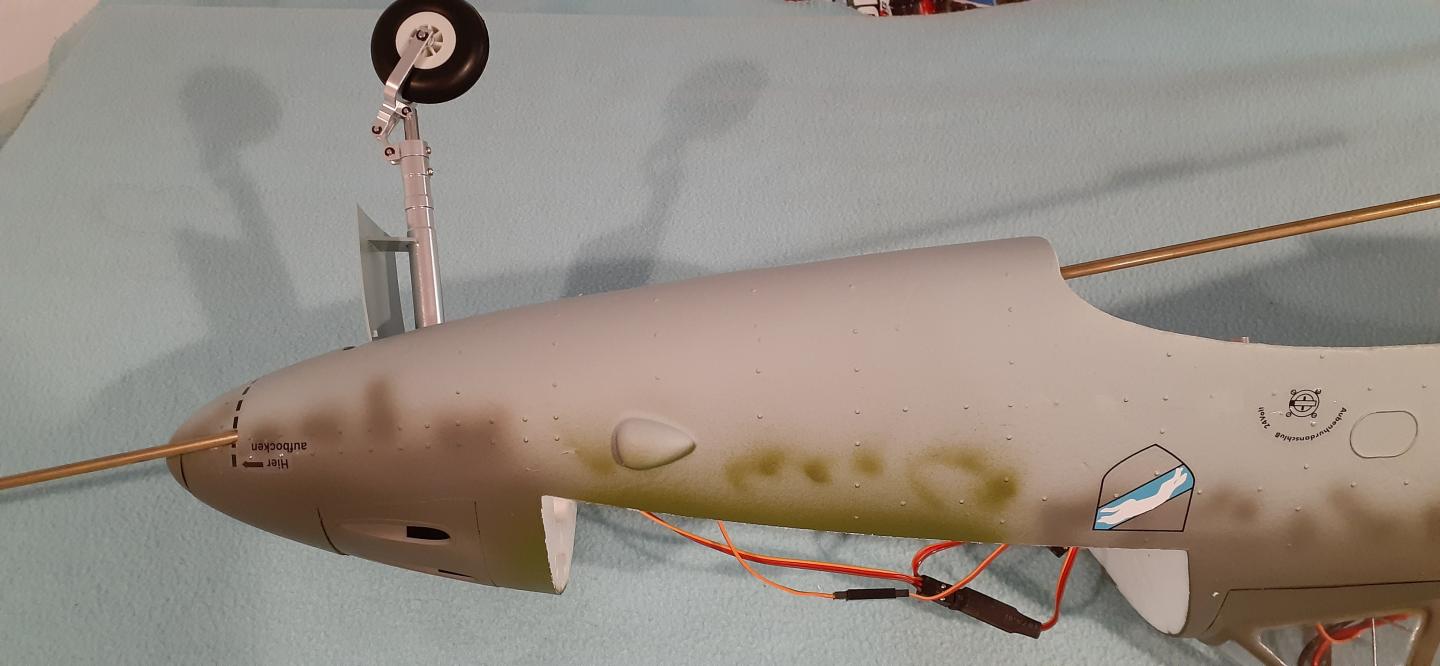

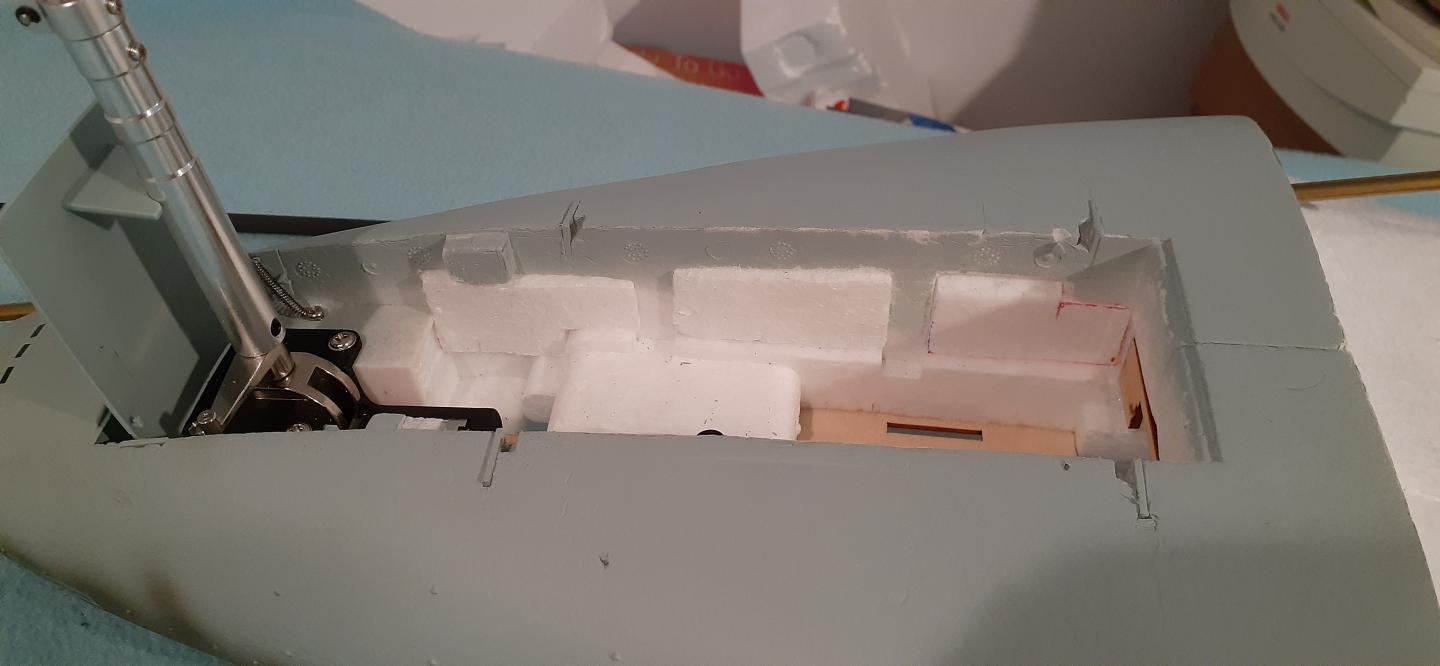

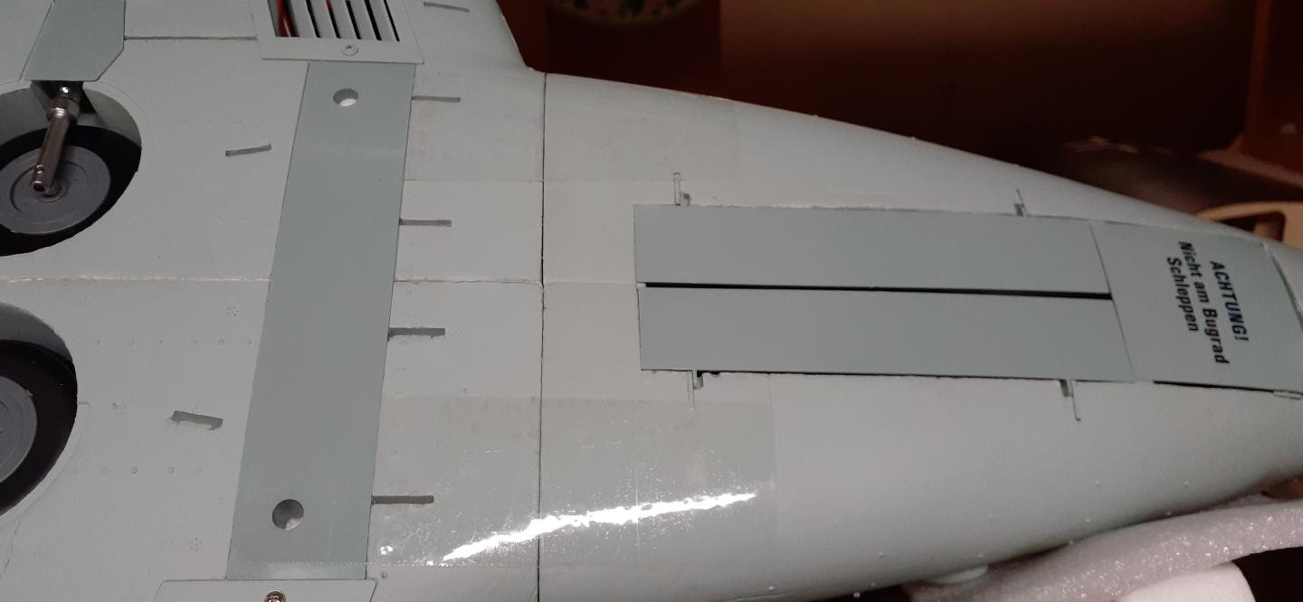

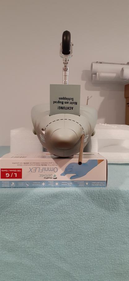

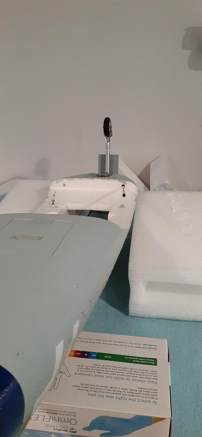

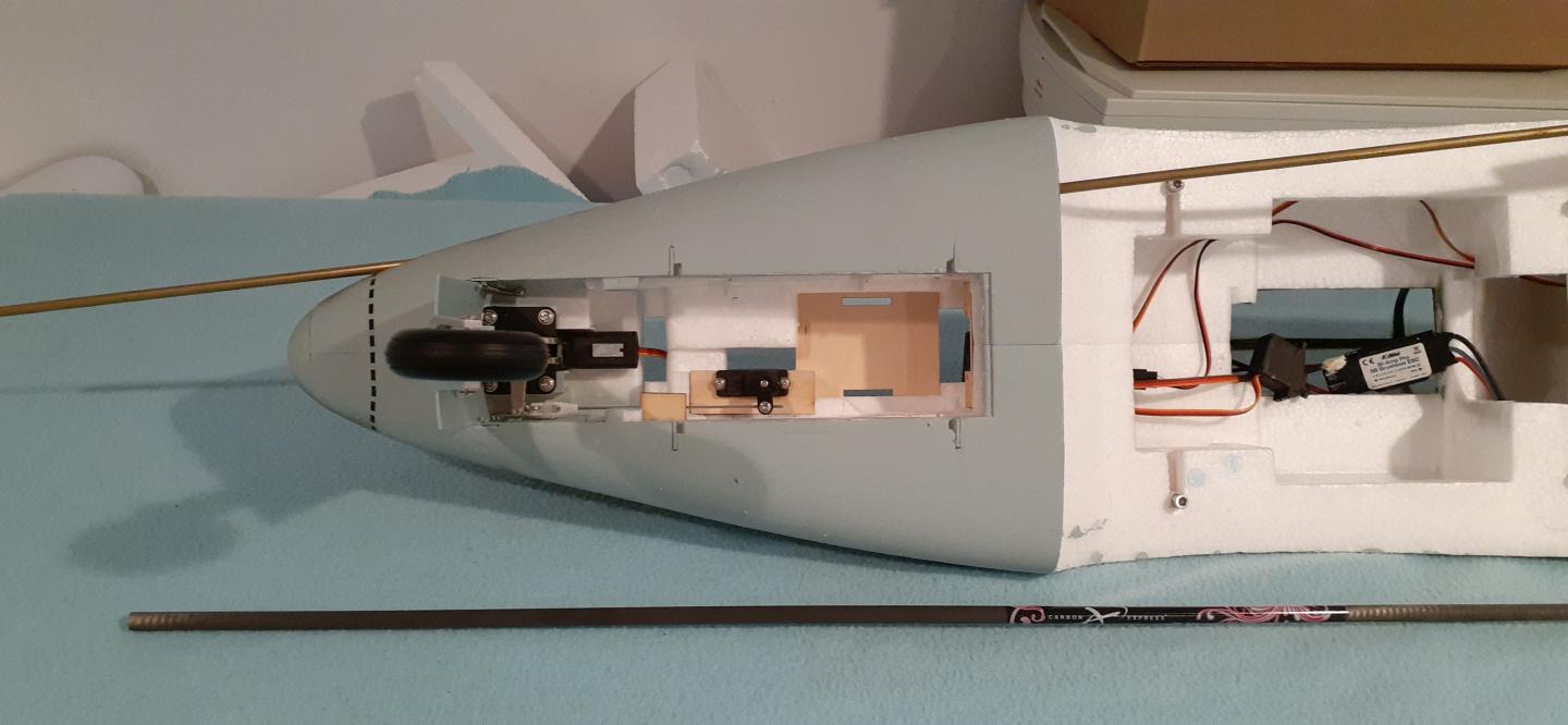

                          • My nose reinforcing with carbon fibre arrow tubes.
                            • Originally posted by Creative RC View Post
                              Yes thank you.... I was having trouble figuring out the pushrod arrangement for the sequenced doors, also realized what servo you use is also critical.

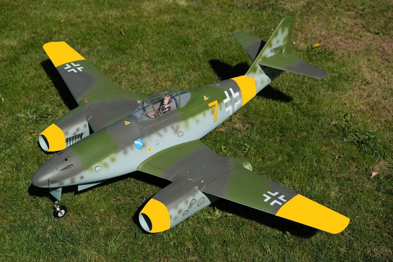

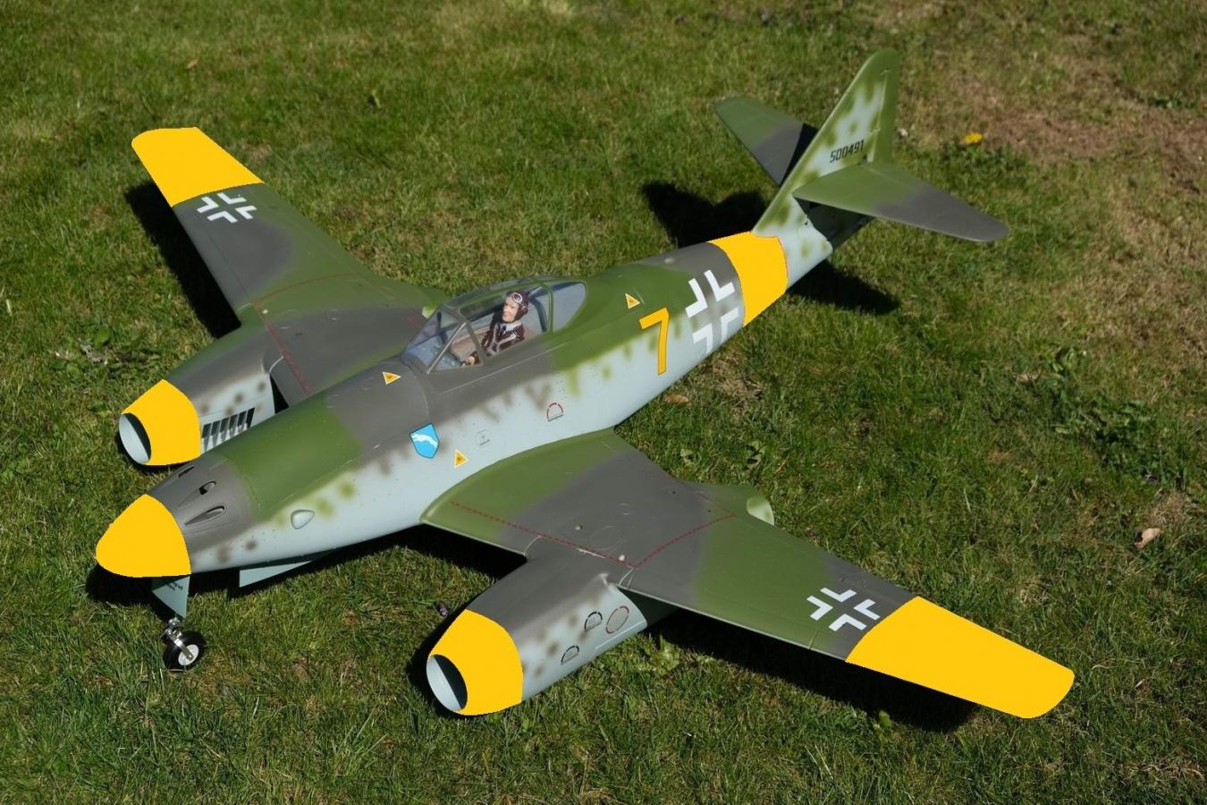

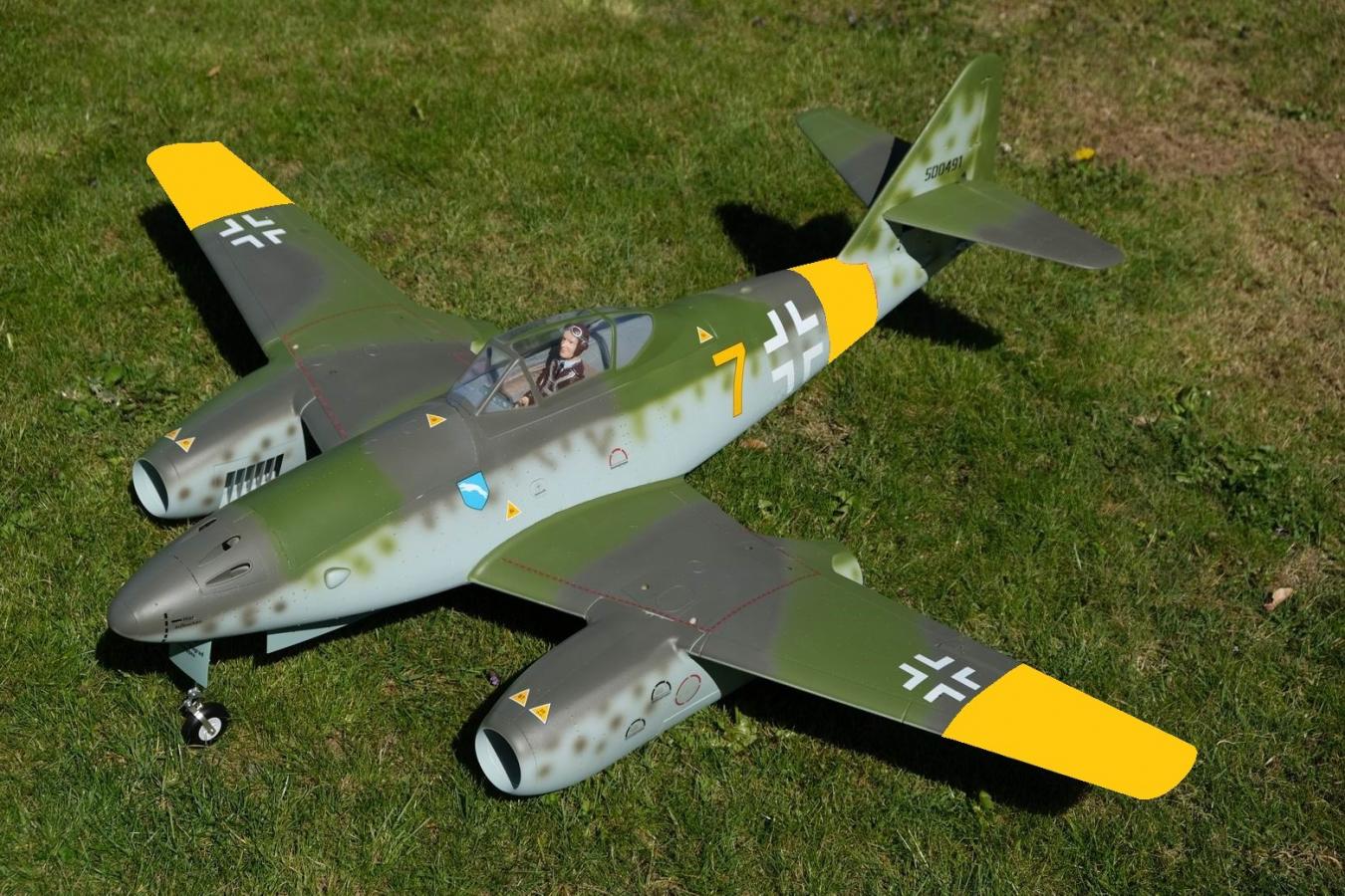

                              • For better visibility. Will start with this and later change the blue and red band at the rear of fuselage to this color as well. If I don't feel it the wing tips and the band is enough, the next step will be the nacelles. I don't think I will go as far as including the nose.
                                As for the underside, I have no definitive plan, but I may start with black wing tips.
