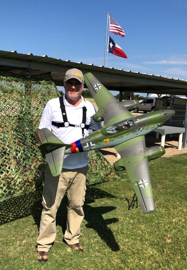

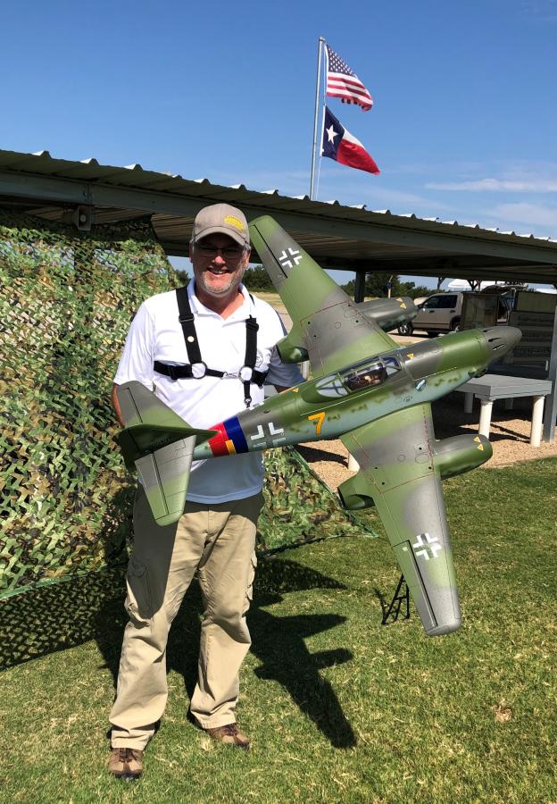

i just flew my V2 after having it in the hanger for some time. What a great plane.Originally posted by Alpha View Post
Congrats on your successful maiden and remaiden! I'm glad so many people are rediscovering just how slick a flyer the Freewing Me-262 is. It's one of the birds the Freewing factory guys here fly for fun, which says a lot.
