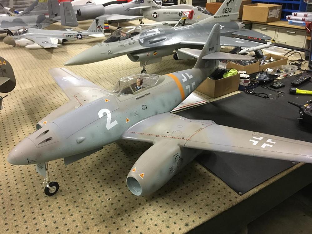

      Well I finally got one of these, the only bad thing I can find about it is that I waited this long to get one! The 262 is one of the best looking, most well built planes I own...if it flys half as good as it looks I'll be thrilled.
        Most excellent George...........Do the front end reinforcement mod though to ensure longevity.;)

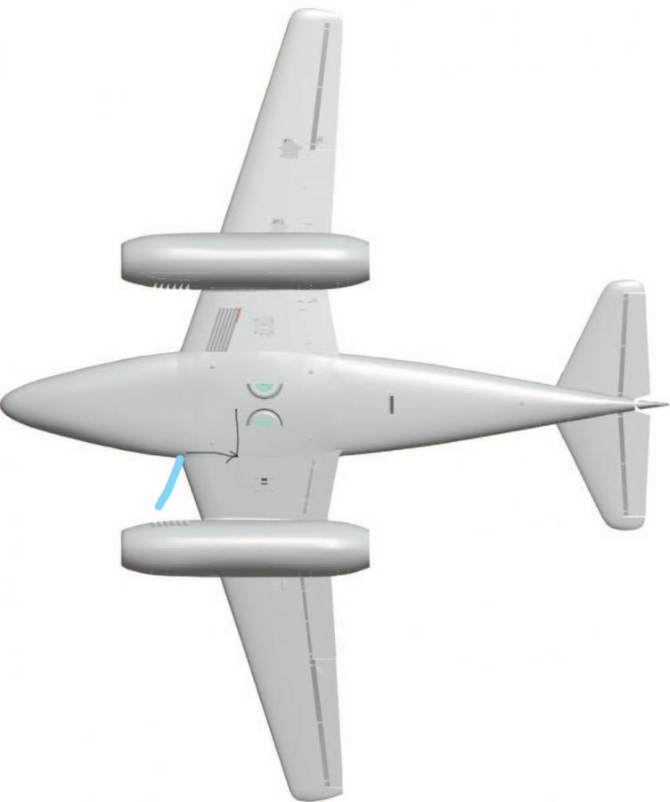

                      CG is 100 - 110 from the point at the leading edge back to where I crudely drew the line.
                        But nothing about throws or rates.

                            No, can't get any info on throws, Ryan said he didn't mention the throws in the video because they aren't in the manual.
                            So the only thing you can do ("I don't need no stinking throws!") bind her up, center your servos and blast off. I hate to admit it, but I've done that, throw her in low rates and hold one. Bad advice, but you have to come up with a starting point somehow.
