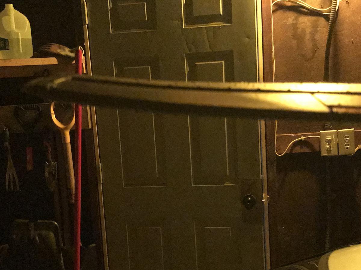

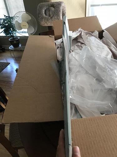

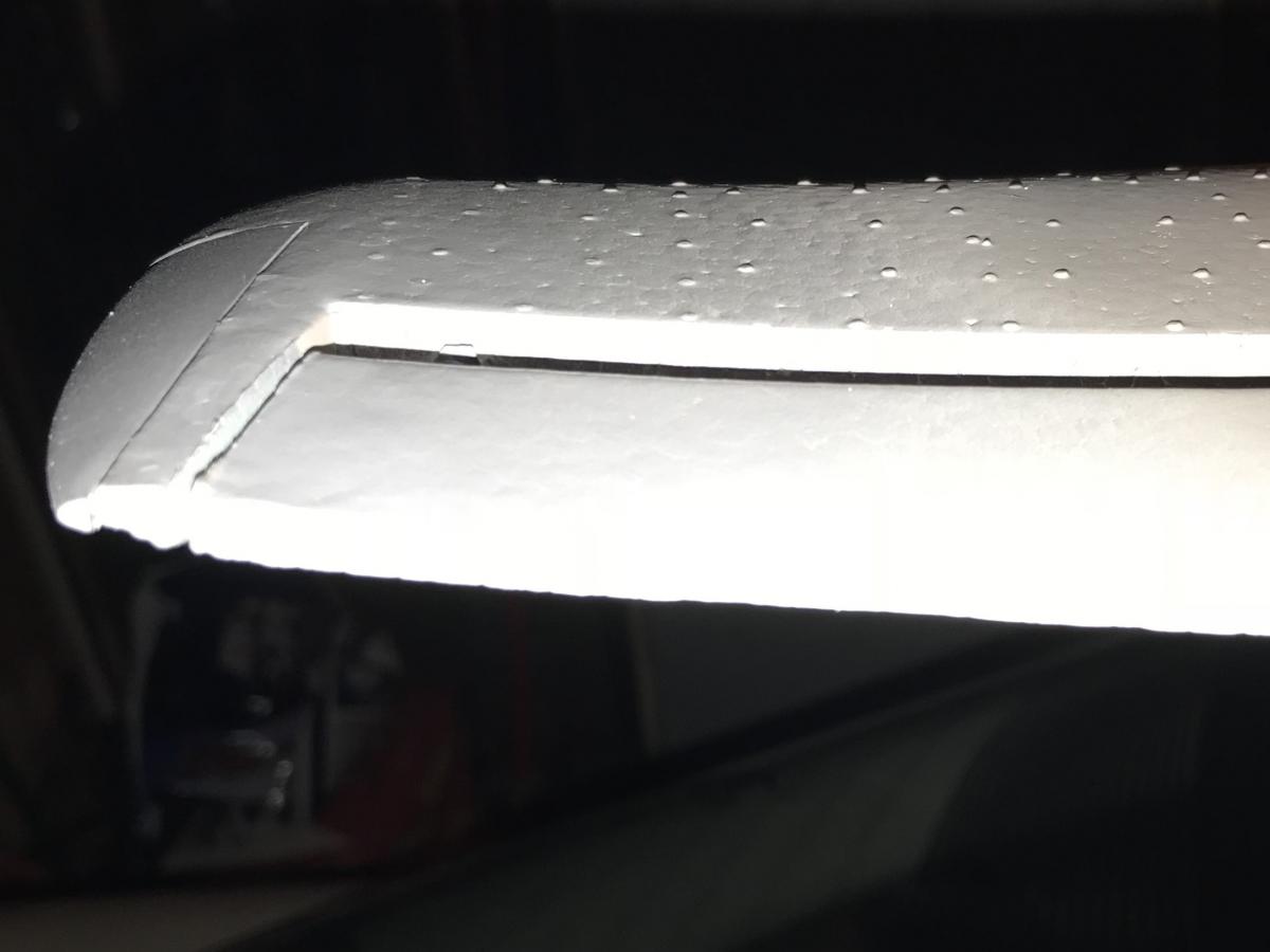

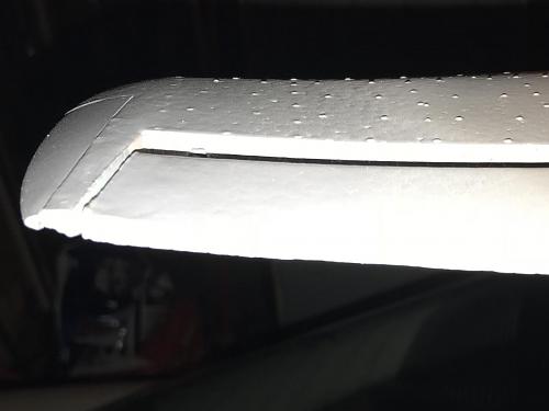

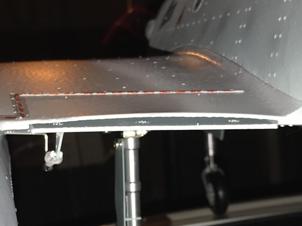

              • I just received my ME-262 and my question is... how warped were your wings?
ID:	138233Click image for larger version
ID:	138232Click image for larger version
                I have never seen anything this bad before.
                • Ouch! That's bad :(
                  • make cradles and strap it to a door core then leave it in a hot garage a couple of days. You can pull the warp out.
                    Actually, letting it sit at room temperature for a week or two it should straighten out.
                    EPO bends and reshapes easily when its warm, but its a memory foam that returns to the molded shape if given time without stress to prevent it.
                    The rudder of my Dynam Tiger moth was bent like a Pringles chip because something was resting on it in my trailer. I set the plane on the workbench and a week later the rudder was straight.

                        Mine are the same way and so was my buddies, thought it was just the ailerons on mine but it was worse than I thought, is your wing warped too?, that could be a problem, if not fly it the way it is, doesn't seem be an issue with trim or at least our's flew straight.
                        • Originally posted by DCORSAIR View Post
                          Helmsman52
                          Mine are the same way and so was my buddies, it was just the ailerons on ours, is your wing warped too?, that could be a problem, if not fly it the way it is, doesn't seem be an issue with trim or at least our's flew straight.
                          Port wing is warped also but not as bad as the starboard and the center flaps won’t seat because it’s warped on the wing. Both ailerons are warped. I’ve never seen it this bad though.
                          • Mine were perfect...they will have you new ones before you know it.
                            • Yeah that thing looks rough, I would try strapping it to a board or something like that like fhhuber suggested.
                              • Originally posted by Helmsman52 View Post

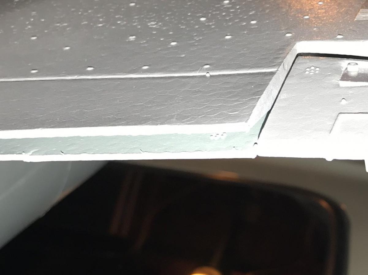

                                I couldn't remember what mine looked like so I went out and took some pics, it is worse than I thought, oh well, to late for me to complain to MRC. I just fly it the way it is, trims are perfect, flaps work great, but I guess from what I have read, this is a known issue and still is.
                                Do you think MRC is going to let you send it back or did you ask for new wings?
                                  Yours are still better than mine. I have know idea what Mrc will say but the proof is in the pics. I took and placed the jet in the garage but by the looks of it it will take more than the warranty time just to get the curve out of the wing tips.

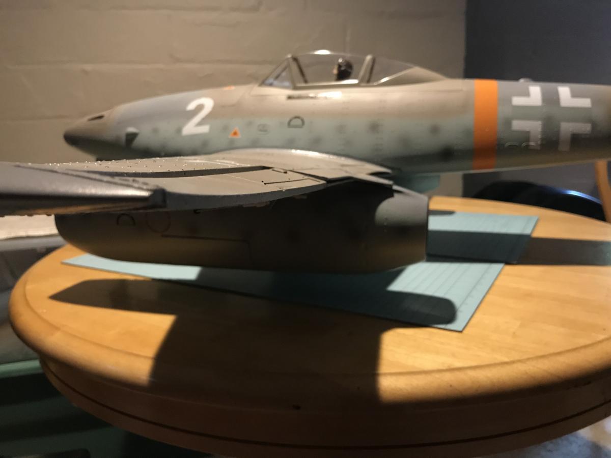

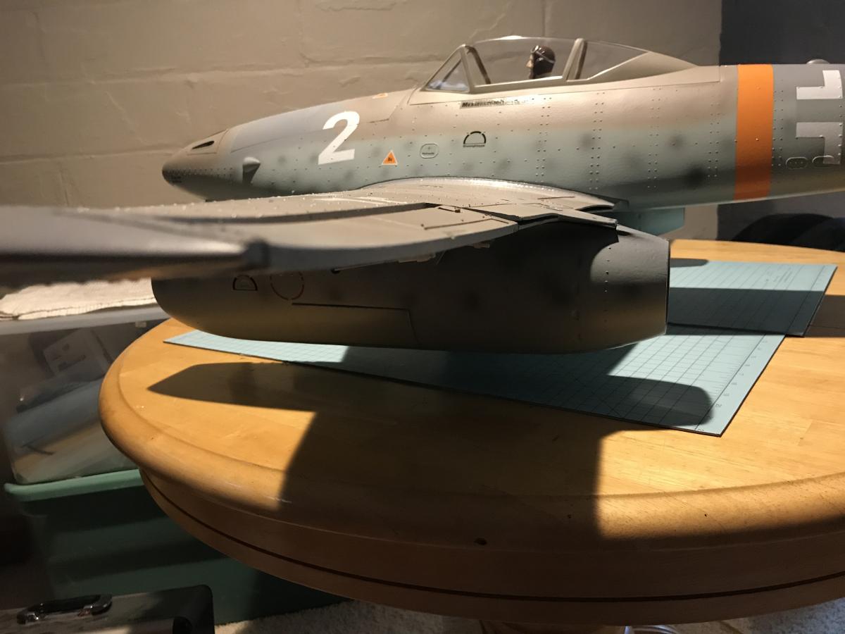

                                  • More wing pics.

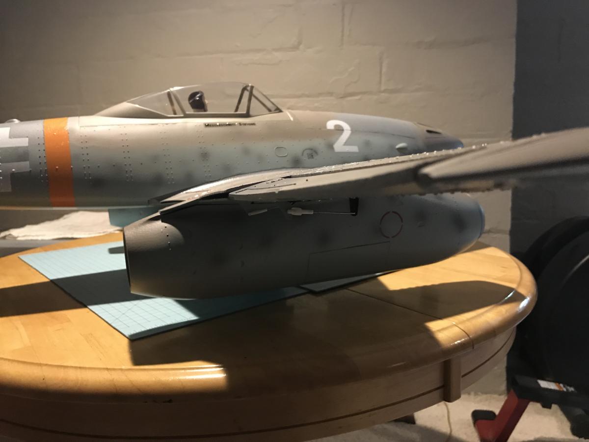

                                      • I’ve been a Mrc customer ever since I started the hobby about 5 years ago and imo they are the best all around in customer relations and service.
                                        I received my replacement wings today and they are straight!
                                        Thanks Mrc!
