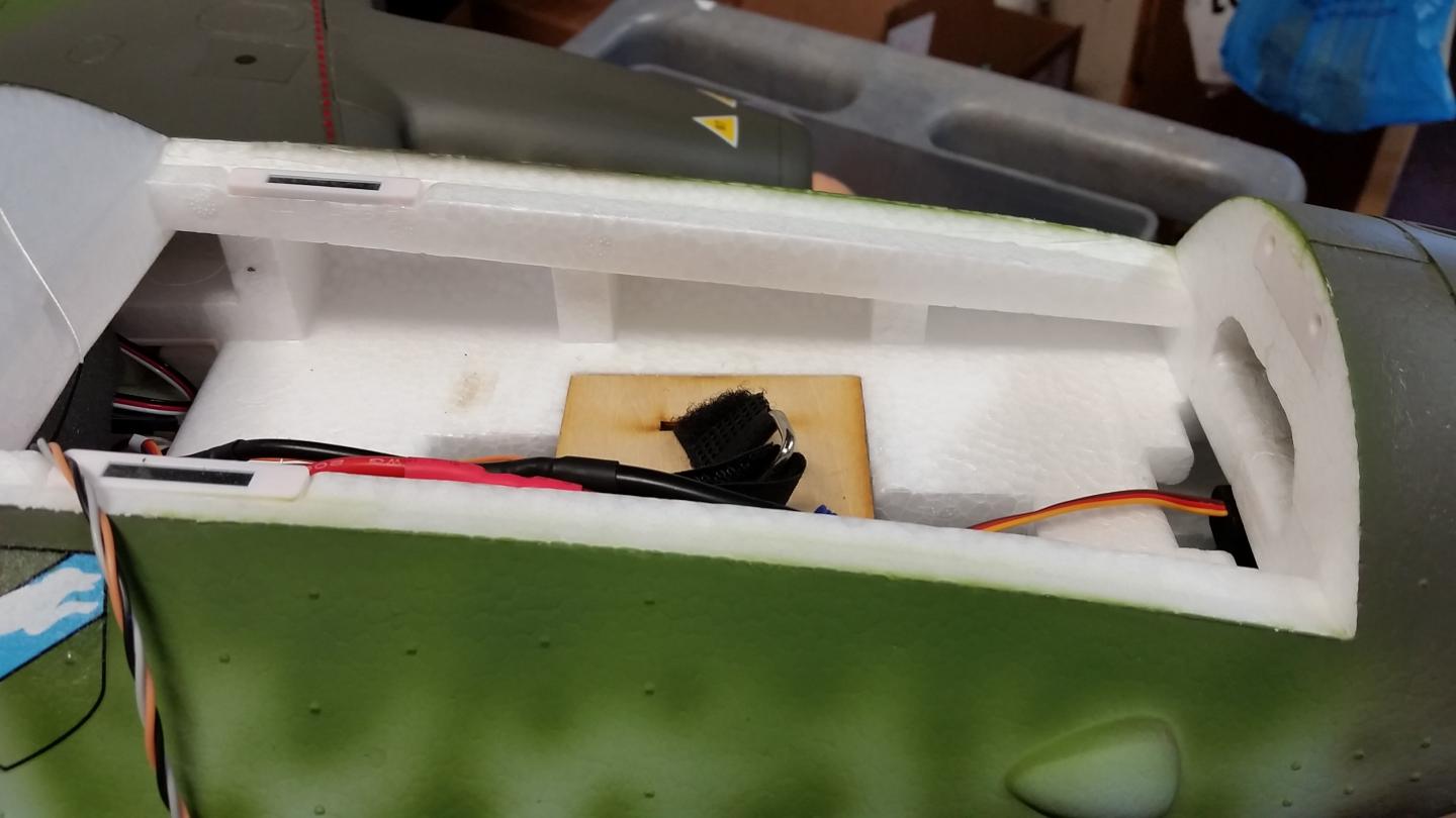

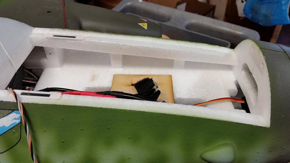

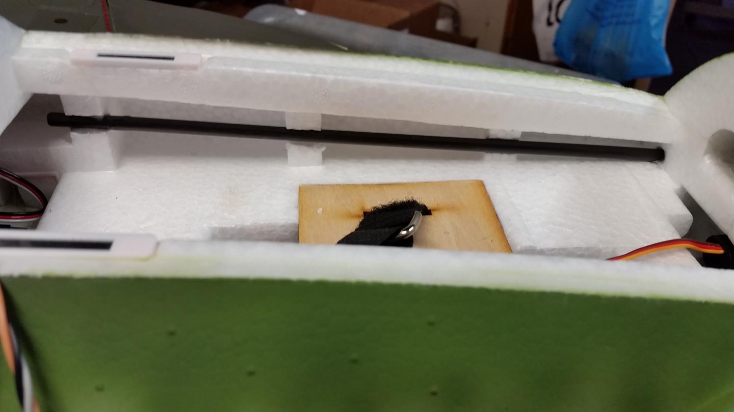

              A few posts back I mentioned that its a good idea on this model to reinforce the nose. Due to the weight of the battery, with a hard hit to the nose gear it's not difficult to break the fuselage.
              I used two 5mm CF tubes, about 10 inches long, epoxied into the sides under the hatch.
              All this does is add some structural stiffness to the foam sides.
              I cut out slots, and made a hole in the front so I could push the tube in at least an inch. "Before" and "After" pictures! (nose of the model is to the right)
