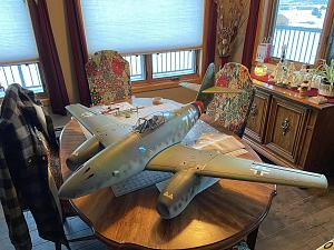

                      • Hello and a happy new Year,

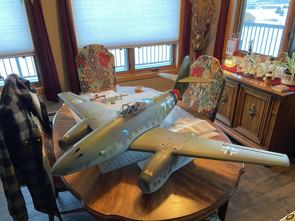

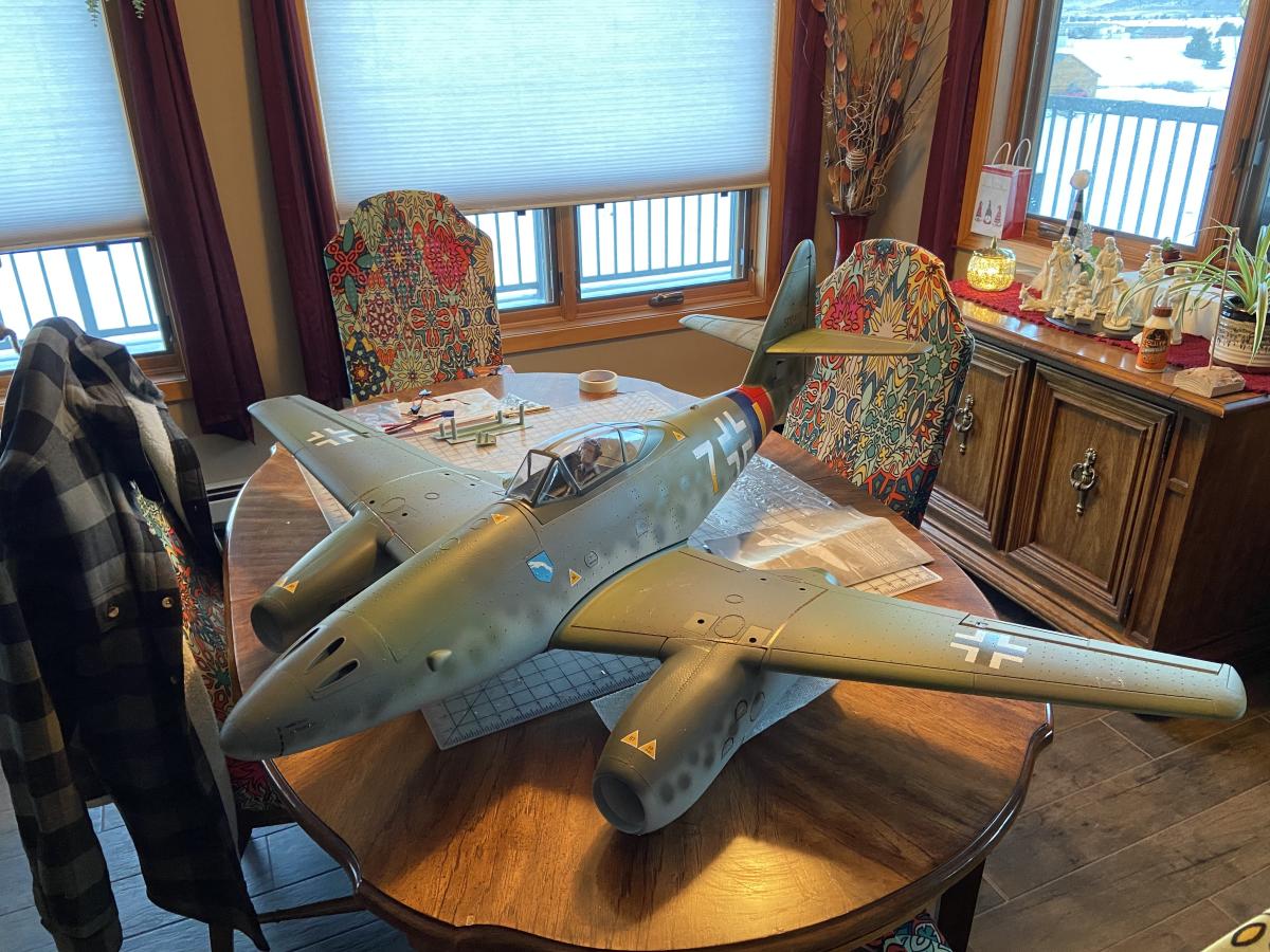

                        here is my Me 262 V2 .

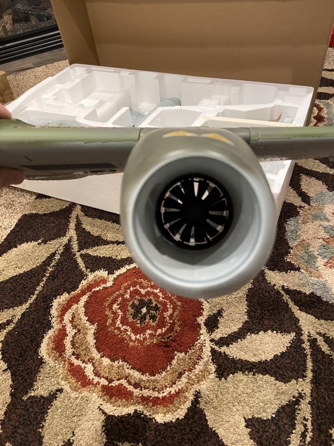

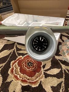

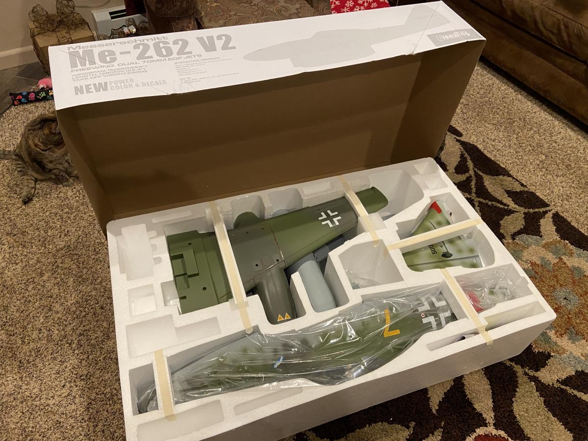

                        • Santa brought me a present - an Me-262 v2 !!
                          Always wanted an Me-262 ducted fan, but never saw a plane or kit I was enthralled with - until this!
                          Have read through this whole thread (helped Santa’s decision - so “Thank You!” to all who’ve posted),
                          and while waiting for the snow to go away (it’ll be a couple of months, at least) I will:
                          1. Set up throws to be moderate, with expo.
                          2. Install reinforcement CF rods into forward section
                          3. Add the vertical stabilizer graphics from Callie
                          Question:
                          For those who have painted, what type of paint (appears to be latex) and what specific colors/brands have you found that match up?
                          Will use a graphene 6s 6000mAh battery, and low rates for T/O and Landing.
                          I’ve calculated this to be 1/8.4 scale model, so may look for a replacement pilot.
                          In the future, will probably mod the flaps, but not much else…
                          Thanks in advance for any answers to my paint question!

                          • I've used Behr latex house paints (color matched to the model) and they work very well - for this plane I used a matte finish. Many people have had great results using a clear spray to seal and protect the original paint. Water-based Minwax Polyacrylic in the green can. Both from Home Depot in my case! The pilot figure is sitting in the back seat! You can peel the canopy off and move him - or replace him.
                            The three points you mentioned are good. This plane is an excellent well-behaved flyer, its only weak spot is the nose but the reinforcements take care of that. My experience is that it can be a bit nose-heavy. I've used a 5000 and a light 6200 (about 800gm) with it placed as far back as possible. If your battery is heavier than 800gm then the model will be nose-heavy (which certainly isn't a disaster, but lighter always flies better).
                            One tip - if you fly from grass make sure its short and clean - the motors will suck up debris which will erode the fan blades over time (or simply gunk up the blades).
