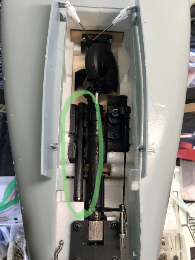

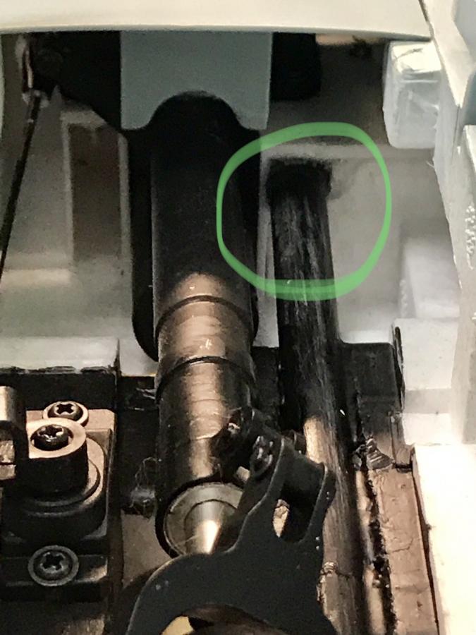

This is indeed true. Even a good landing on a rough, grass surface will snap the beak off on this plane. I've got CF square tubes going from the opening of the wing hole, all the way along each side and driven into the foam in the solid part of the nose cone. The rods were Dremeled into an arrow head point and pushed in about 2" into the nose. Then I used popsicle sticks and epoxied those under that nose cone and into the battery bay to help strengthen the nose gear when it hits something unforgiving.Originally posted by themudduck View PostI agree completely with XViper's comments! (great minds think alike??) I also fly mine stock. I feel its an improvement from the earlier version. I'll add: be careful to monitor your battery usage in your first few flights to get your timer set, the twin EDFs eat the milliamps up fast. And - its a good idea to reinforce both sides of the battery compartment with CF rods because the nose can be broken clean off in a firm landing. (none of us will ever do that, right!). I really enjoy flying this one, its definitely a keeper.
When I got it, the first thing I did was reinforce the nose and nose gear with 5 CF rods and add balsa to the batter tray. I read up on everything when I got it, I just thought I would ask opinions before I installed everything. As far as the "wheelies" go, I already have a AS3X receiver in it that I had laying around. I didn't see the need to go higher than 6 channels on this plane. The only I could potentially want would be nosewheel steering, but I'm not that worried about not having it

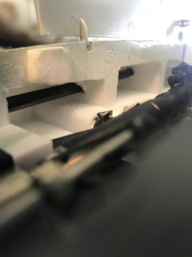

In your first picture, how far into the foam (beside the retract body) does that rod go? Mine broke just aft of the retract attachment screws. The other place it cracked was at the front wing hole. As for the "wheelie", this happens from the standing start, so AS3X won't help as there's no airflow to speak of on the elevator. You just need to accelerate moderately at first. The AS3X will help reduce nose up for sudden throttle input while flying.Originally posted by C17loadmaster View PostWhen I got it, the first thing I did was reinforce the nose and nose gear with 5 CF rods and add balsa to the batter tray. I read up on everything when I got it, I just thought I would ask opinions before I installed everything. As far as the "wheelies" go, I already have a AS3X receiver in it that I had laying around. I didn't see the need to go higher than 6 channels on this plane. The only I could potentially want would be nosewheel steering, but I'm not that worried about not having it
I had envisioned it airborne when I replied about the wheelie haha. :)
The gear support rod is pushed up against the stew that secures that corner of the retract, so about an inch. I haven’t texted it out yet... I could just tell that mount was asking to break off. I was building this the same time I was working on my SUs so I was in the mindset of strengthening nose gear haha
