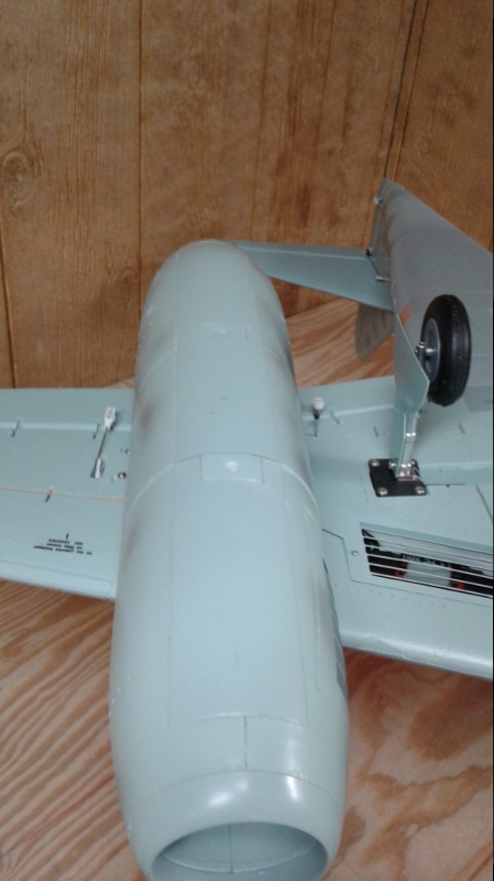

                              Modded the engine pods today. I wanted to get in there and check out the motors and fans but there was this skid glued over the hatch. I suppose they did this to help damp motor vibration or maybe like the flaps they were just being a bit cheap? I don't know. Anyway....
                              A few hours later and I had it modded so that I could get in there when I need to. We tend to get grass particles stuck in the shroud where I fly. And I like to clean that stuff out.
Name:
                              I did find a metal shaving and a piece of solder in my #1 engine.hmmm. The metal thing was wrapped around the shroud mount part of the motor on the outside. And, I found out they had stripped one of the fan mount screws. And as an added bonus they stripped out my servo cover screws. This has to be the all time worst case of stripped out screws I have seen.
                              Did Freewing get their biggest meanest guy in there to install screws? I have had to re-build, re-glue, or get bigger screws just about everywhere a screw lives on this bird. Not happy about that. It appears to be a disturbing trend with the last three kits I have received.
                              However, I look forward to flying her tomorrow. I did add a couple drops of contact cement to each side of the hatch in order to help quiet noise. It made a difference.
                              This bird, with all her factory fresh issues corrected, flies wonderfully.
                              • #35
                                I believe those plastic covers are there to prevent rub rash on the bottom of the nacelles. I'm glad they're there too as I've scraped my nacelle bottoms on the pavement quite a bit!:)
                                • #36
                                  Mine are there too. But I can now open my engine bay without ripping glued stuff off the plane.
