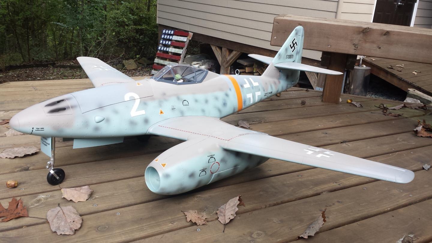

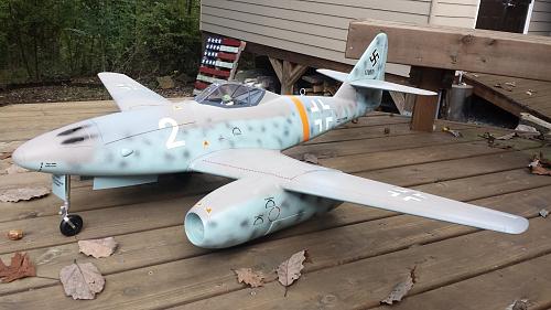

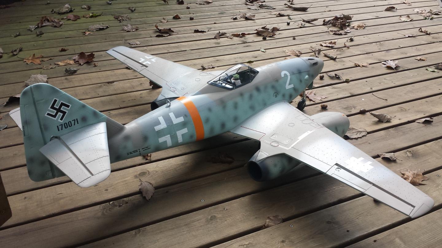

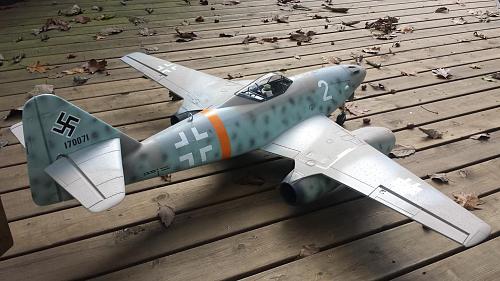

                I have done allot of work on my 262 but have only a few flights on her. I have to say she is one of the best flying jets I have, the plane is very well built and designed. I'm running my own non counter rotation edf power system @75A each and have not seen any negative effects. I'd suggest reinforcing the nose as the front section can be easy to do and a few people have had the nose break on a hard landing.The plane is super stable, the only thing to watch out is not to power up too quickly on takeoff as the thrust line is low so the nose can be pushed up too quickly before the plane has reached flyable speed (NO flap on take off, just let her come to speed and come up). Also as with any jet large sweeping turns and keep speed up. I have found you can cut power and she will glide right in, nice.
                cg 110-113mm
                10 to 12mm ele up (top of ele) I always use as little ele as needed as bad things can happen with too much ele :o)
                15mm ale ( might add more, she rolled slow )
                20mm rudder
                Good starting point, the plane felt good right away, no pitch change with wheels or flaps, I will add a little down ele with throttle mix. She is a thing of beauty, hard to find a more beautiful jet.
                Good luck.
ID:	118441Click image for larger version
                here is the maiden video
