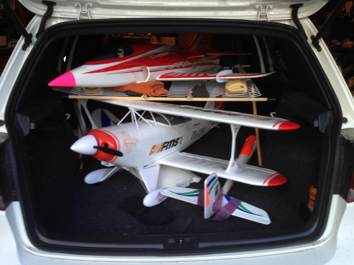

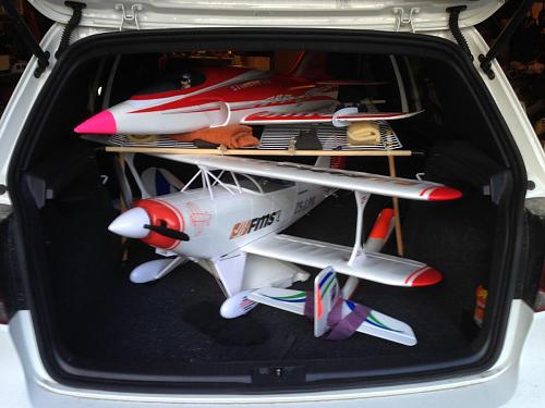

                              Well, of course. It's not going in straight. To get a plane that size into a vehicle like a Sportwagen, you have to be creative, think outside the box. You put one wing in first, then at a slant, you get the rest in, changing the slant and the angle as it needs. The opening in your T&C is cavernous compared to my Sportwagen and the overall space inside is again, gigantic.
                              I can easily fit a 1500mm Eflite Mustang, 1620mm Avios Albatross, 1600mm C-130 Hercules, whole. In fact, I can take two of these, one the floor and one on the upper shelf, which I built for the car.
                              Here's a picture of my shelf with a large biplane (small compared to the Albatross) on the bottom and Stinger 90 on top, with a sailplane in pieces stored in the spare spaces. I don't happen to have a picture of the 262 in there or I'd show you.
                              Oh, BTW, this is my old Golf GTI, a bit smaller than my current Sportwagen.
                              Click image for larger version  Name:	IMG_2044.JPG Views:	0 Size:	105.9 KB ID:	335159
                              • Sir; okay, I just have to get creative. And be very careful. Thanks for the help; Ernie P.

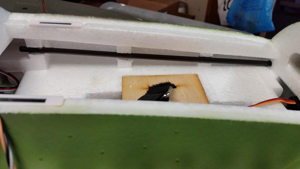

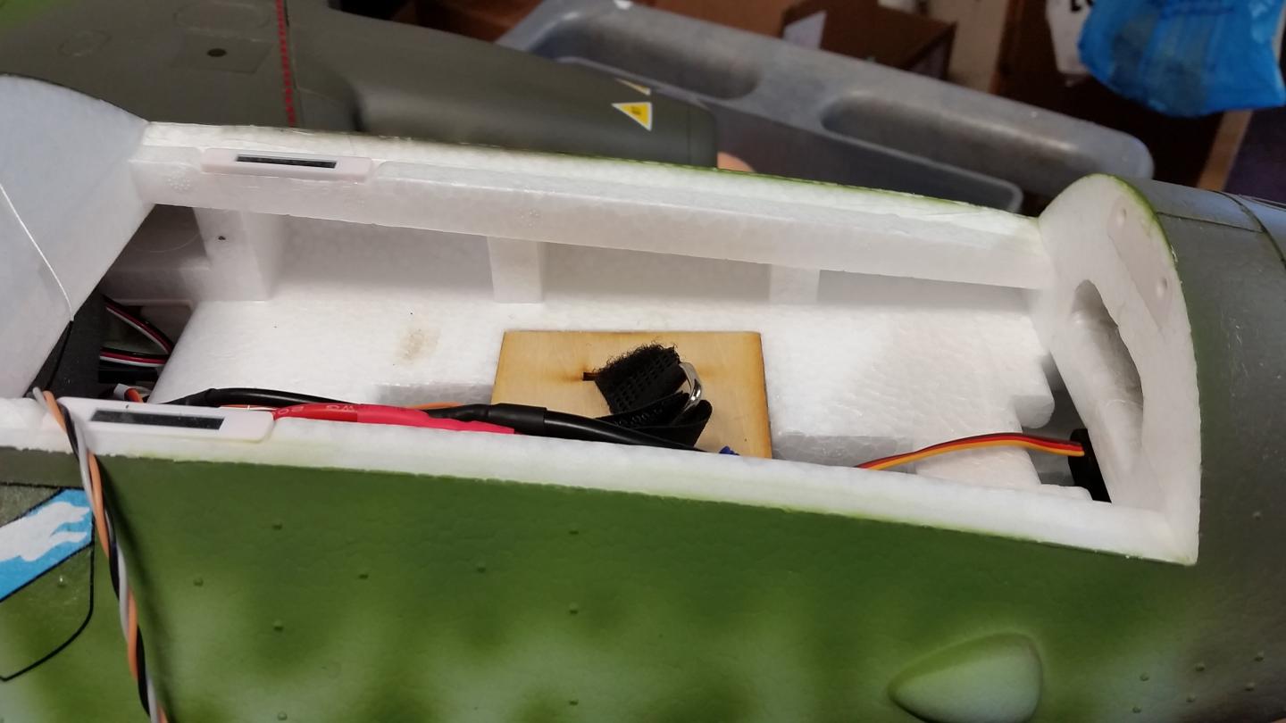

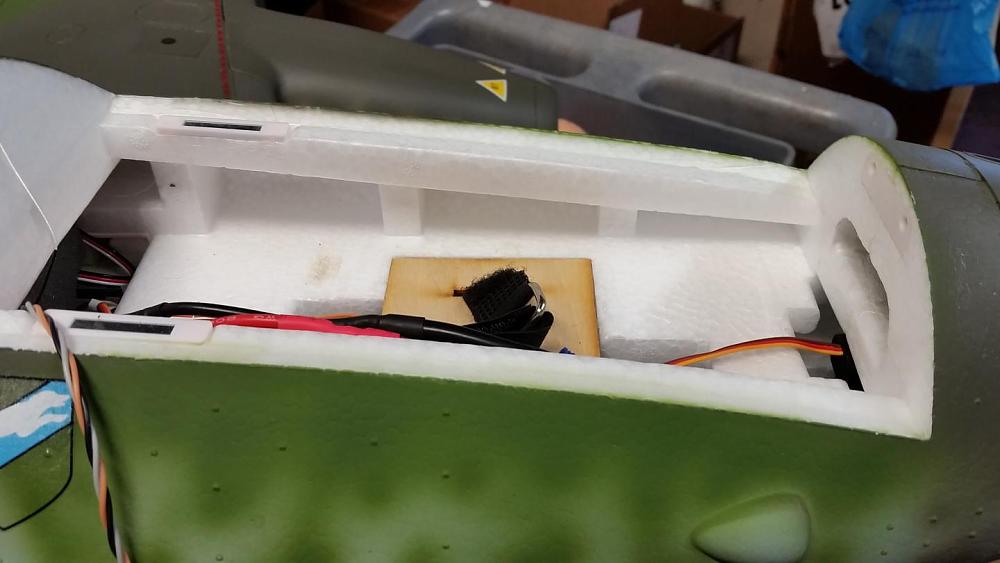

                                  Regarding the square cf tubing to strengthen the nose section, can anyone tell me what dimensions you recommended/used? Many thanks and safe, fun flights.

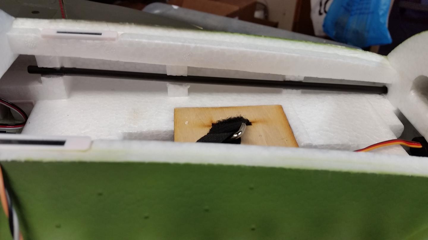

                                  • I used 5x3mm CF tubing (5mm OD, 3mm ID) embedded in both sides, like you see here... and I extended it as far as I could into the nose.
ID:	338446Click image for larger version
                                    • I did it exactly the same with the CF rod along the nose. I've had no issues at all with cracking or bending, but I do fly off tarmac. You'll love the 262. Its a real pleasure to fly so stable its a nice relaxing edf.
                                      • The CF addition works great. I've been flying mine from grass for the last four years with no issues with the nose area.

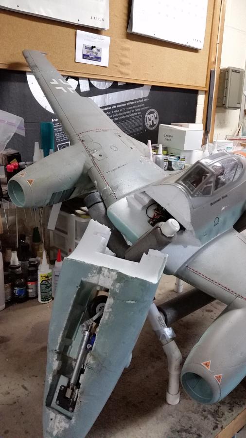

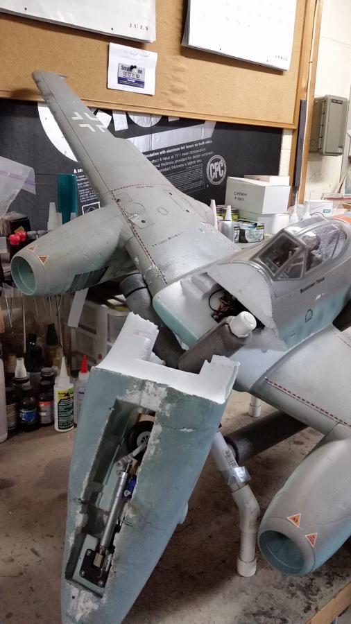

                                        • I should say that I broke the nose off my first ME262 (v1) which didn't have any reinforcement installed.
                                          It broke off during a landing, and it wasn't a very hard one. Hard enough!
                                          I repaired it and added the tubes on each side and flew for several more years, then did the same on V2 and have no problems. Its a very easy reinforcement that will help your jet last a lot longer. These pics are from 2016
