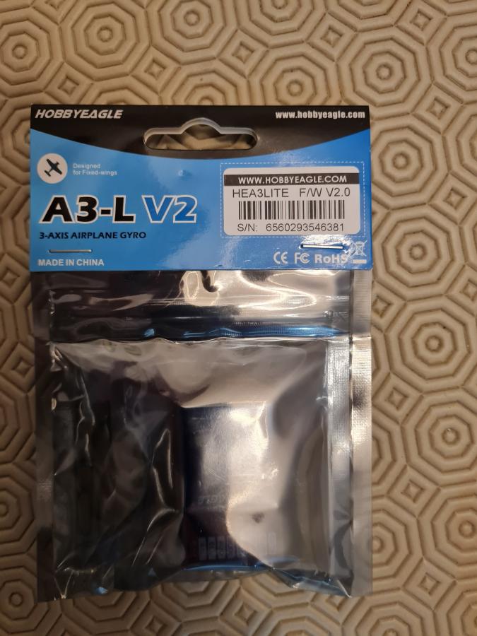

    It's really hard to tell a clone from the real deal. I bought a tail gyro for my helicopter years ago. It was a well known and popular brand. It came in all the proper packaging, labels and even the actual gyro looked identical. I found out the hard way on the internet that that particular seller was selling clones. I took the thing apart and found a large nut glued inside to make up the weight of having no electronic innards. I don't suggest you do that but I would strongly recommend you do ALL the required tests once the gyro is installed before the plane leaves the ground - control directions are correct, gyro response directions are correct, no odd little glitches like vibrations and improper servo centering. These are telltale signs that something is wrong - DON'T FLY.
    cheers bud, yeah ill make sure all of the checks as you state are carried out. If i have any doubts ill buy a different brand like micro beast or something.

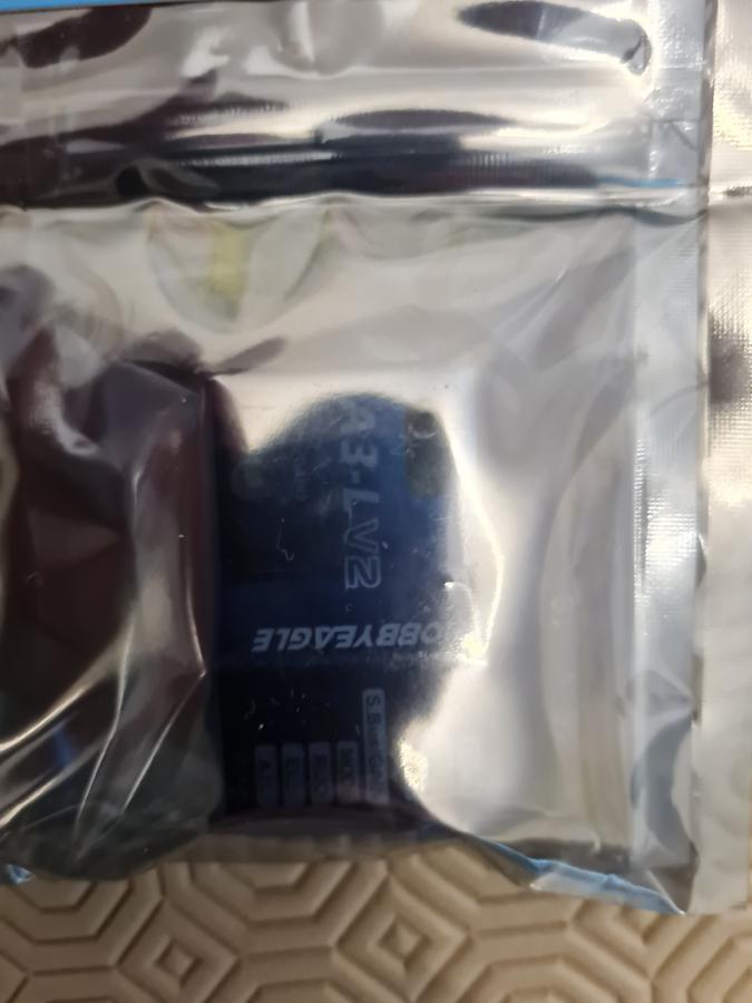

    Originally posted by Arron yeate
    ah good stuff, however mine was purchased from ebay a while ago for £17.00 this is the actual product taken by my phone
  • Arron yeate
    Either one will work. Neither is the "wrong" one. I use both on my planes. The A3-L has a "normal" gain pot and a "3D" gain pot. You dial the 3D to zero. The A3 splits the gain pots into the 3 separate axis - AIL, ELE, RUD. I don't think you can have 3D gain on that one.
    BTW, HobbyEagle has discontinued both of those. You can still buy left over stock in various places but once that stock is gone, you'll have to buy the replacements, which will have some extra features. Just beware of "clones" from places like ebay or even AliExpress and Banggood.
